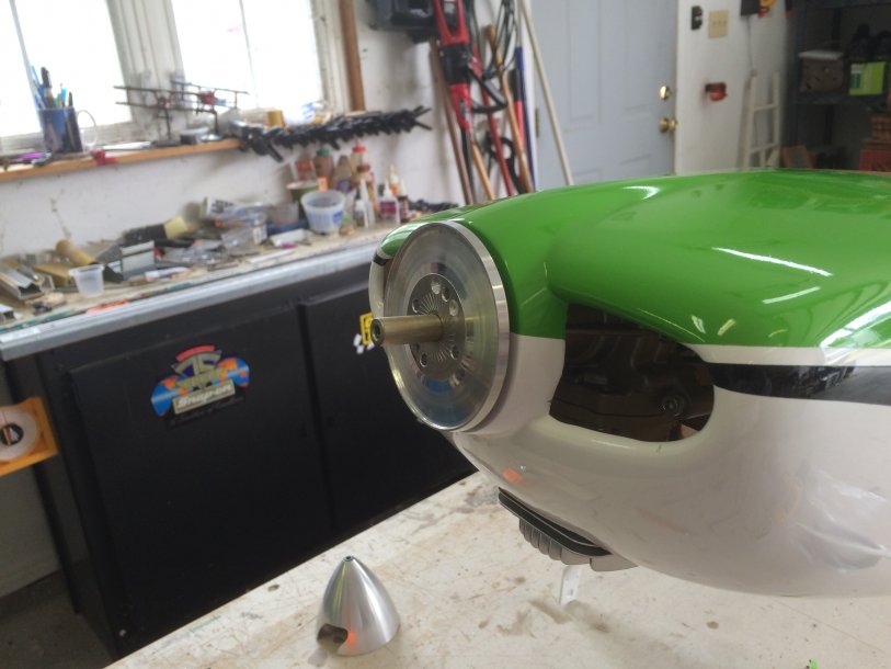

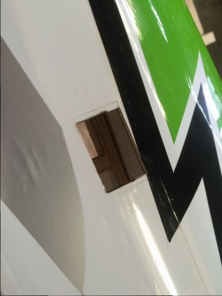

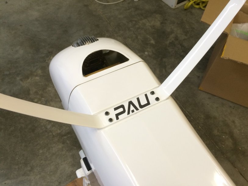

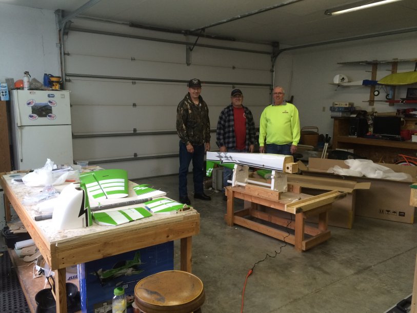

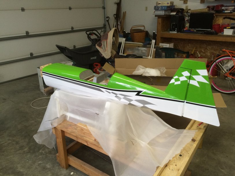

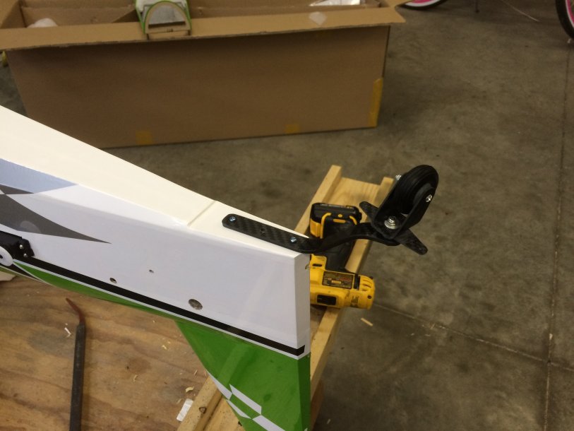

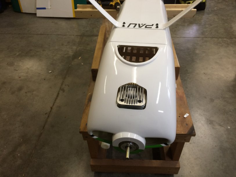

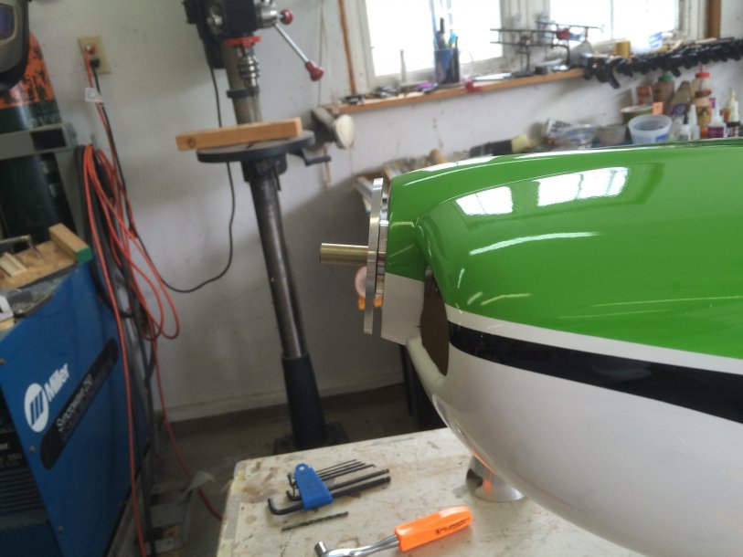

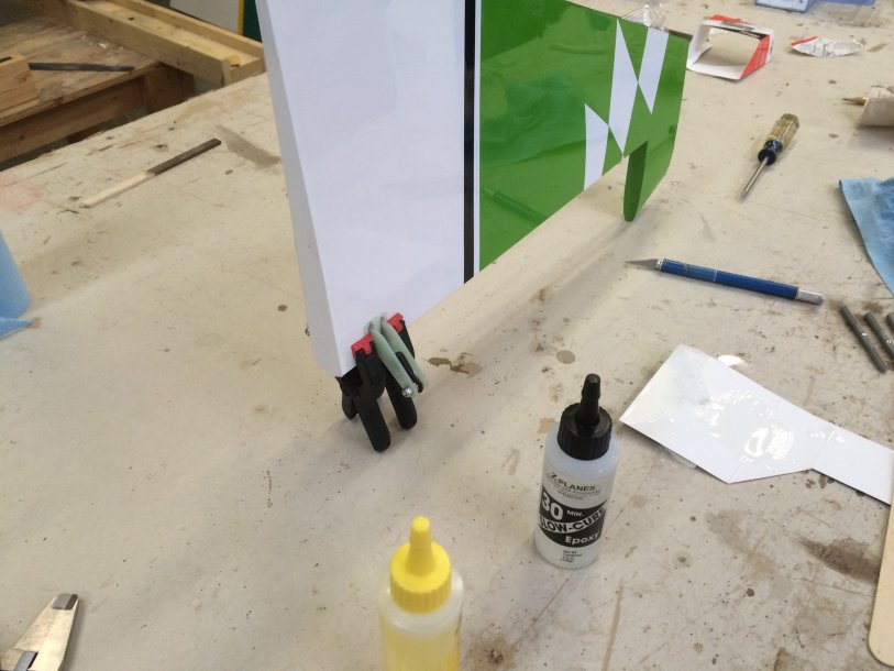

  9. I'm getting started on another 35cc Edge. I brought this home for my friend Kent Horsman from Joe Nall. He's a relatively new pilot. Definitely not a 3D pilot. We decided to do an Economy Build for the weekend flyer. Don't have to have the most expensive equipment to still have a great flying plane and be able to have tons of fun with it... Using Hitec 5645s for servos. These will work for regular flying and all IMAC maneuvers and some fun stuff like flat spins. I had this setup in my Sboch and it worked well. DLE-35 RA will have way more power then he needs. Using 6V Life packs for less hassle and ease of charging. Keeping it simple.
    I waited for Kent to open up the box cause we all know what Christmas feels like and I didn't want to deprive him of that feeling. smile emoticon
    Mounted the Engine, the rear servos landing gear and tail wheel. Also glued the control horns into the rudder.
    Posts will be sporadic this week cause I'm getting ready for IMAC but stay tuned cause this won't take long to finish. IMG_2303.JPG IMG_2304.JPG IMG_2305.JPG IMG_2306.JPG IMG_2307.JPG IMG_2308.JPG IMG_2309.JPG IMG_2310.JPG IMG_2311.JPG IMG_2312.JPG IMG_2313.JPG IMG_2314.JPG IMG_2315.JPG
