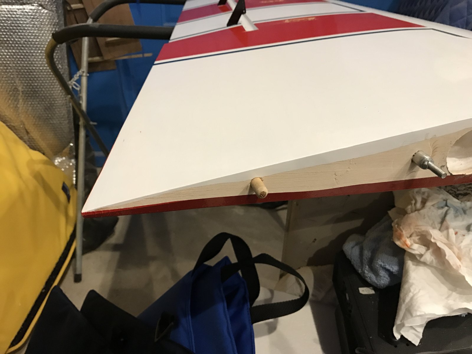

yes sir. thank you. Just did something, may be hard to see, But this is 3/5" long poplar dowel, and this is being glued on to the TE of the root of the wing, to help increase the stability. Maybe it does not need it, but I was informed, this would be a good idea, and I like it.,
tl3
For future reference: I prefer using sections of carbon arrow shaft for anti rotation pins, or get some alum tubing to fit over the dowel. In hot humid weather, which I'm sure never happens in LA ;-), the dowels can swell to the point were putting the wings on or taking them off becomes challenging.
