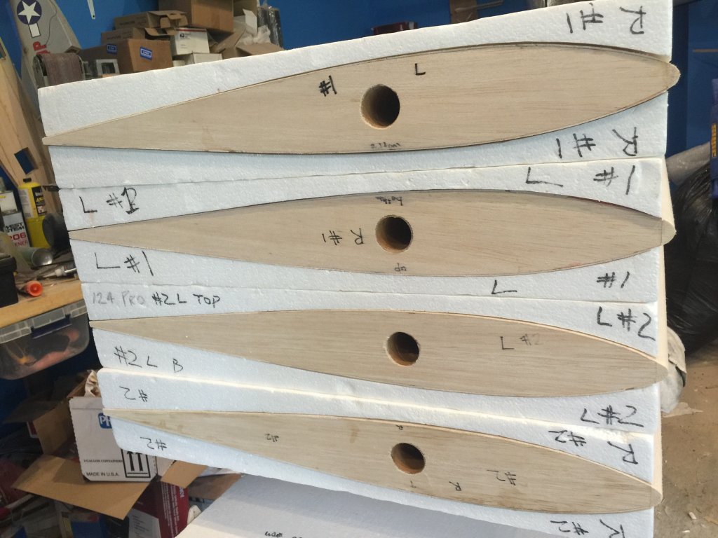

The wing looking good , nice rounded leading edge , excellent work .

All the leading edges are sanded and shaped.

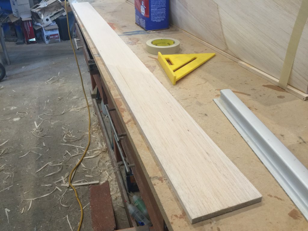

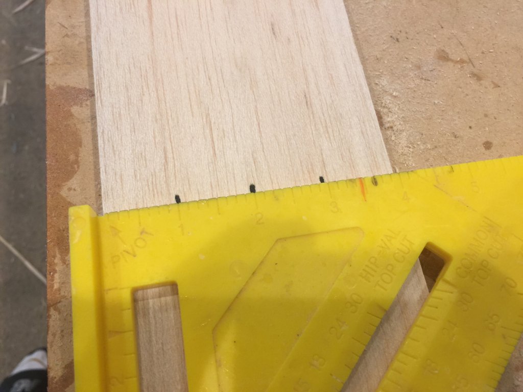

wanted to demonstrate how I made the TE:

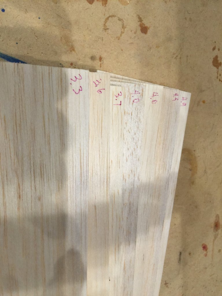

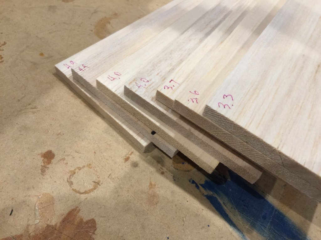

1st, I picked the 48" x 4" x 3/8" thick balsa that is the most dense, as I want it to be as stiff as possible, for the TE of the aileron.

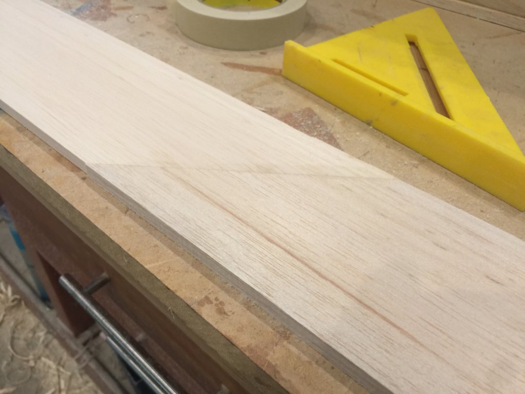

I then need to splice it to another segment, since the balsa is 48" in length, and the TE of the wing is roughly 56"...

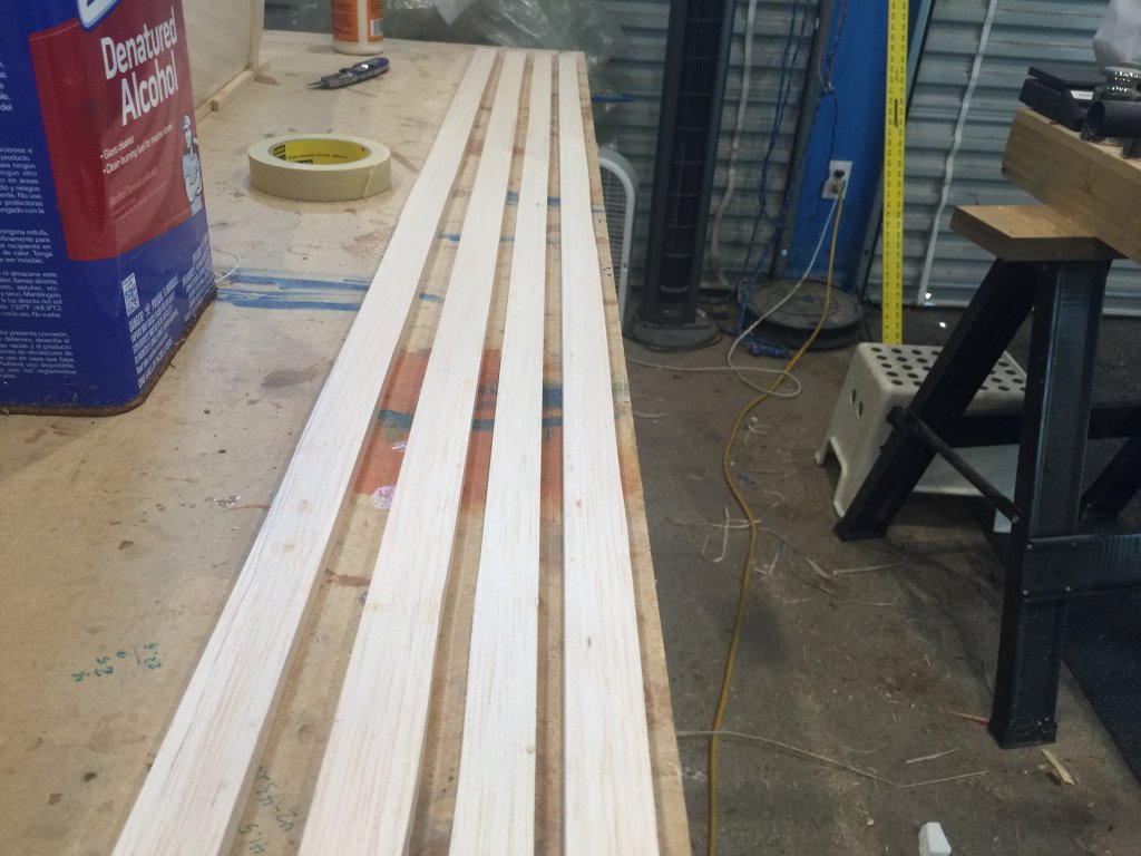

I will be needing 4 of them, and it being 4" wide, easy to cut them into 1" wide strips....
now, time for me to glue them on, then I can shape the TE, and set the incidence.
