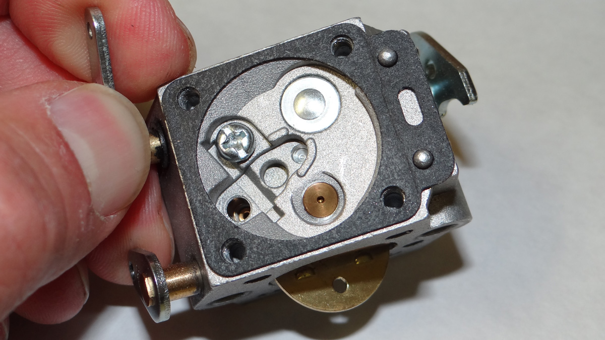

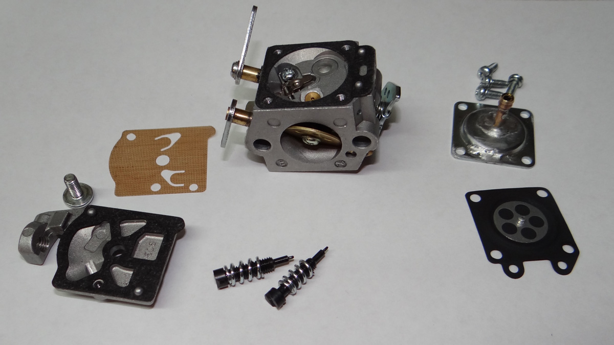

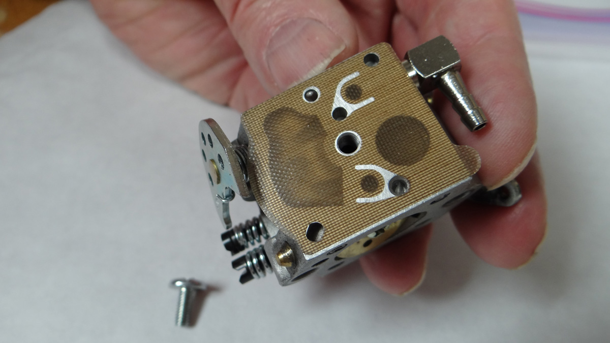

I wanted to close the loop on this and post some photos of the original carburetor dis-assembly I did today with one of our more experienced club members. It wasn't nearly as intimidating as I had feared. But the bottom line is that we found no smoking gun as the cause for the engine dying when the plane was inverted.
One thing we did find was that the fuel inlet barbed fitting was very loose. I could easily pull it out of the carb body with my fingers. Pat flared the end a few thousands of an inch and pressed the fitting back into the carb body.

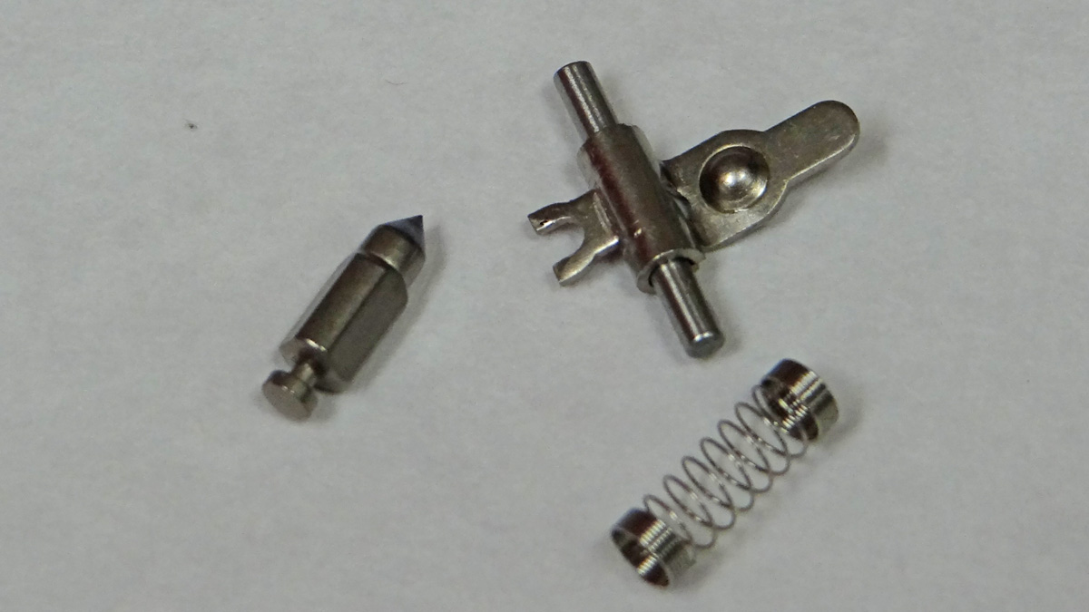

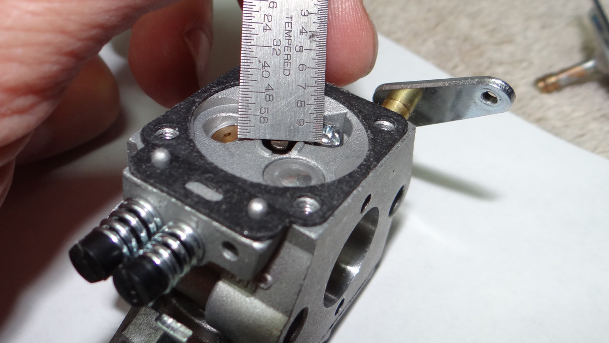

Pat also had some concern about how the metering lever should fit and if it maybe needed a tweak. But I was not able to find any reference material on that so it is still a question.
Major components
Pump side
Regulator side
There is still some question if the lever may need some tweaking.
Inlet needle, lever and spring.

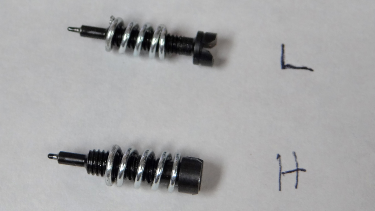

High and low speed needles.
