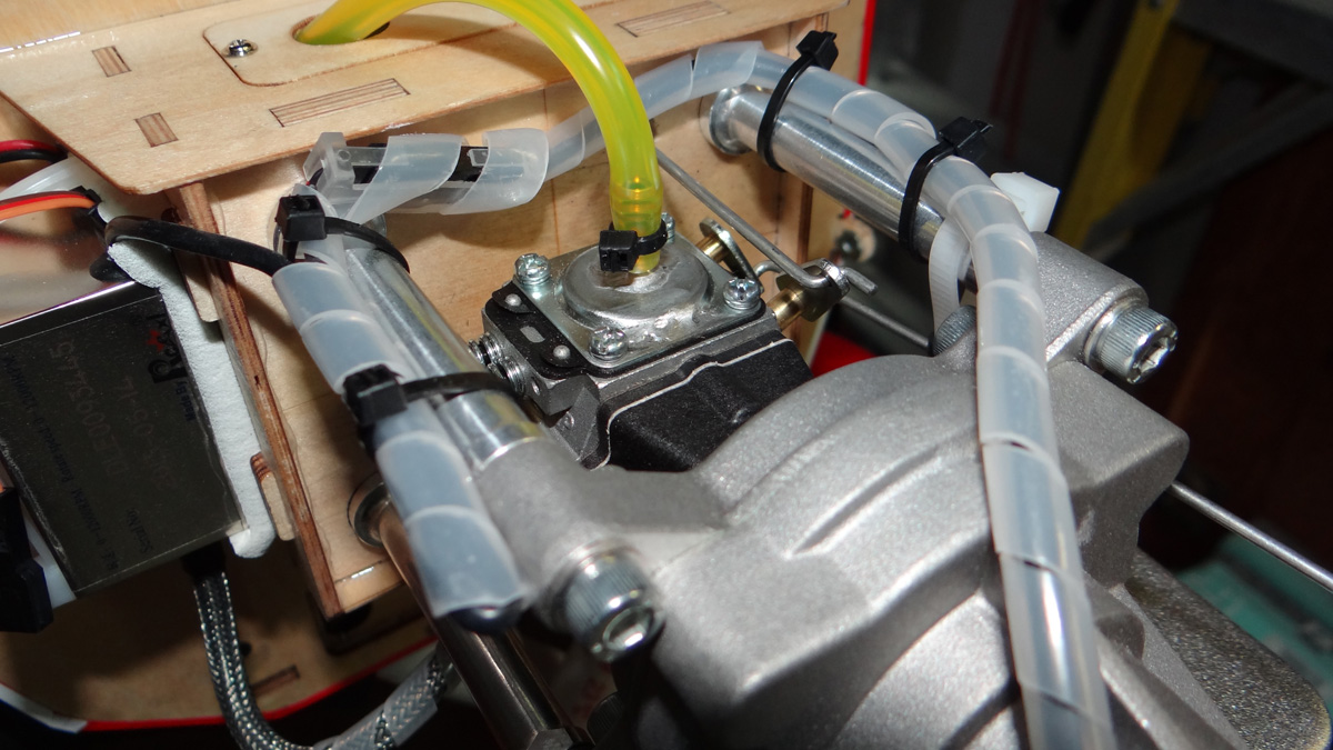

This is the fitting I soldered on for the carb equalization

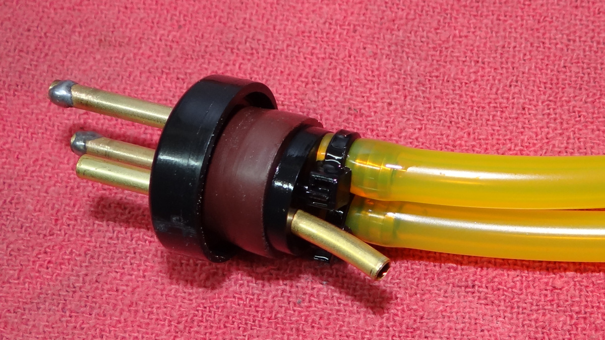

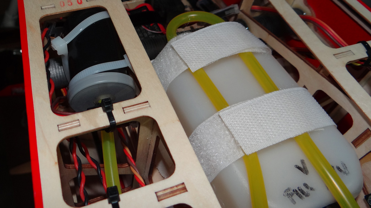

This is the tank as mounted in the plane

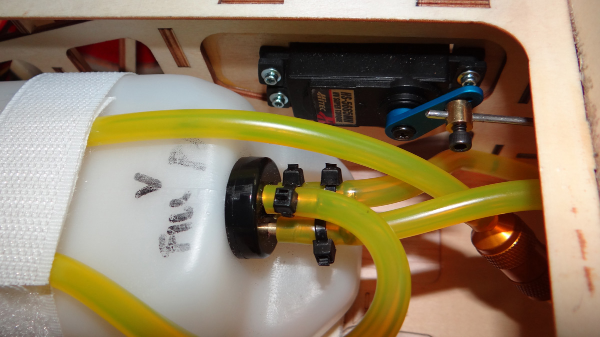

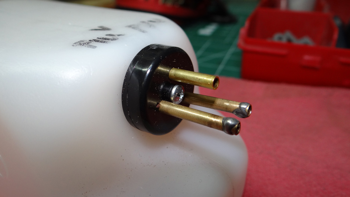

These are the tank inlet lines

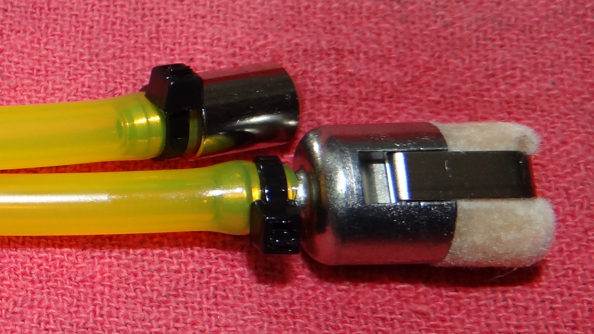

This is a closeup of the stopper
This is a closeup of the clunks (pickup and fill/drain)

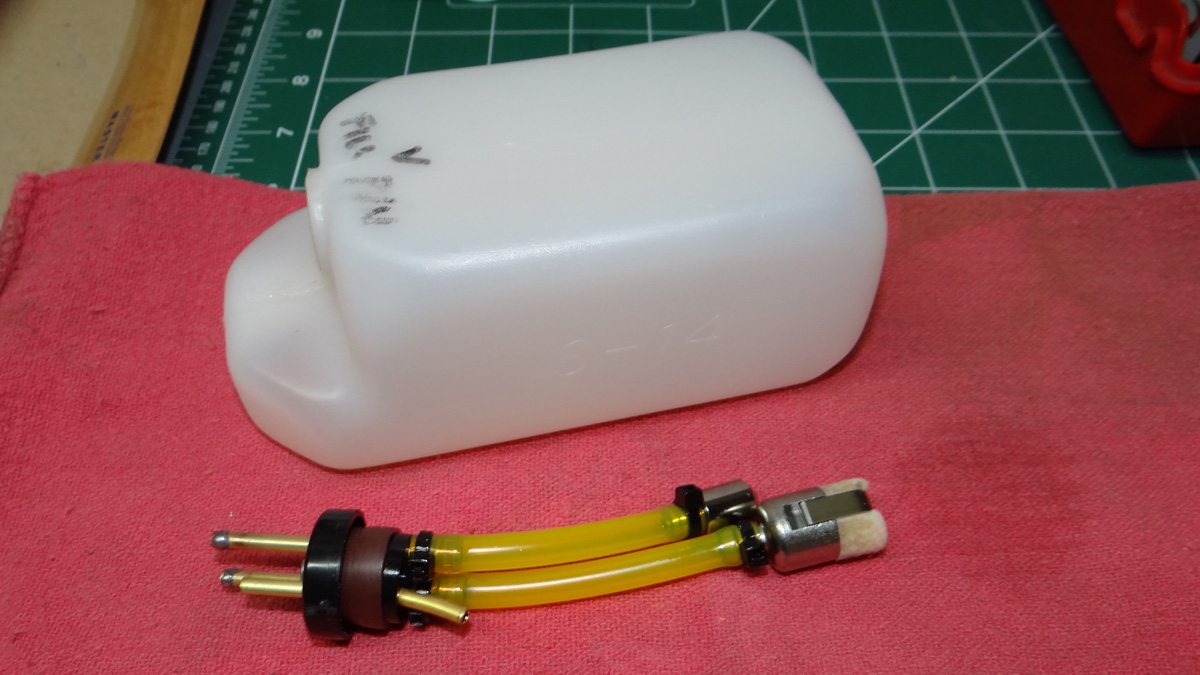

This is the tank with internal plumbing removed
I've heard many people talk about that problem with DLE30, but never had it with mine.
Would think two things would be helpful:
1- get a new carb. [MENTION=327]ValleyViewRC[/MENTION] stocks them for a very reasonable price.
2- get a different tank. I've never been a fan of those dubro tanks, I personally prefer [MENTION=2715]WrongWayRc[/MENTION] tanks, but many have had success with Fourtitude as well.
Get rid of that funny carb equalization apparatus thing. Shouldn't be needed, and it just complicates things and adds unnecessary weight.
:D I thought that carb equalization thing was funny too. But I'd be willing to wear a clown nose if I thought it would allow me to fly inverted.

Another guy suggested I get rid of the three line tank and go with two lines and a tee (like everyone else in my club). He thought maybe the fill clunk was getting in the way of the pickup clunk. He also suggested getting rid of the felt clunk and going with a regular clunk. I went with the three line tank and the felt clunk based on other people's suggestions though. :rolleyes: So it may be more trial and error.

I just bought another DLE30 from RC FEEN, and his has a baffle on the carb to keep it from dying inverted... I'm not sure if I'll keep it, or throw my spare carb on it.
Is that baffle you're talking about the one that mounts in front of the diaphragm pump plate to help equalize the atmospheric pressure? If so, that goofy fitting I have on my carb pump plate is supposed to fix the same problem.
