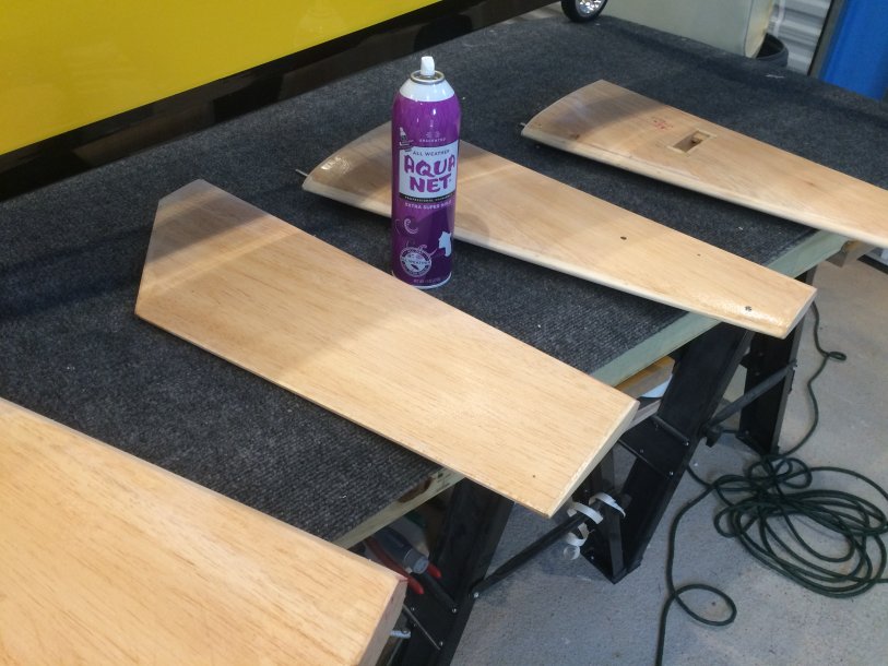

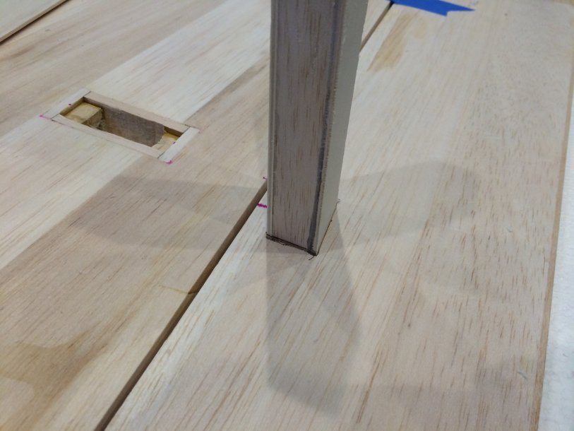

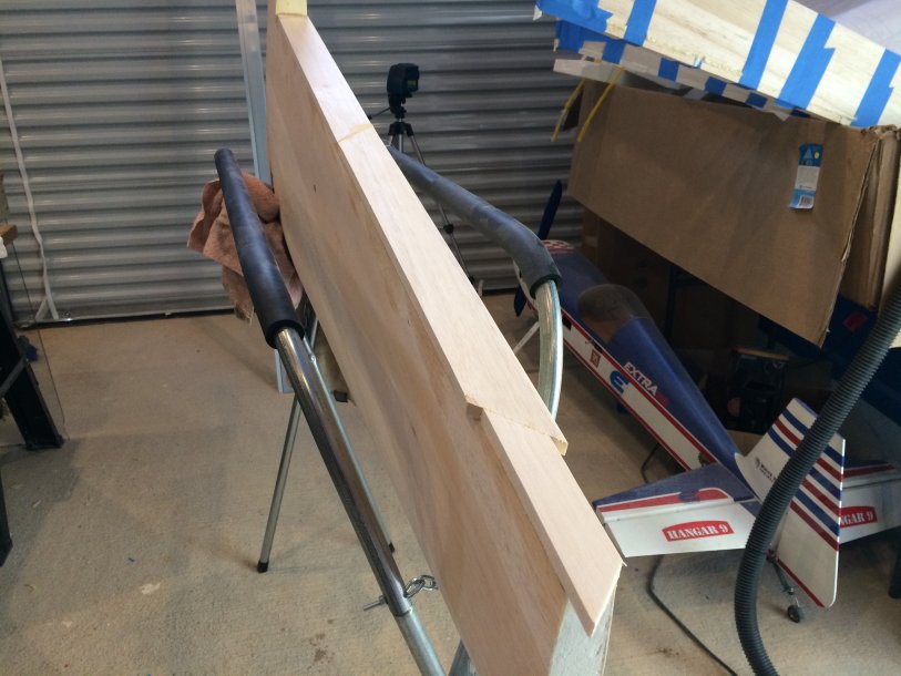

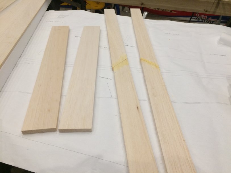

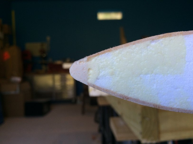

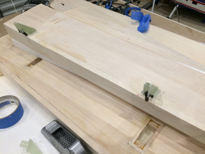

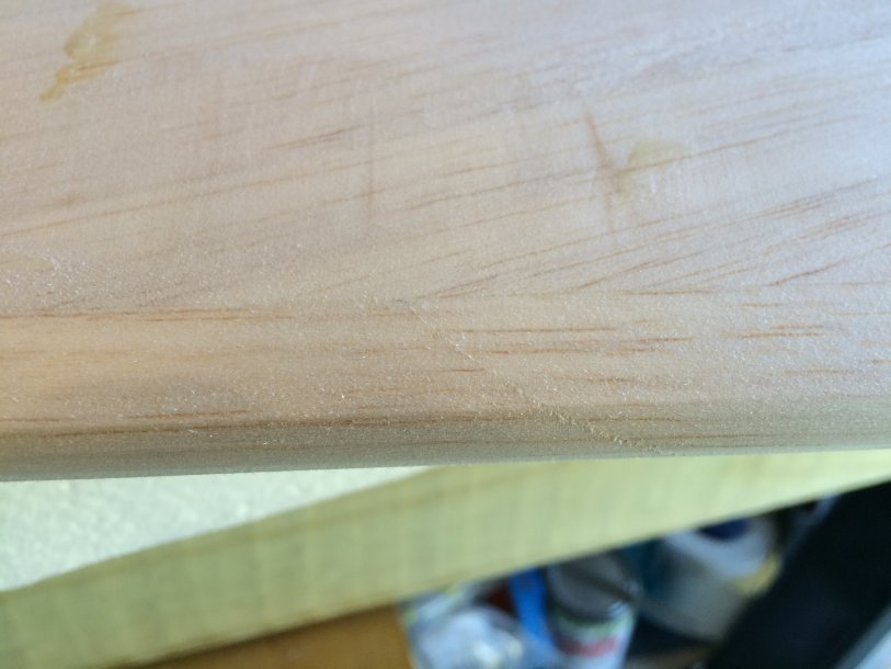

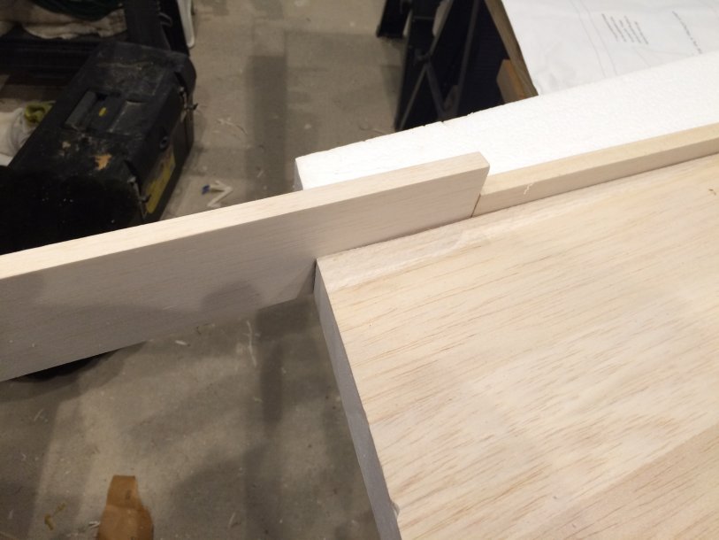

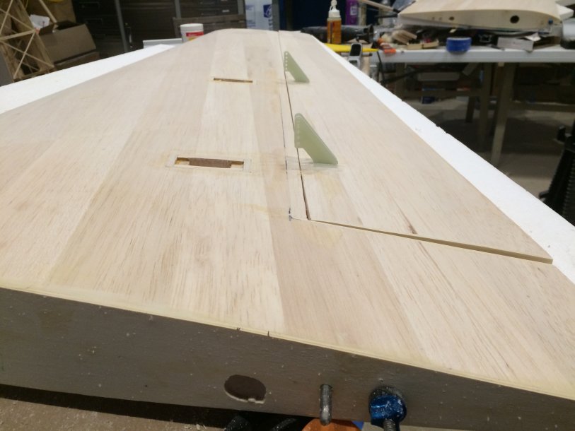

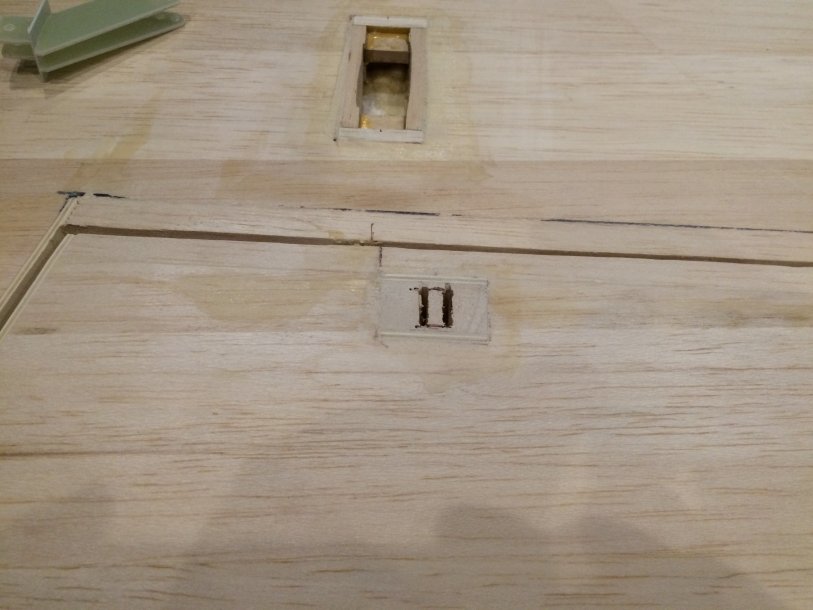

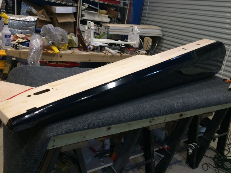

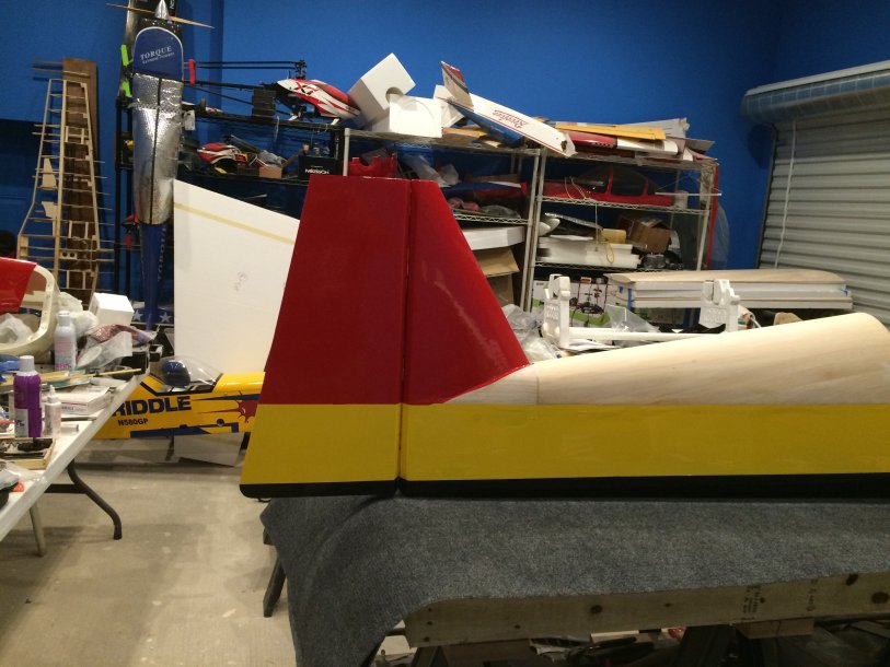

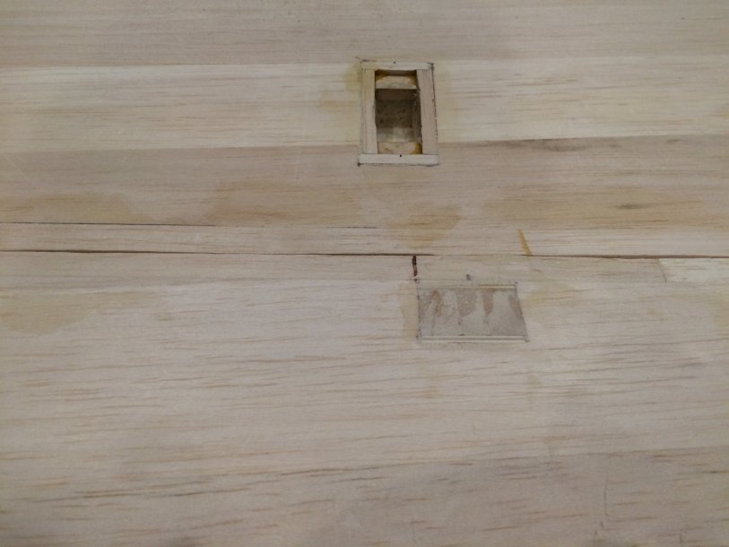

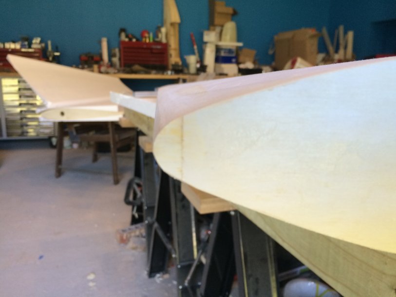

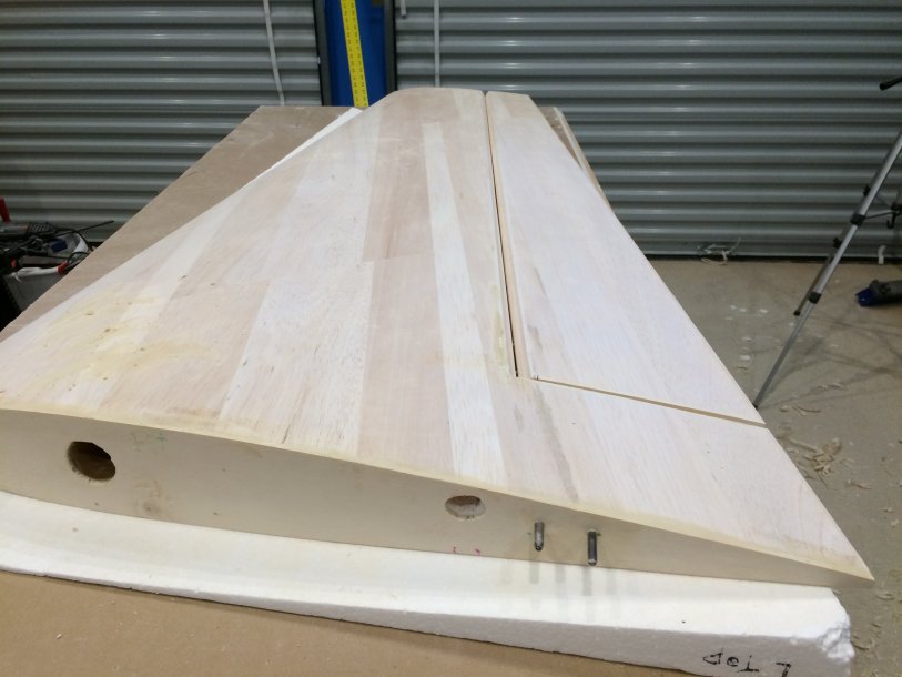

getting the prep work to cover the stabs/wings.
I am using aquanet hairspray to create a sheen on the balsa, then i will sand this down, til very smooth with fine sandpaper. then i will use a brush to remove as much dust as possible, then an air compressor, then a tack cloth. after this, i will then apply balsa-rite, then cover time.

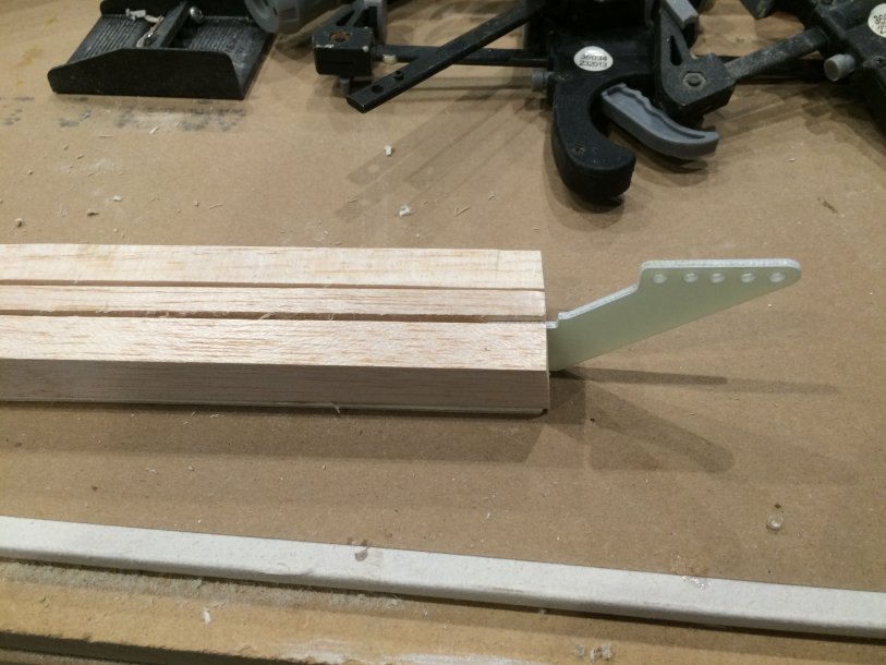

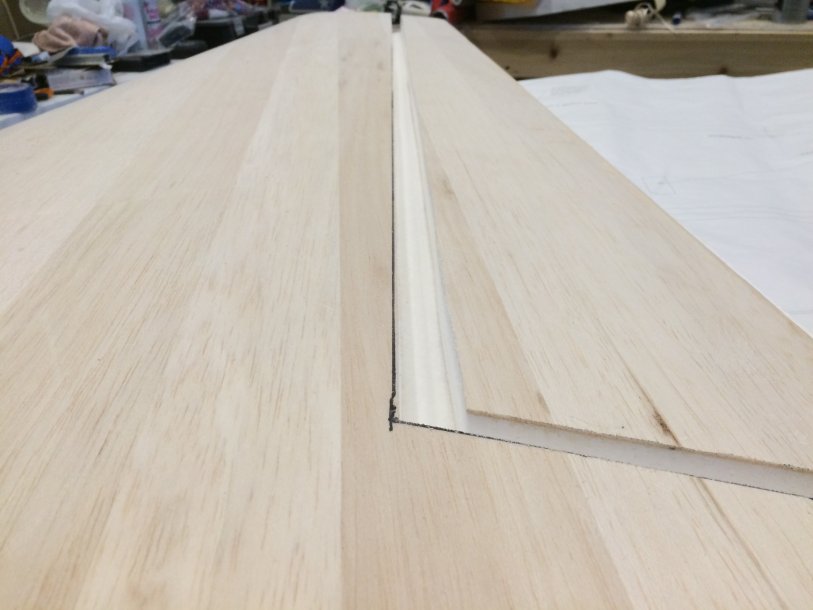

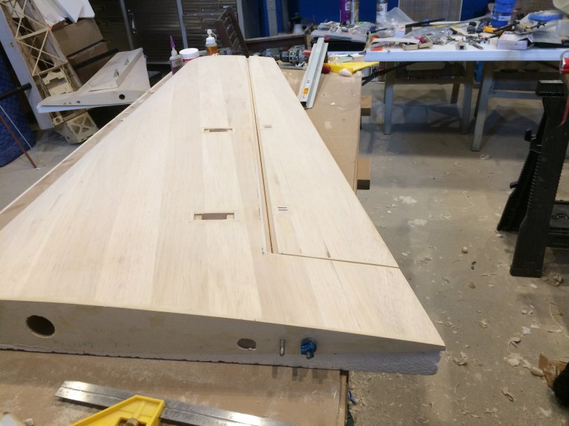

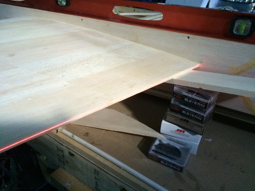

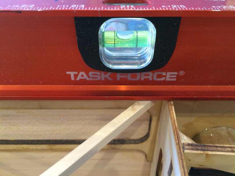

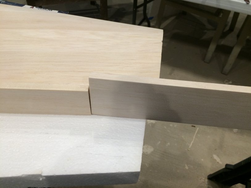

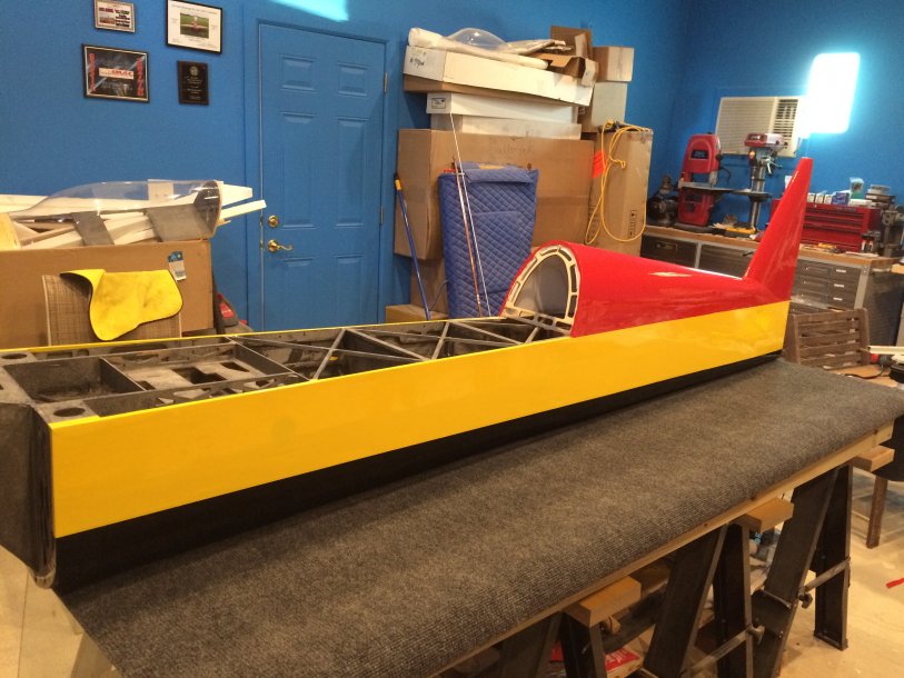

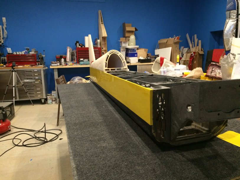

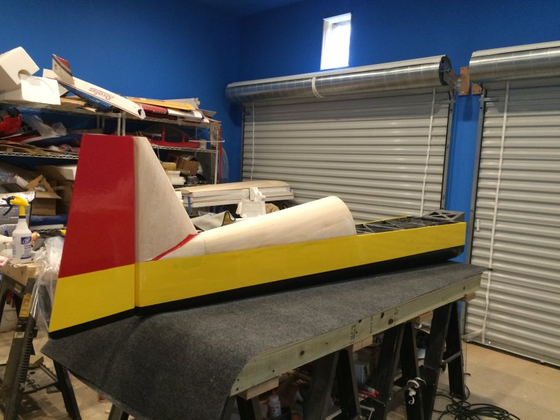

get you all up to date....
and now i am up to date with these pictures!!!

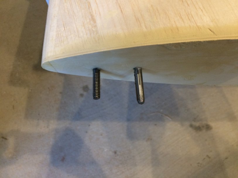

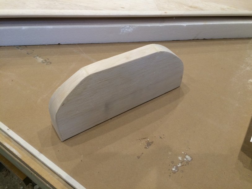

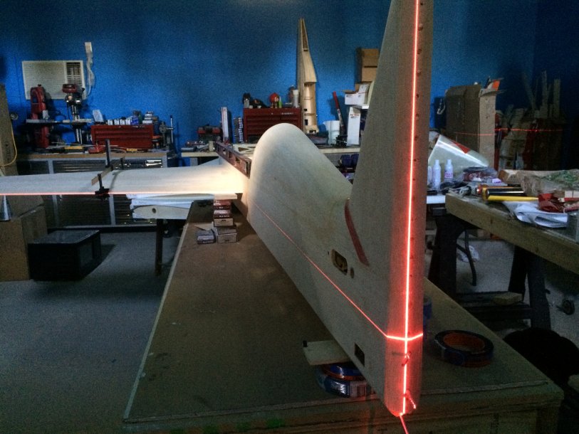

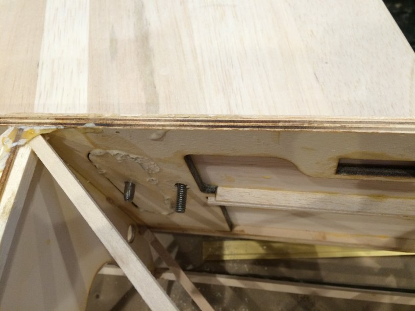

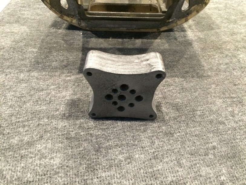

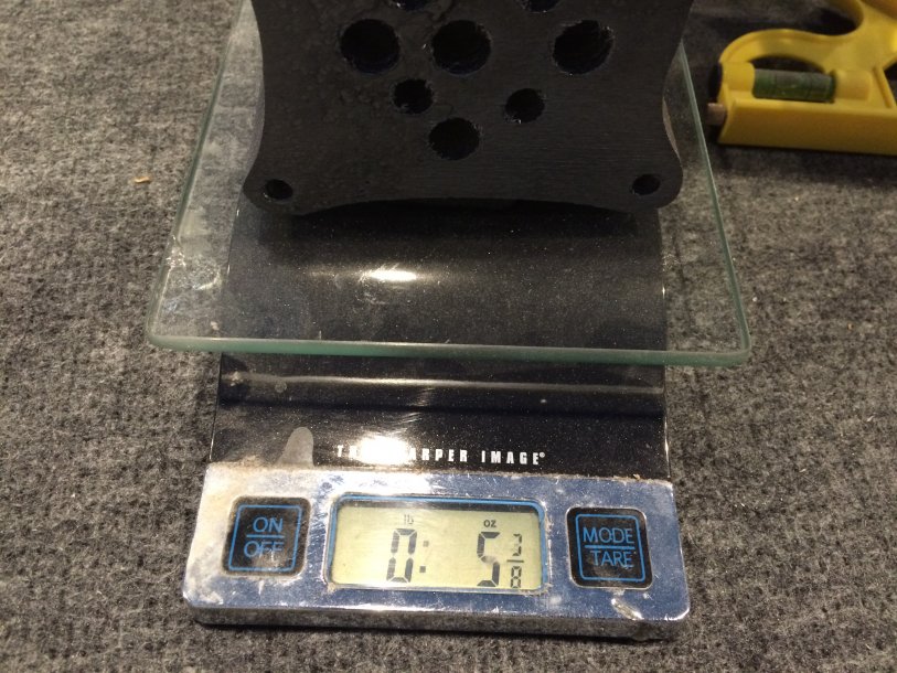

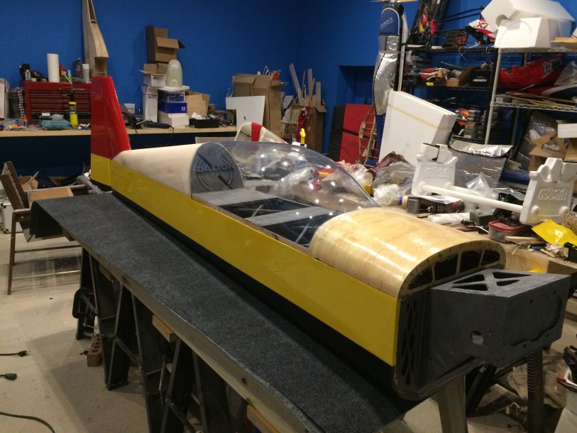

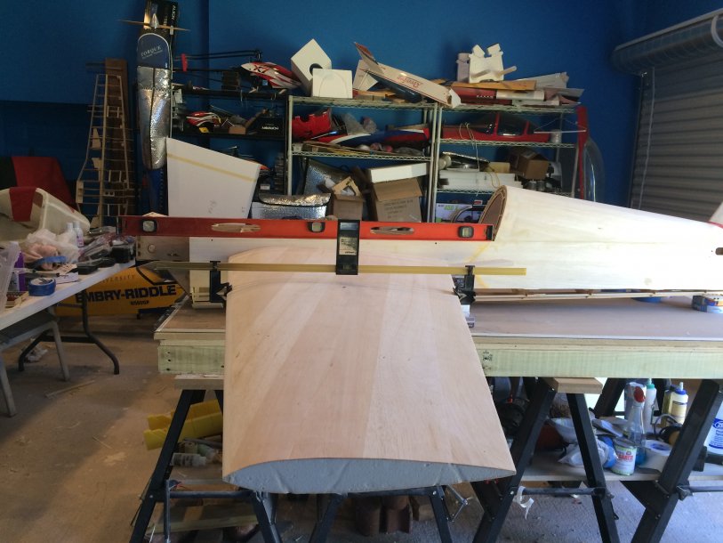

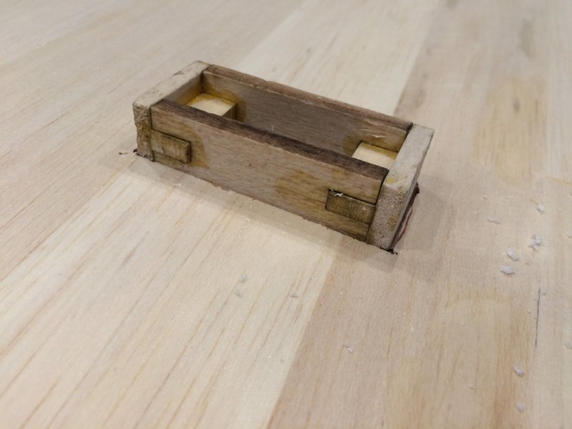

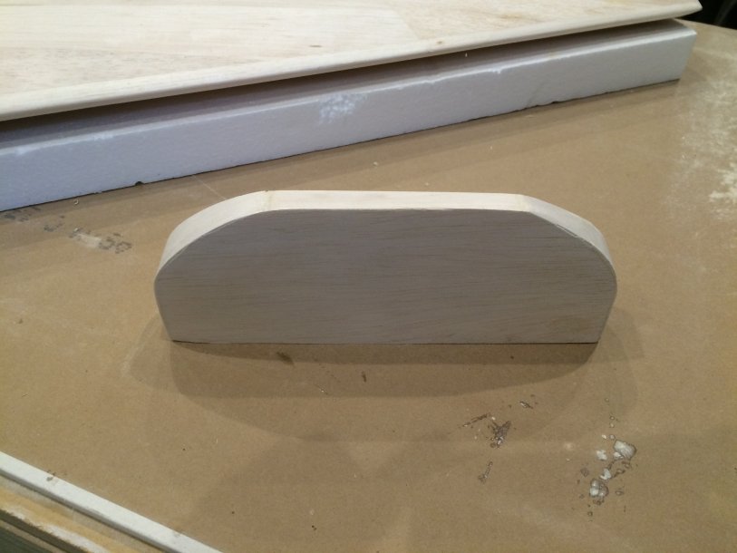

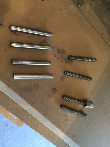

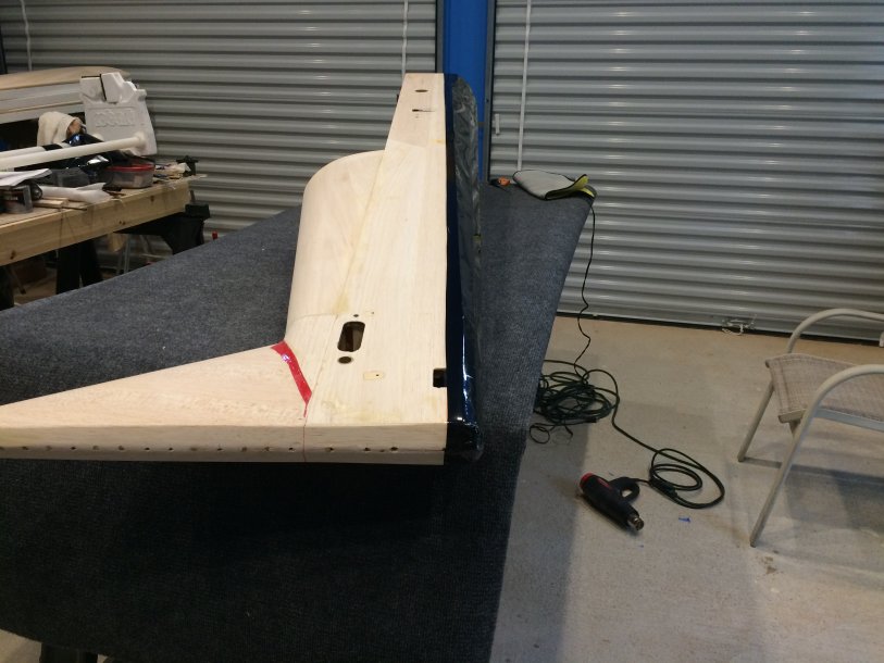

After i saw Sukhoi Kid's dalton that Tony built for him, i decided to go with the standoffs. this will save me over 4 ounces compared to the plywood block I had manufactured.

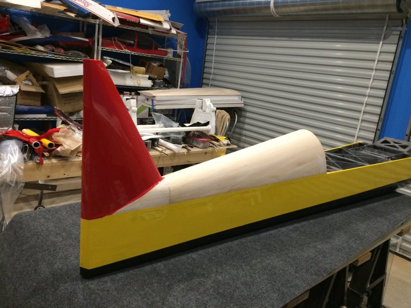

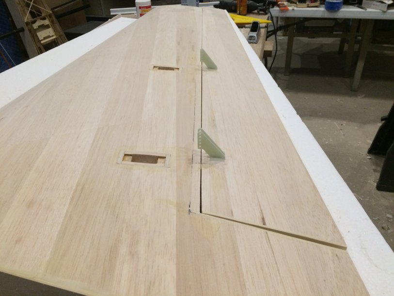

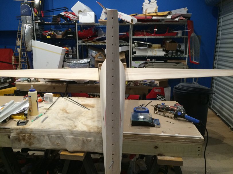

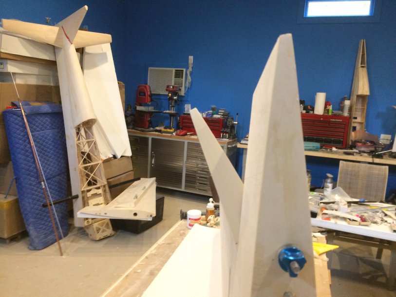

slow progress. maybe tomorrow morning, i will get to finish the elevators.
