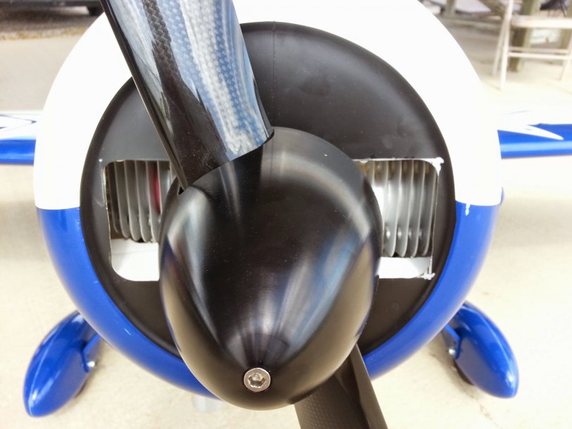

I used an EME70 on my 3dhs 91" Yak because it was narrower due to having angled plugs. I didn't think the DA70 would fit without cutting cowl relief holes on the plugs, but I was wrong. Went to a fly-in this summer and saw a 91" Yak there with a DA70 in it. Fit just fine. I do recommend cutting some extra holes in the cowl to allow for extra airflow. I originally didn't baffle mine, and had it overheat and shut down. I was also a tad lean, which didn't help. Since then I added telemetry, and baffled. And redid the baffling several times. Each got a bit better, but overall it was still running a bit hotter than I liked. After going to that fly-in and seeing how the other one with the DA70 was cut on the cowl I did the same to my cowl and dropped the temps about 20 degrees. Definitely worth doing. Just added extra air over the cylinder head.
Couldn't tell you what standoff length was required for the DA, with the EME I used the stock motor standoffs and they worked perfectly.
Here is a pic of the latest cuts on my cowl, the ovals to the sides of the main opening.

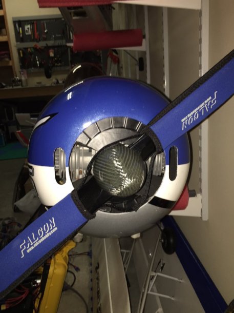

Nice. I was planning to close off the front of the cowl and baffle as well. I was going to just use some light ply and paint it but that cover looks nice, did you make that or buy it? I was going to do something like this from my yak in the avatar.
