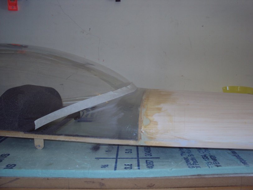

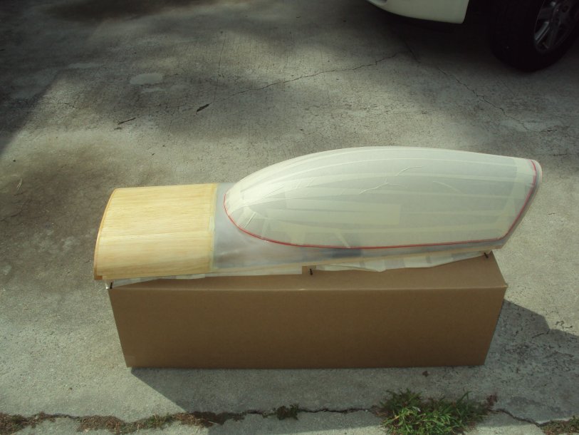

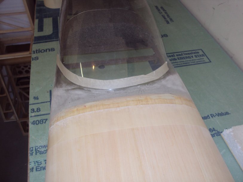

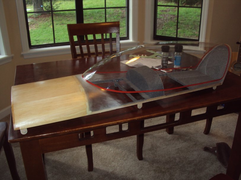

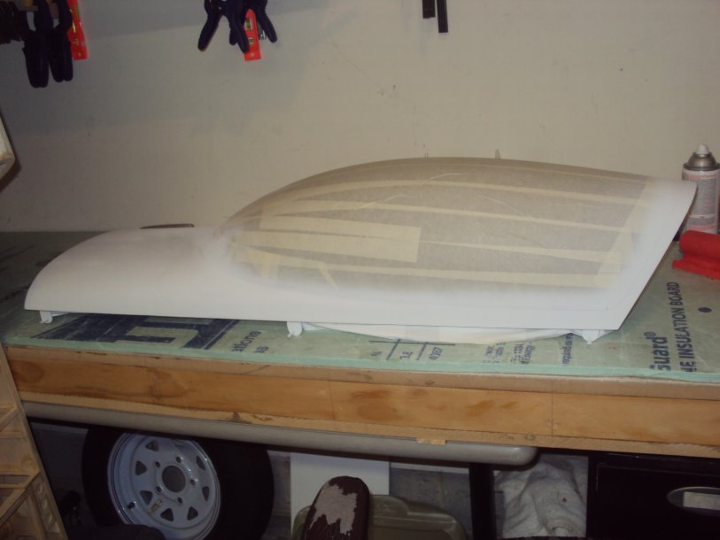

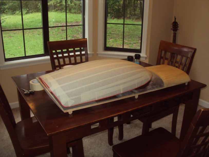

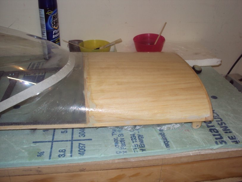

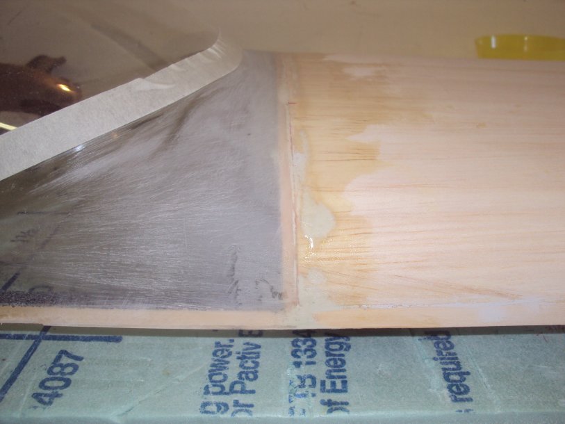

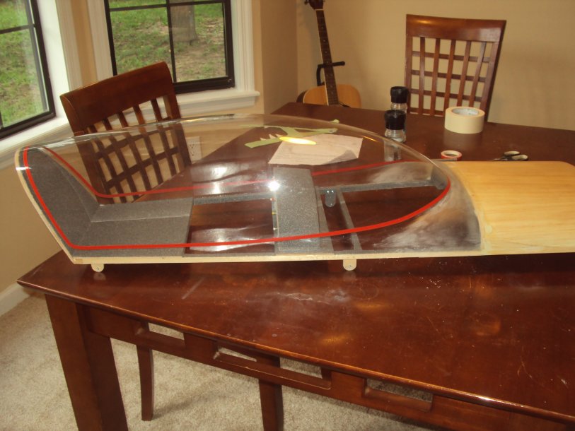

Kevin, thanks for the suggestion I was ahead of you by one day, but, what I did was this. I cut a strip from the .5oz cloth and laminated it on the balsa and the canopy, I let that dry overnight sanded it and then I installed more cloth over the front part of the hatch.

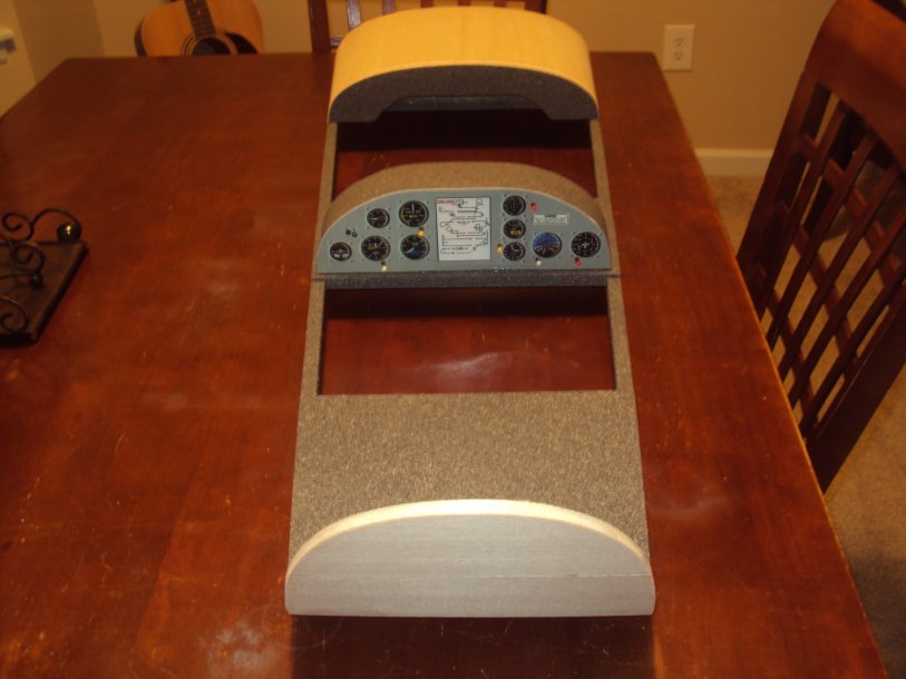

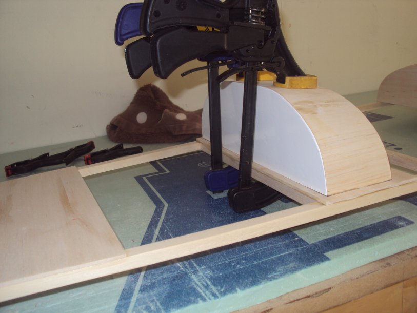

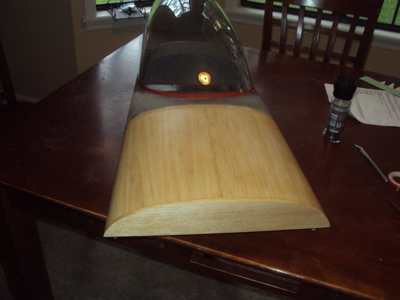

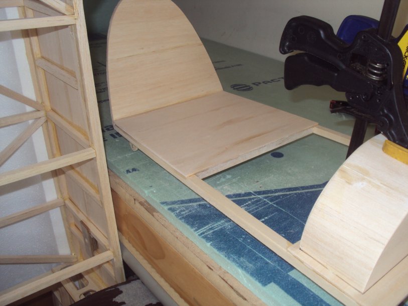

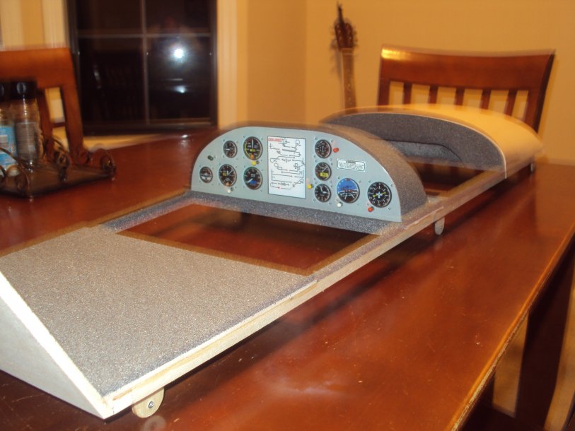

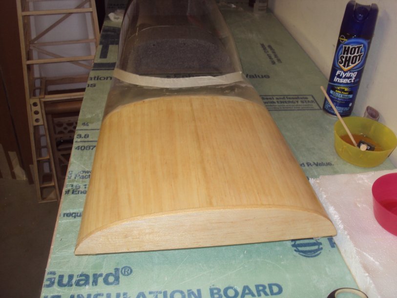

More pictures of the hatch, I forgot how much time this part of the build takes, I'm guessing about 30 plus hours.
