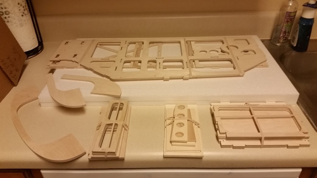

The KIT, The quality is AMAZING!!! Well packaged.

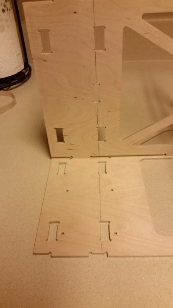

As you guys can see on the first picture, between Kevin Turner and Wayne, I was able to get the kit last Sunday, TAHNK YOU GUYS. That same night after Family night I put together the motor box in about ten minutes, just a dry run to see how it goes together. Like a glove.

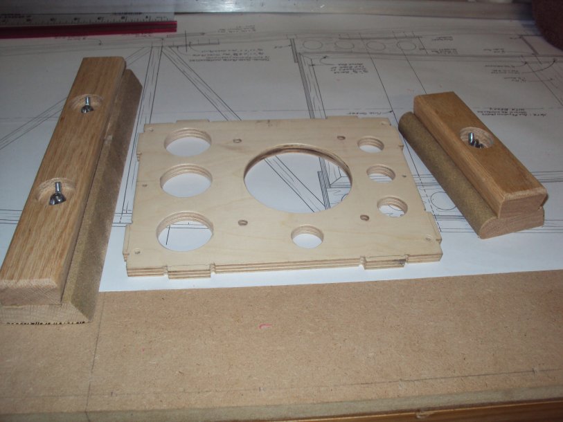

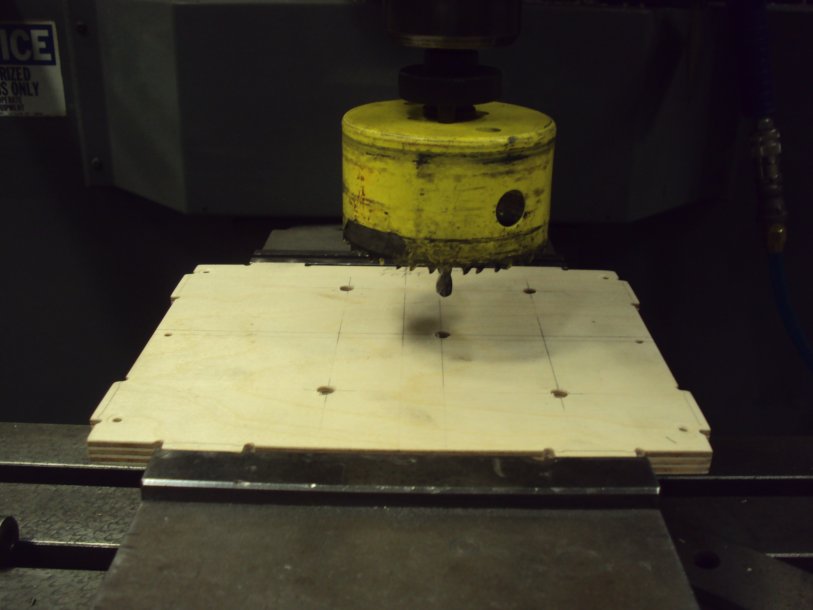

Before the gluing begins, I think is best to pre drill F1 to whichever engine you are using, in my case DA200, KS 95’s rear dump. So lots of reading and a few calls later I have started on it. OK ENOUGH READING RIGHT? Pictures please!!!!
ROLLERMAN

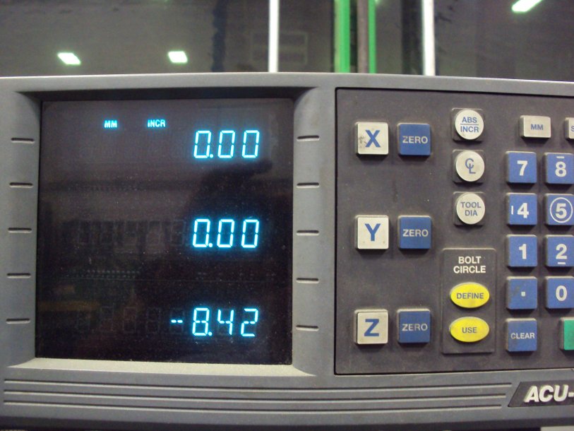

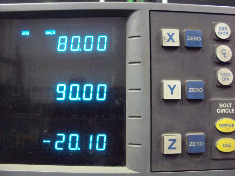

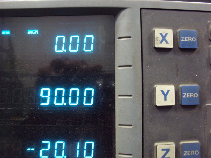

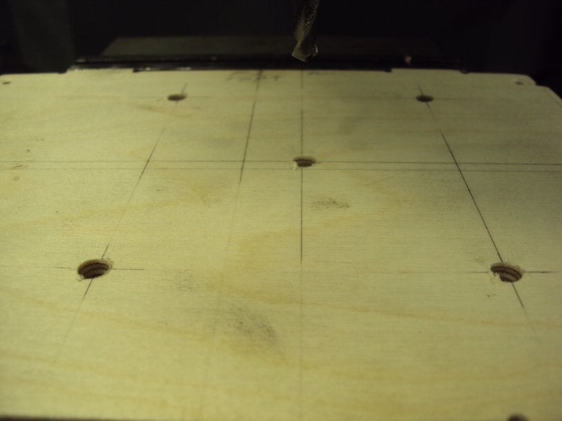

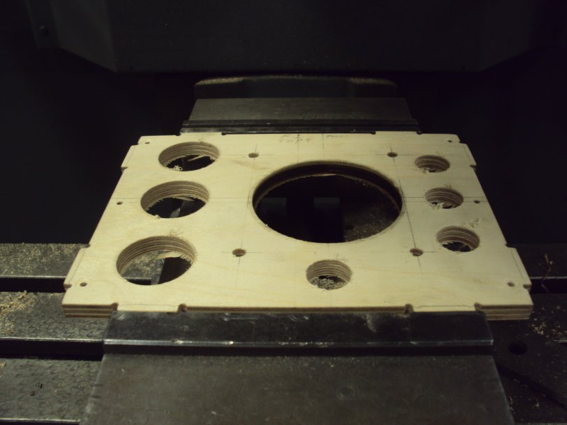

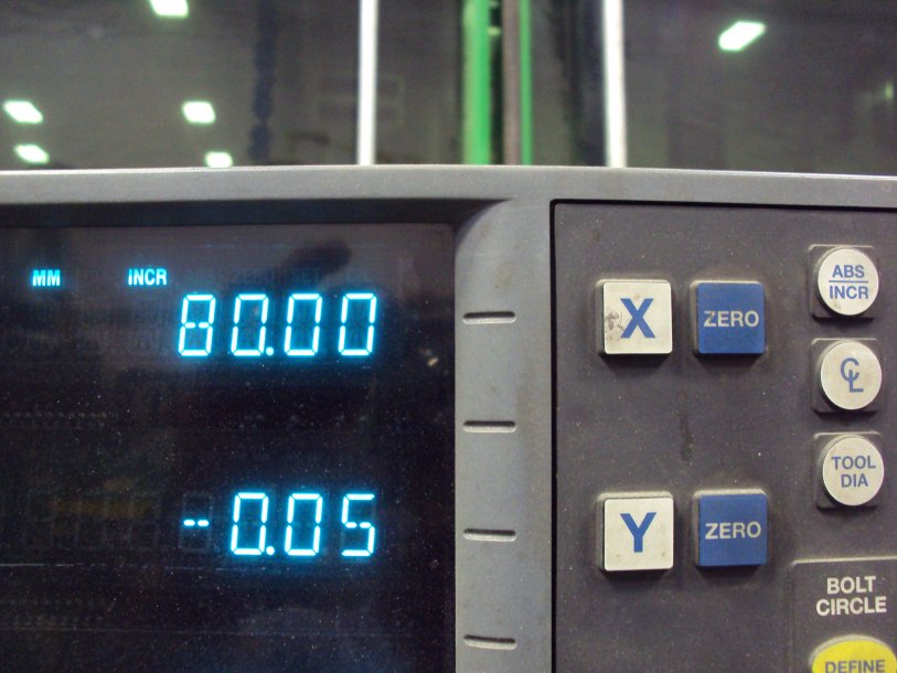

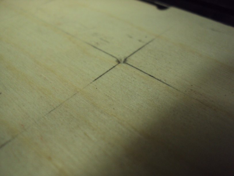

So before I started drilling and boring out holes to save weight, I call DA to verify the centering of the mounting holes, 80mm on the horizontal line and 90mm vertical, once I was done measuring 1000 times I made my first mark. Using a Bridgeport mill with a digital display made things easy. Once I found my first point I zero the X and Y axis, I then moved over 80mm, drilled, down 90mm back over to zero.

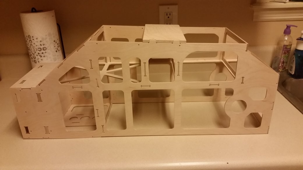

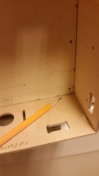

The next few pics are to show what all I’ve done so far, I should be able to start gluing the engine box tonight. Unless I go and play a round with Tiger Woods at Augusta National today. It is a MAD house. I live about 20 minutes from the course.
