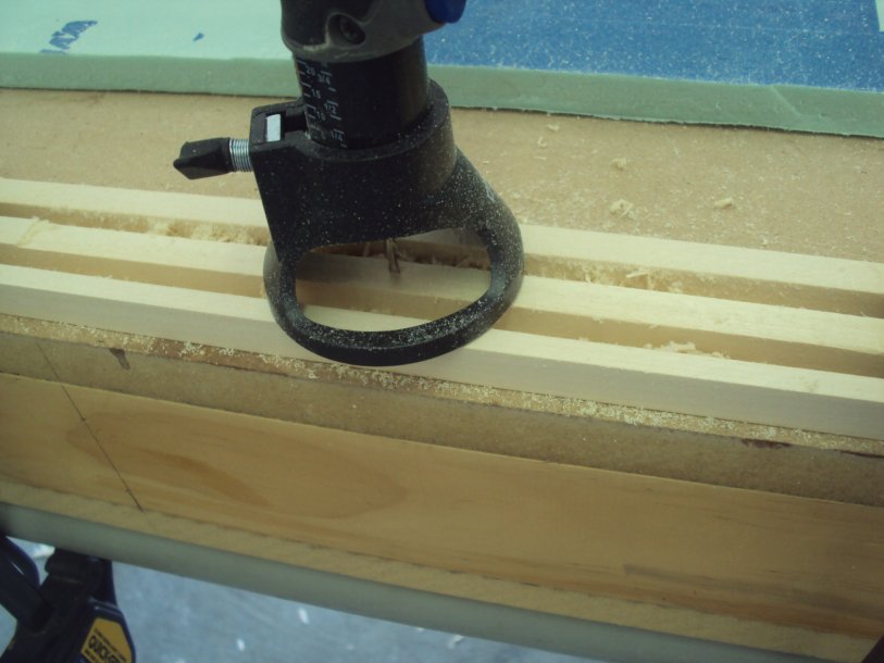

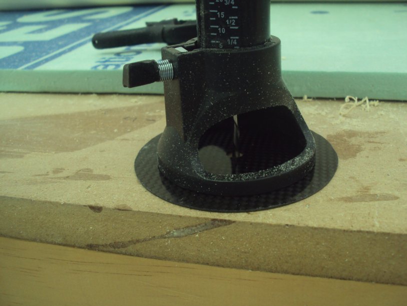

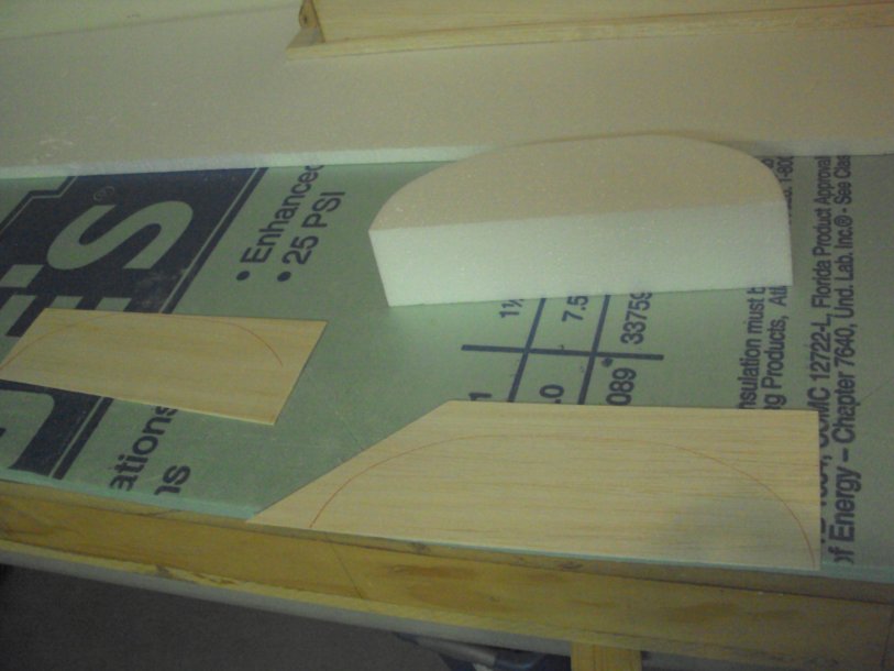

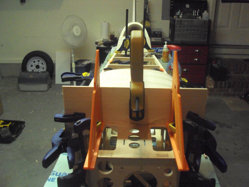

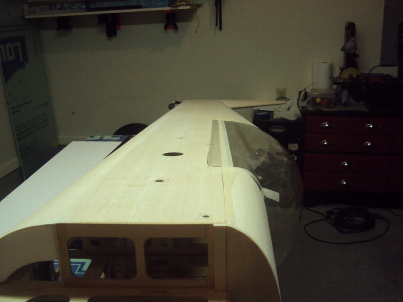

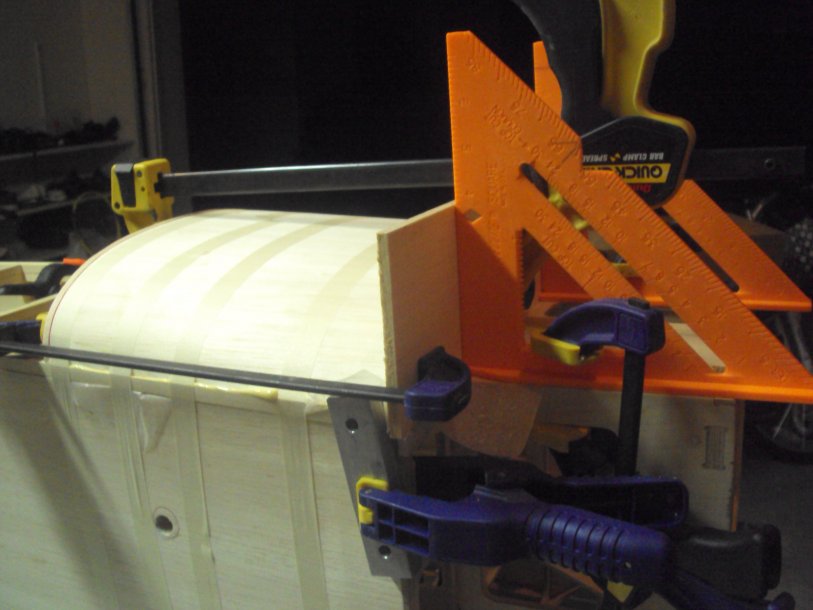

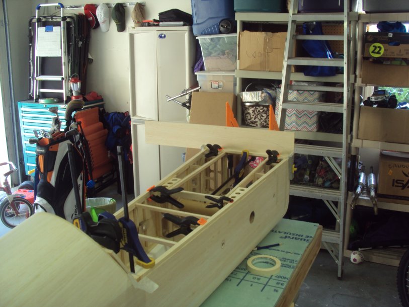

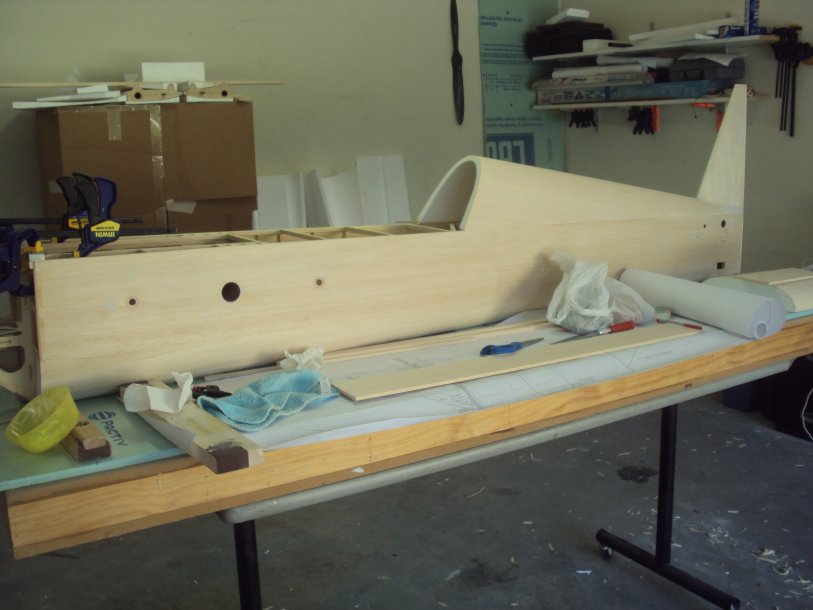

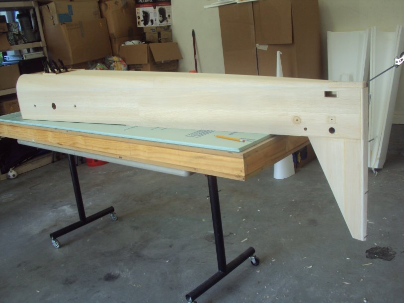

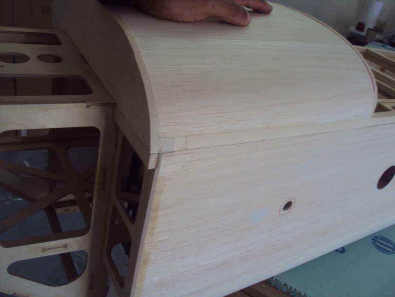

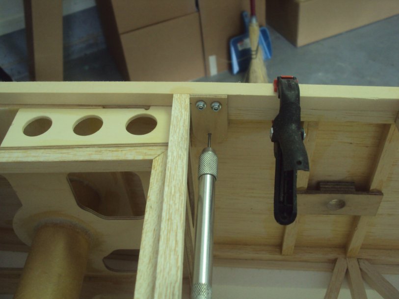

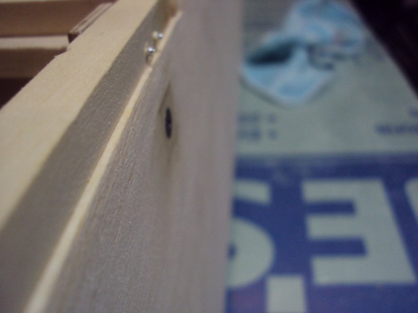

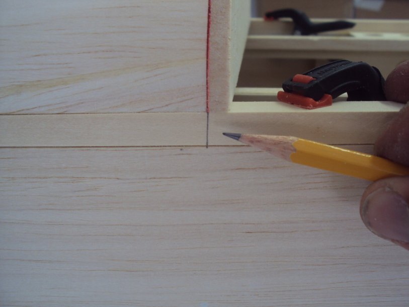

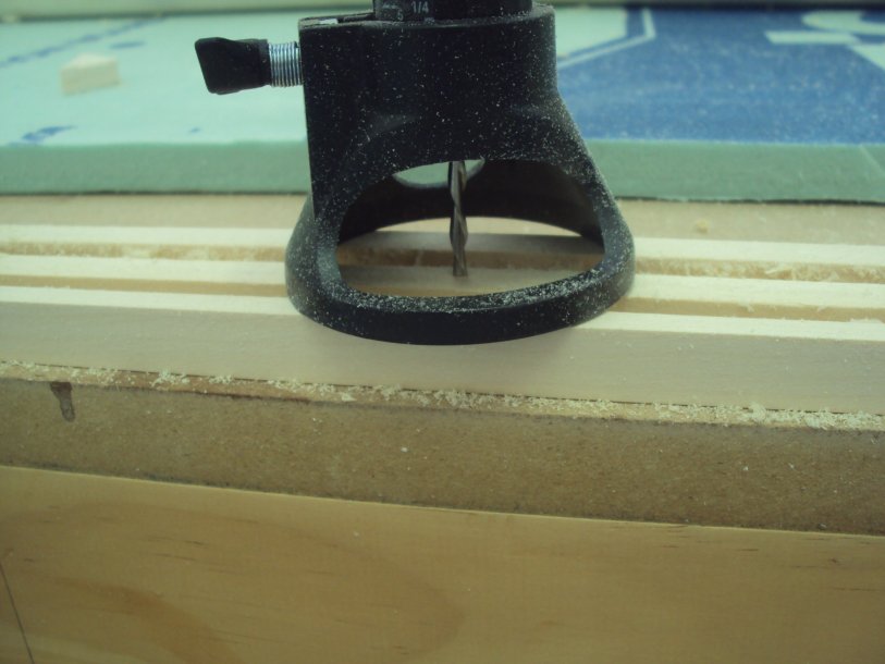

With the fin in place and the TE done it was time to start adding on the bottom decks and turtle deck. Sorry but I failed to take pictures of the process. After completing the decks I started on the hatch, THAT!! Is a ton of work. Gota have some kind of plan. On the 118 I built I caught hell adding the recess on the outside part of the frame after I had it all glue together, on this one, I used my Dremel to add the recess.

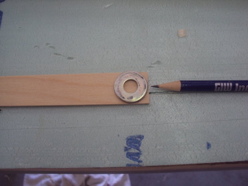

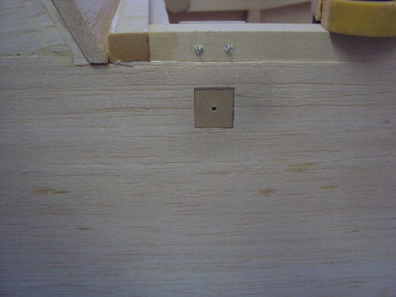

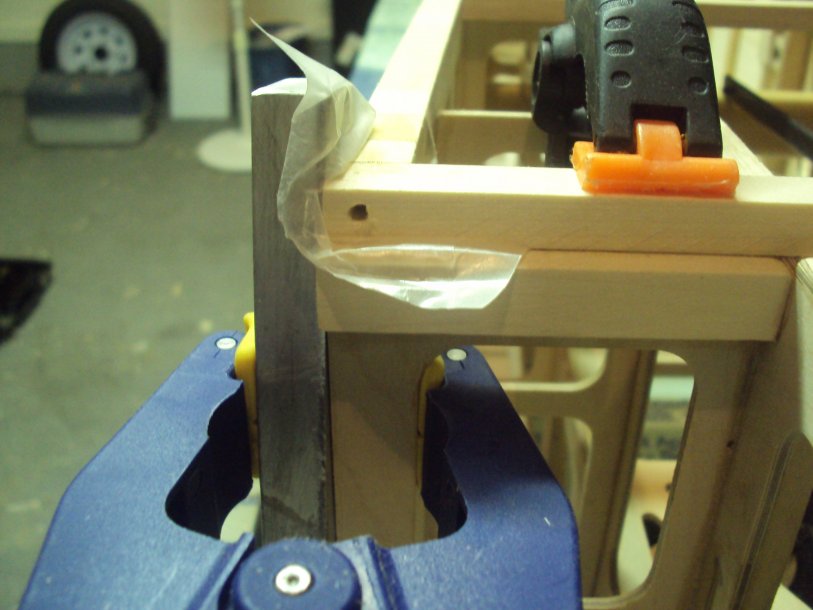

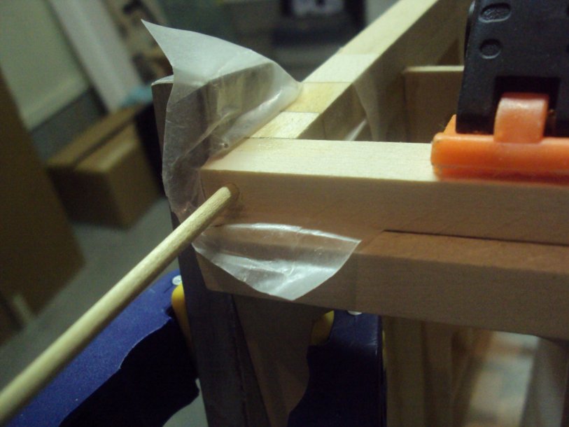

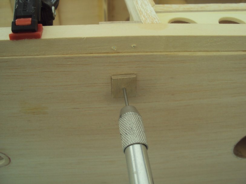

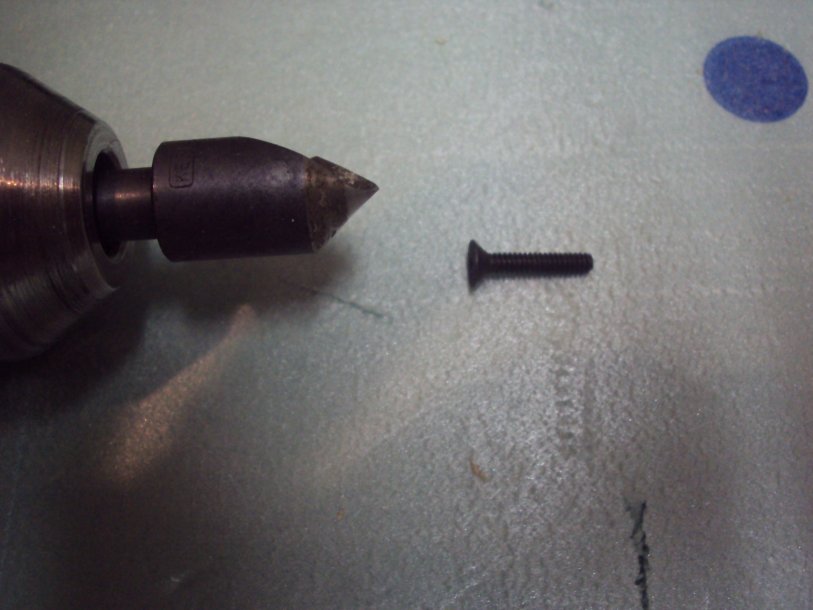

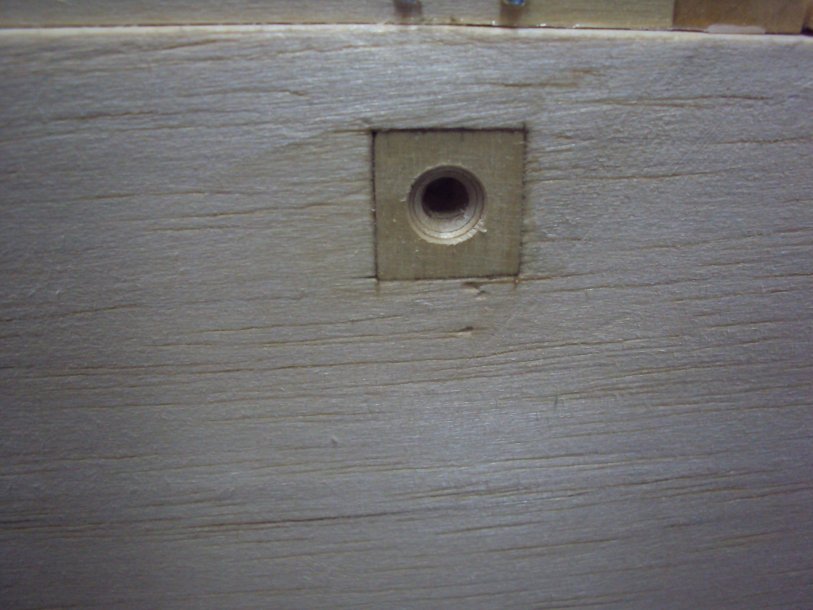

So, just as I did on the stabs, I added some hard points to the side of the fuse where the canopy screws are located.

I used the same set up on the 118 and I never had one come loose and that was without using any blue locktite. I do believe they hold better.

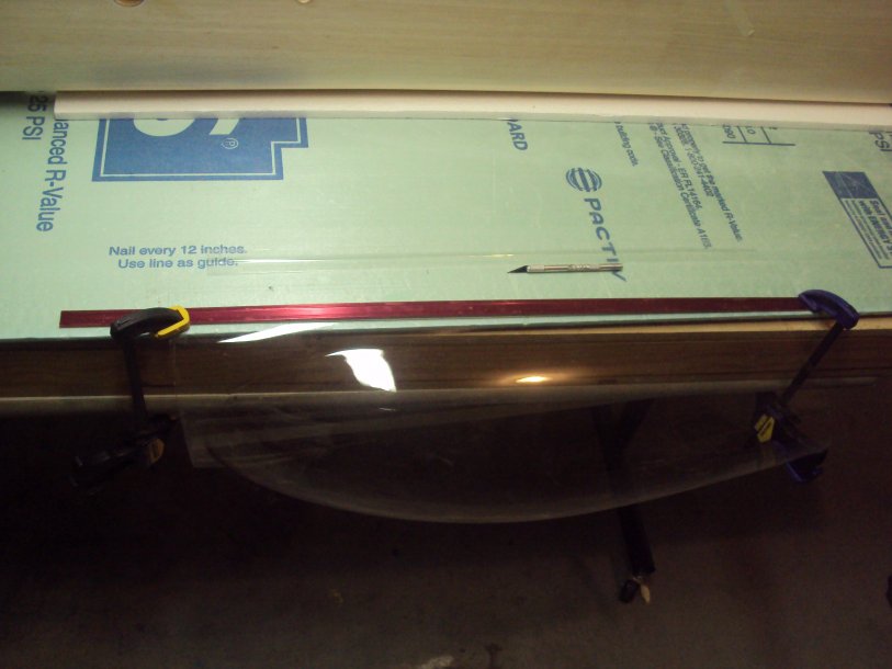

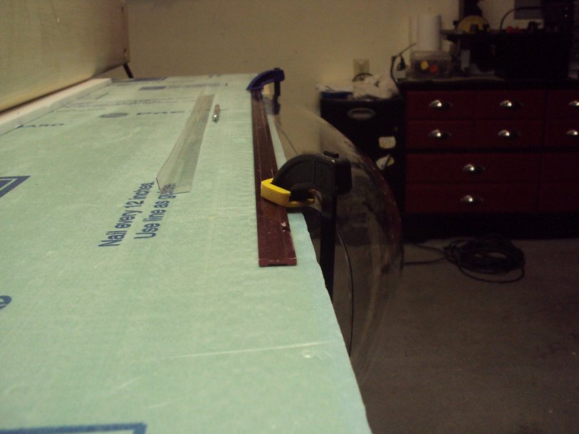

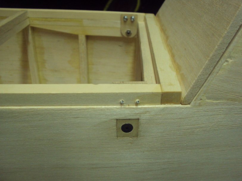

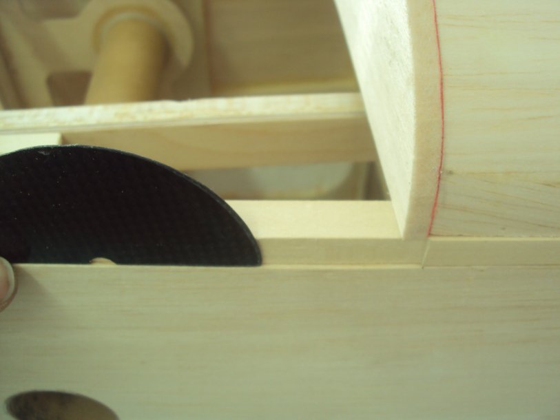

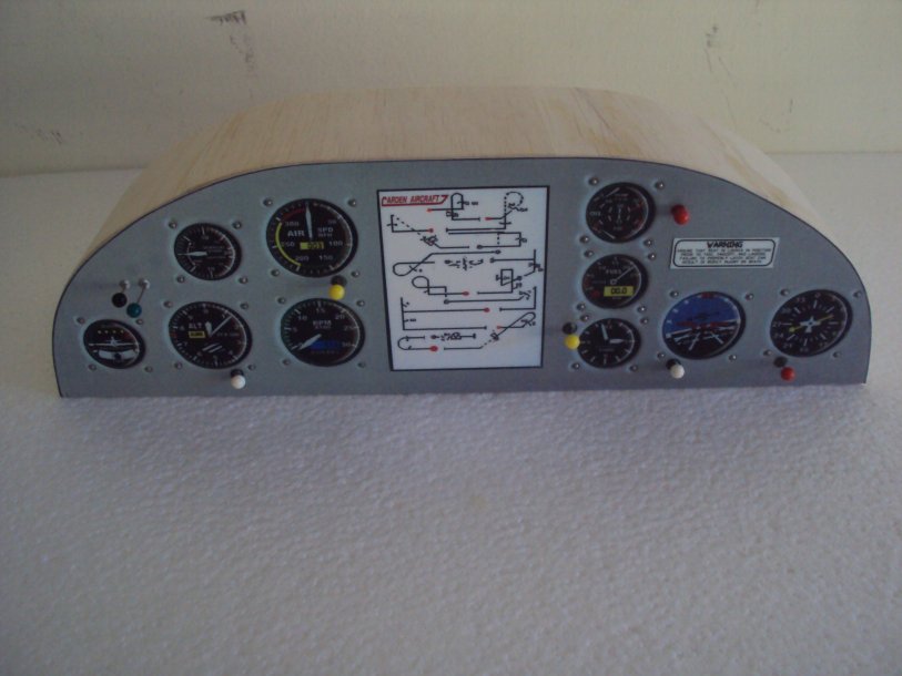

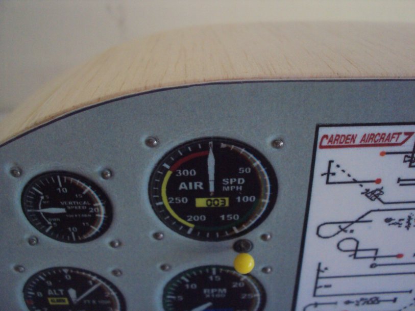

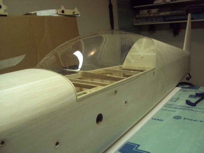

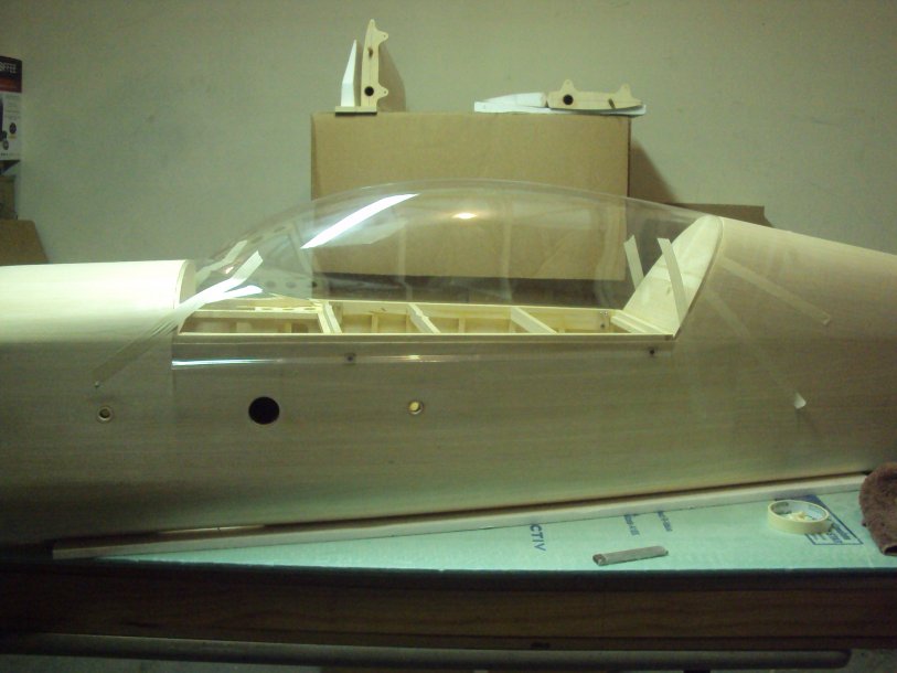

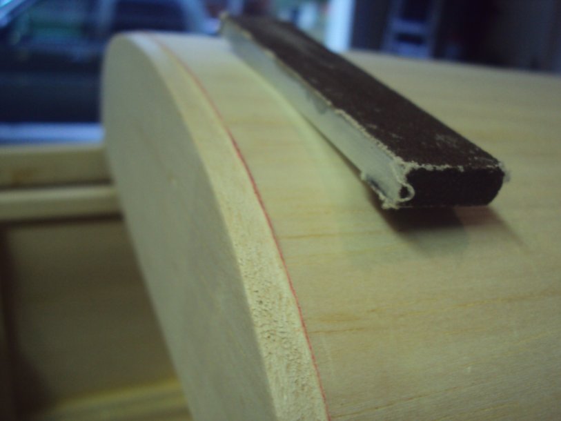

Now that I have the hatch frame completed, I can line up the canopy and trim it. I also worked on the dash panel, I added more detail to it, and this was fun to do.
