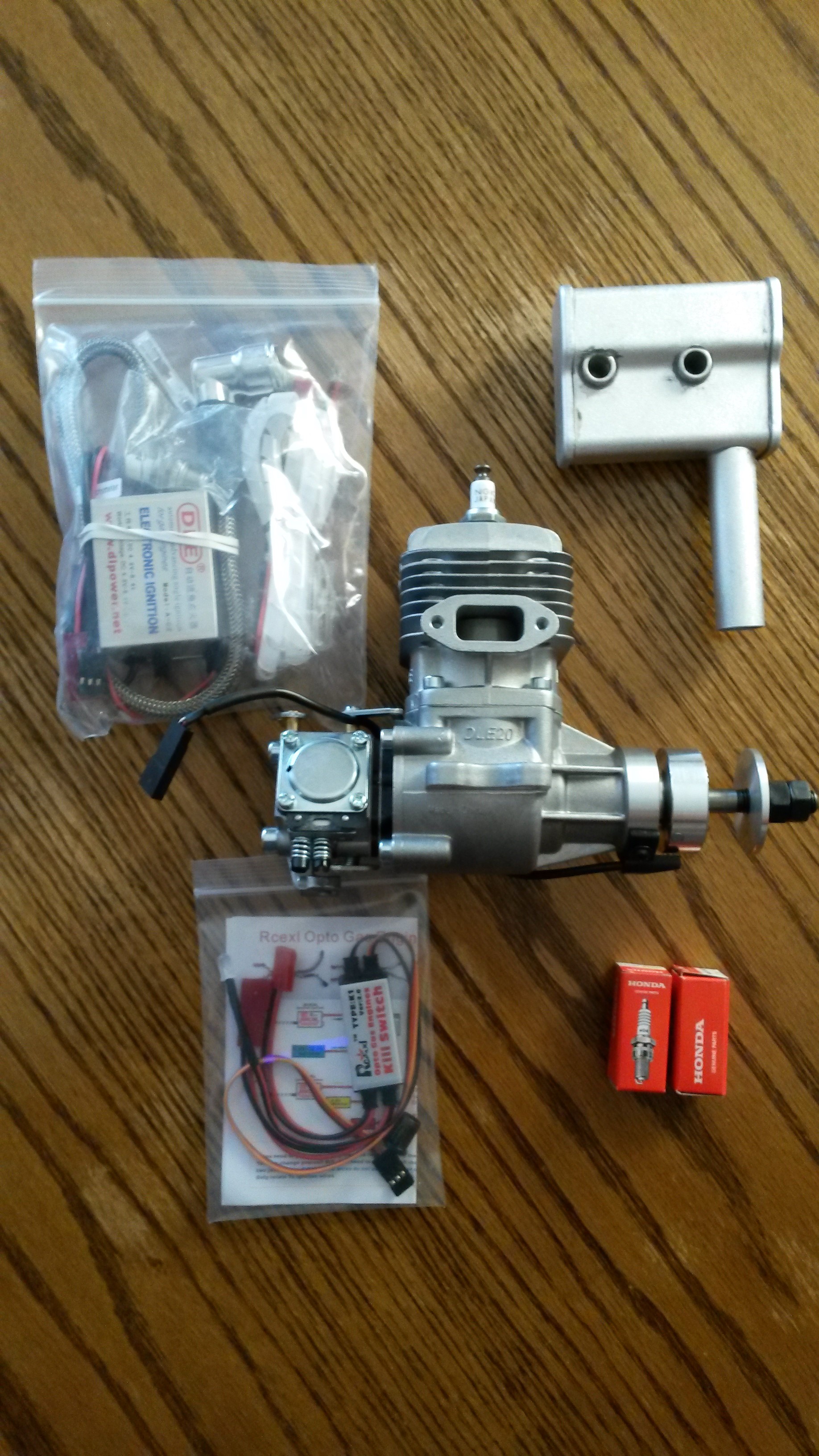

WORK WORK WORK has hindered progress some, but I got some goodies from Redwing:D and managed to get a little more done on the profile. I'm replacing the supplied DLE spark plug with Honda CM6's that I purchase at work.

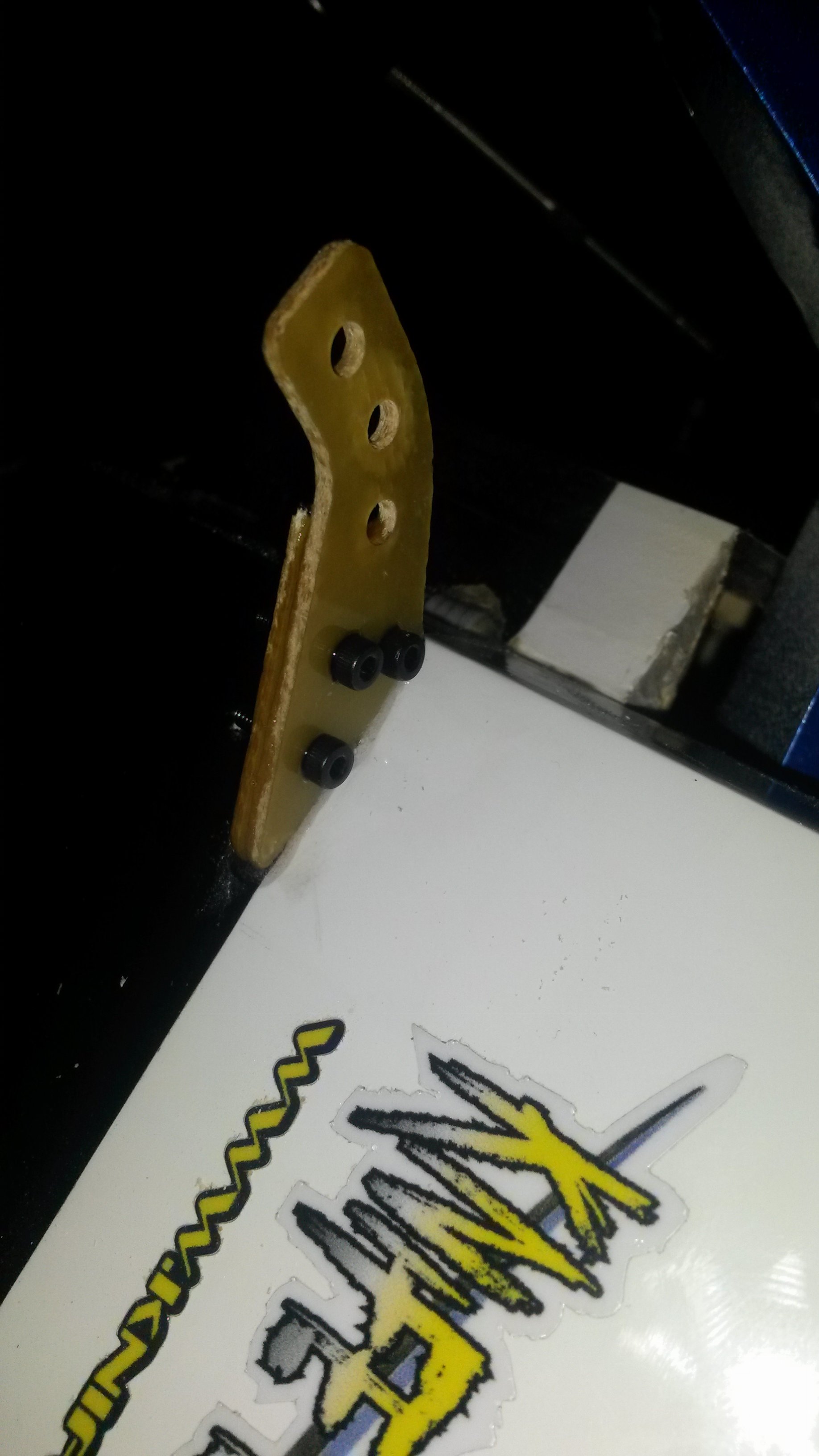

Here...the phenolic rudder control horn just snapped off during preliminary testing of the rudder(scratching head....hmmmm). Pic of the fast fix.

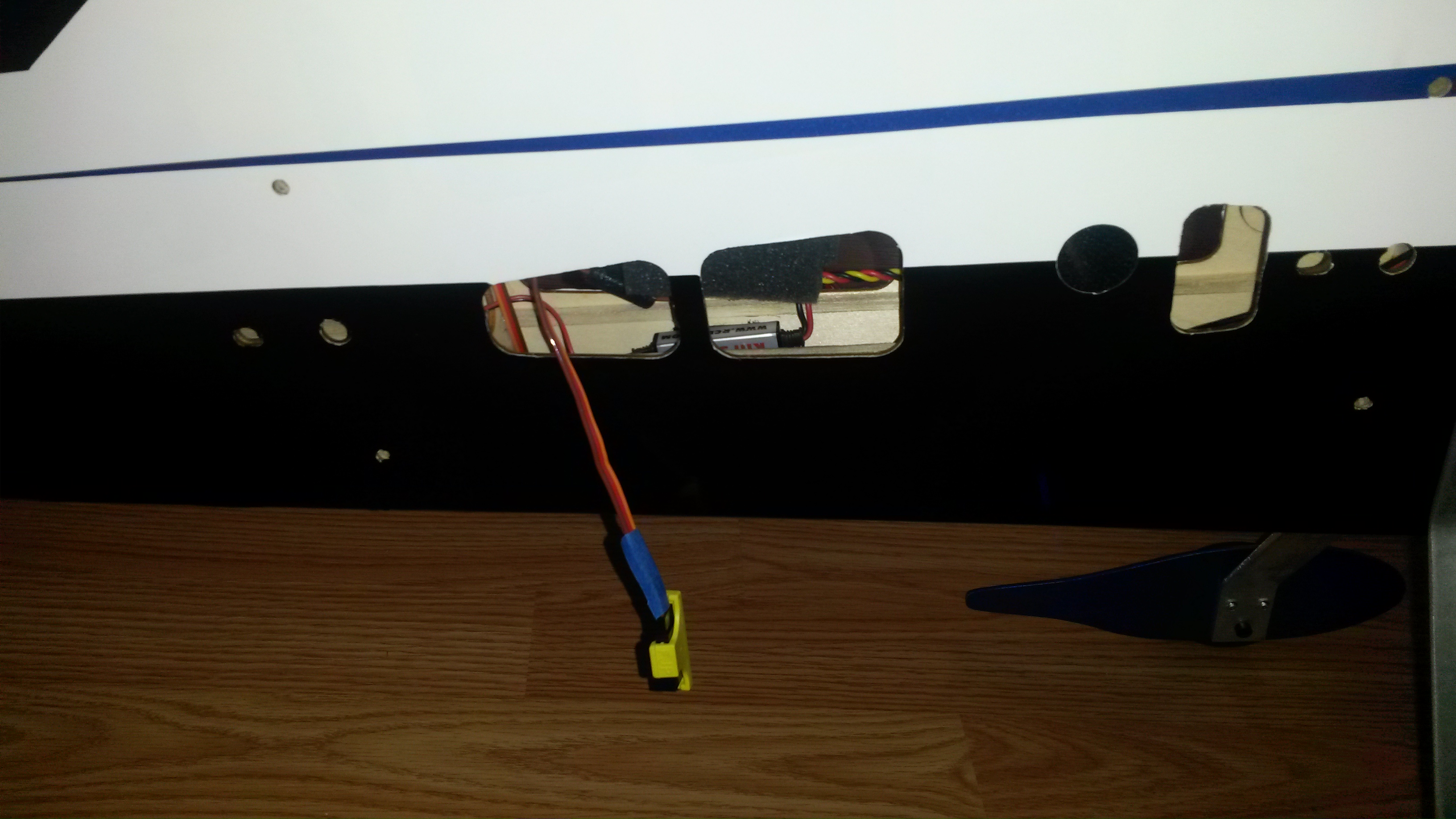

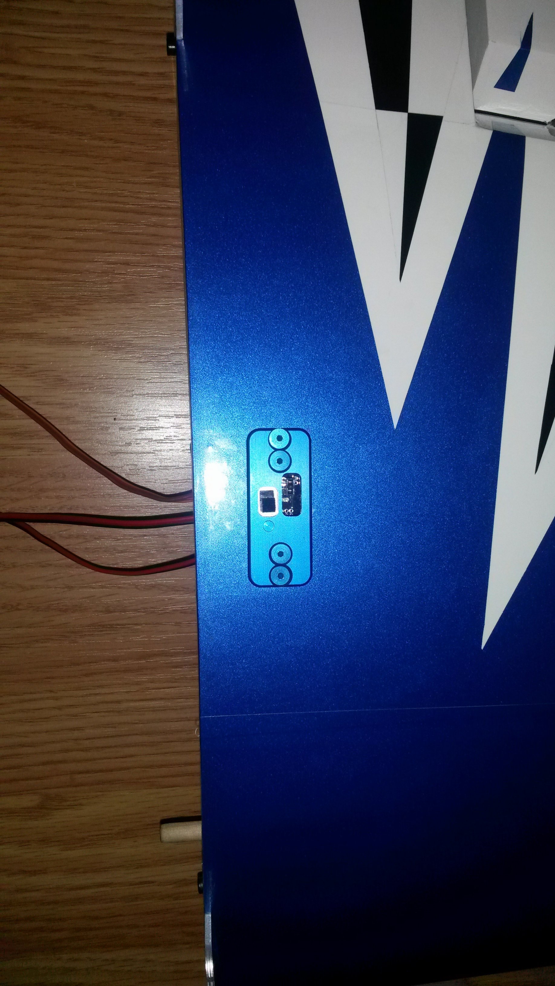

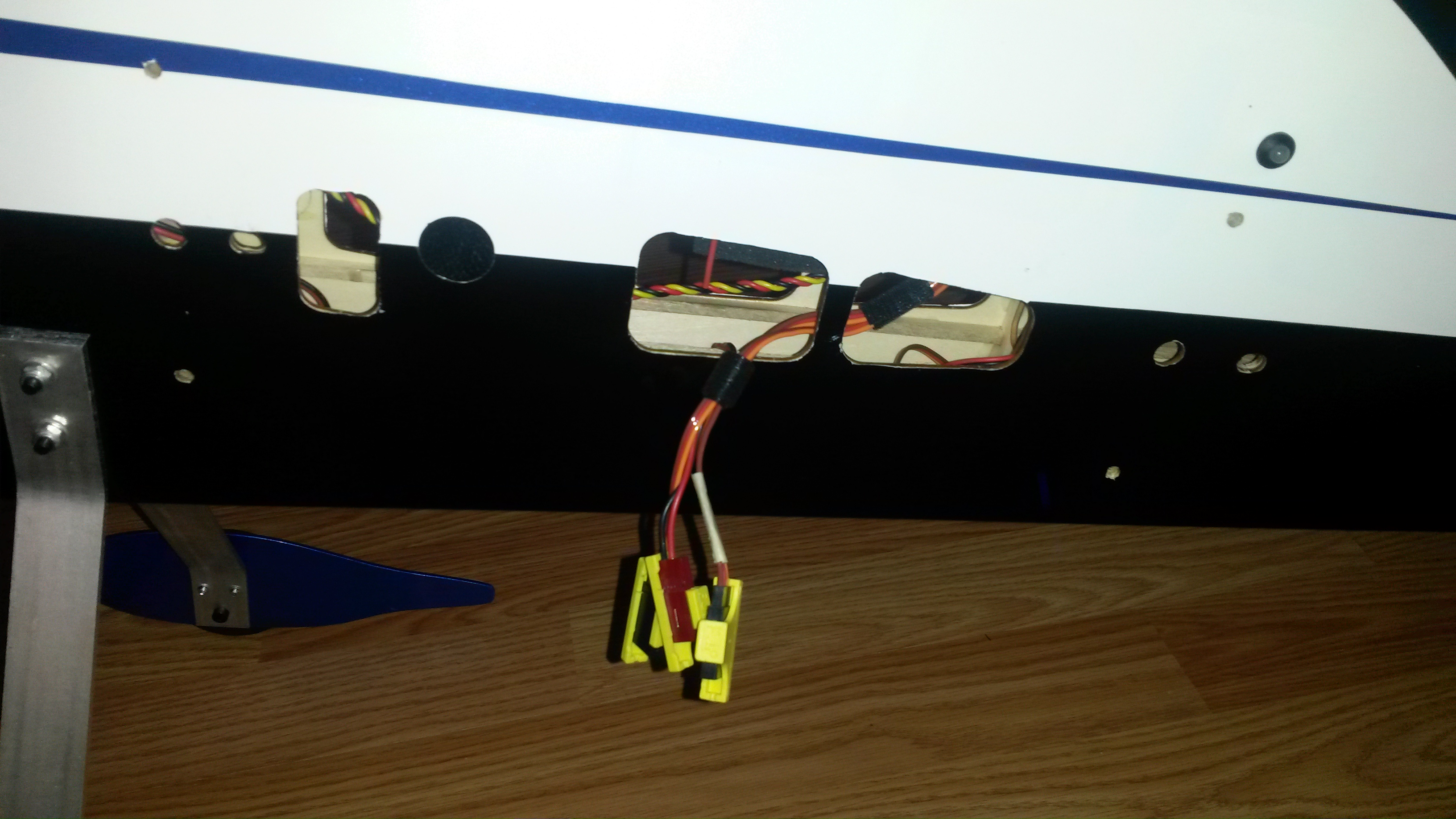

Here we got the installed Badger switch in the left wing, 3500mah battery(ignition and rx) is also in this wing.
Aileron and power quick connects from fuse to wings

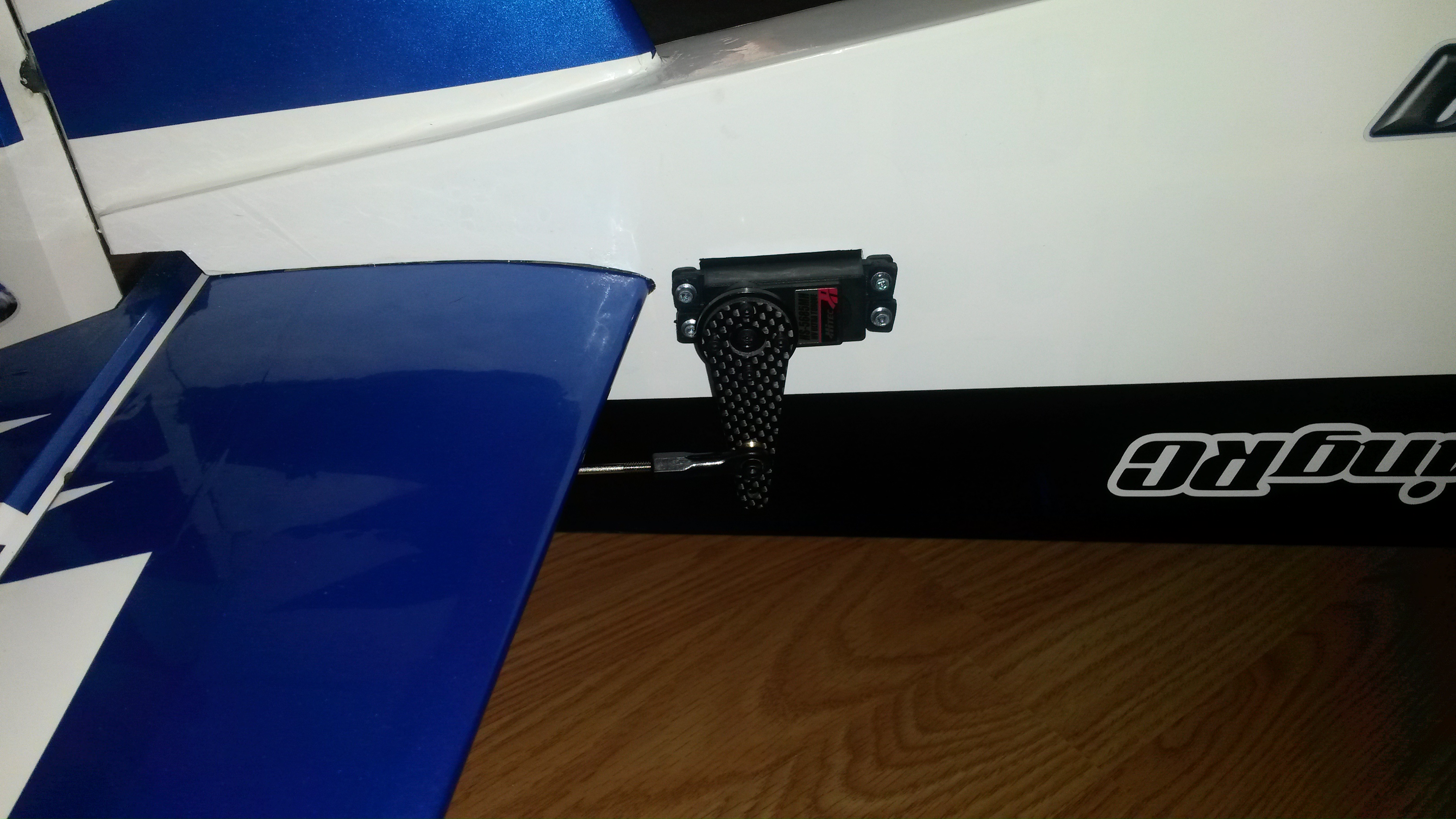

Hitec HS-5685MH high voltage servos all the way around with Redwing RC carbon arms and aluminum circle horns

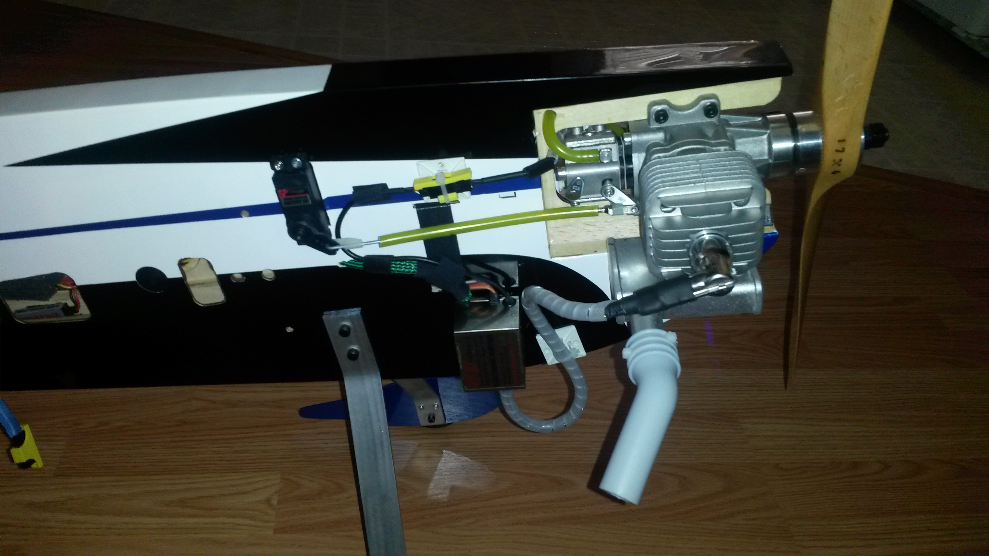

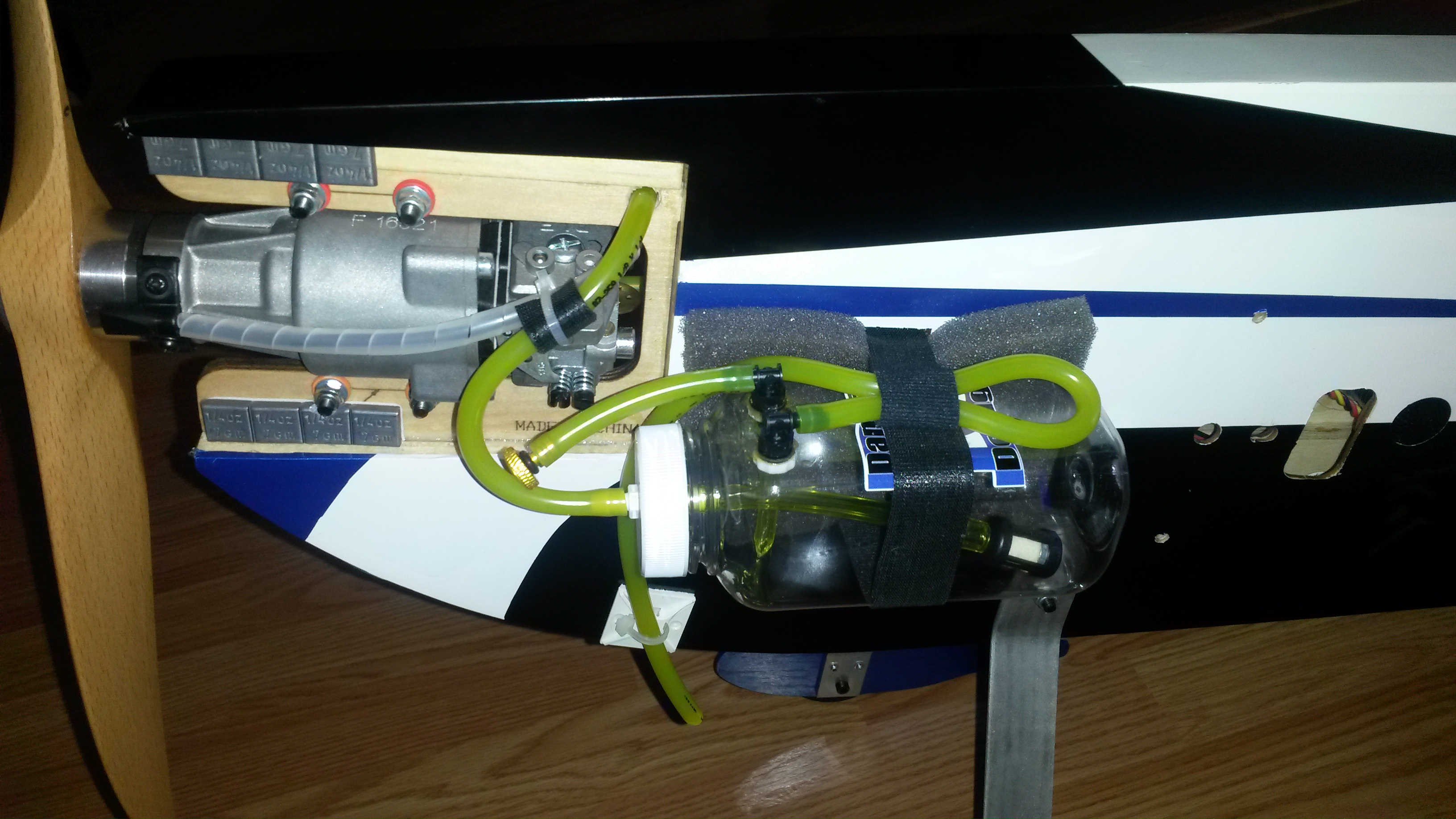

Engine, ignition and 4titude 8oz fuel tank mounted.
If you notice in the pics...It killed me to add some nose weight(dead weight) to achieve the approximate CG balance. I'm really hoping after a flight or 2 I feel the need to remove it!!
