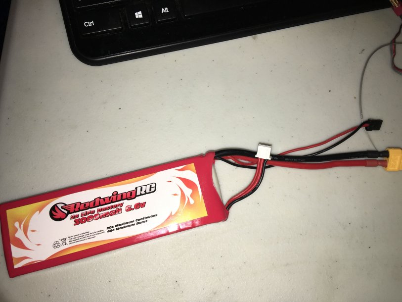

I'm awaiting my new radio and a few other things, like a servo arm and battery adapters. I decided not to go with the Powerboard. Going use this with these batteries. I have QX 4020's on everything else, including throttle.
