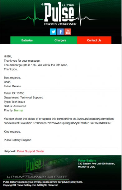

I contacted Pulse regarding the confusion about the discharge rate on their 2,550 mAh 2S lipo RX pack. One place it said 6C another said 15C. Their answer is that it is 15C, meaning that the pack is rated for a 38 amp continuous load. Most lipo can handle spikes of twice their nominal C rating, meaning spikes of 76 amps will not be an issue. With dual packs we are talking about 76 amps as the nominal full continuous load rating with spikes of 152 amps not being an issue.
