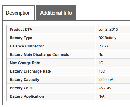

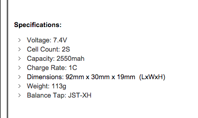

A lot of misinformation here, the specifications say 1C, the second tab "additional info" clearly says Max charge rate 1C, The Q&A says 5C not 6C but again not clear at all and that is why I have not tried them.

I still have my Pulse 5000 MAH batteries and still us them. The Thunder power was an experiment with a 25C rated battery. I have not noticed the same phenomenon with the TP batteries yet. The voltage drop is also less.
Attached is the Note in the first page
Note: This receiver battery is designed for 1C charge rate and a 6C discharge rate - do NOT exceed greater than 1C during the charging of this LiPo battery. Any charge rate greater than 1C / discharge rate greater than 6C will immediately void the warranty and very well may end up in pack destruction via fire. It is the end users responsibility to ensure proper safe charging practices, so please be aware of this.
When I first purchased these batteries last year I do not recall even seeing the 15C rating. Only the receiver 6C discharge rating. Thus my investigation into other batteries. I have an email from Buddy RC for the Glacier receiver packs and they are rated for 5C discharge.
Judge
It would be very strange to see a lipo with a 6C discharge rating. 15C for a RX pack is pretty standard. Regardless, with a 2 pack set up at 6C loading I can still handle 30 amps total. On my 50cc plane that is not a likely scenario. If I was using Pulse packs in a larger plane I would use larger packs.
If you went with dual 5,000 mAh packs in a 40% even at 6C you're looking at a 60 amp load before getting any real voltage depression. That would work for me.
