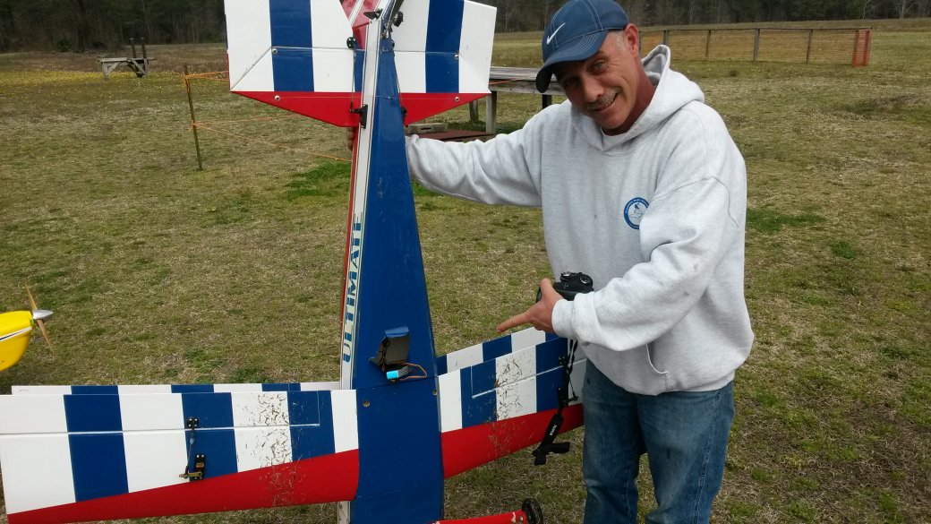

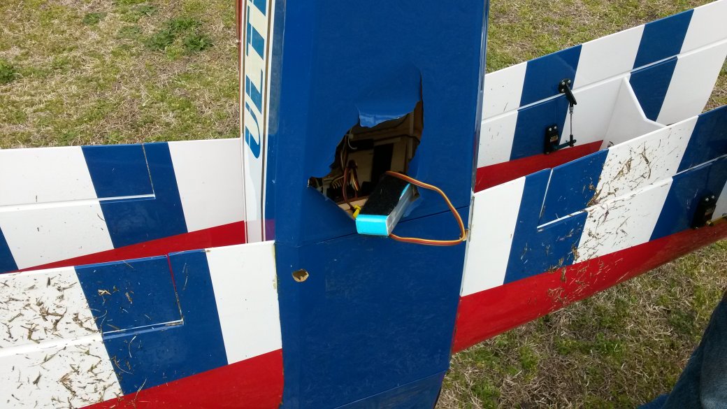

Ben I don't use foam on my batteries, just velcro them in and strap, again STRAP them down. I've not only heard horror stories of folks ejecting batteries, it happened to me not to long ago
Bbcorvette18
I have a small foam pad velcro'd to fuse then I velcro the batt to the foam pad and then run two velcro straps. Probably overkill for the little batts I run. Especially since I forgot to strap them in one flight and they didn't move. But better safe then sorry. Saw a guy eject 2 6s 5000mah packs a couple months ago.
