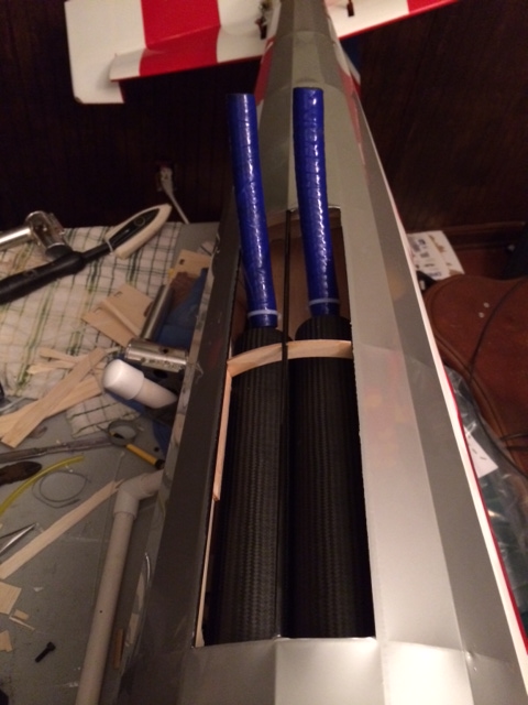

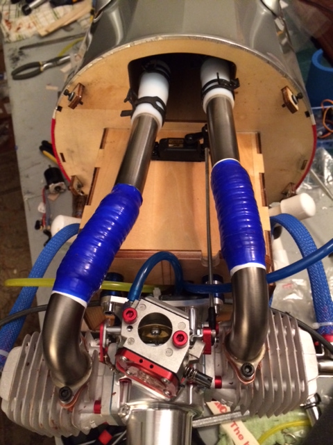

Just found this Forum, so here's my first post!
A rather unfortunate nose-in dead stick required me to replace the stock mufflers on my Yak. So rather than go stock, I squeezed two ES Composite pipes in my Yak running a DA70. It took a bit of mods to the pipe tunnel, but I got 'em in!
Hope the rain here in Nashville passes for the weekend so I can get her tuned!
Richard
That's cool! Welcome :)
Why the long exit hoses?
3dmike
Love the composite pipes... Nice job. I'm with GYRO about the length but I'm sure the thought is to cut them but I could be wrong.
Ha! Keen eyes! The stingers are hi temp heater hoses that I wraped in some blue bling :) I cut them after this pic was taken. Thanks for the welcome, good to be here!
