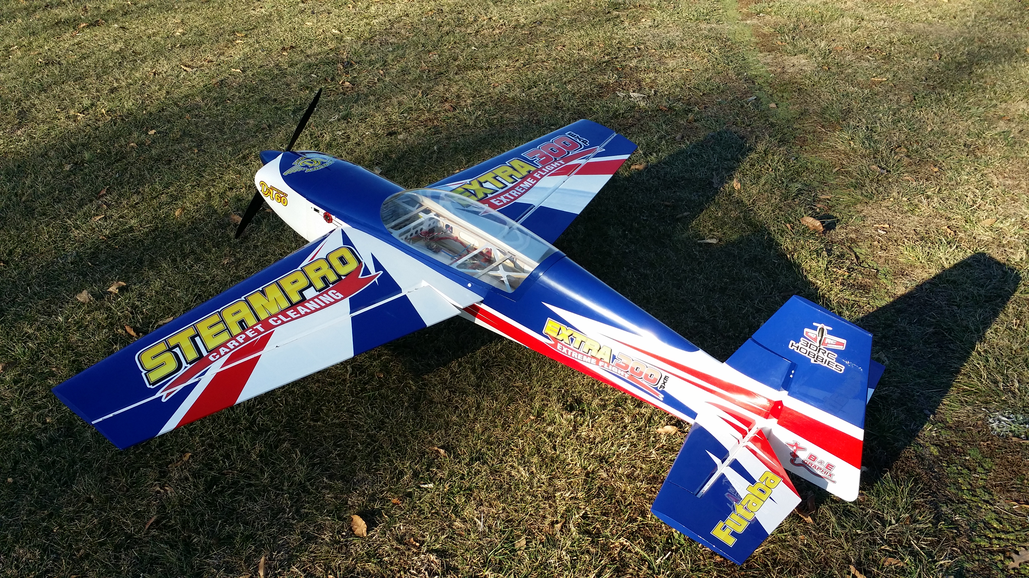

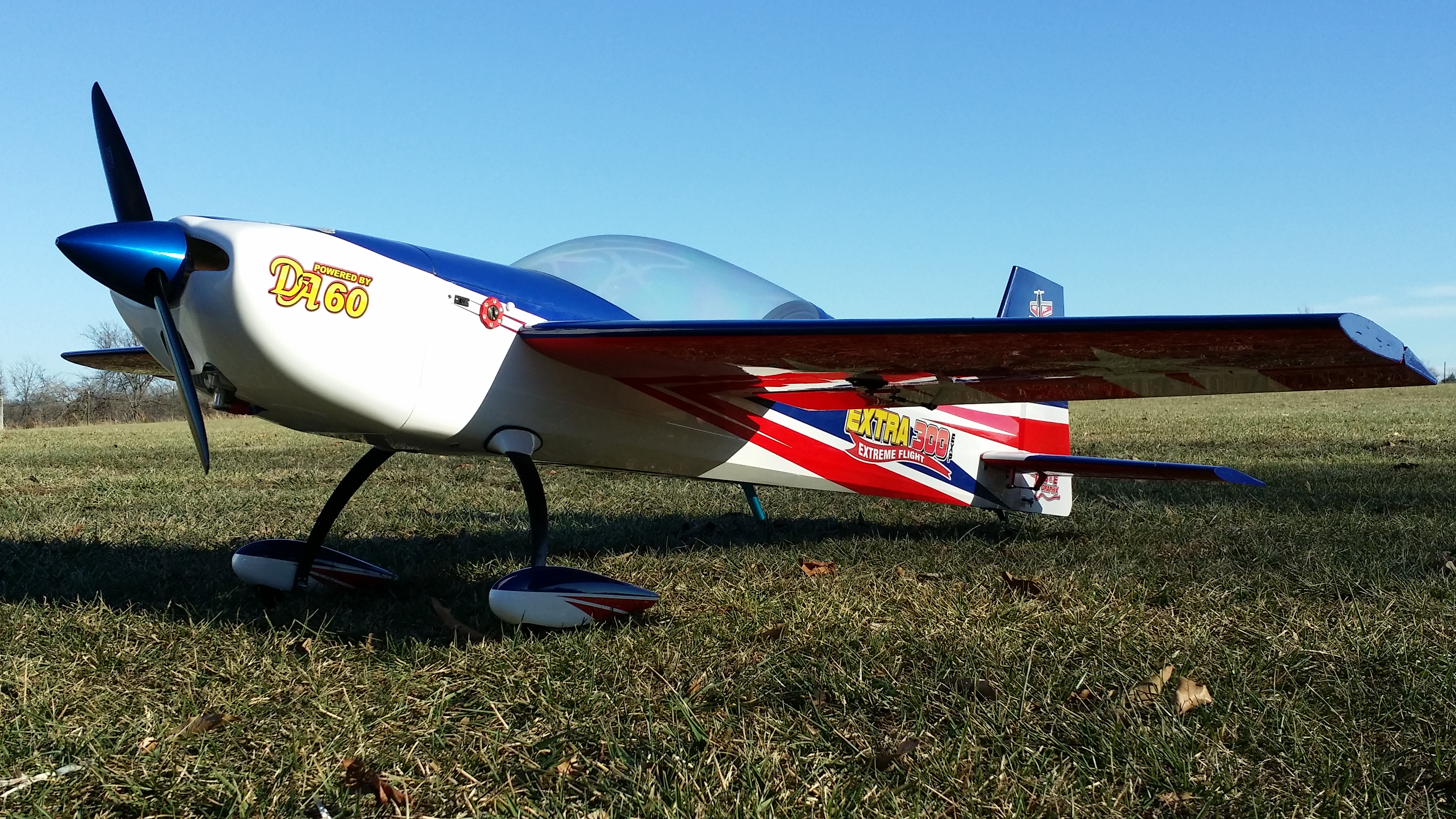

It was better than perfect weather today here in Springfield, MO. Finally got to go and maiden the Extra, wish I would have had the 92" Edge done in time to take it too.

Daniel, so far so good, just got one flight on it. Everything was new om this plane, the DA-60 w/MTW pipe had about 5 minutes pre-run before the maiden and ran great. I think my balance ended up about 1/4"-3/8" behind the backside of the carbon tube. What would you suggest for the rates and expo's. I made a video of the flight, but the GoPro was cap mounted and was set at the wrong angle and most the video u can't see the plane.

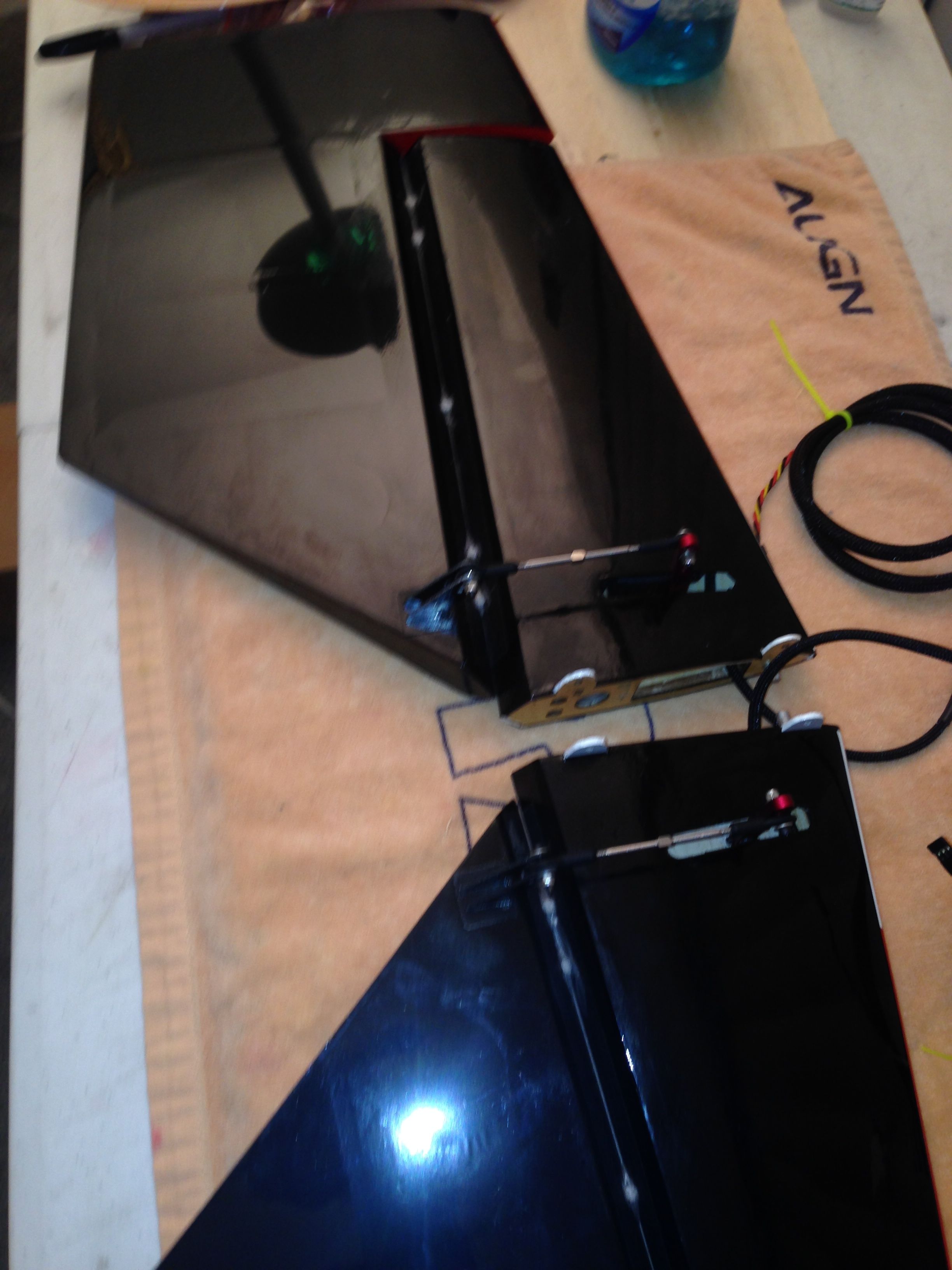

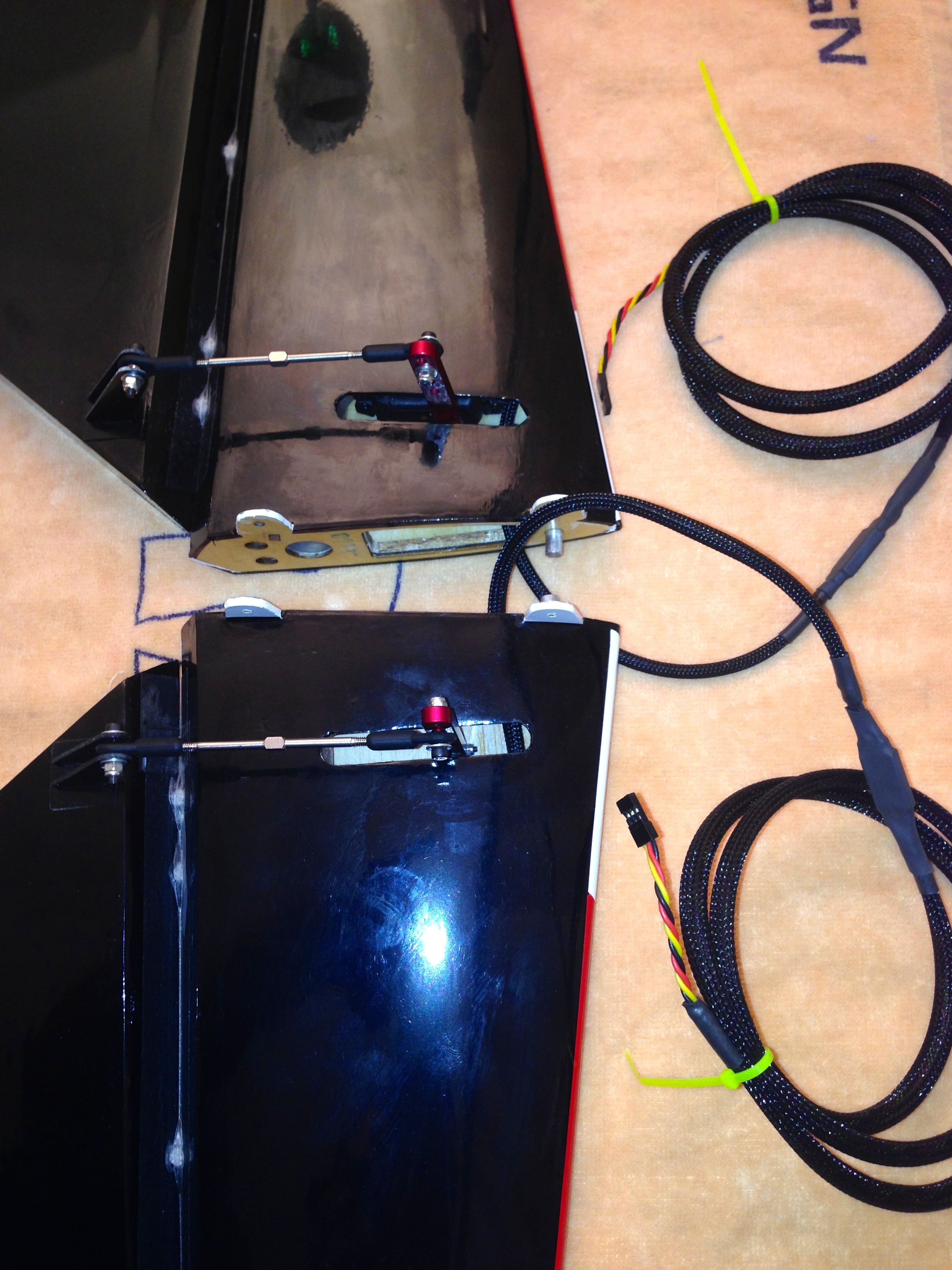

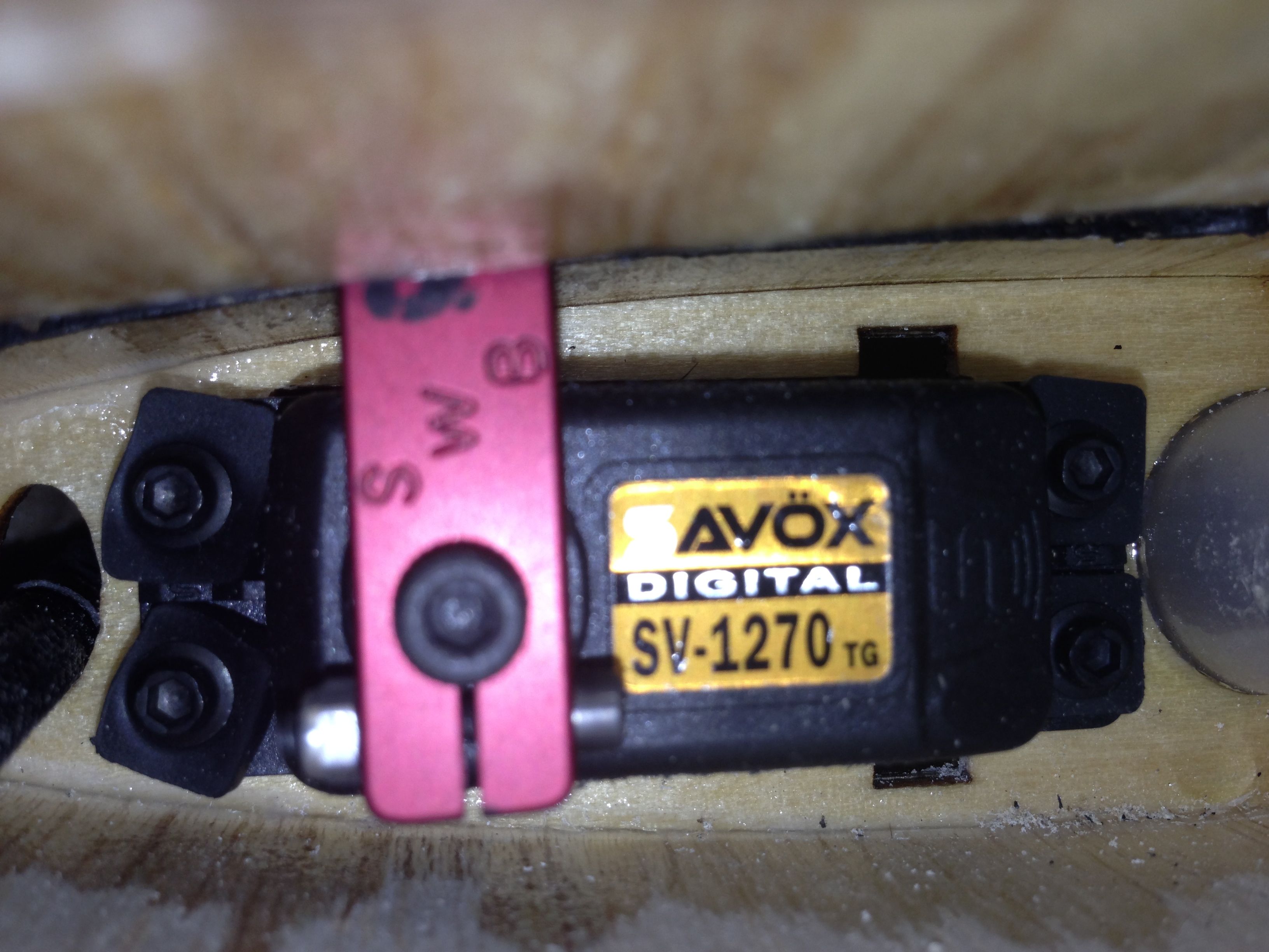

Finally, I worked on the build today. I installed the Savox 1270 servos, SWB arms, tapped them to 3 mm, wrapped the servo wire, used shrink tube and installed the control horns, and installed the linkage. I used a mic to measure the lenght of the linkage to ensure the length is spot on. Also, set up the servo's before installing them in the elevators. Hope this comes out OK, it's my first build with a plane this size.
I used Blendrem tape to seal control surface gaps.
When I installed the servo horns I used Zpoxy mixed with Milled Fiberglass, did the same when I installed the hindges on the Elevators and ailerons.

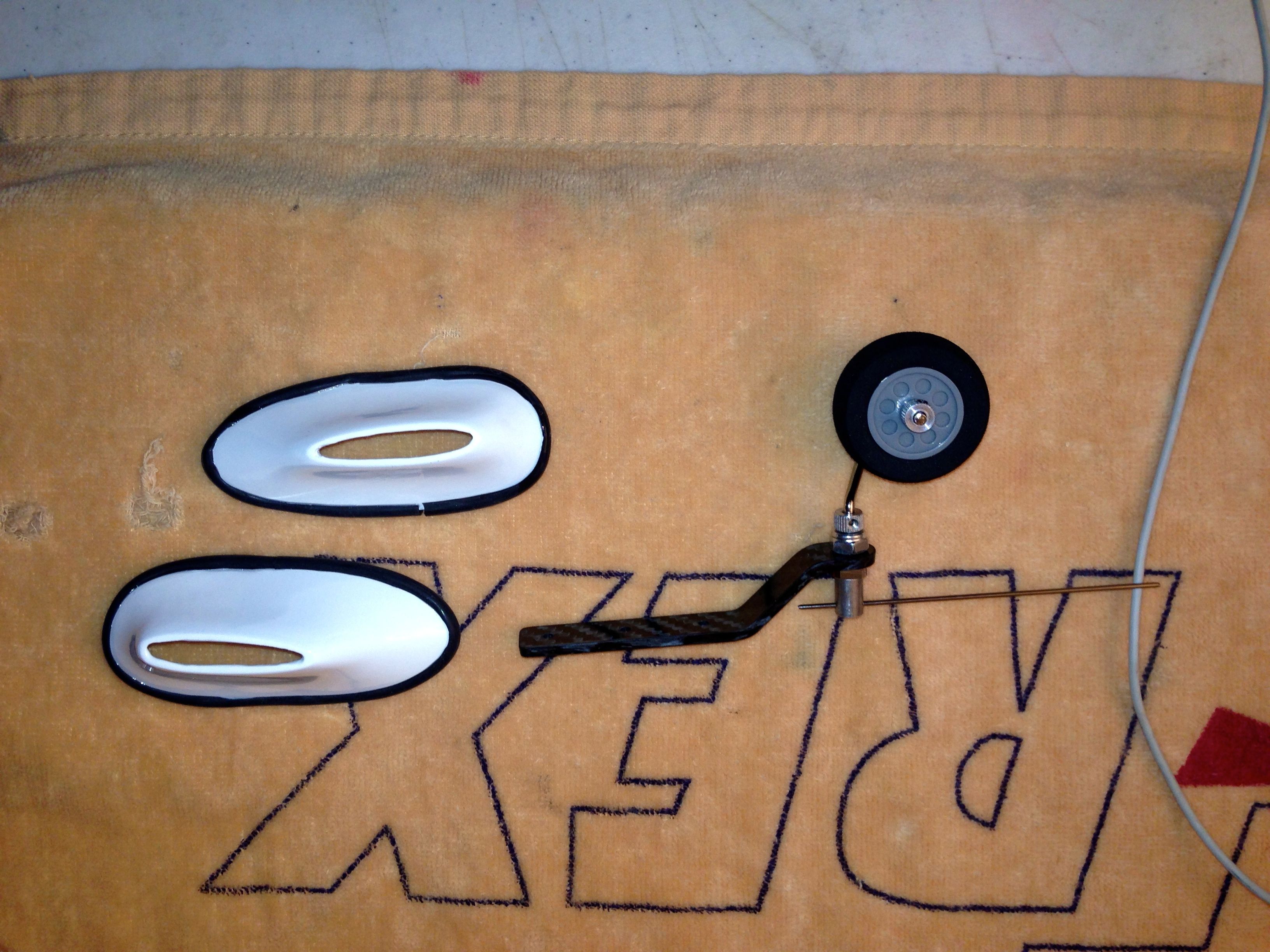

I bulit the tail wheel assembly and....
