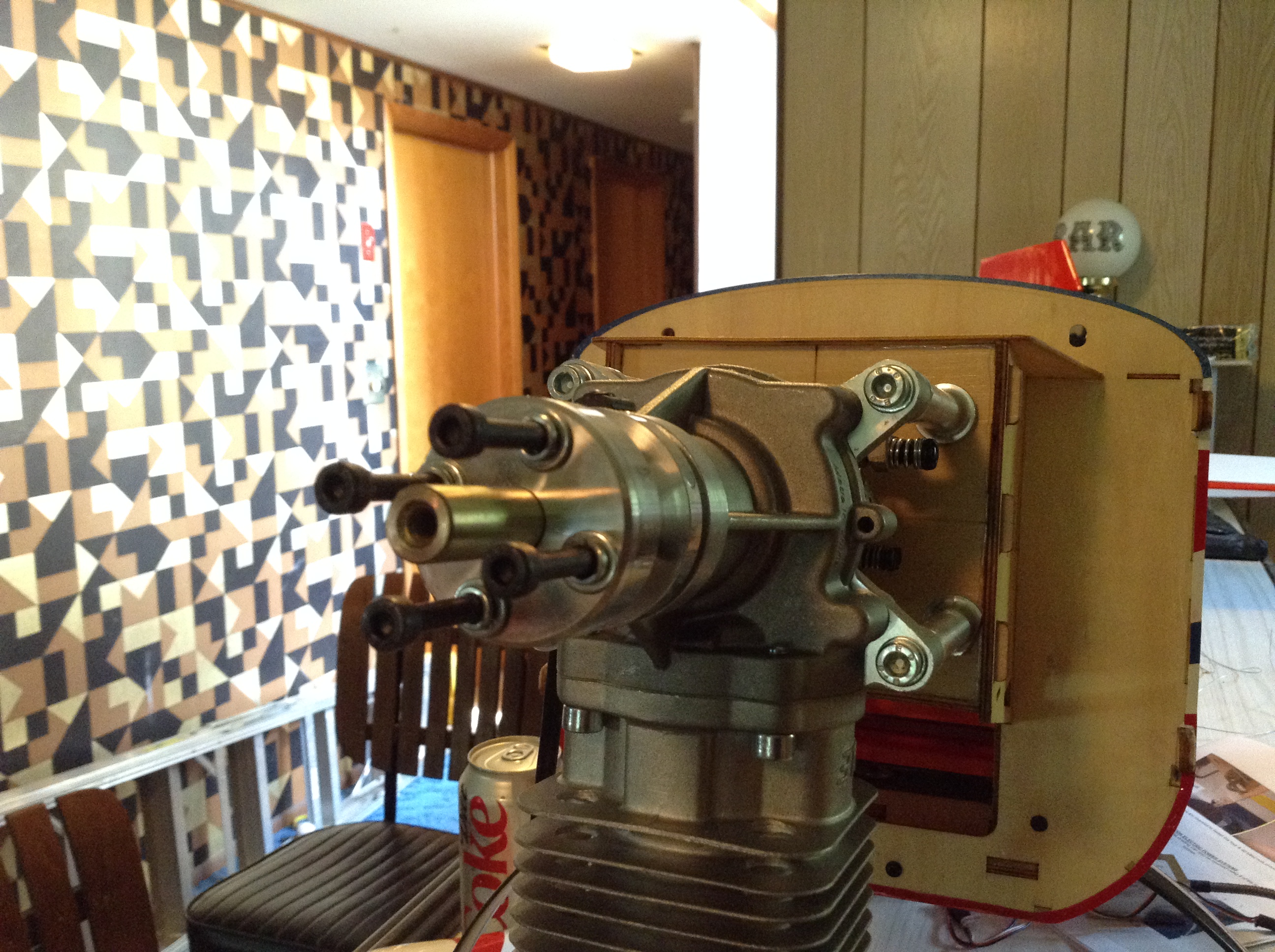

I've had similar issues mounting the dle55ra and dle61 which has the same spread out lower bolt pattern.
You'll be fine! Just cut that part of the firewall that sticks out, so it's flat. Then drill and mount.
I would mill the standoff so it has flat sides to fit the motor box. It will still hold the motor square to the motor box, without modifying the airframe.
I am sure it will work either way, but it would be easy to buy a new standoff one day, however to fix the motor box, it would be quite the chore.
Hiway
Thanks for the information! I also posted on RCU and they said the motor was too much for the plane. I think 3DHS now says up to 38cc so that isn't an issue. I was OK with machining the washers and standoff or cutting the wood down. I just wanted to make sure it wasn't a mistake with the alignment marks at the factory. Stranger things have been known to happen.

I got the engine mounted today. No problems.

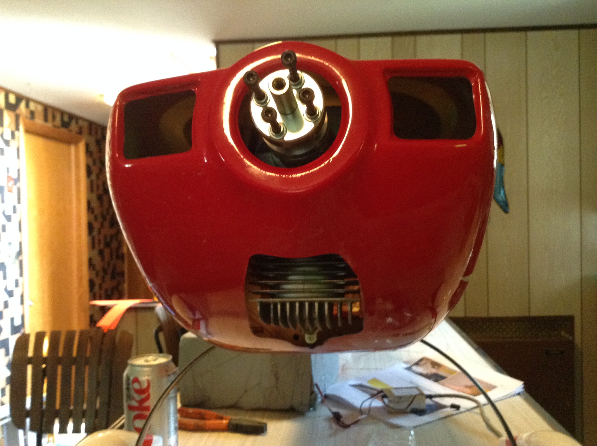

Any suggestions on getting the cooling right for the DLE35RA? I didn't want to have to open a big hole in the cowl on the bottom behind the head, but I'm not sure what else would work. The kit had panels for the bottom of the fuselage with holes in the balsa for venting. I am guessing that is for the electric configuration to keep batteries cool. I thought about using one of them. It would let air flow past the head, through the canister tunnel, and out the bottom. My concern is we are putting a smoke system on it and wouldn't want the oil going in there and getting to the wood at the tail.
I hate cutting up cowls but dead sticks from overheating are worse. Any ideas?
Cut a big enough opening to expose the whole front of the cylinder to air, then use the pipe tunnel for the air exit.
