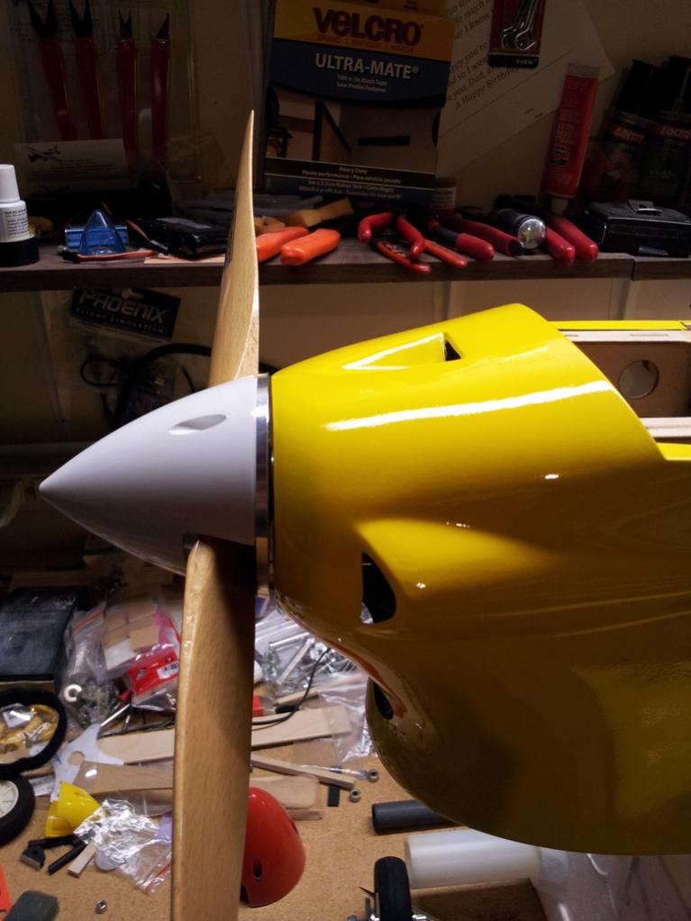

Do you have a picture of the cowl from the front? I might be able to think of something....the 330SC's have a bit of a cooling problem too.

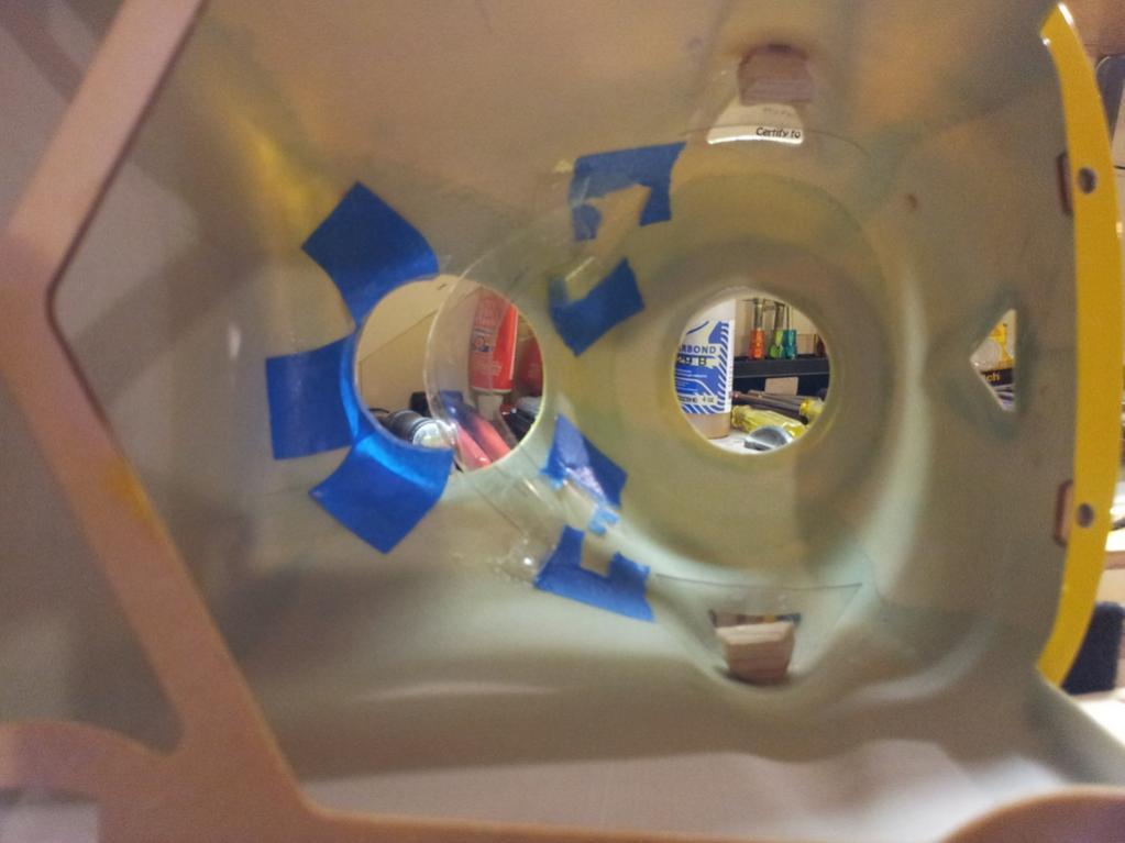

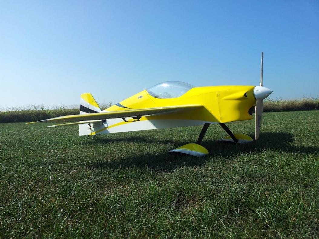

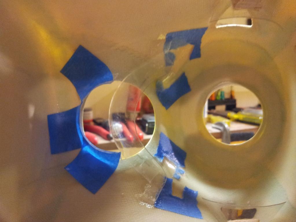

Flew another flight on my 65" Vyper this weekend...still came down pretty hot, I guess my cooling mods weren't enough....I put deflector in the chin opening to deflect air up, I think I need to capture more of the chin opening; currently the scoop captures about 1/3 of the opening (I didn't want to neglect the ESC which is mounted on the bottom of the motor box).
I guess my next play is to widen the cheek openings a bit more and put 90 degree deflects from the cheek scoops to point directly at the motor from both sides...?

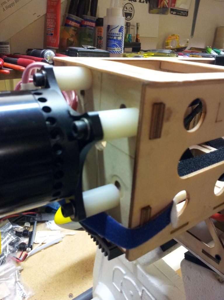

I don't have a temp gun, but I can touch the back end of the motor shaft through the firewall and it was so hot that I could not keep my finger on there for more than 1 sec. That seems much to hot for me. I have Motrolfly motors on other planes such as my 51 Slick and 58" Edge and they come down with a touch of warmth...I can keep my fingers on the motor without any pain whatsoever. I suppose I should invest in a basic IR heat gun from Harbor Freight to get a more objective temp reading. :/

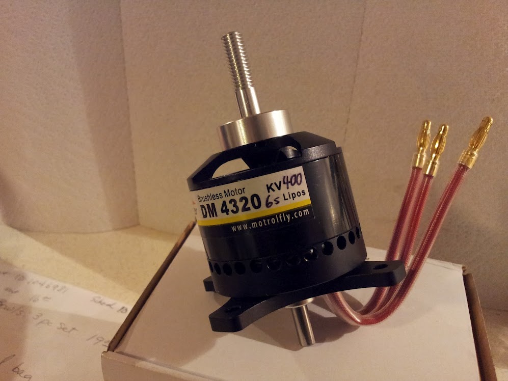

what motor/prop,etc ya go on this one? also is it brand new?Sometimes the brand new ones( if you are using motrolfly) take a cple of flights to level the grease in the bearings out some. Also an IR gun is def needed as I cannot hold my fingers on a motor that is over 120 deg. 150-160 is ok for the back of the motor at the amount/rear bearing tube area.
