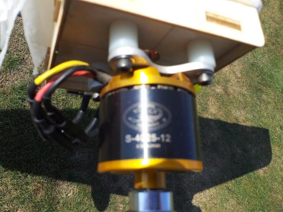

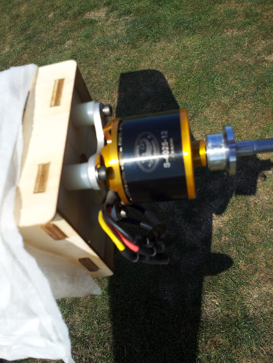

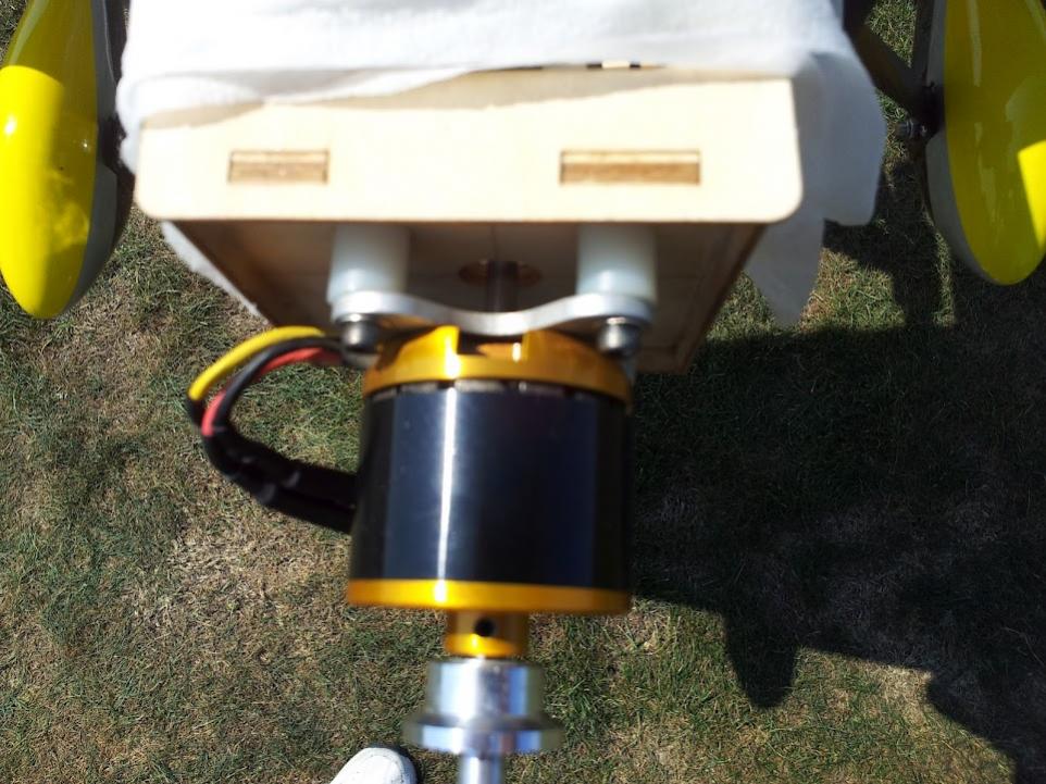

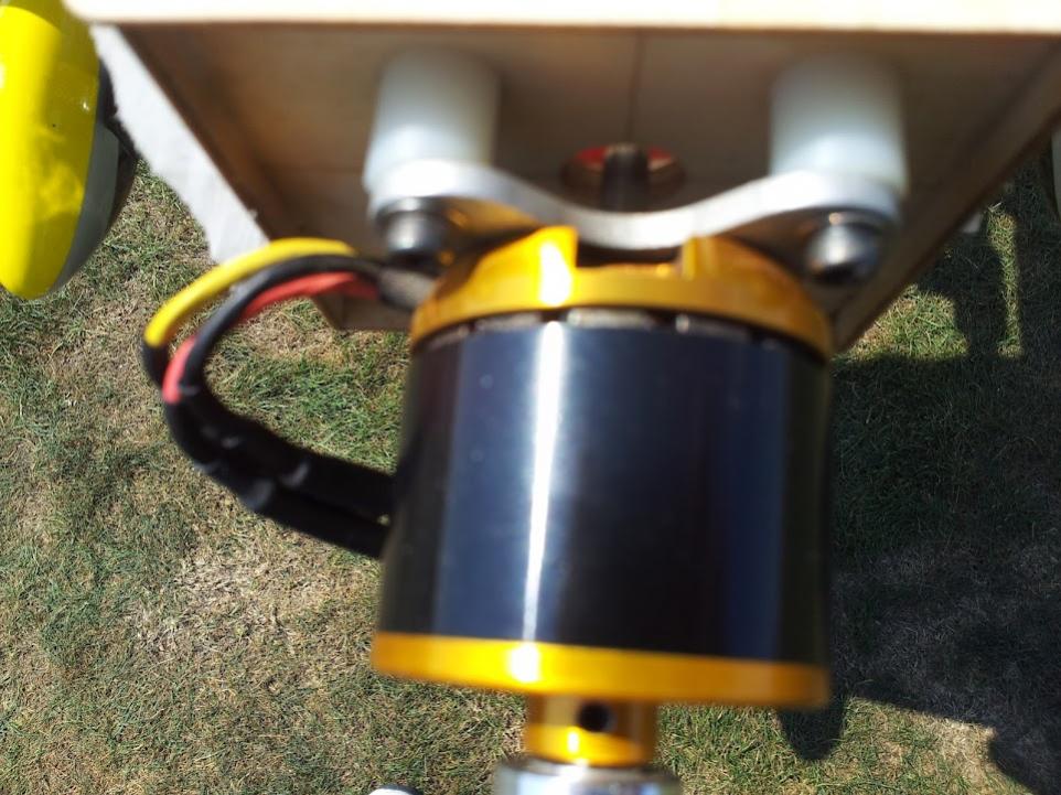

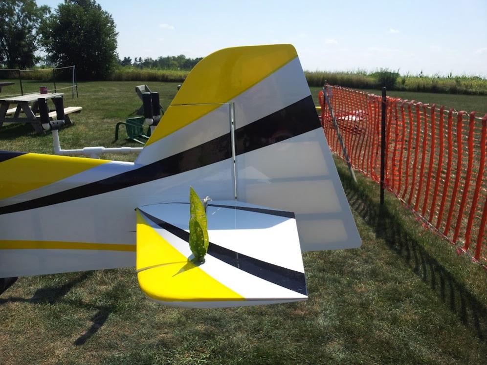

I was flying my 65" Vyper on Monday. About halfway through the third flight the motor started sounding different, but it seemed to be flying okay, so I kept going. As I was doing a last hammerhead before landing, I flipped over at the top and as the nose pointed down, I noticed white smoke trailing from the plane! I thought "cool, smoke on an electric plane"...then I thought "wait a minute, I don't have a smoke system on there!", then I realized "my plane is smoking! electric fire onboard...crud...)($#$* so I cut the throttle and brought it down, landing gently on the edge of the field in the tall grass...ran out to the plane, pulled the cockpit, unplugged the battery, ran it back to the pits, started pulling off the spinner, prop (which did not break!), and cowl..everything was super hot to the touch, got it apart, noticed that the motor can had come apart somehow or slid forward, you could see the magnets from the rear edge of the can...couldn't touch the motor. I put a wet paper towel on the can to help cool it down and it started sizzling immediately...finally got it cooled down. So other than the motor, there is no other damage to the plane. The prop even survived. I feel really lucky that it turned out this way. Not sure what happened to the motor...I bought it used from a reliable source, and I don't think I was over taxing the motor. It was pretty hot today, not sure if that had anything to do with it.
Anyway, I attached a few photos for your enjoyment.
[FONT=arial, helvetica, sans-serif]Still haven't had time to pull the motor off the plane, but it definitely does not move easily. Probably gonna have to replace it. Time for a Motrolfly!

Mike your magnets have broken loose from the can and it looks like they are rubbing on the base of the motor. This is likely the cause of your excessive heat. I had a similar issue with a hacker motor. I tried re-gluing the magnets with limited success and ultimately burned up the motor windings. It looks like you are in the market for a new motor.
I'm not sure what causes the glue to break loose from the magnets but the failure I had on my hacker looked similar to what you have there.
Generally, for all the magnets to break loose like that, there has to be sufficient heat to break down the epoxy holding the magnets, which by Mike's description, occurred here.
So that brings the next question: what caused the heat? A couple possibilities come to mind here: too big or too much pitch on the prop, inadequate cooling air to the motor, old/worn bearings causing friction. I'm not sure if any of these apply in Mike's case, but that's where I'd start.
