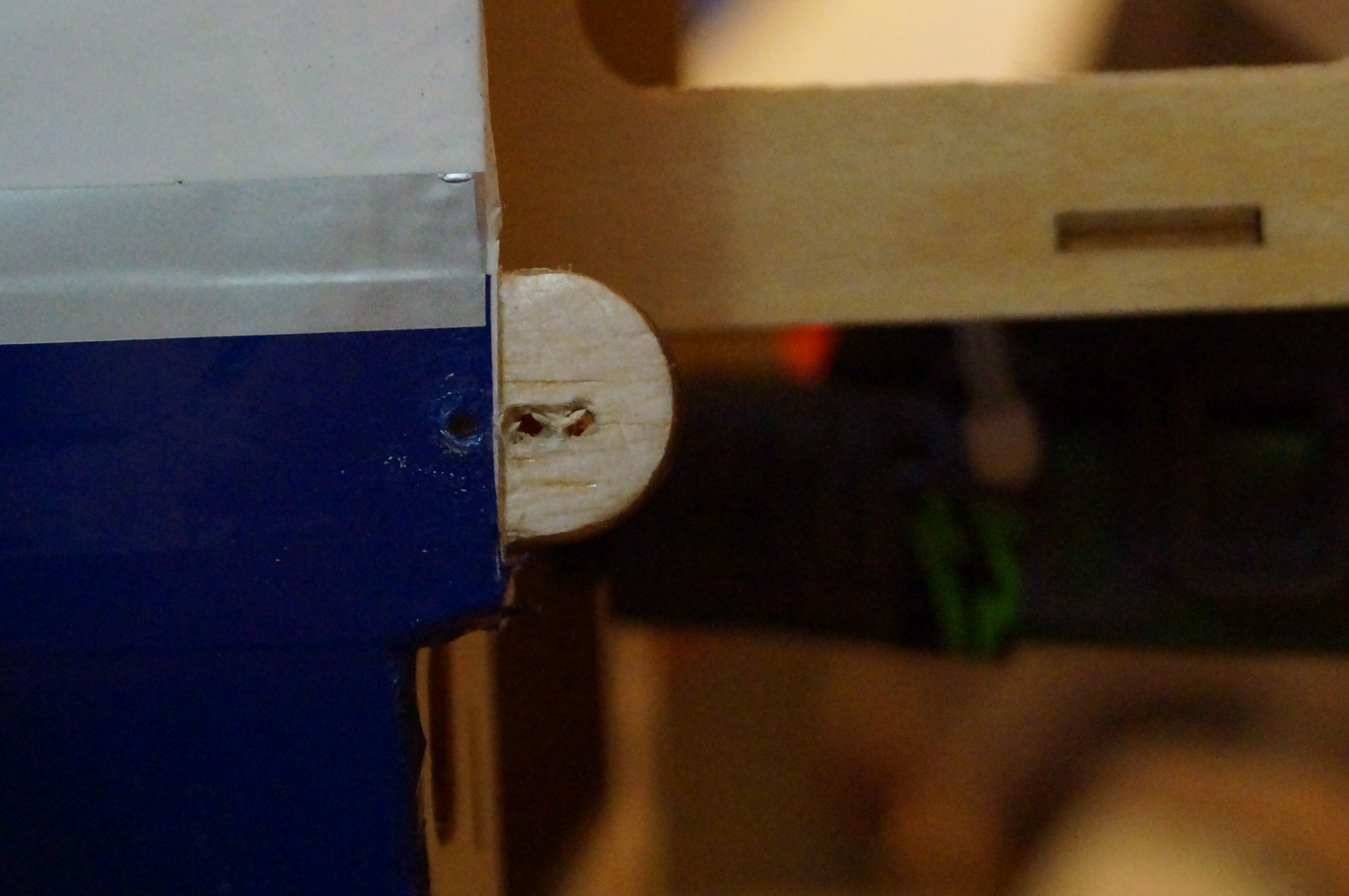

I've found over time that using popsicle sticks to mark the openings works well. Here are instructions and some pics from my previous builds/posts on this subject:
First, tape some popsicle sticks parallel to the fuse, extending over the tabs. Then, drill the openings through the sticks that you intend to use:
attachment.php
Then, simple slide the cowl into the position you like, underneath the popsicle sticks, and align with the fuse and motor. Then tape it down so it doesn't move. Finally, simply re-drill through the same holes in the popsicle sticks.
attachment.php
attachment.php
That's it! you've got a perfect cowl!
