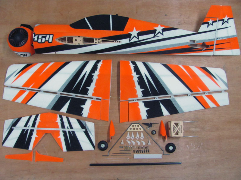

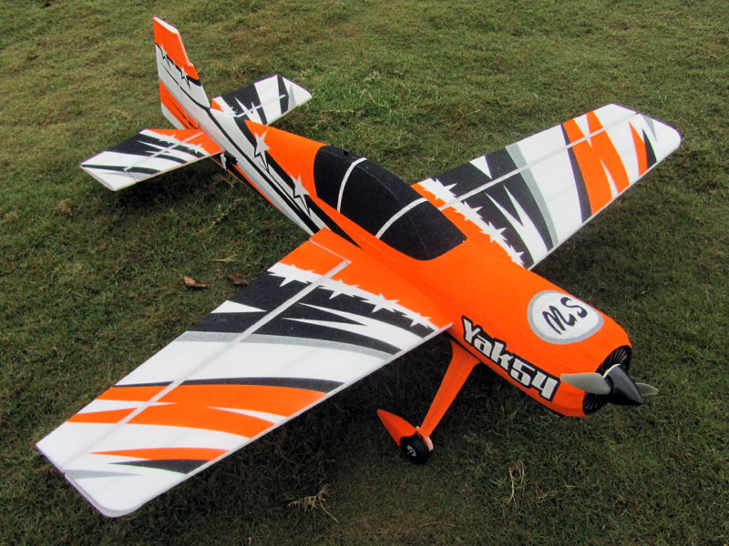

New pics of prototype #2, first color scheme.

This is a nice looking Yak 54. I like the orange, white, black and silver colors (my 71" Slick has these colors) but to me this scheme is confusing...........no focal point. Kind of like a tiger or zebra, the stripes are for camouflage and confusion; I think my eyes would prefer a more docile design.
