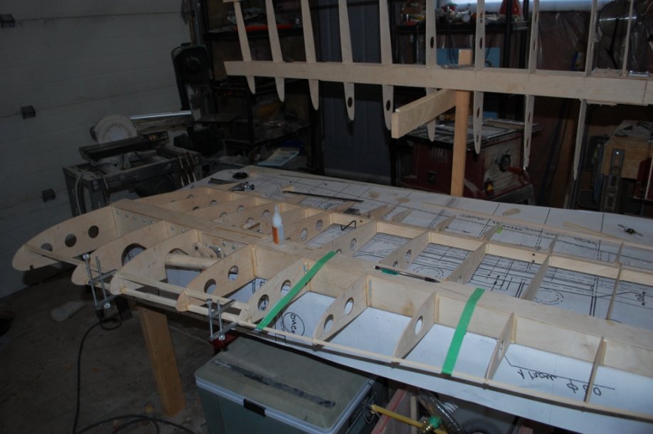

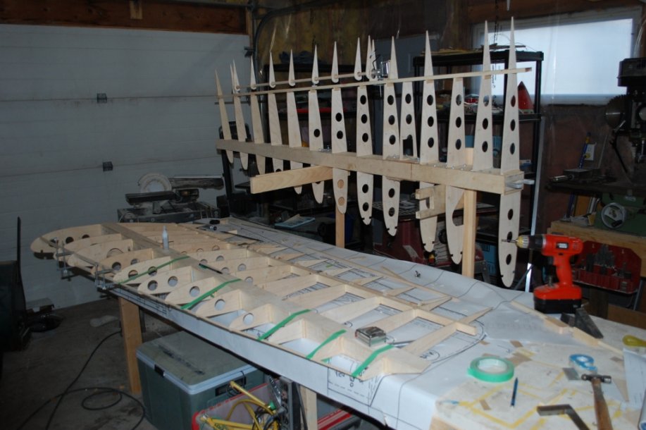

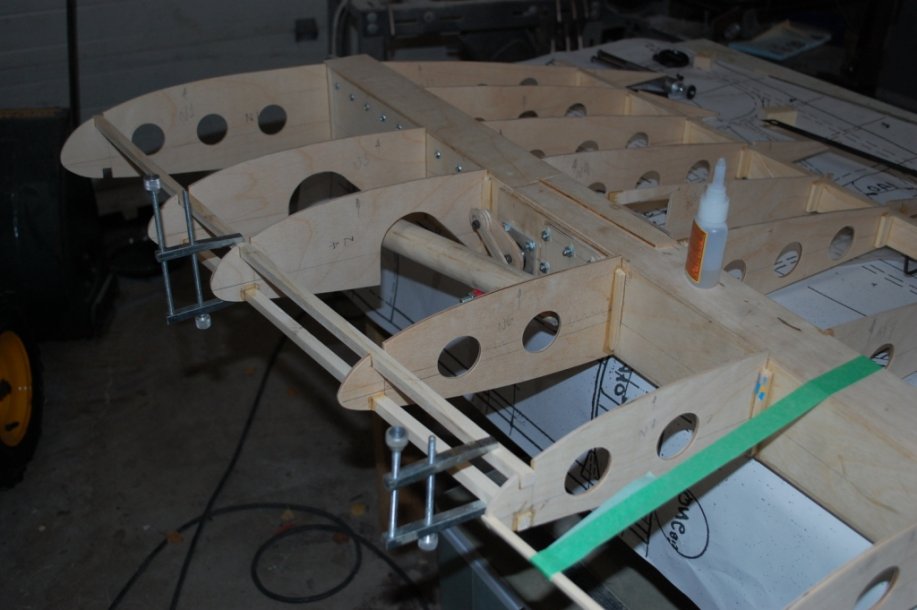

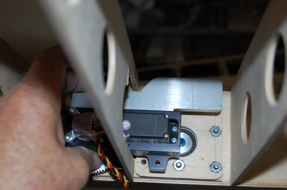

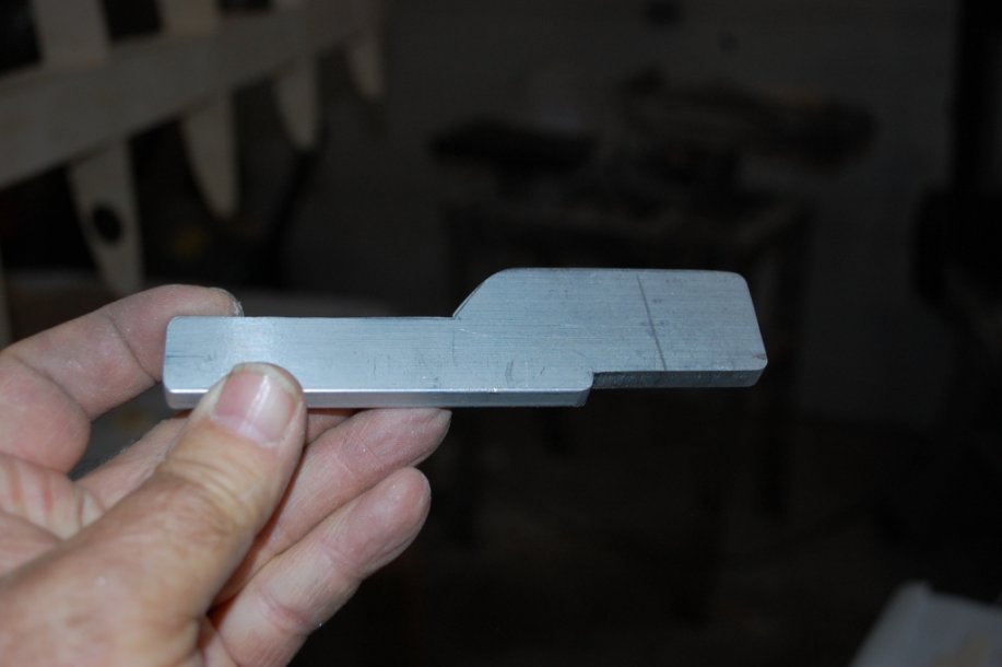

installed a few stringers in the front ribs to stabilize them when sheeting the wing plus the aluminum piece is to install the retract servo , more to come

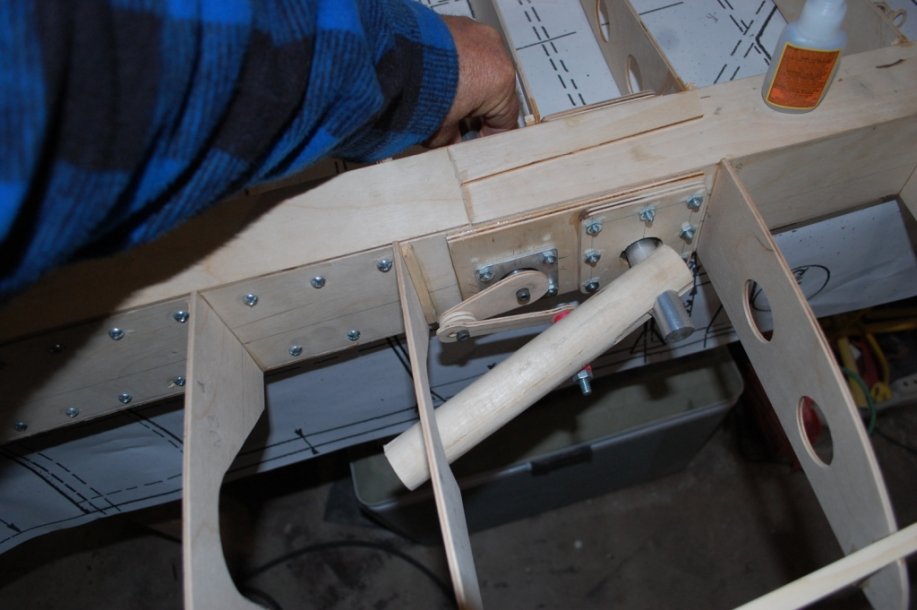

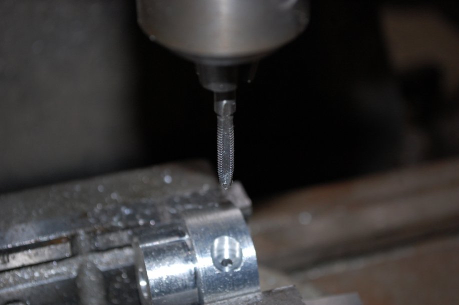

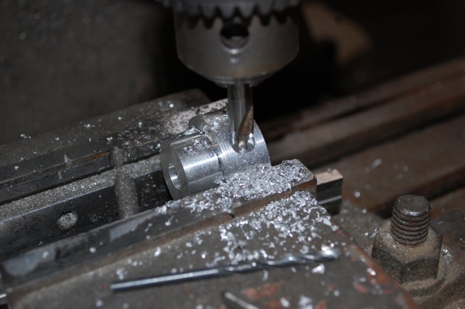

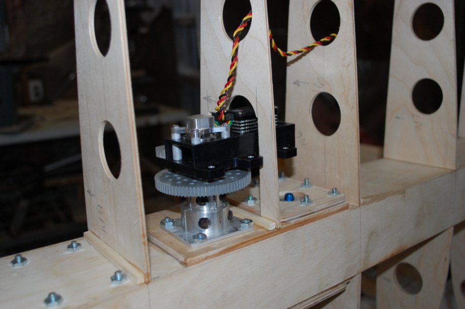

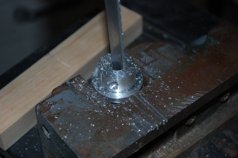

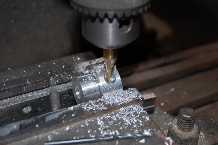

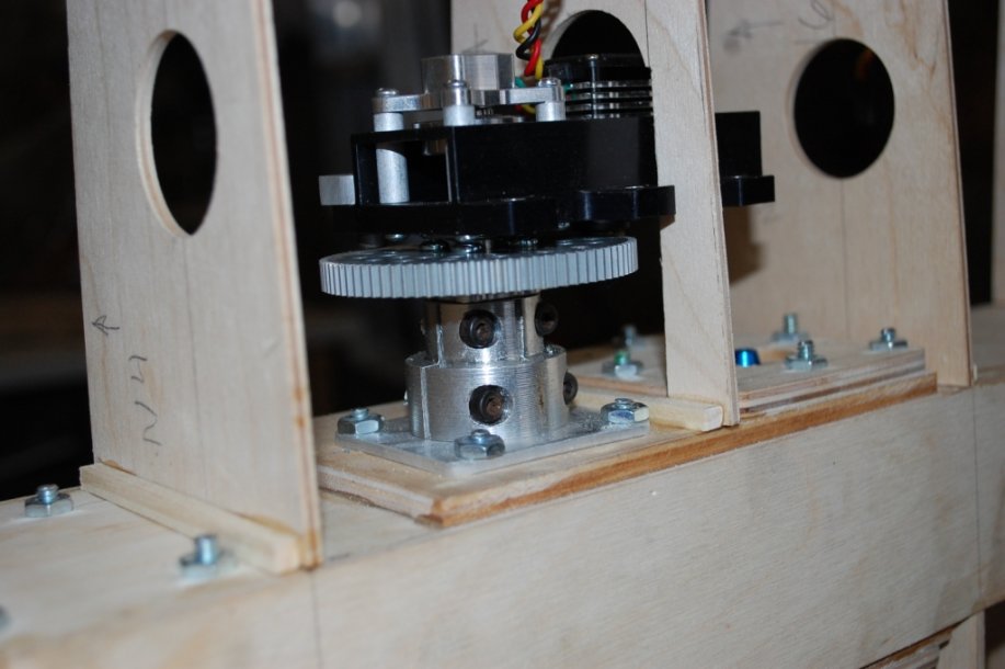

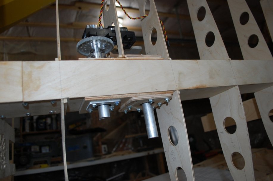

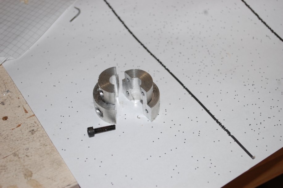

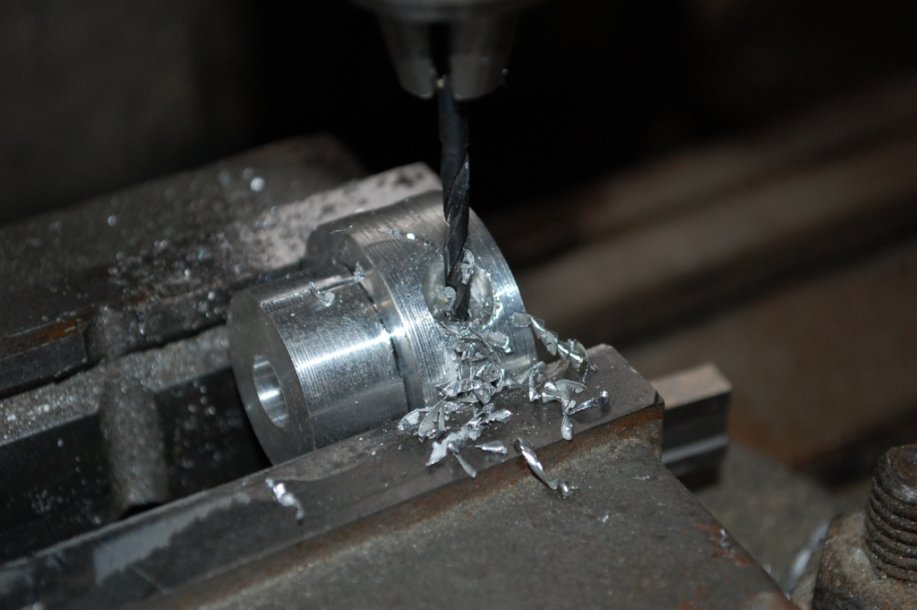

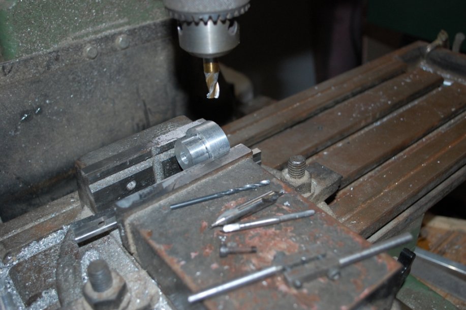

working on the coupling between the retract servo and the retract shaft through the spar
