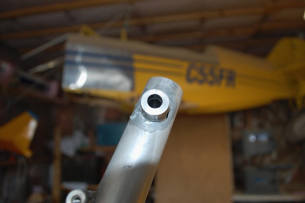

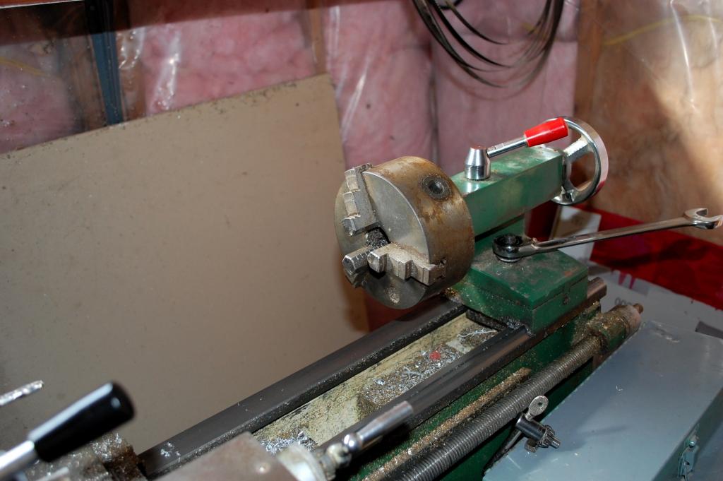

since I can't remove the aluminum axle, I found a way to fix it, , so am now working on a proper jig for my lathe and will see , yes I will post pictures just hope it works what I have in mind

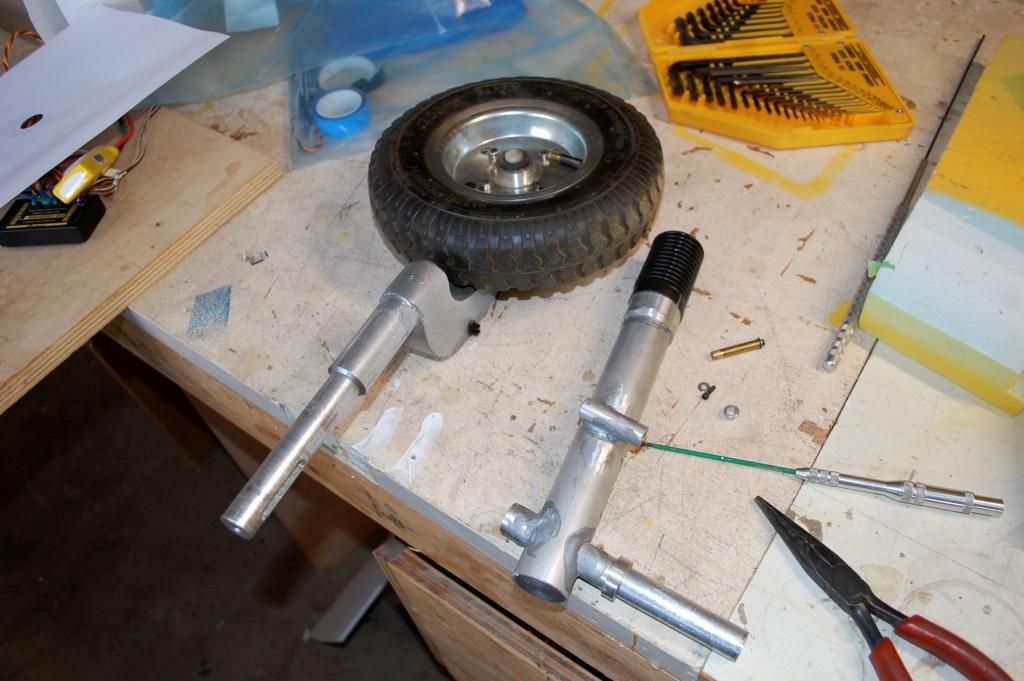

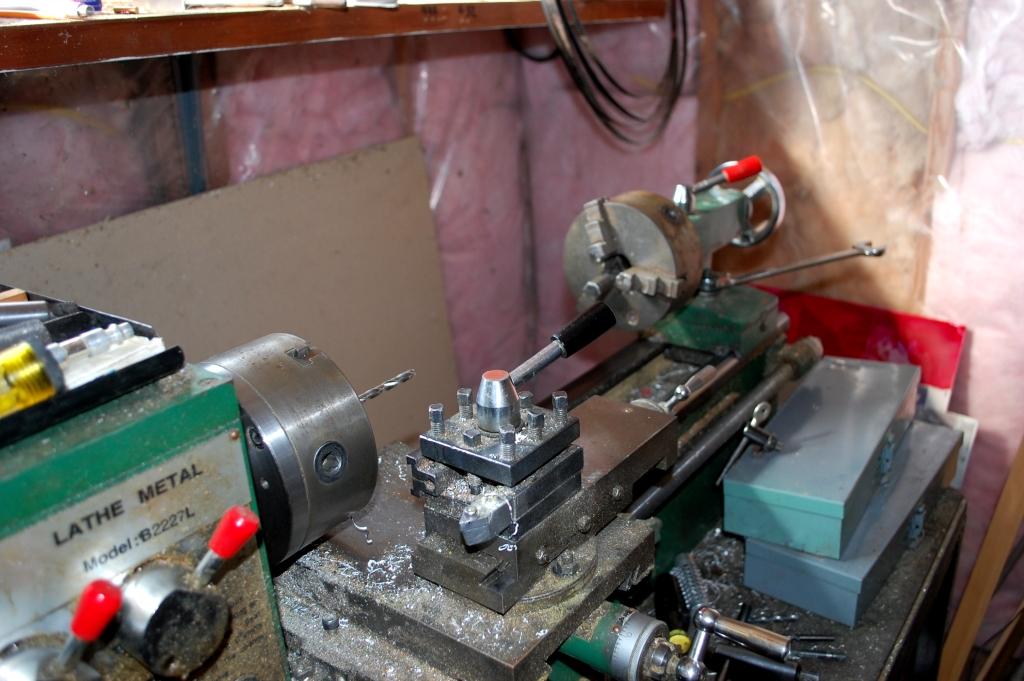

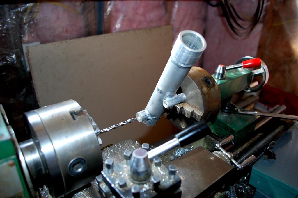

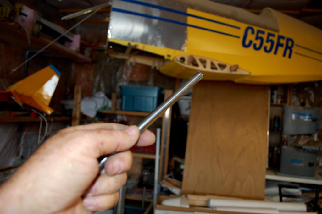

Here are some pictures, I drilled a hole 10mm dia. deep inside the aluminum axle, the idea is to insert the drill rod which is a bit bigger, inside up to the point of the highest stress. by heating the aluminum, and cooling the drill rod, it should slide in just fine, with this said , before I attempt to insert the drill rod, I noticed the axle weld cracked also so will have it tig welded this afternoon so more pictures will follow

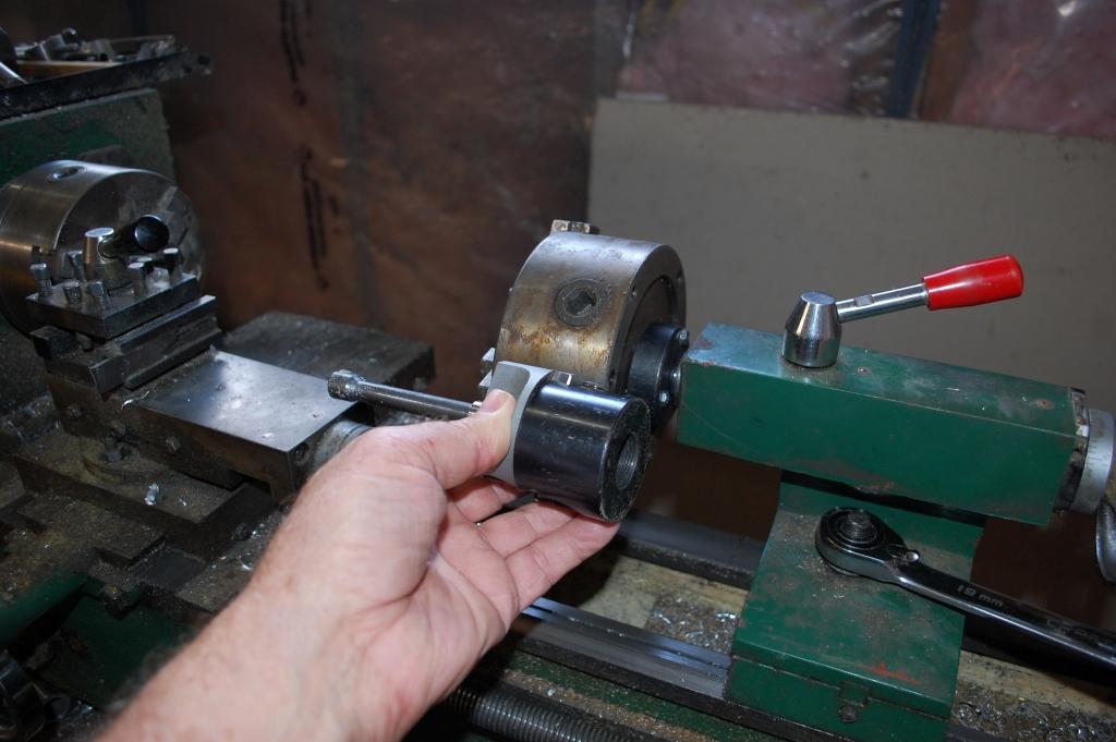

I sure I am not but I was thinking how does he get a taper to connect into a three jaw chuck. I am sure there is away because you have done great.
and that was the problem, I took the taper part of another tool, with a wide base, and drilled 3 holes to match the ones on the said chuck in the back . I will take pictures of this as well, I'm just happy I was able to do it , and the reason I did this is the original chuck in the tail stock only opens to half an inch so had to get this one to work.
