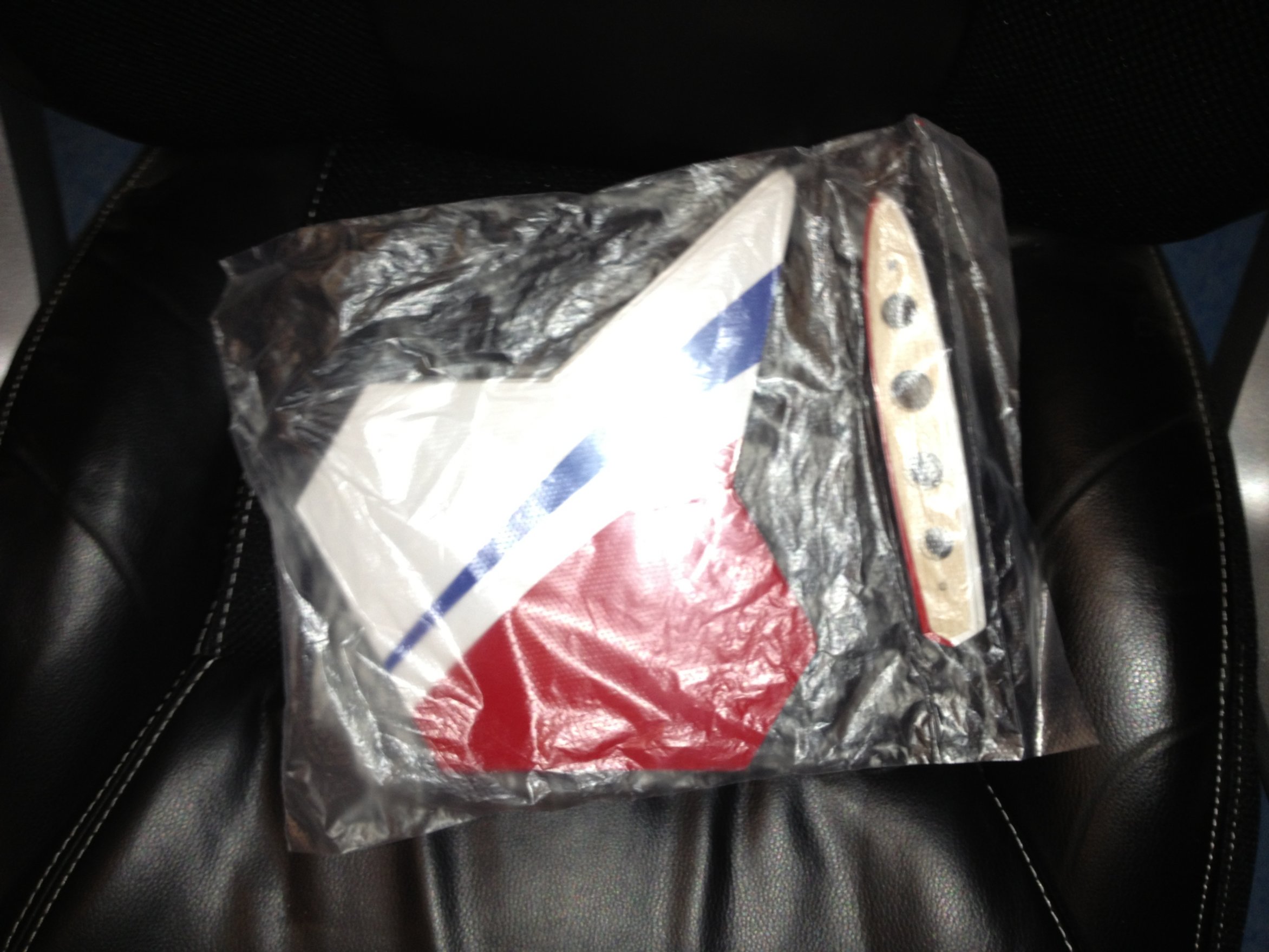

Does anyone need these SFG's; they are BNIB for a 72 Red Extra...
Cover the shipping and they are yours... Send me a PM please.
