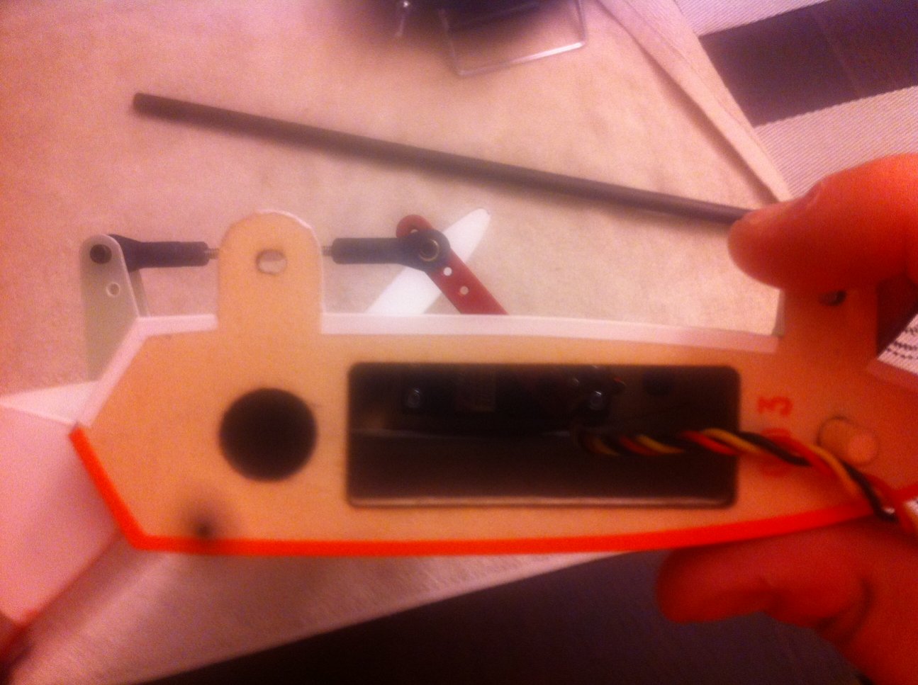

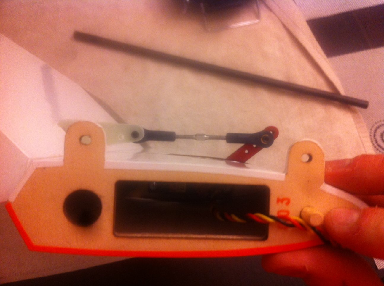

Cool stuff guys! I should be able to fly mine some more this Sunday. About the servo arms and throws, I just re-did my ailerons and was able to get 45 degrees with the 1.5" hole and the outer-most hole on the horn. (same outer hole on my elevator horns using the 1.75" arm holes)
djmoose
Here's what I ended up with on my elevators getting 50 degrees using the outer most horn hole and 1.75" arm hole.
If anyone is interested I'll get you the length of the pushrod. (I didn't record it...just used the calipers to get them the same length.)
