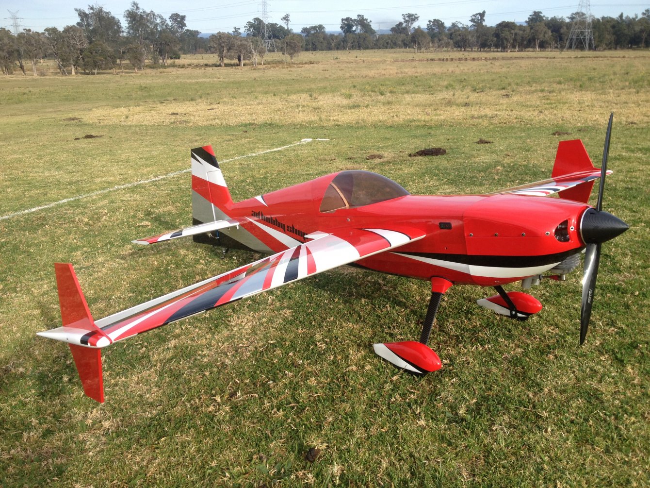

30cc
hi guys the 92'' fly's great put 2 flights on it this morning, it should be called a BALLISTIC 540.
No mixing is needed cg is spot on with the batteries just in front of the wing tube with the push pull servo in the rear.
I'm very happy with the way it 3D & tracks great for imac style flying
I can not wait for next weekend ill get a vid :banana:
moose i have 2'' rear arms & its at the maximum point not sure in degrees
1.75 on the ailerons
2'' on the push pull rudder servo
