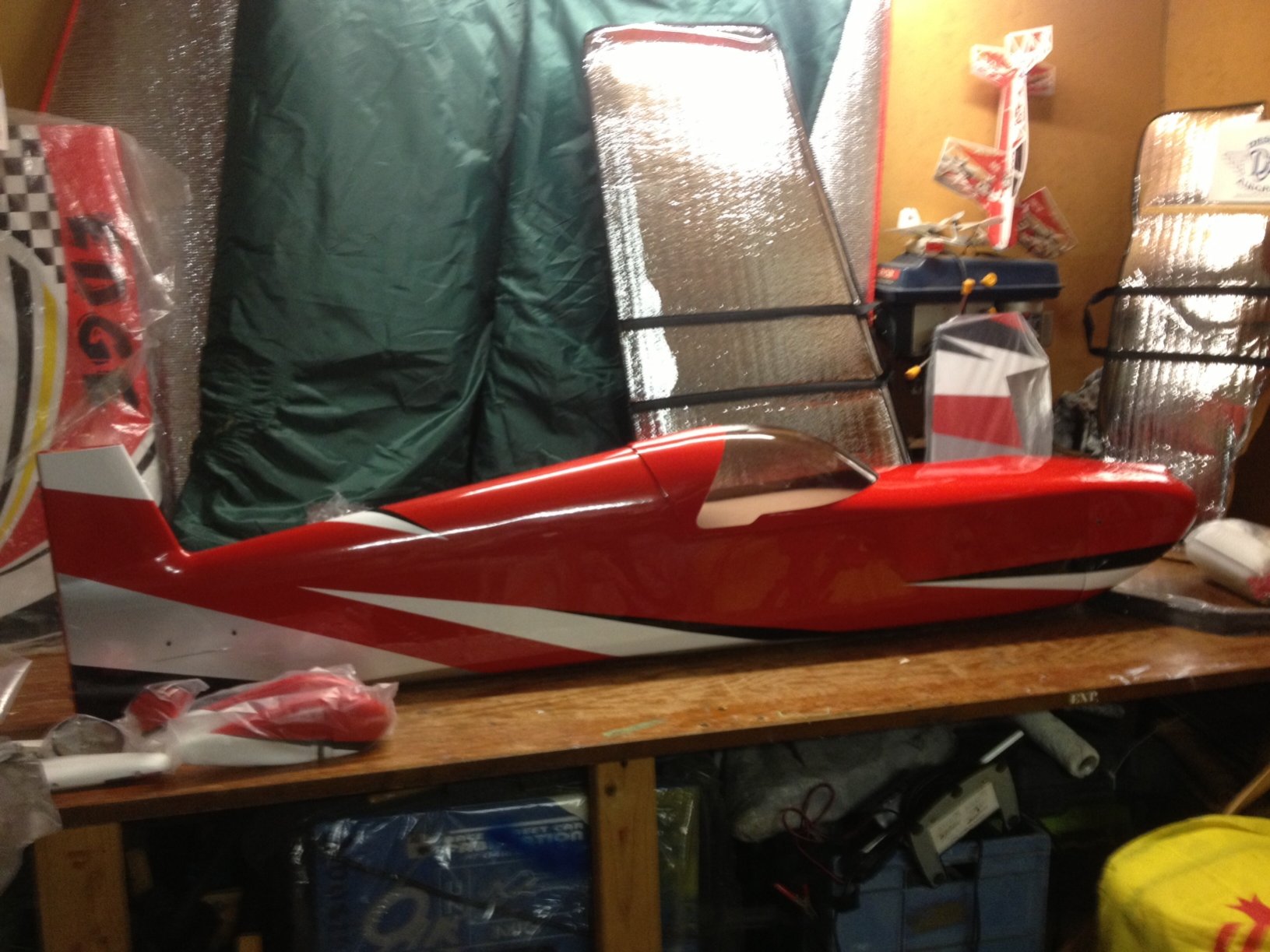

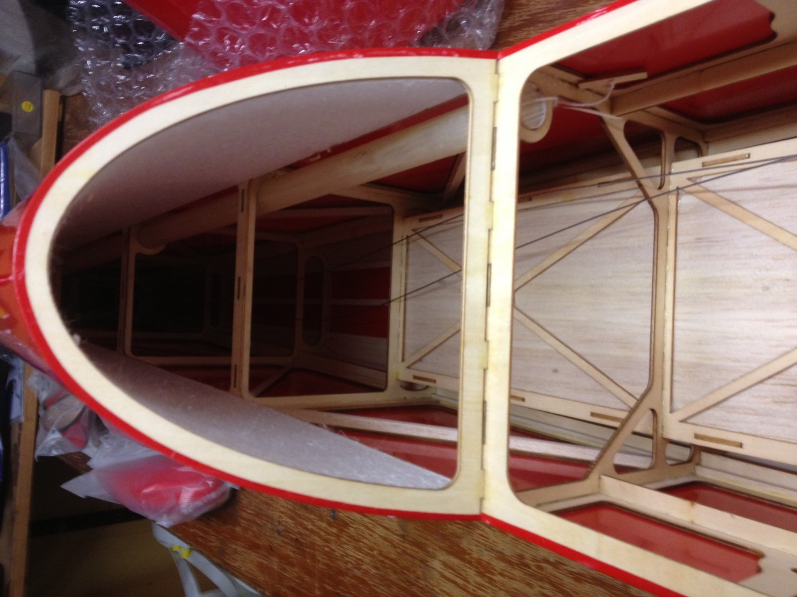

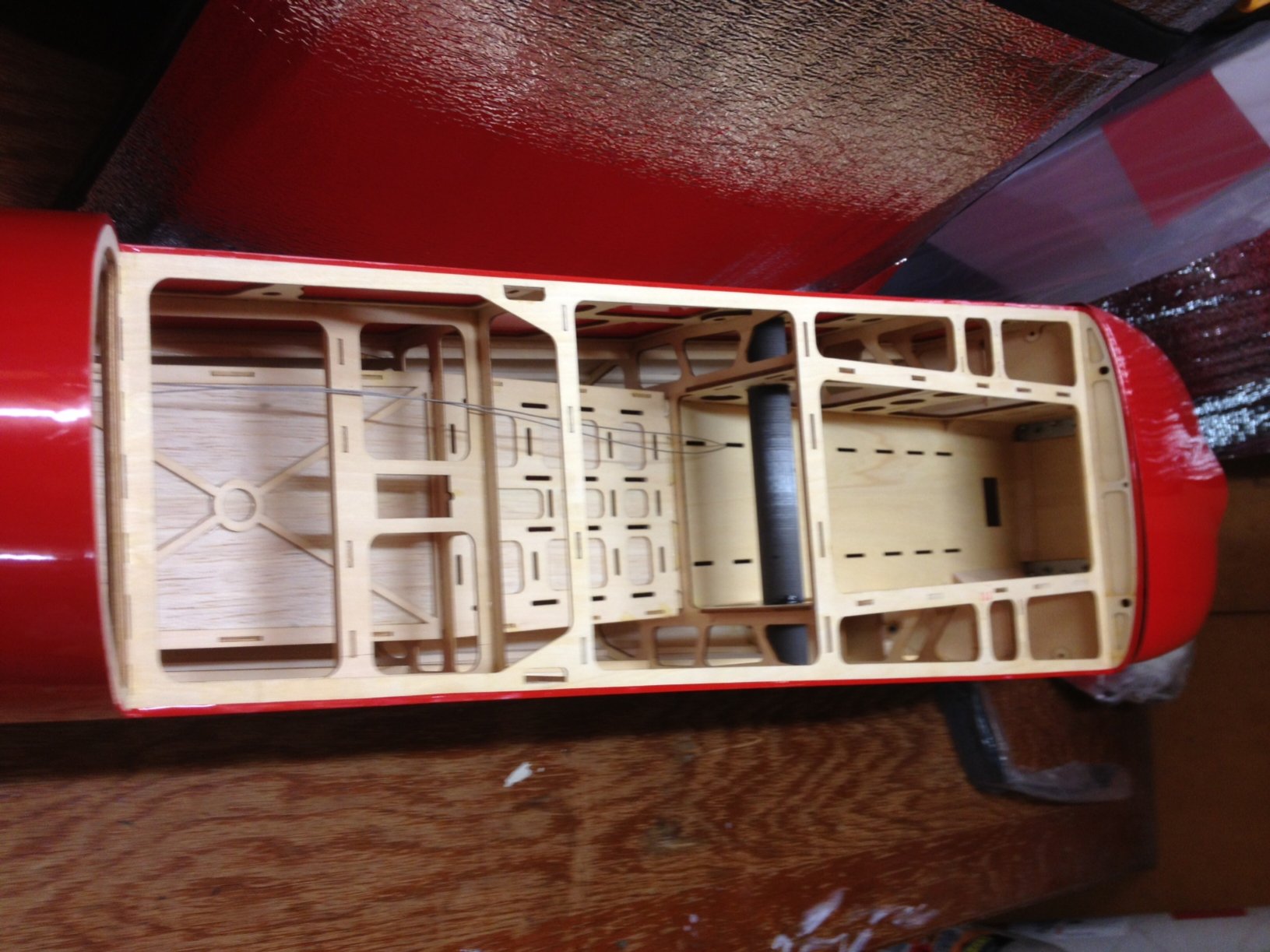

Hi guy my 92'' edge arrived today & I'm very happy with it . Pre hinged & sealed, hardware looks good

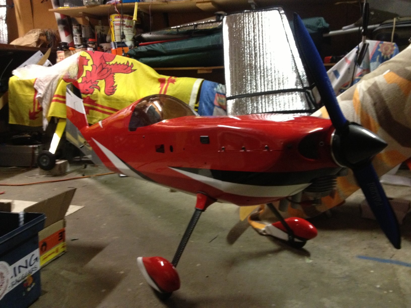

i'm off to the hanger back later with progress pics i would like to test fly it in 5 days if all goes well

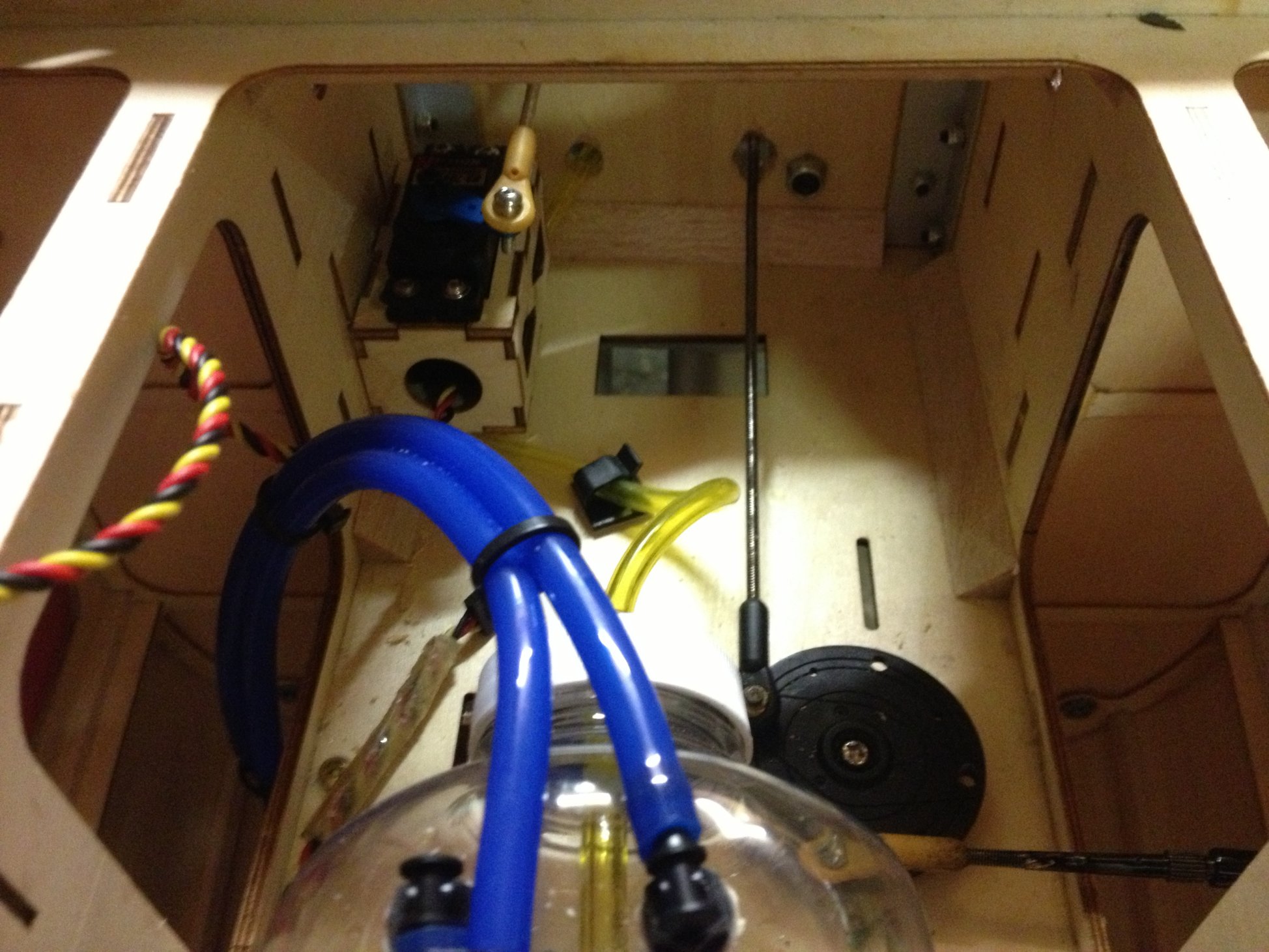

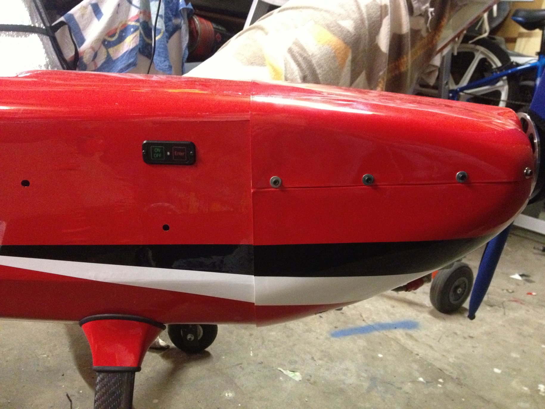

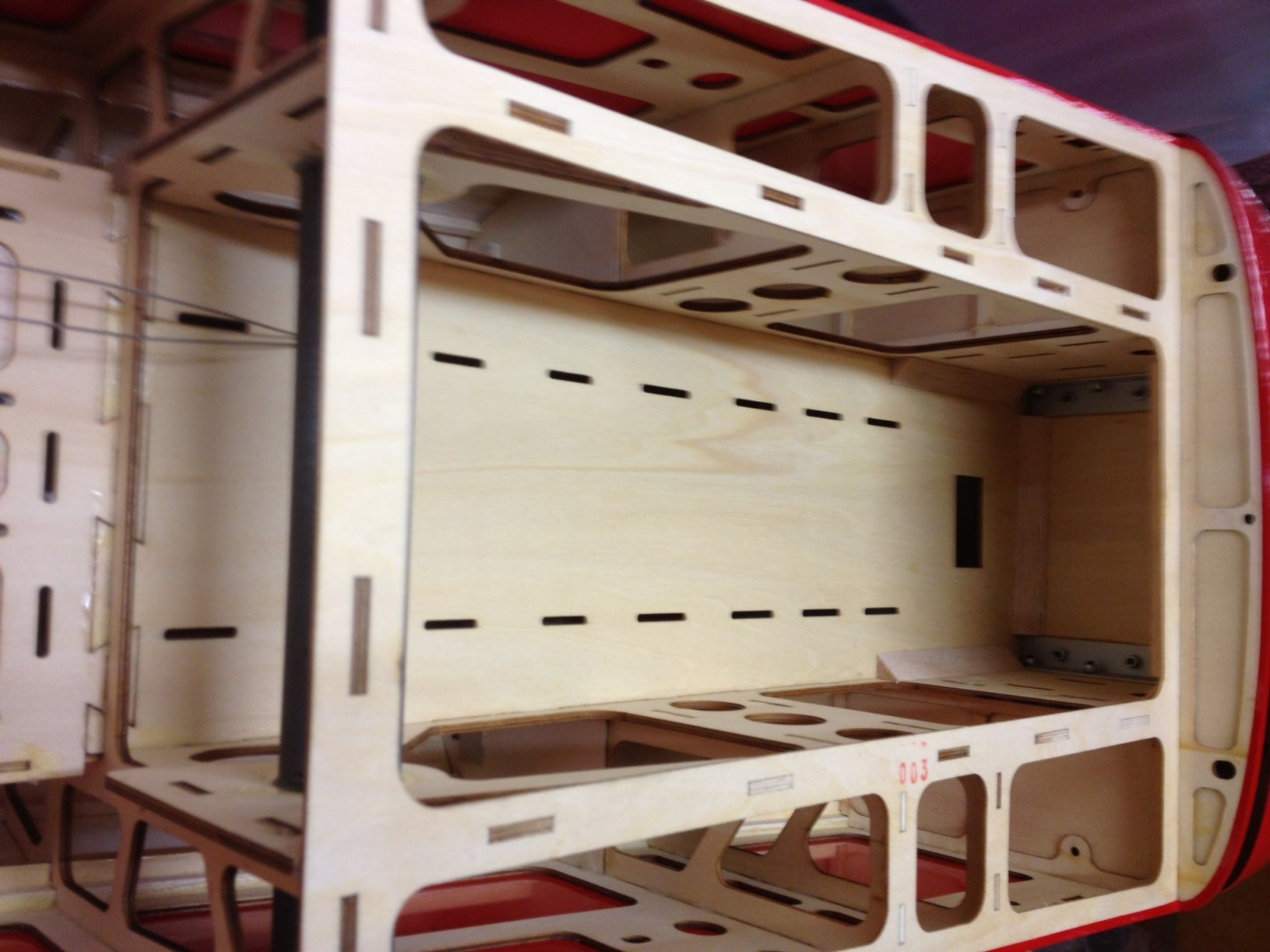

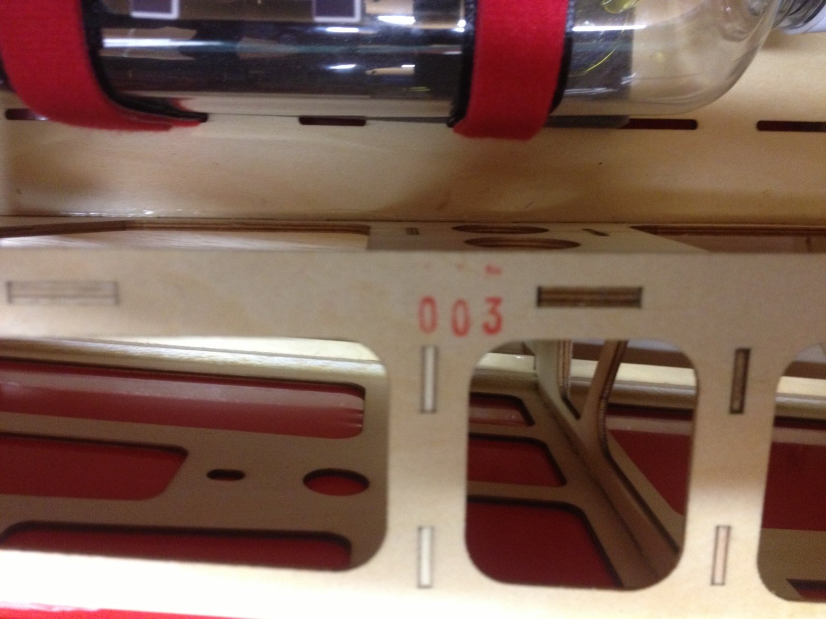

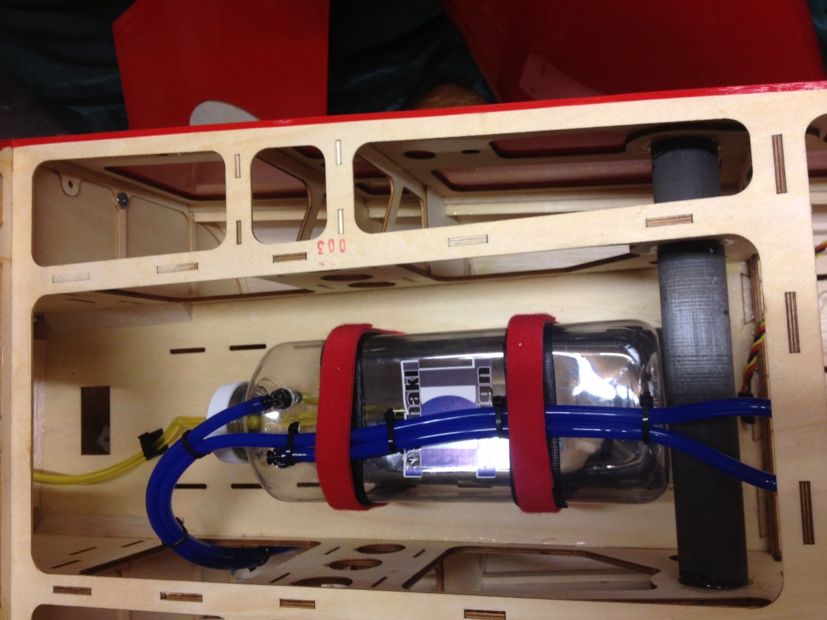

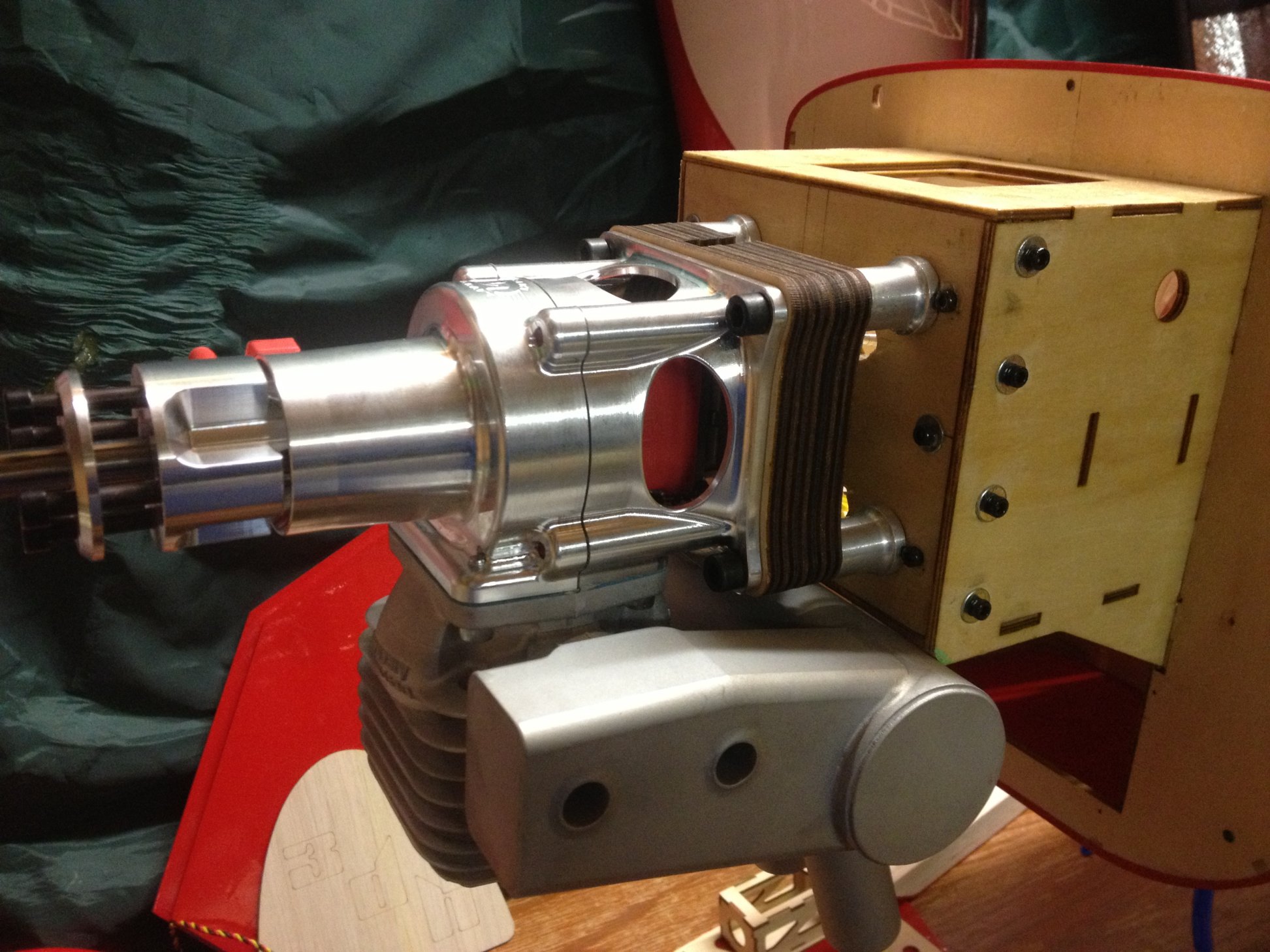

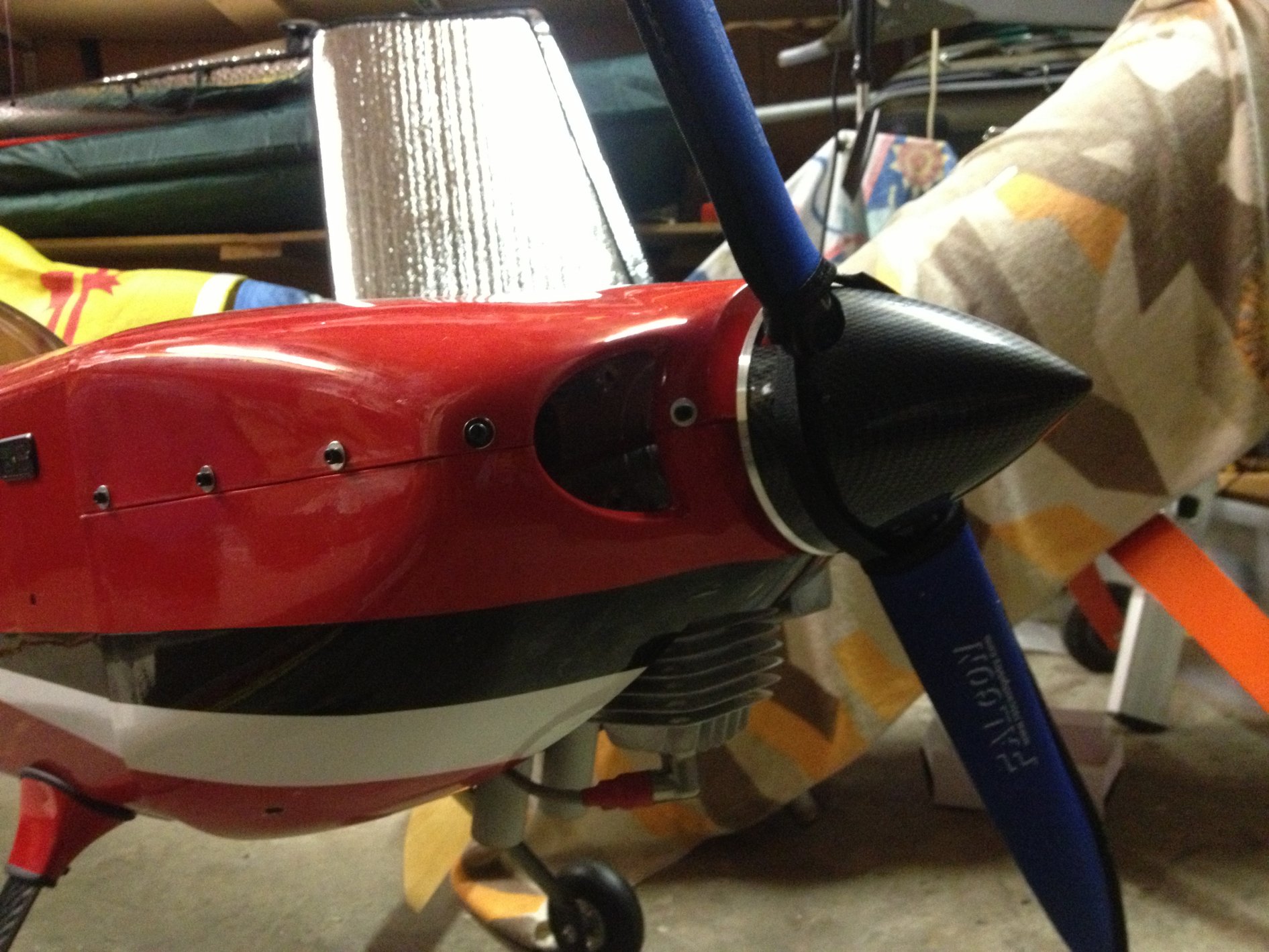

Fitted the motor, throttle & choke set up tonight, running a bell crank for the choke that come out the side of the plane :p, also fitted the tank all plumbed up .Servos will be tomorrow nght.

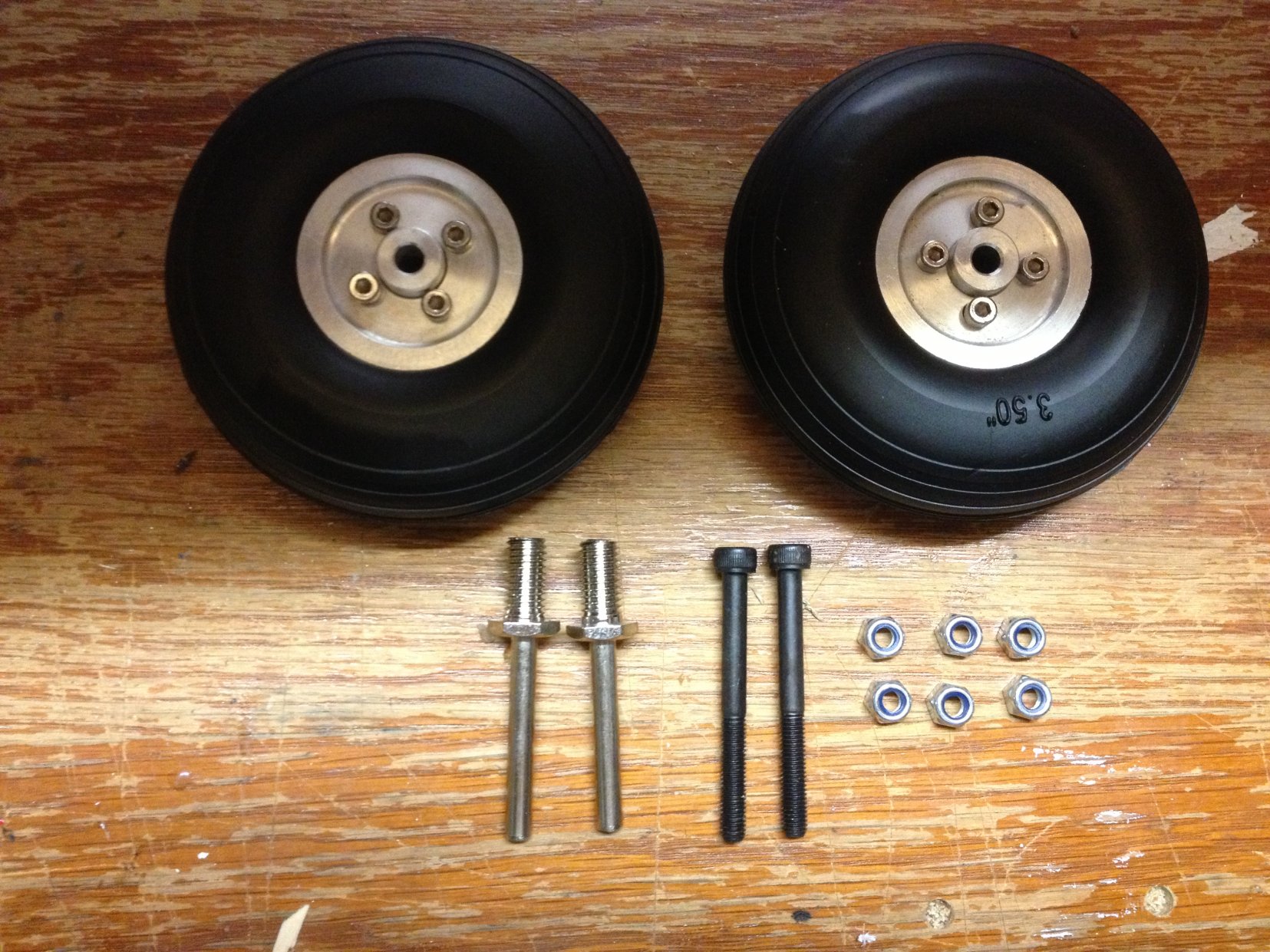

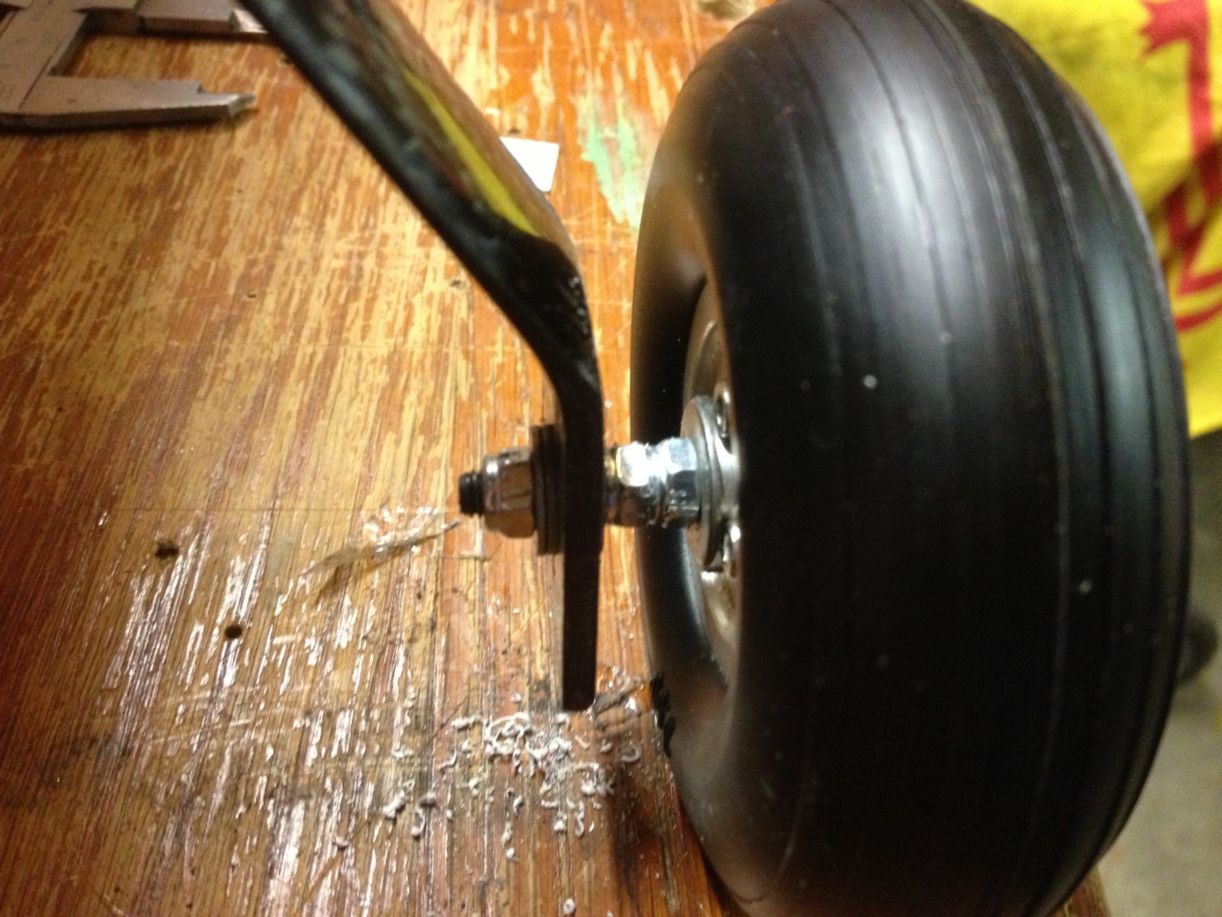

ok big night that was got my wheels on & i don't use the axels supplied as wheels fall off , i use a high tensile cap screw with nylocks as its very reliable for 40% so im going with that on the 92.

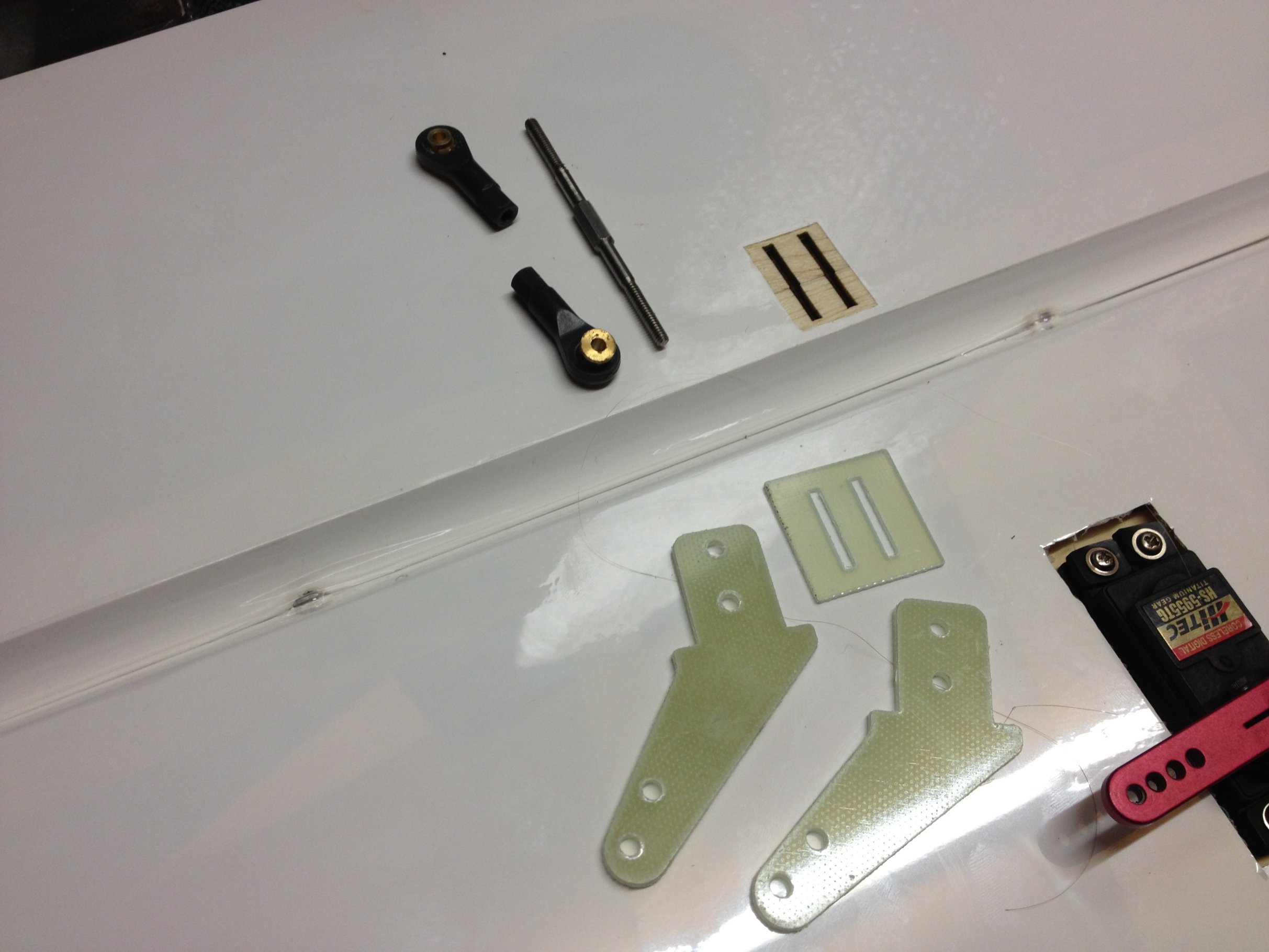

Servos flitted all round went with the 5955 on alis & elv halfs as i will use the 7955 on my comp arf. I will be going with the rudder servo in the rear as i love the authority of my 40% H9 SU26 set up \, don't like pull pull :sadface:

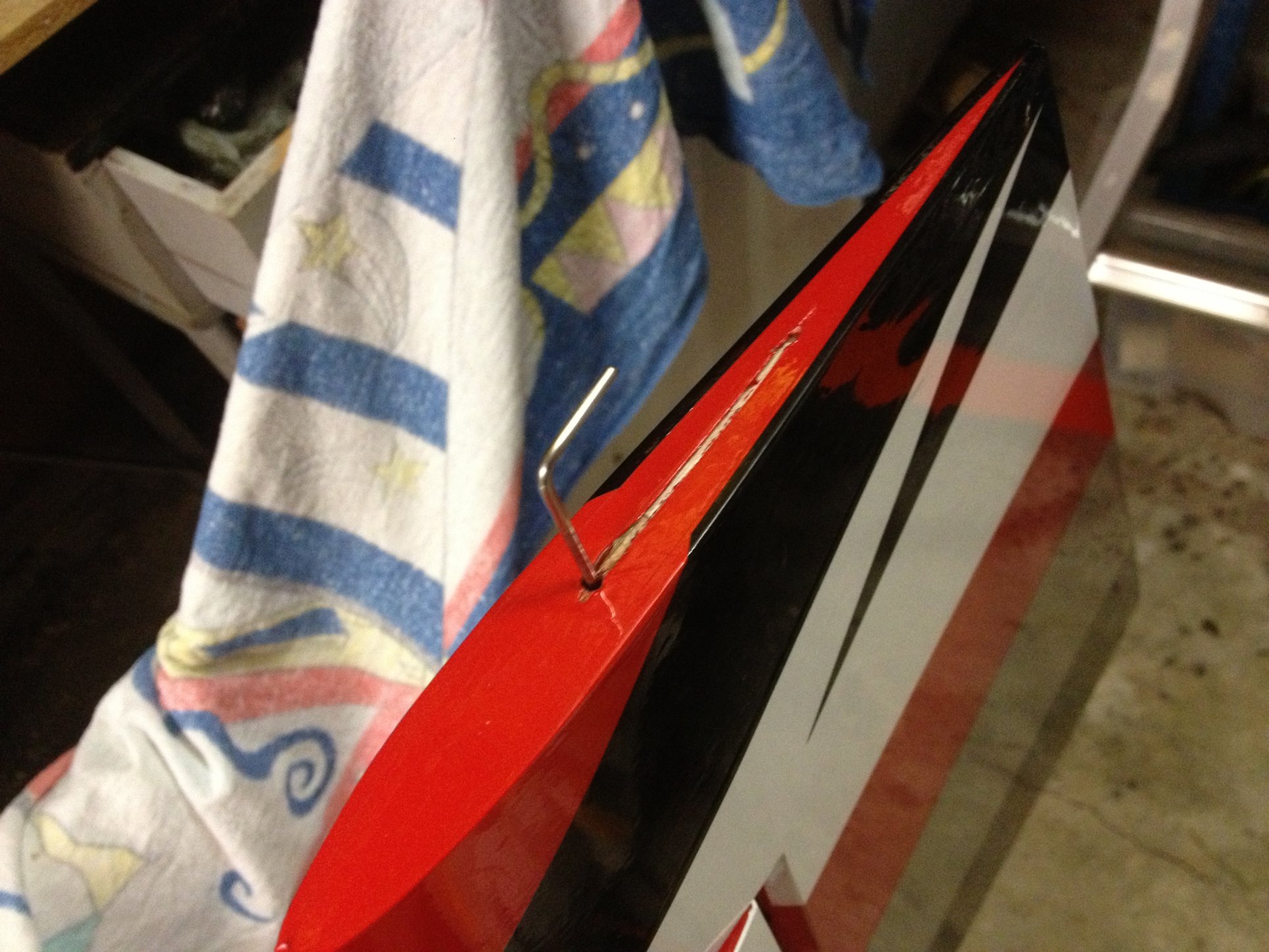

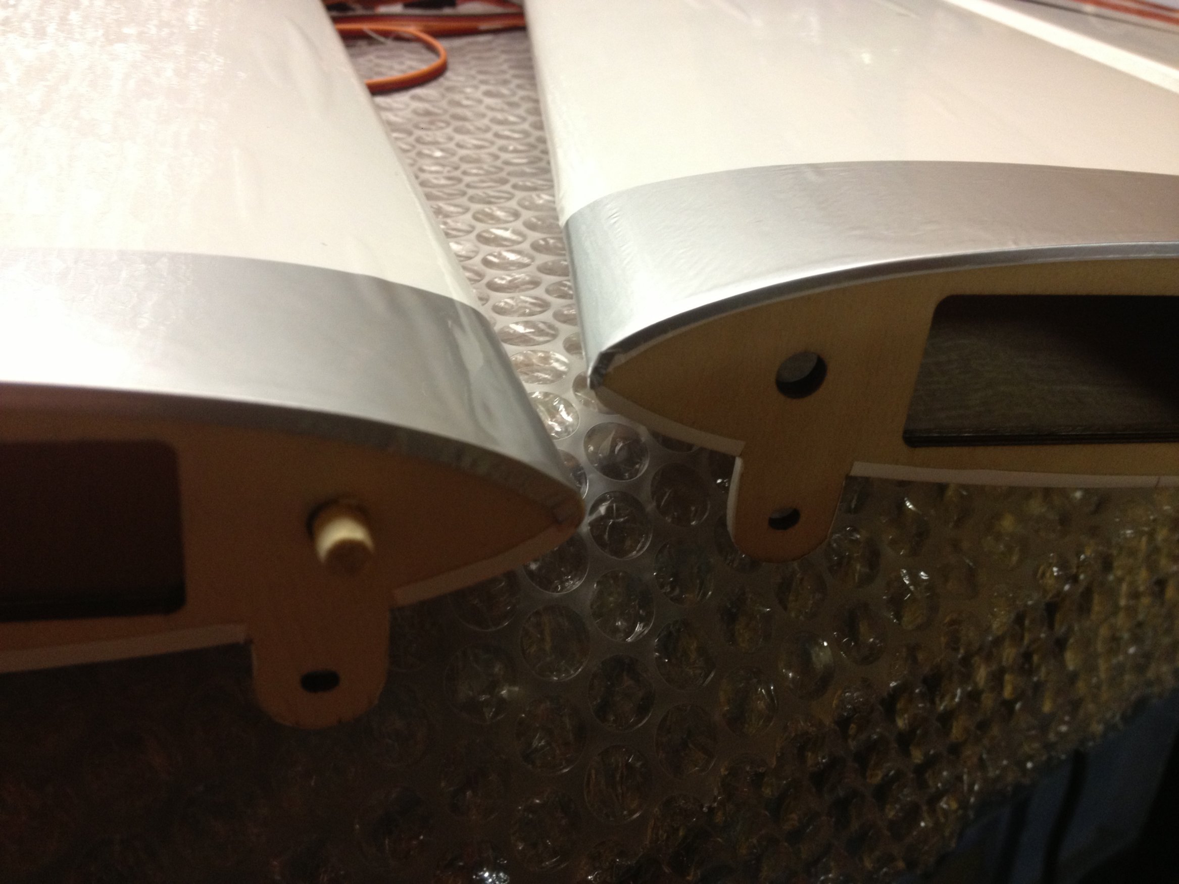

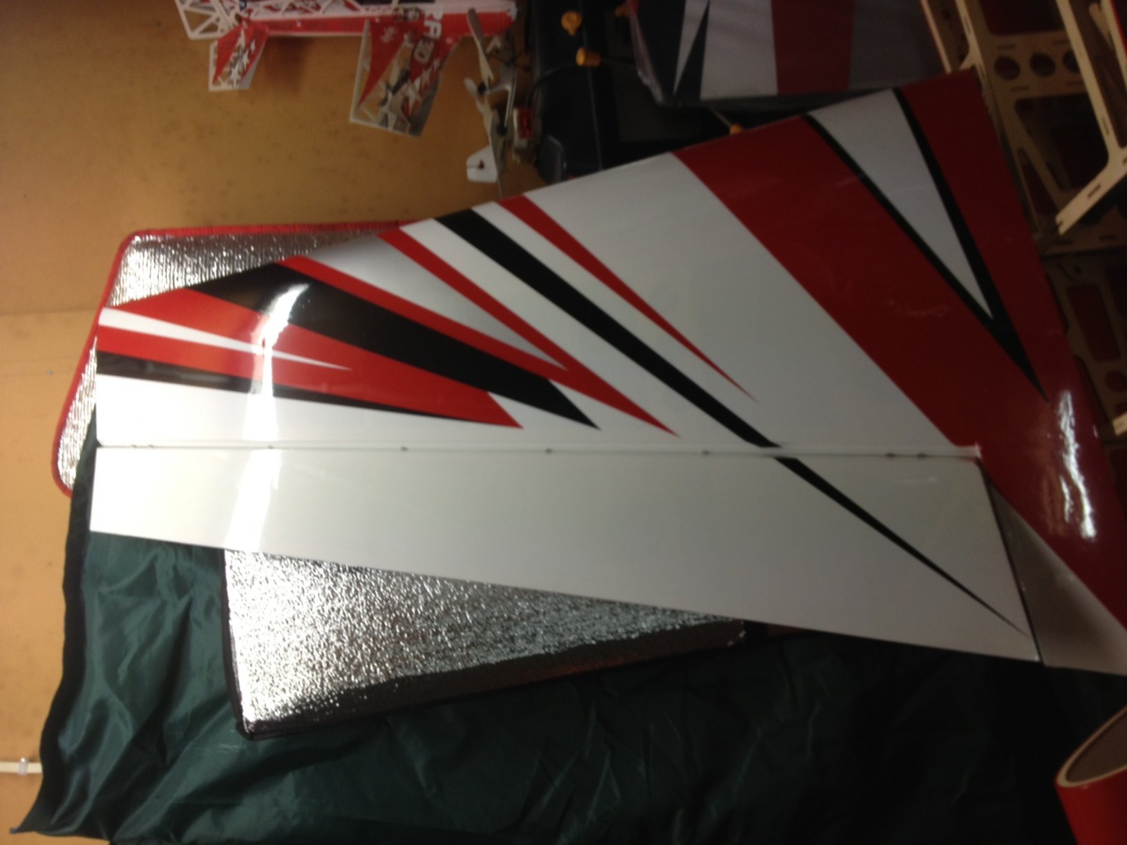

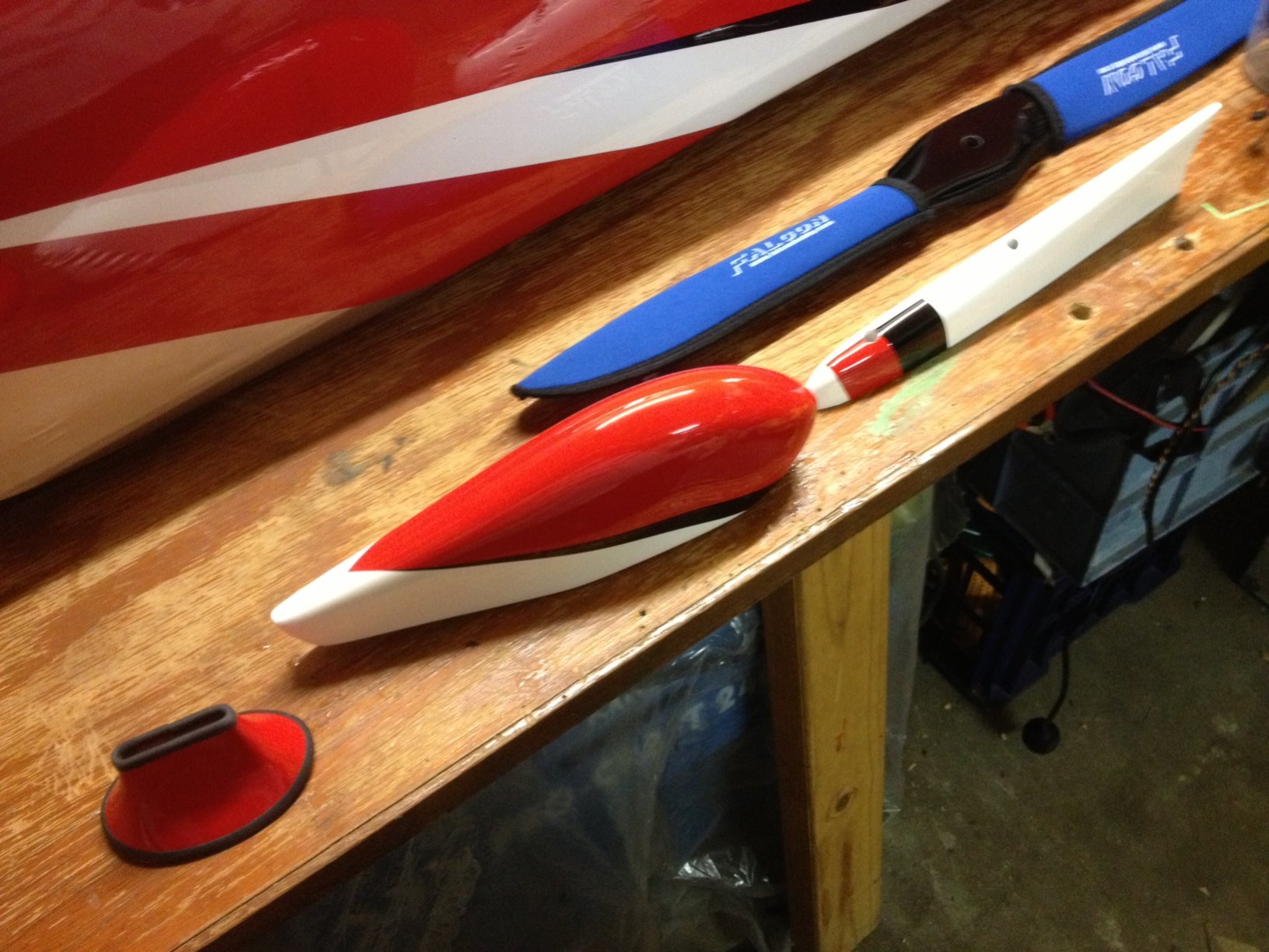

Problems have came across , the elvator half must of been a friday arvo job as the covering is terrible. I will fix them, they forgot the locator dowel in one :facepalm:
buy some servo arms tomorrow, hope the battarys &switches turn up as i wont to fire this bugger up. So far 9 hrs work should be built in less then 20hrs
