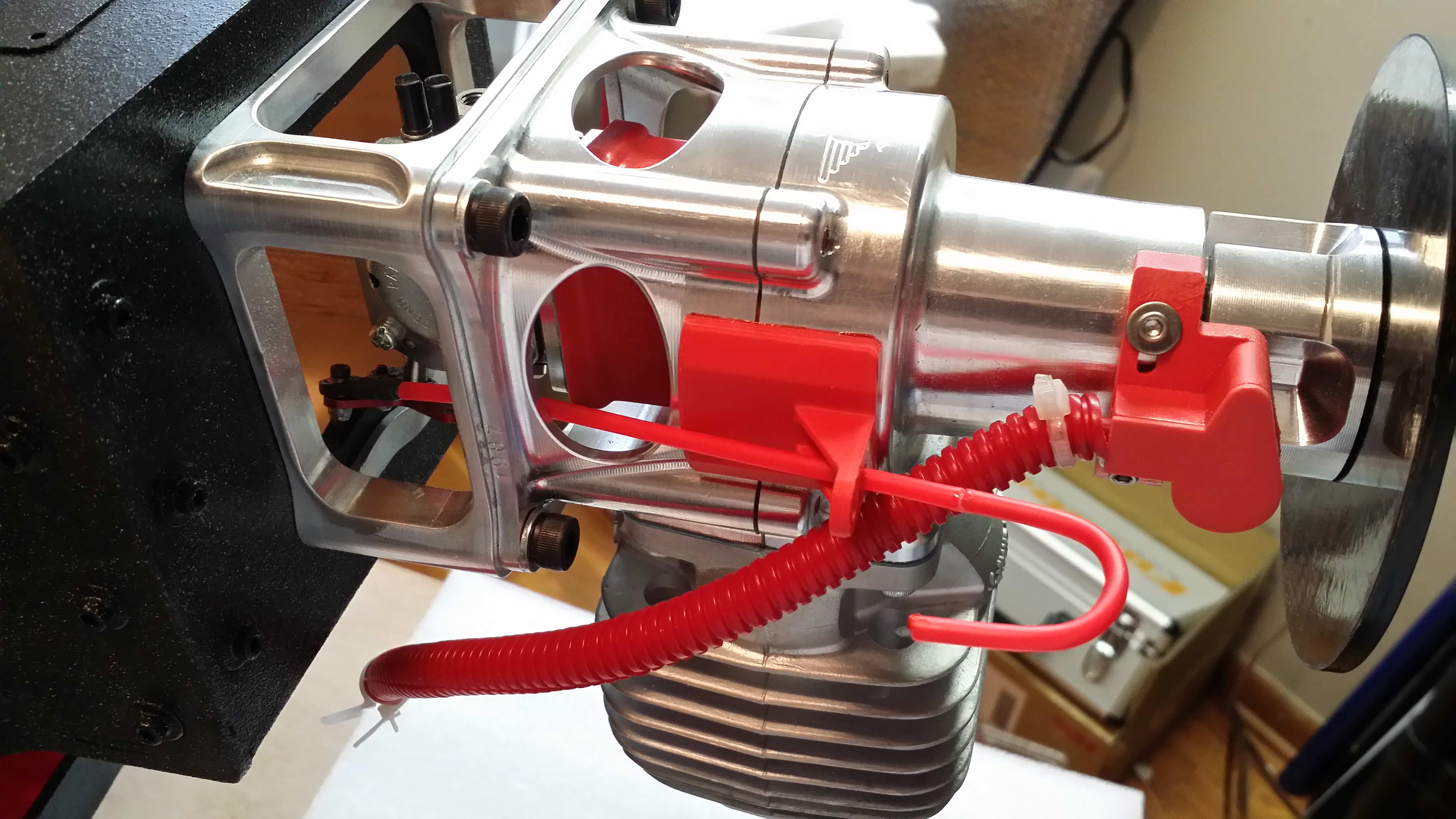

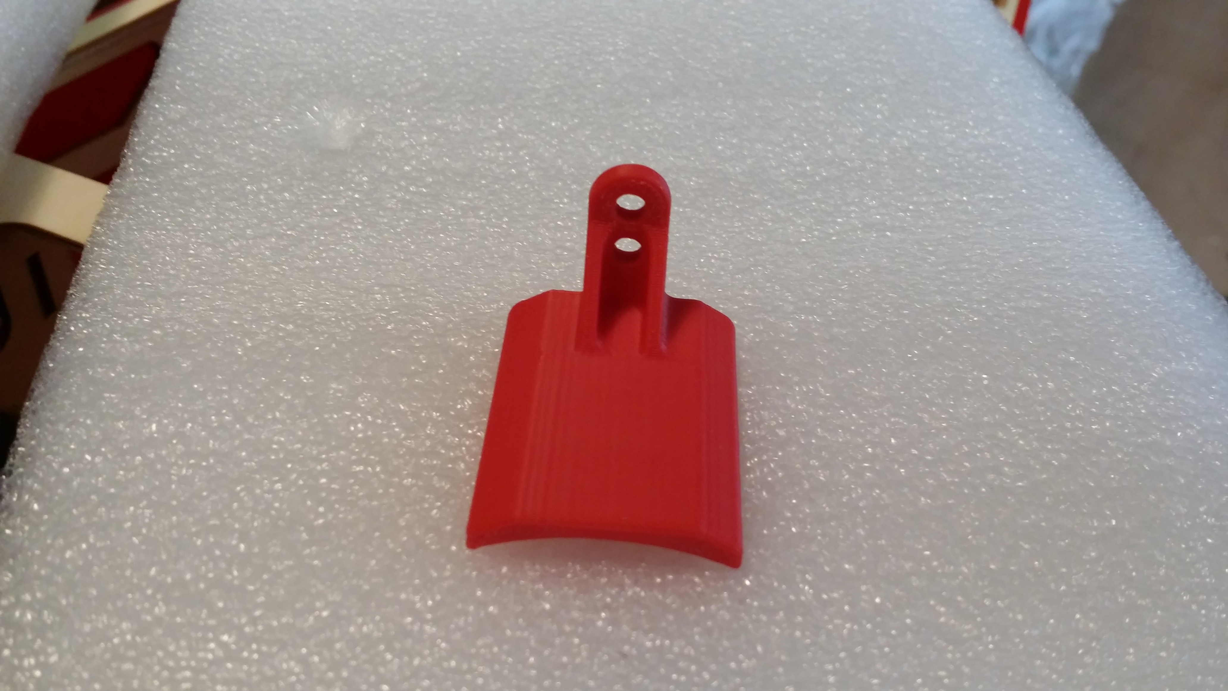

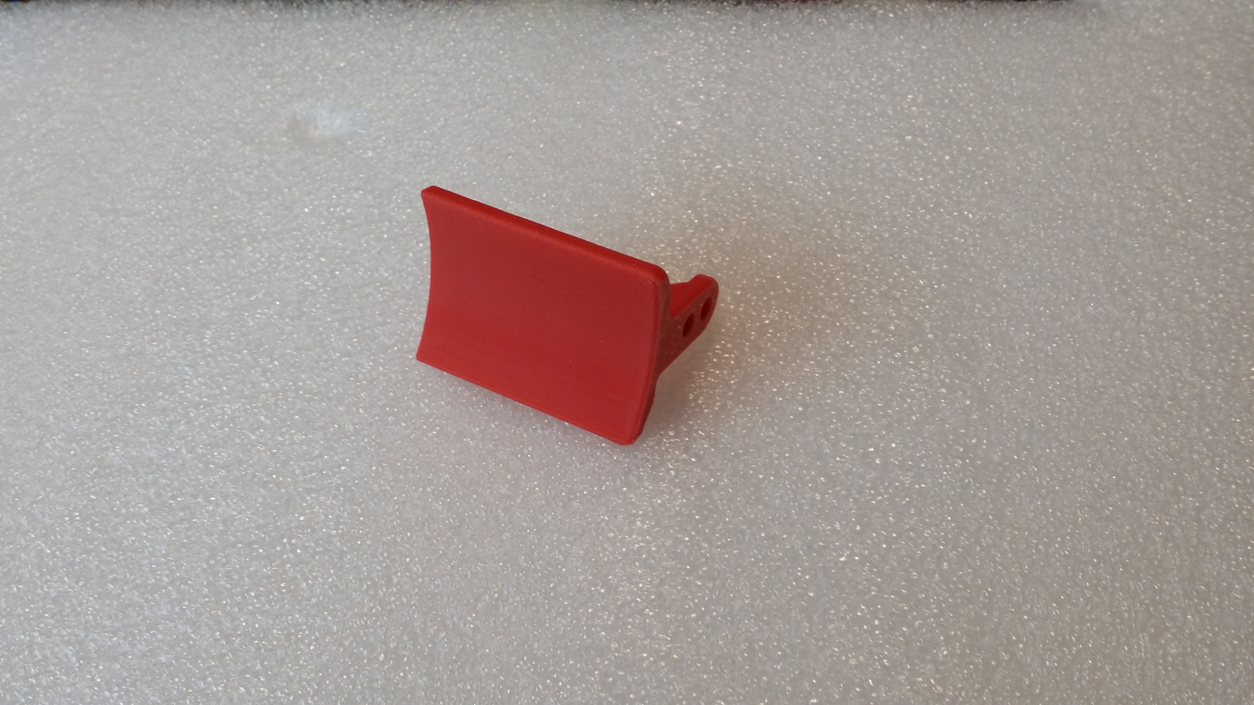

Want to thank Gary Hoffman for making and sending me these cool little 3d printed DA-60 choke brackets. Makes it way easier and adds some bling. I think he can print them in several colors.

He said to use red rtv kinda thick, he also said that Arron Bates and himself have used them all season and have had good luck with them staying in place.
