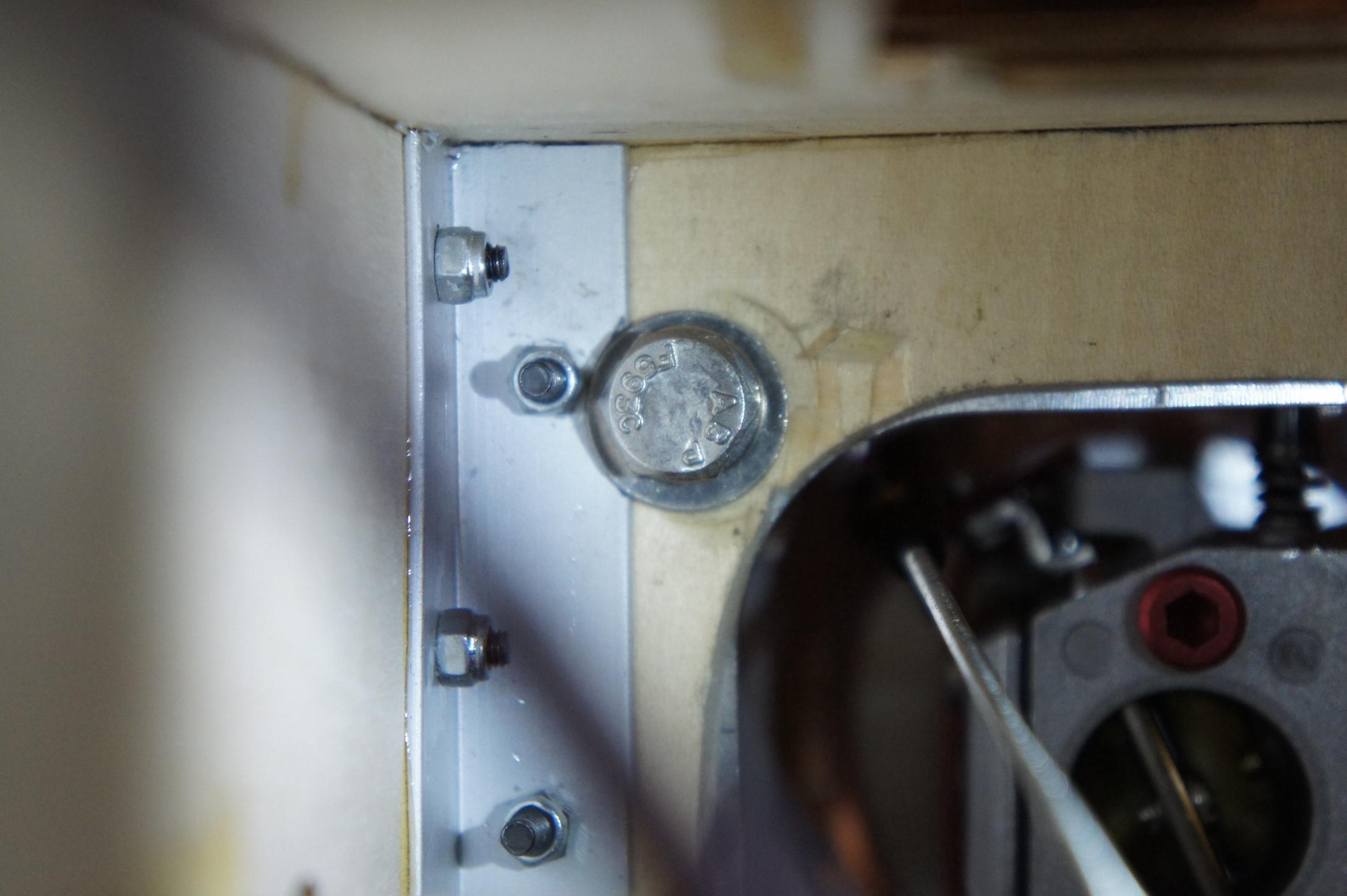

Craig,
I will be finishing up my DA60 install tonight.
The 60 does come with some laser cut plywood spacers. (or atleast it came with mine from TroyBuiltModels). I unfortunately have mixed them together with the ones I got from the planes previous owner. I can try to figure out which are the used ones and which are the new, if you want to know how much spacing they provide.

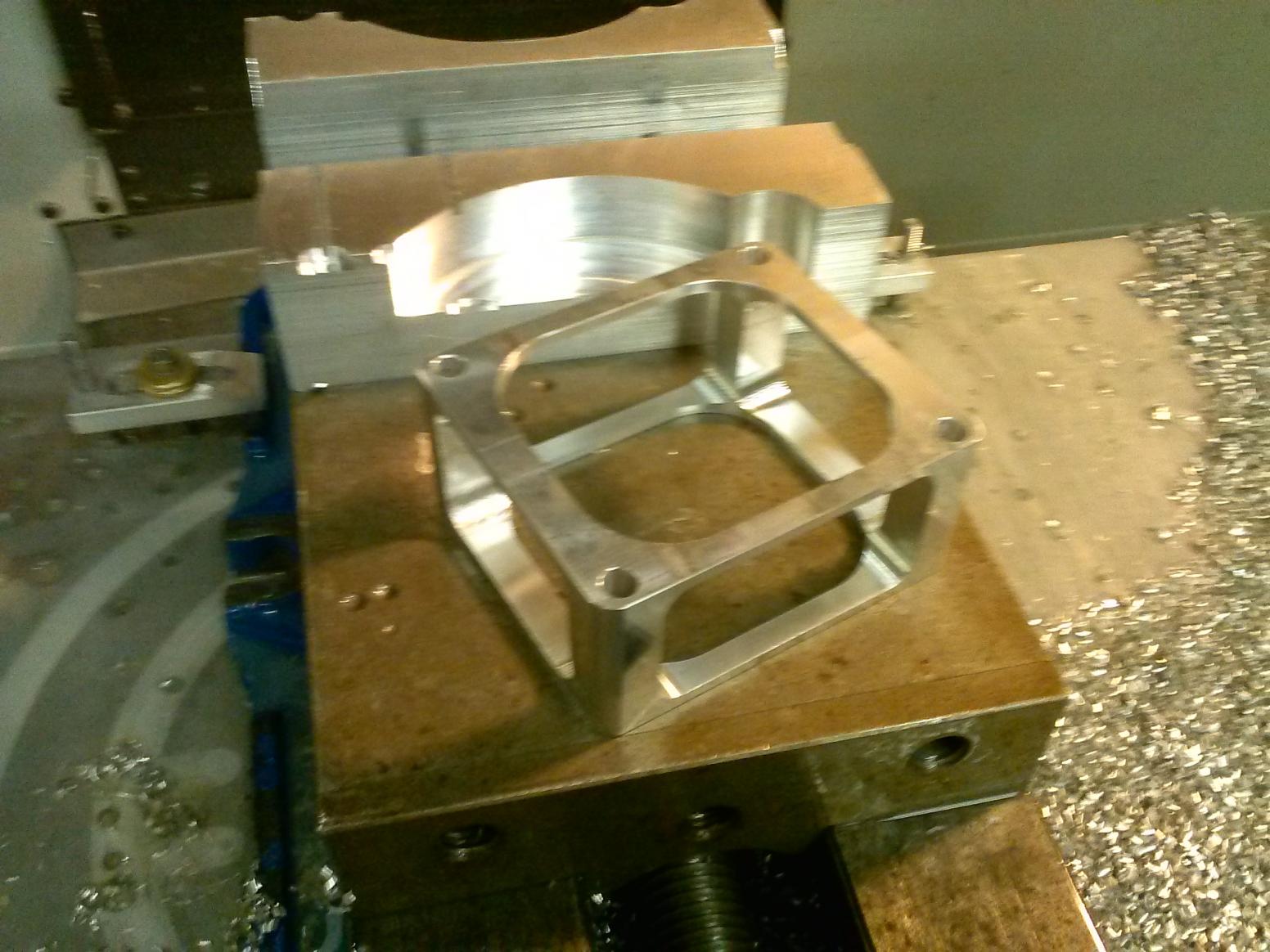

Since I'm a machinist, I fashioned up my own aluminum one. Vey similar to the one you can get from 3DHS (Blazing Star Products ). That one says it's 1.5". I made mine 41mm (1.614"), which gave me a 5mm (0.197") gap (pretty sure, I'll double check when I get home).
If you made your stand-offs 1.5", it should provide a 0.1" gap.
And yes there is some odd washer and bolt fitting with the 60. I'll get some pics tonight when I get home. Not sure if there are/were any blind nuts pre-installed on the firewall, as mine is second hand.
Also I'm not sure it makes a difference, probably not. But mine is the FB version. Not sure if the cowl is the same as the newest version, but most likely is.

We are going with a 1.5" standoff since that's the size of the mount that 3DHS sells. It sounds like that will work based on your info as well.
I'm still looking for the distance from the DA60 mounting holes on the left side to the washers. it looks like the one on the top left might cause some intereference. This is on the front of the firewall.
Also, the distance from the mounting holes to the metal bracket on the inside of the firewall, also on the left side. if I supply blind nuts, it looks like maybe the two on the left might need to be modified slightly in order to fit.

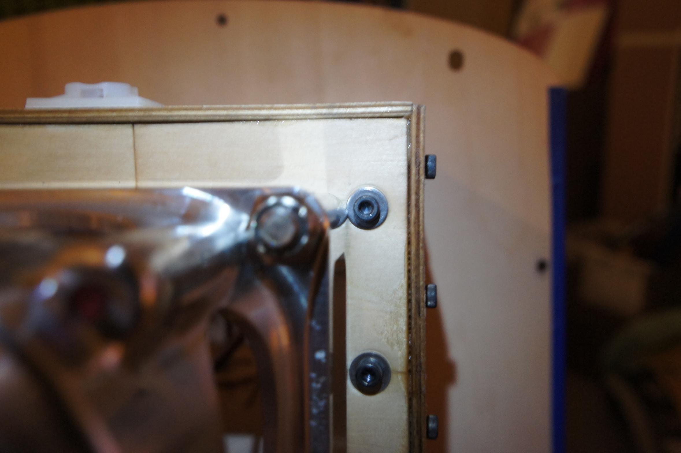

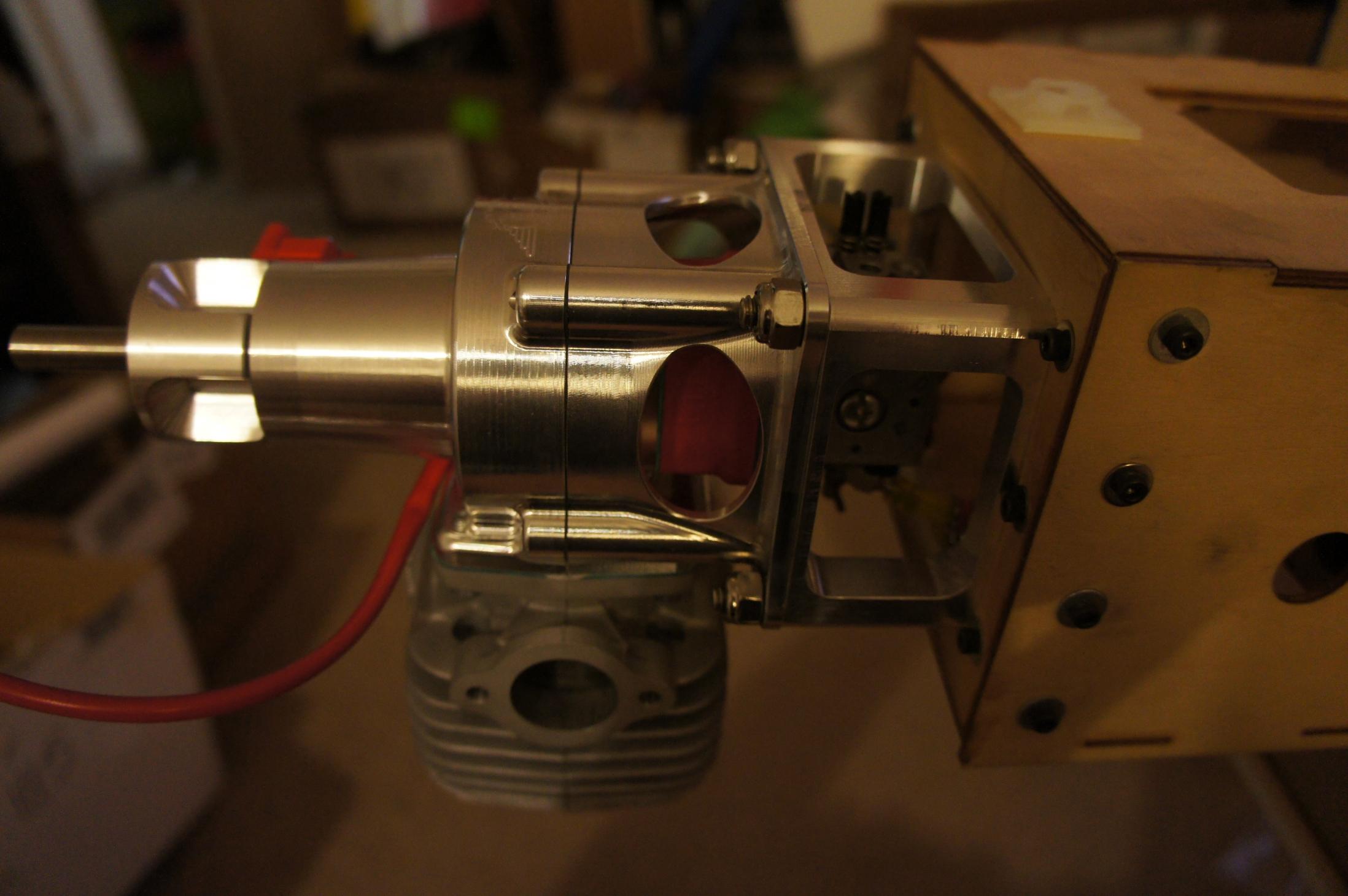

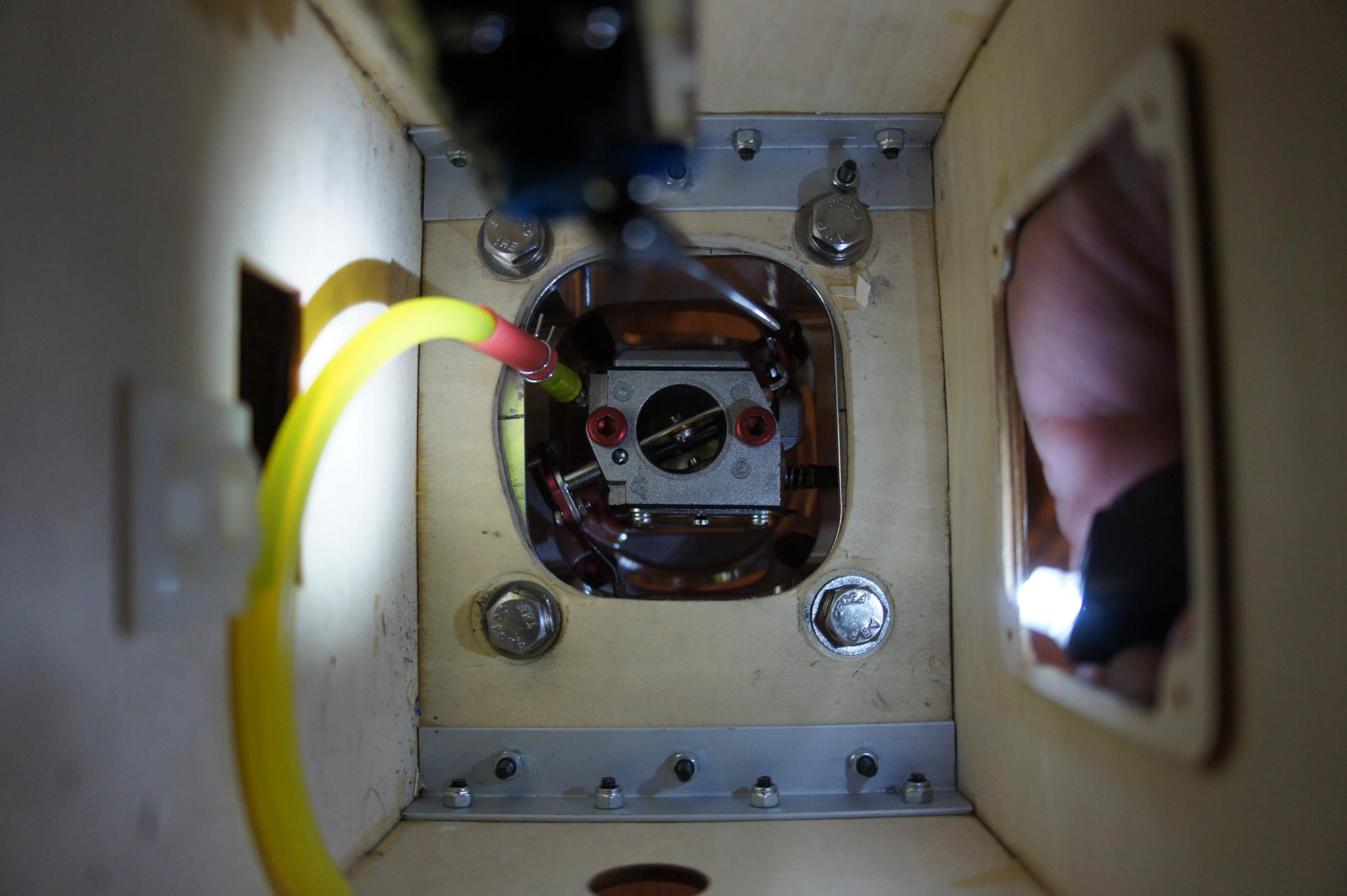

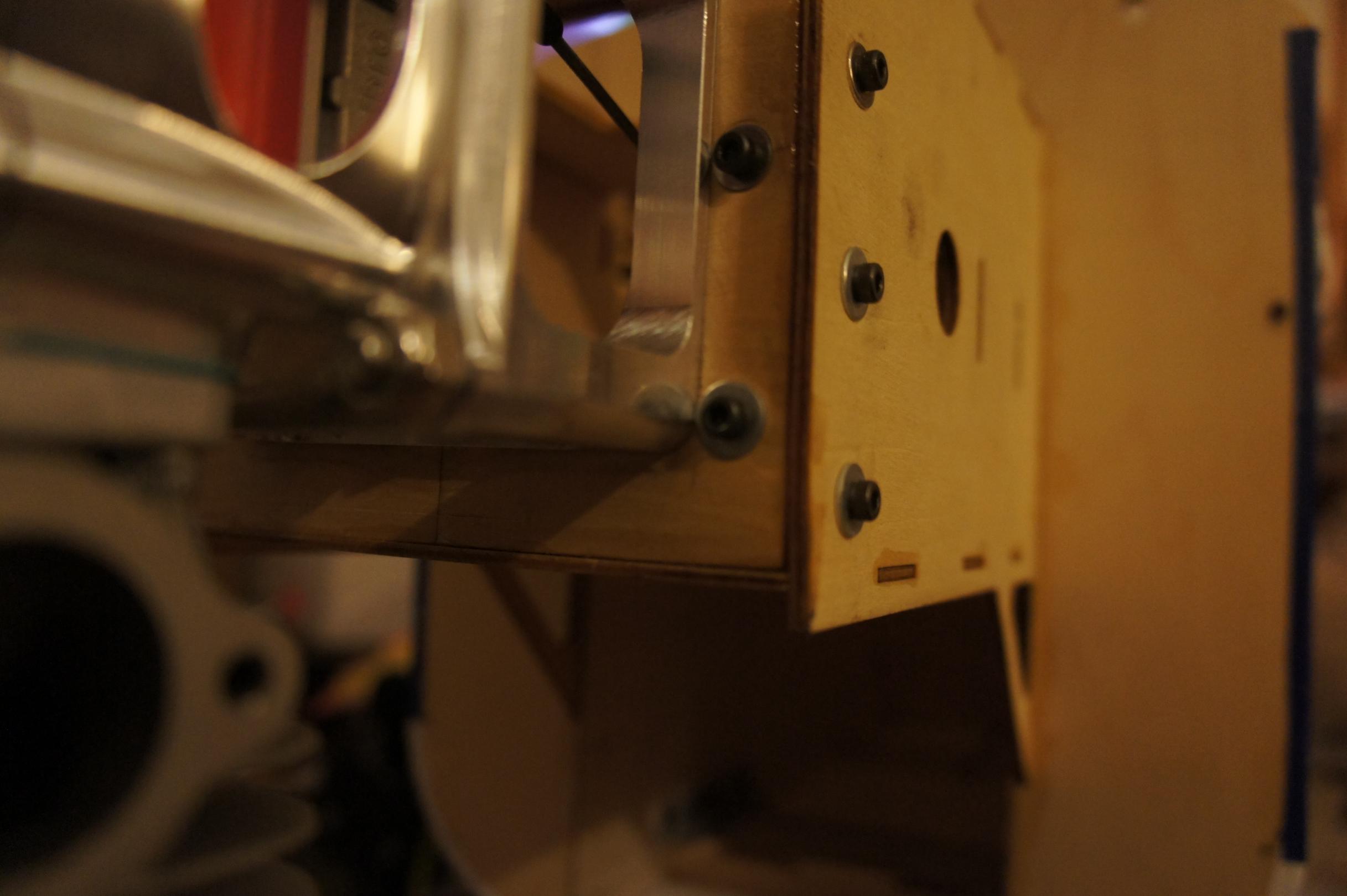

Here are some pics of my set-up. The mount I made is the exact width of the DA 60. On the upper right screw I had to swap out the M3 washer with a 4-40 washer cause it was just a fraction smaller on the OD.
When looking at the inside of the motor box. I would have to advise against blind nuts. The right side mounting bolts (when looking at the front), are just too close to the aluminum brackets on the inside of the box. I used 1/4-20 bolts to mount mine up, although M6's would work just as good. The approx distance, center to center, between the motor bolt hole to the upper right motor box screw is 0.375.
