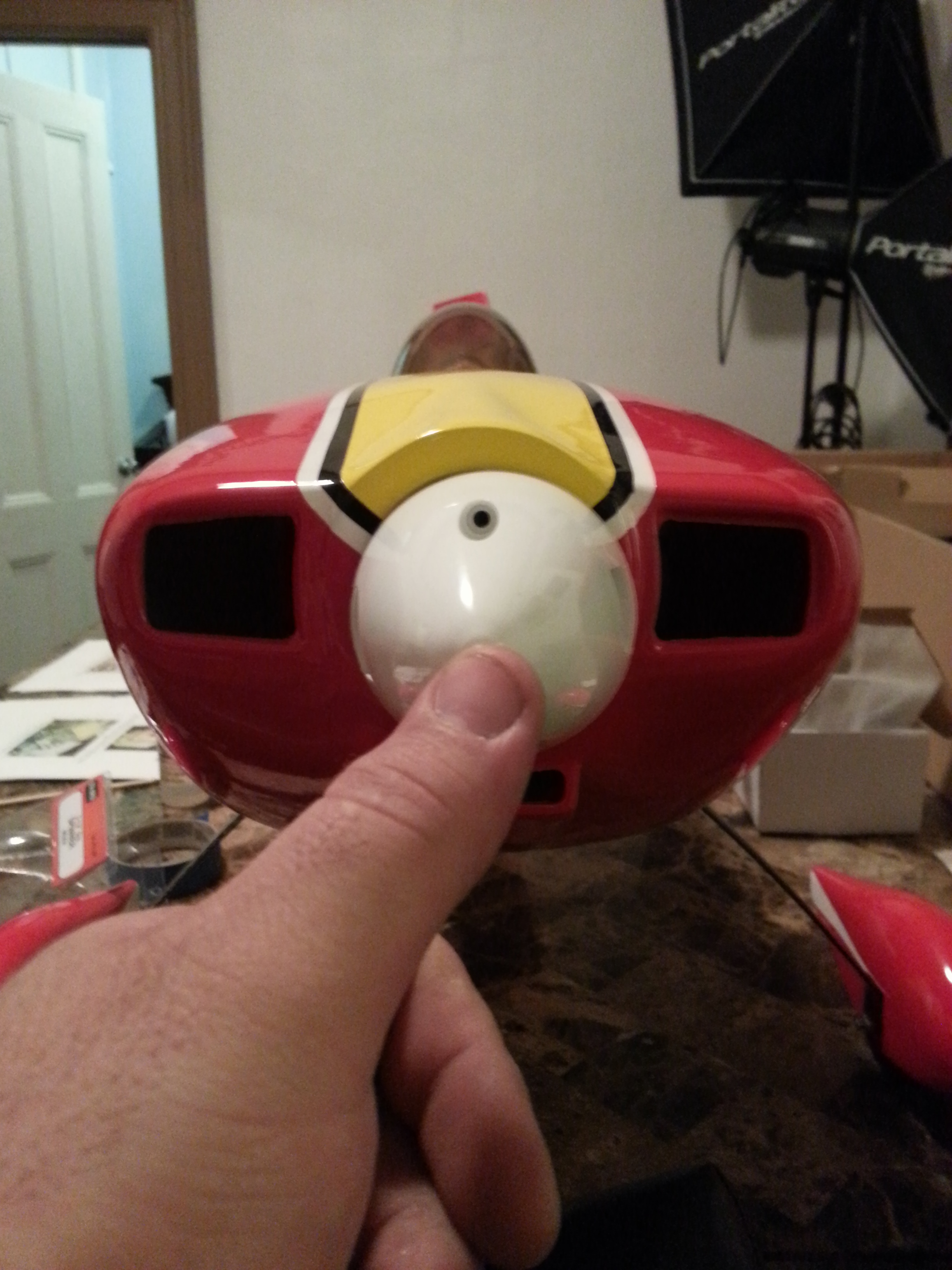

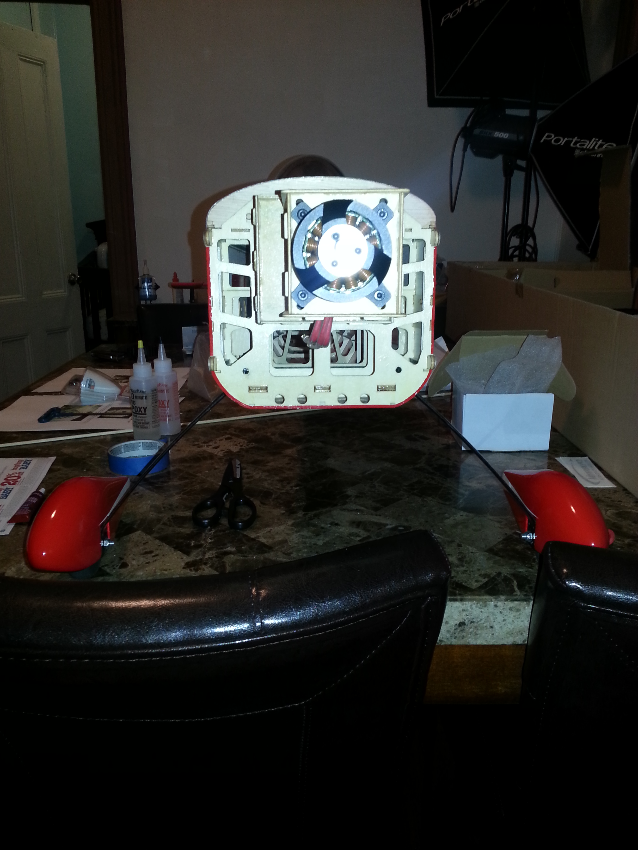

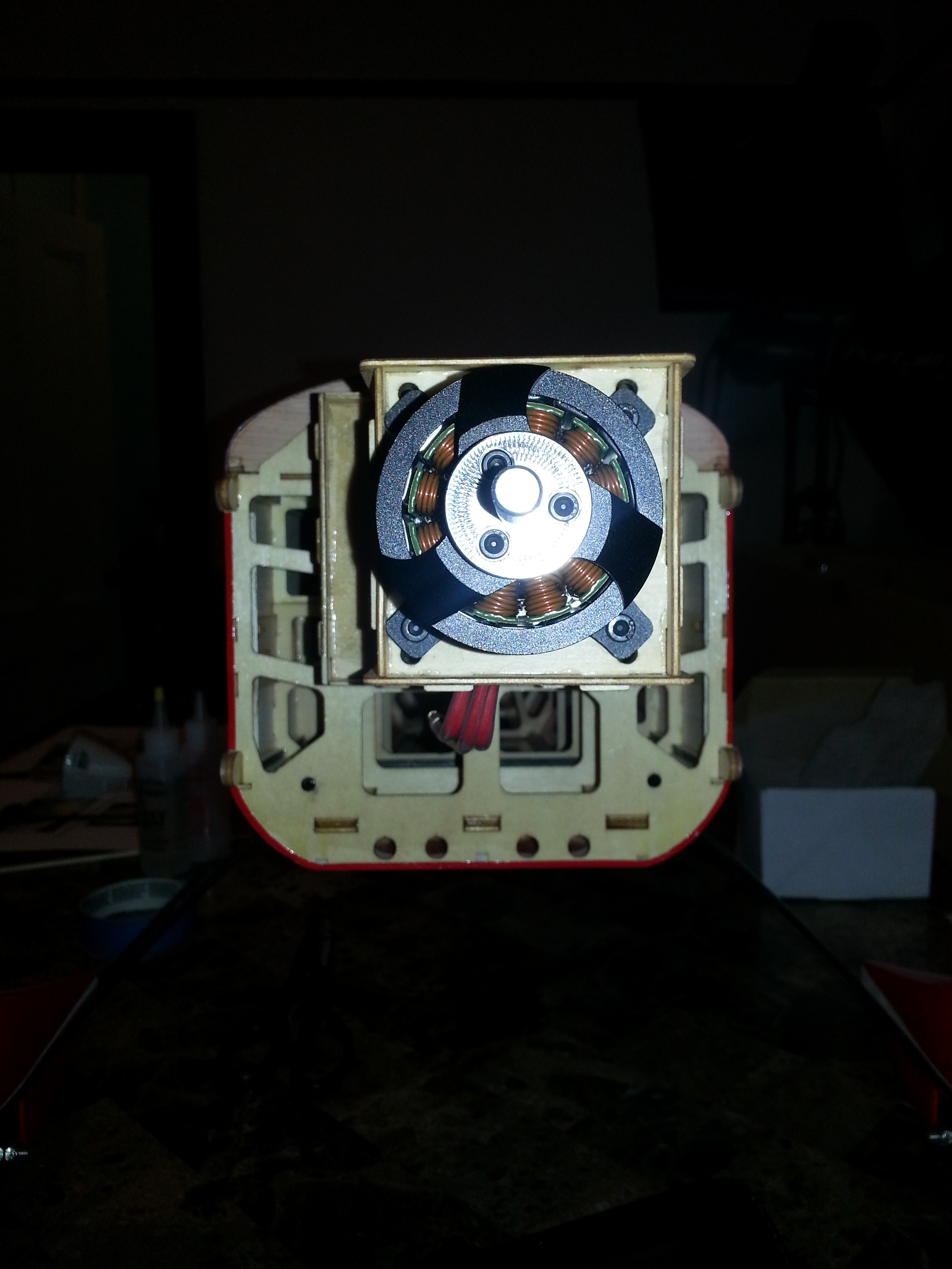

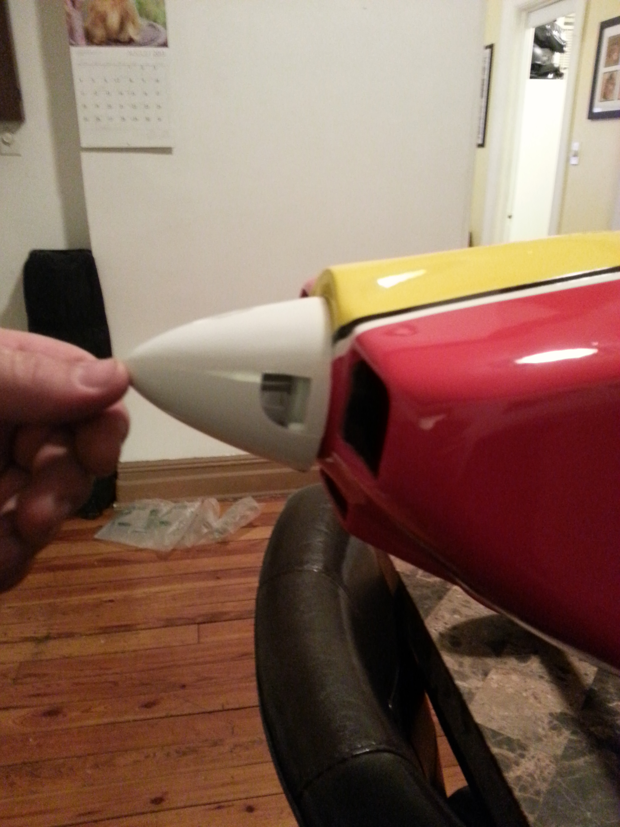

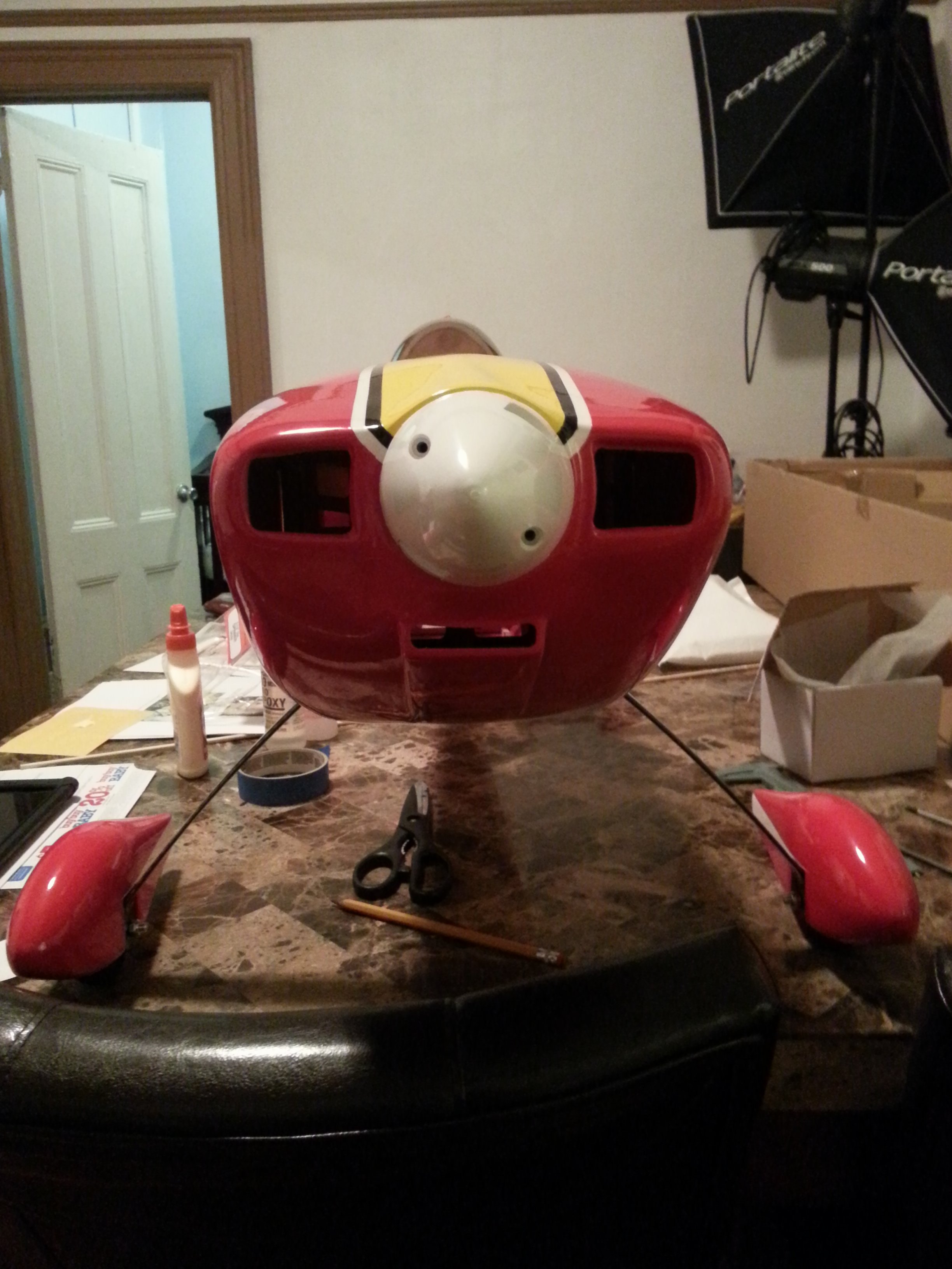

Paulie, looks like the motor is pretty well centered to me. Can you take a peak at the cowl ring? I've had a couple 3dhs Edges lately where the cowl ring was glued incorrectly.
Also, since you're going electric, I suspect you potentially could remove the cowl ring entirely, and simply center the cowl on the motor, then screw it down. I've had big gas planes with no cowl ring, and everything worked fine.
