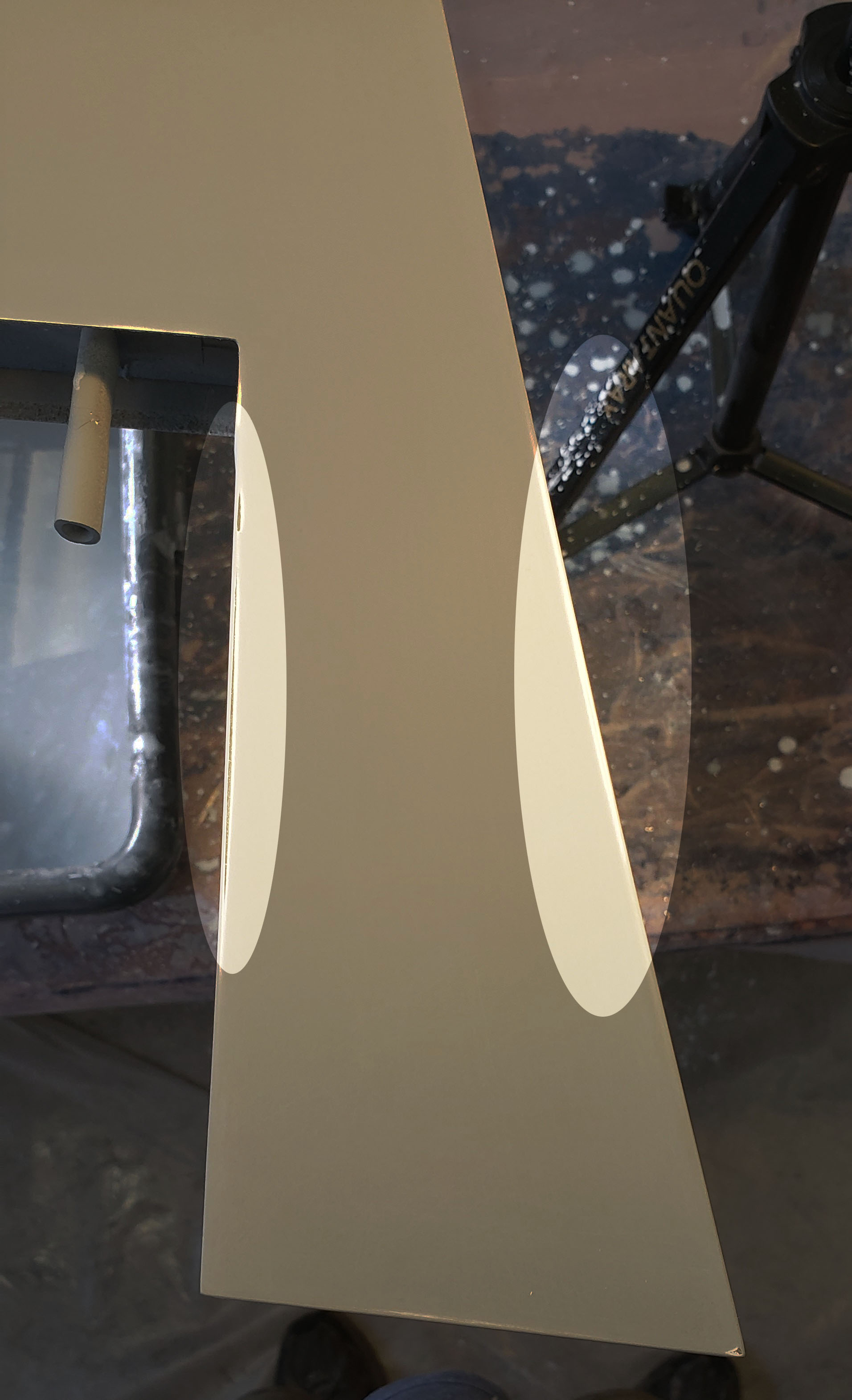

    @Jetpainter ......Question for the painting pro....Final (hopefully) wet sanding of the primer (Nason 2K) on my Krill. Every now and then there will be a very slight sand-thru of the primer, to either the underlying white gelcoat or glass. All still very smooth. In the pic I've highlighted a couple of such areas. These happen on or near edges.
    Should I touch up the primer on these spots or just go with the color? Using Chromabase colors.
    Thanks for the guidance!!!!
  3. Jetpainter
    Jetpainter 640cc Uber Pimp
    Small cut throughs are usually not a problem and don't require repriming. Just make sure the color stays uniform over them so it all looks covered. You can put a coat of base on everything then hit the cut throughs separately so they're covered then coat the whole thing as needed.
    dhal22 and Pistolera like this.
  4. Pistolera
    Thanks!....that'll save lots of time. I was afraid if I retouch those areas with primer, I'd have to wet sand again before color.
    I plan on shooting the whole plane white, making sure I have good coverage for areas that will remain white.
