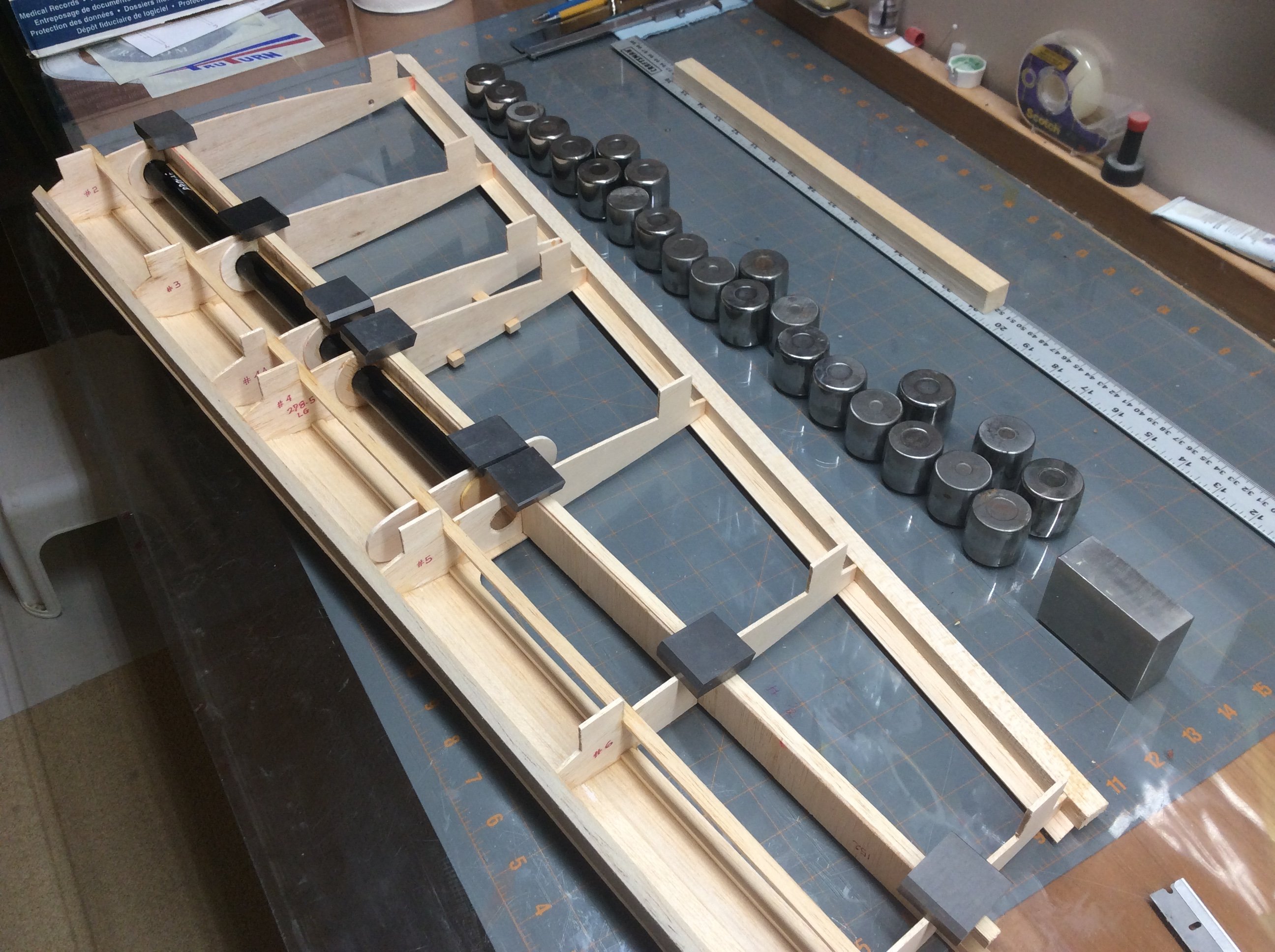

The way I have done all the glitter series planes is as follows. Fully sheet top and bottom from from R1 out to R3. Then from r3-r4 go from LE to main spar. The rest of the way just go from LE to the subspar.
Just making sure we are on the same page R1 to R3 is the first rib from the fuselage. Rib 1 and 2 are glued together.
I still consider the first two ribs as R1 that are glued together. I may have them labeled as 1 and 2 on the plans. When I say from r1 to r3 I'm referring the r3 as the rib on the plans the tube stops at.

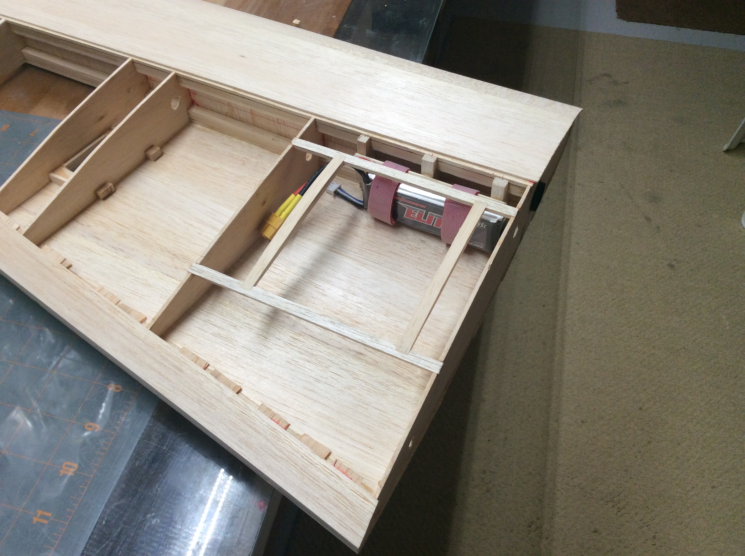

Made a little progress today goat the leading edge sheeting on. Flipped the wing over and added the small balsa wedges between the shear webs and the sleeve and epoxied them in. Hopefully tomorrow I can finish the top sheeting.

@BalsaDust the access hatches in the wings, do you access from the top or bottom. I know the bottom looks better but a lot easier to work on from the top.

Hatch location is personal preference. I always put them on top for convenience. Aileron deflection I normally max out and watch how it flys. Some planes I end up backing it down on as they will start to act as air brakes and the plane will rotate slower and less violently. Same with the elevator deflection.
