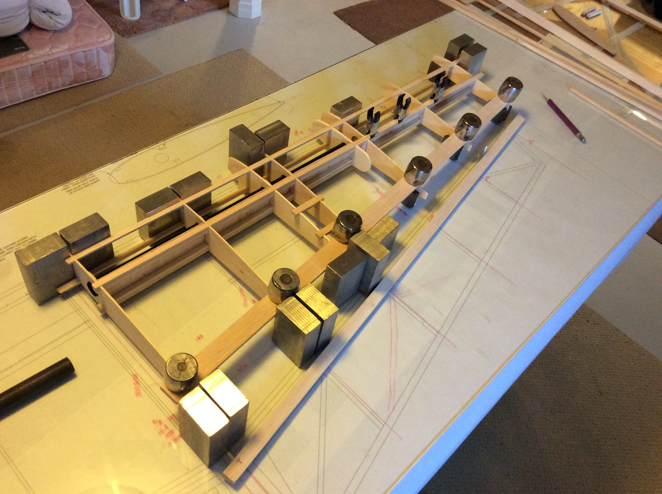

Made a start on the wing it is all jigged together no glue. Just have to fiddle with it a little till everything is square and straight and then when I think it is so then start adding glue and keep checking.
Still have to figure out rib number one to make sure it is square and flat.

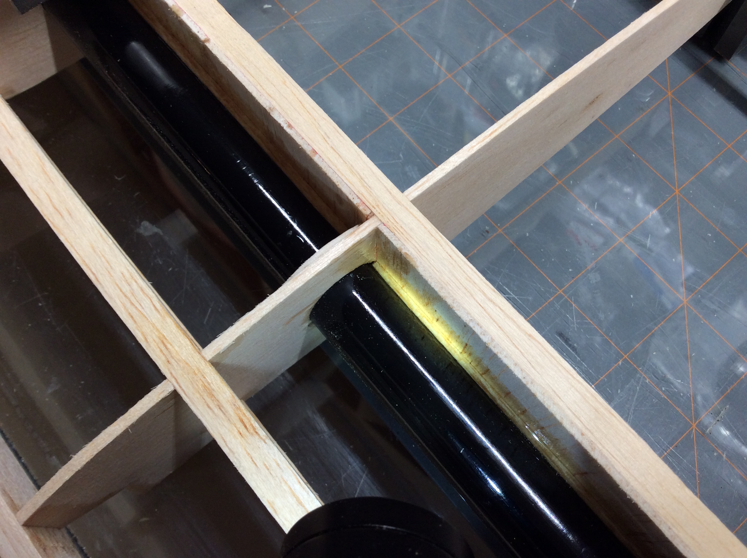

Made a small change on the leading edge it is glued to the ribs and then sanded to match the rib radios. Will then glue the sheeting to ribs and the leading edge all at once. Very difficult to keep 1/16 balsa flat and true.
Question on the sheeting, I was thinking of sheeting from the leading edge to the main spar for the full length of the tube, or should I just sheet up rib four which is rib before the tube ends. Just does not seem right.
The way I have done all the glitter series planes is as follows. Fully sheet top and bottom from from R1 out to R3. Then from r3-r4 go from LE to main spar. The rest of the way just go from LE to the subspar.
Thanks I needed that info, that made up my mind.
