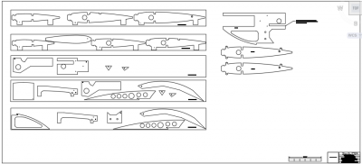

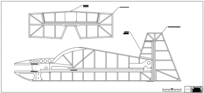

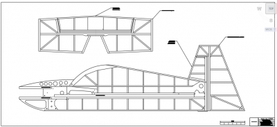

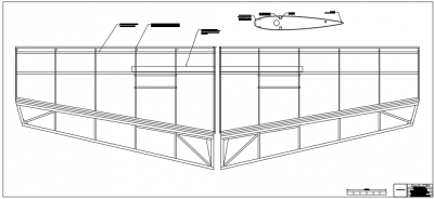

    Alright here is a thread just for the 20cc Edge profile. I will keep this first post updated with the important things we come across as people are building it.

    I have questions too!! I should probably wait until I get the plans, but what can I say... I am excited!
    A parts list of some sort could be handy to put together:
    Do you have a good source for the carbon tube?
    What oz/in servos, 100? Speed recommendation target?
    Gear size, wire? or?
    62" wingspan
    55-1/2" length
    950 sq in of wing area
    Two piece wing using a 3/4" wing tube
    Thanks for sharing your plans, and letting us put together one as well! Very kind of you.

    As I have it designed the landing gear is to be made of aluminum flat stock but you can do wire gear if you prefer. Choices on the tube is all up to the builder. you can go with a cheap 5/8" aluminum tube if you want from lowes or home depot. Down side is in a hard dork it will bend and you will have to bend it back straight. You can go with carbon. plus is it will be super rigid but down side is in a hard dork it will probably shatter and break. or you can go with a fiberglass tube. they are the best of both worlds as they will bend a lot before breaking but go back to their normal state after the impact.
