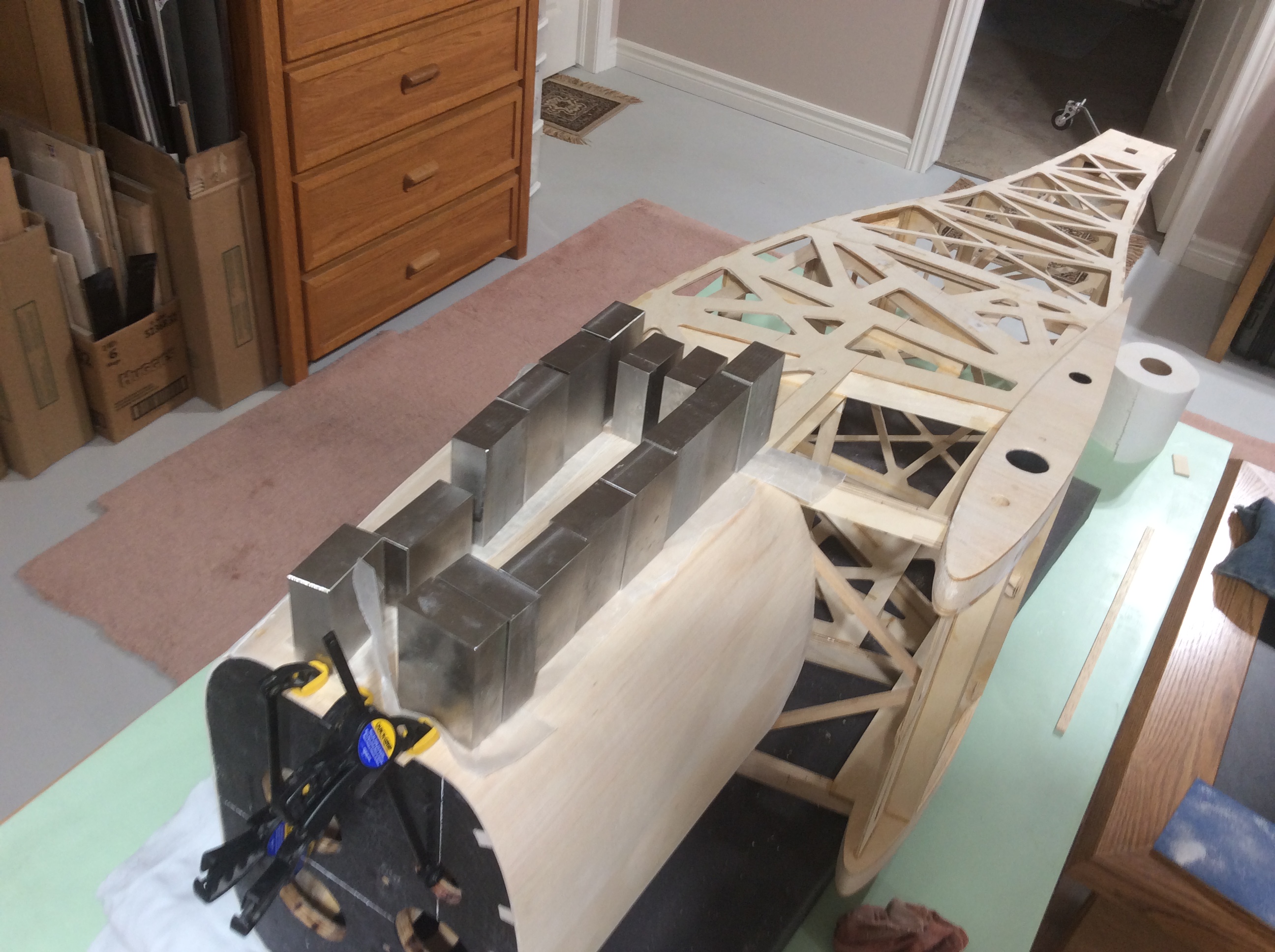

This side did not take as long all done in 4 hours well not quite still the glue needs to dry and a little body work and it will be done.
One thing that has to be noted is that a lot of inner structure is required for strength and something to glue to and hold the balsa sheeting in place when it being bend into place.

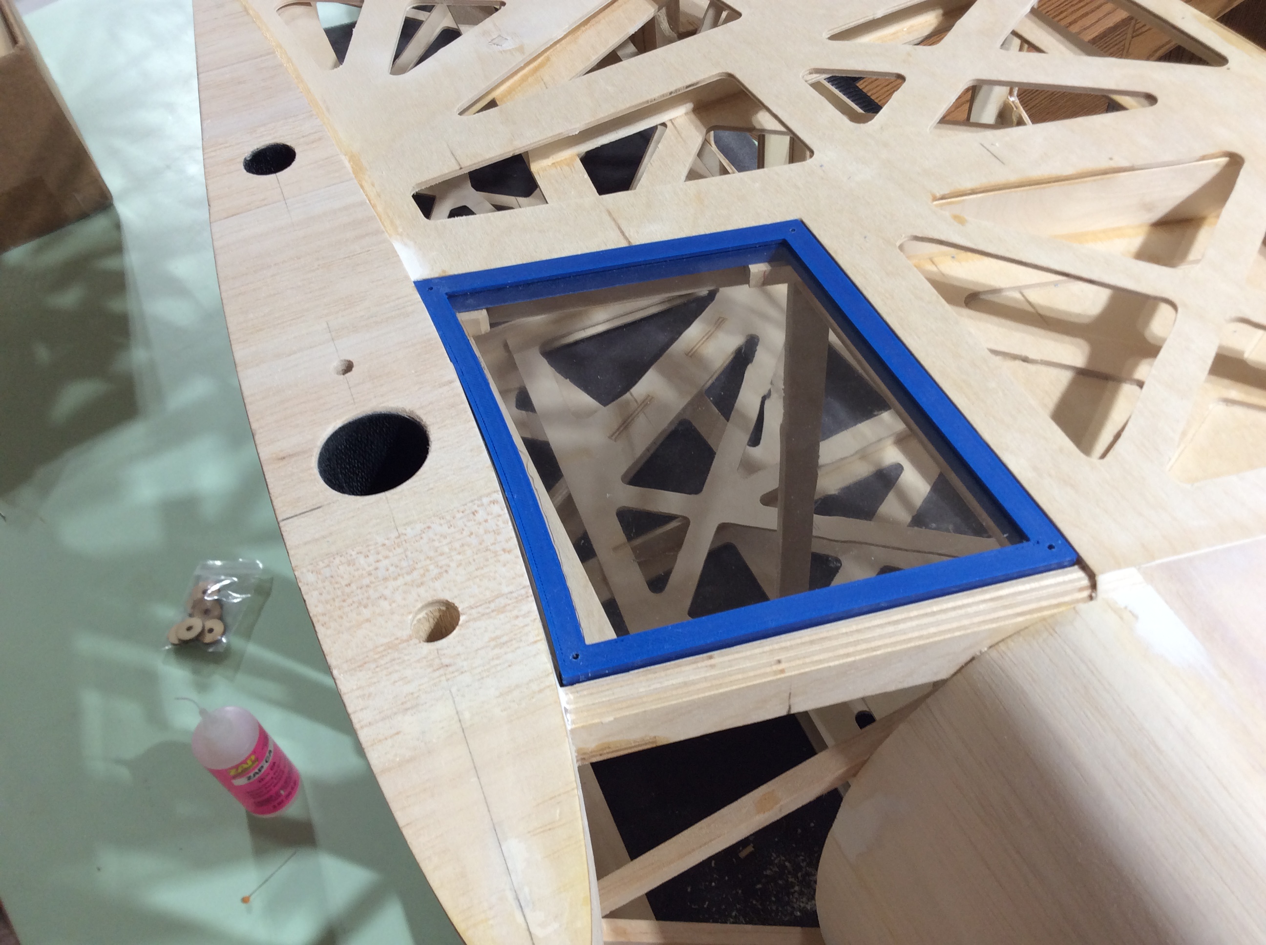

Got the widows fitted and the necessary blocks of wood to hold it in place and flush with the outside of the fuselage. The window frames were 3D printed and fitted nicely. Just four small screws in the corners to hold it in place.

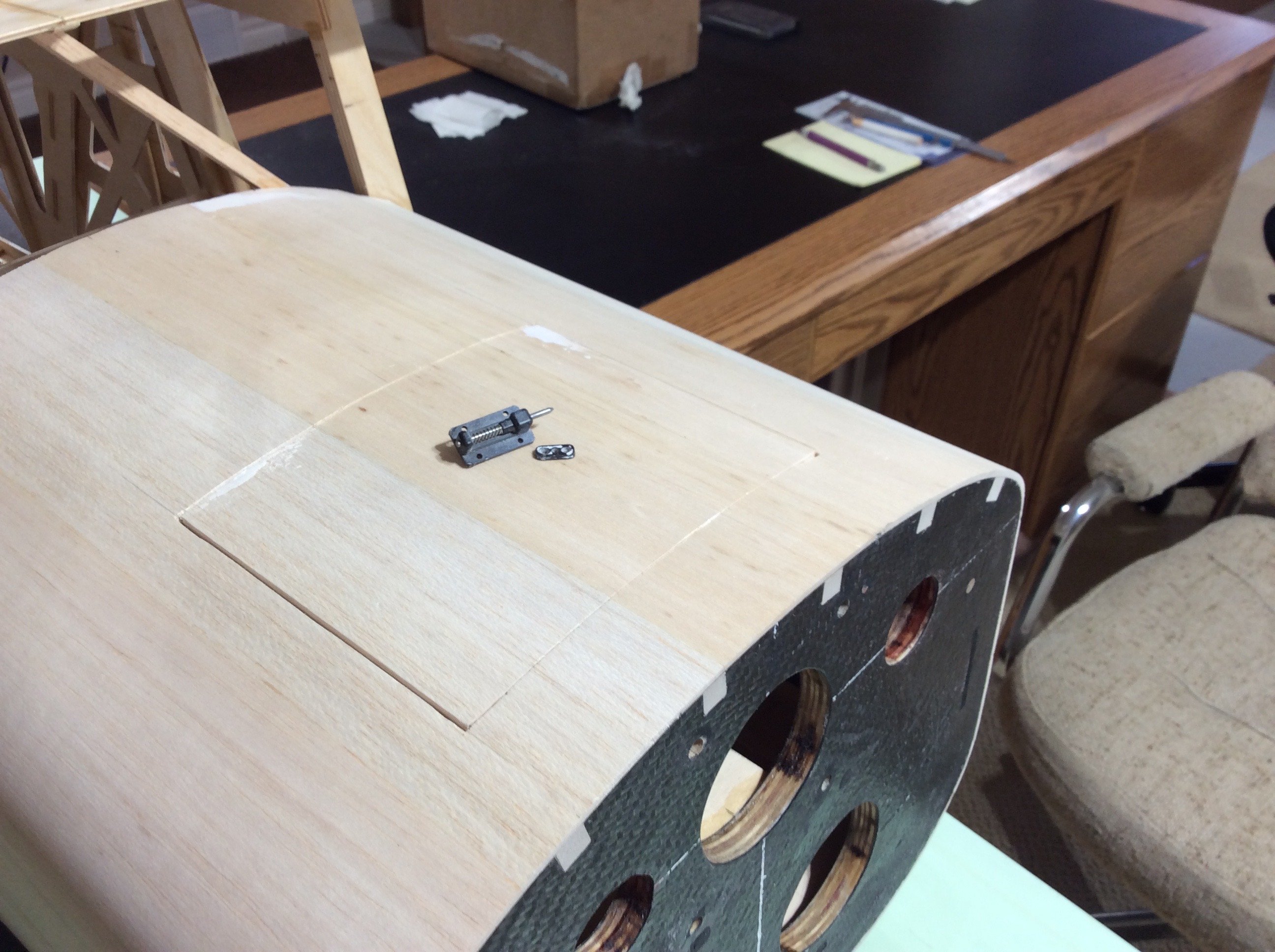

The top access hatch in the top is cut and done. Decided to use four magnets instead of a latch. Once the plane is built hopefully the hatch will almost never be used.

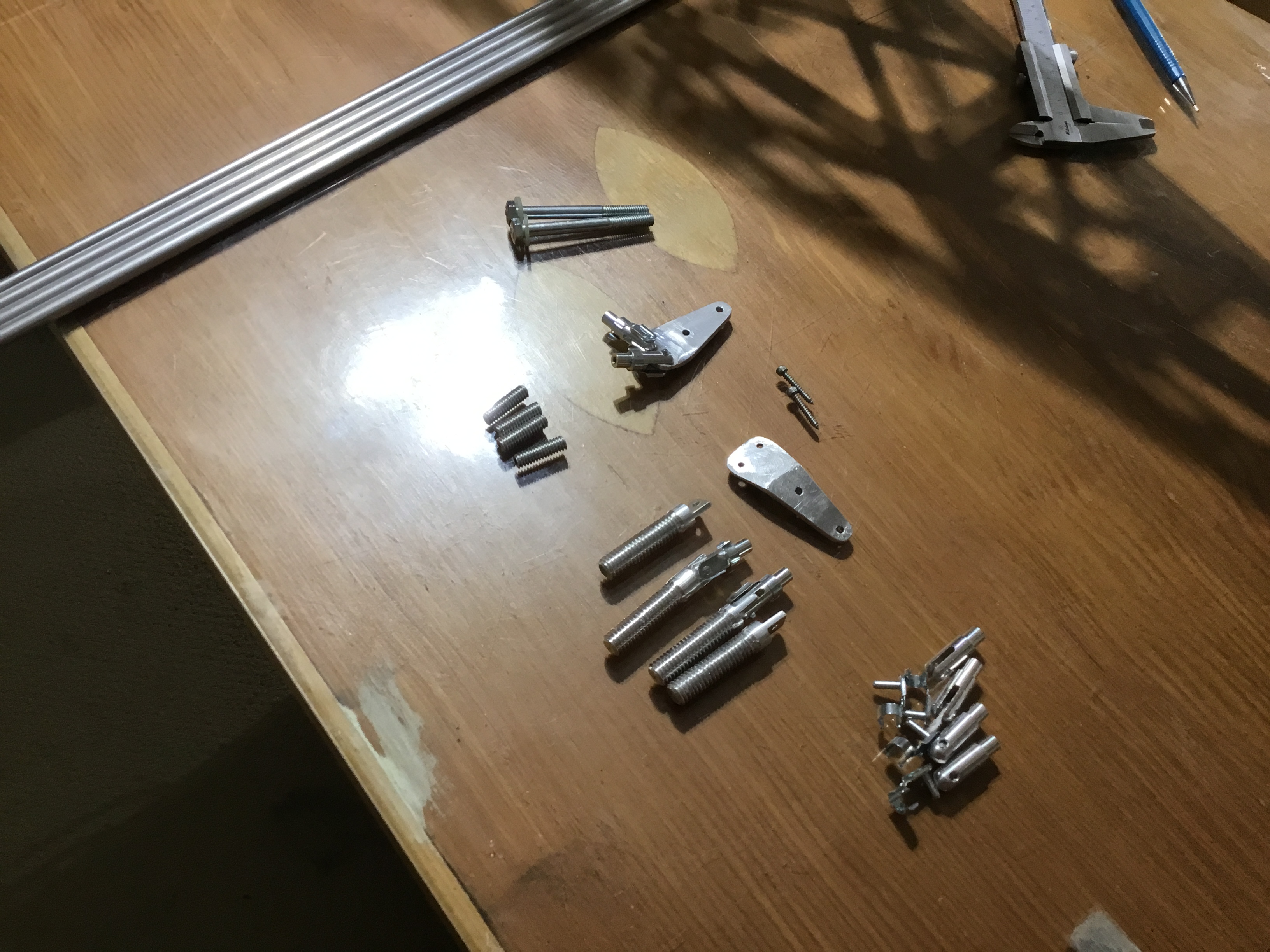

All the hardware is made and ready to be installed for the struts. Decided to use arrow shafts instead of the hardwood shaped aerofoil for struts they look better but are very heavy and weight is my problem. The arrow shaft are considerably lighter less than half the weight. Saved me 10oz in weight.
Does the threaded end get glued into the arrow shaft?
Yes. They are machined with a tight fit into the arrow shaft. Epoxy is spread into the shaft and onto the threads and then pressed together. One test piece was made beforehand to see if I could pull the bushing out of the arrow shaft. At 250lbs I quite could not pull it out.
