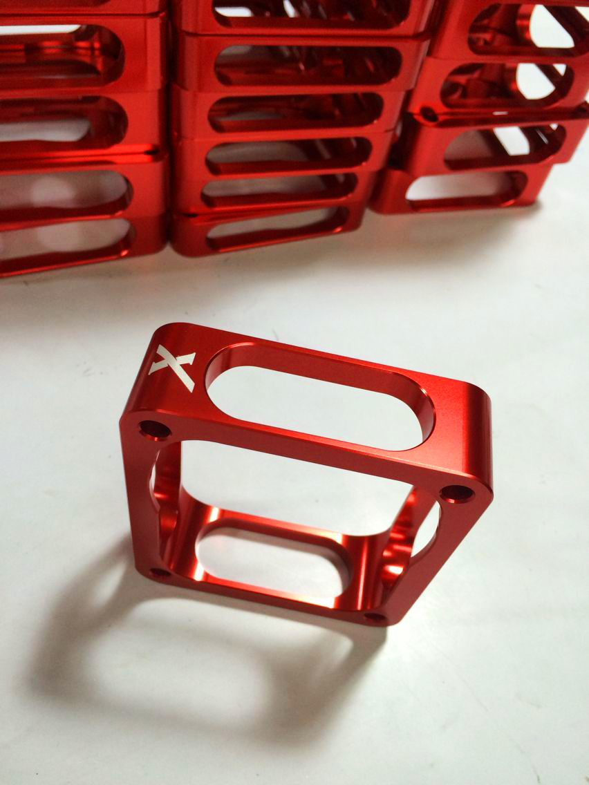

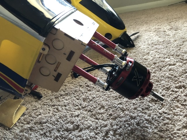

no, they don’t fit stock, you’ll have to ream those out as well. I was the one who used the blazing star standoffs and it worked flawlessly! I love this setup. So easy to do and very strong.
Excellent. Ordering the standoffs now. So are you not using bearings with the Airtops? Just drilling out the hubs?
@320CKA

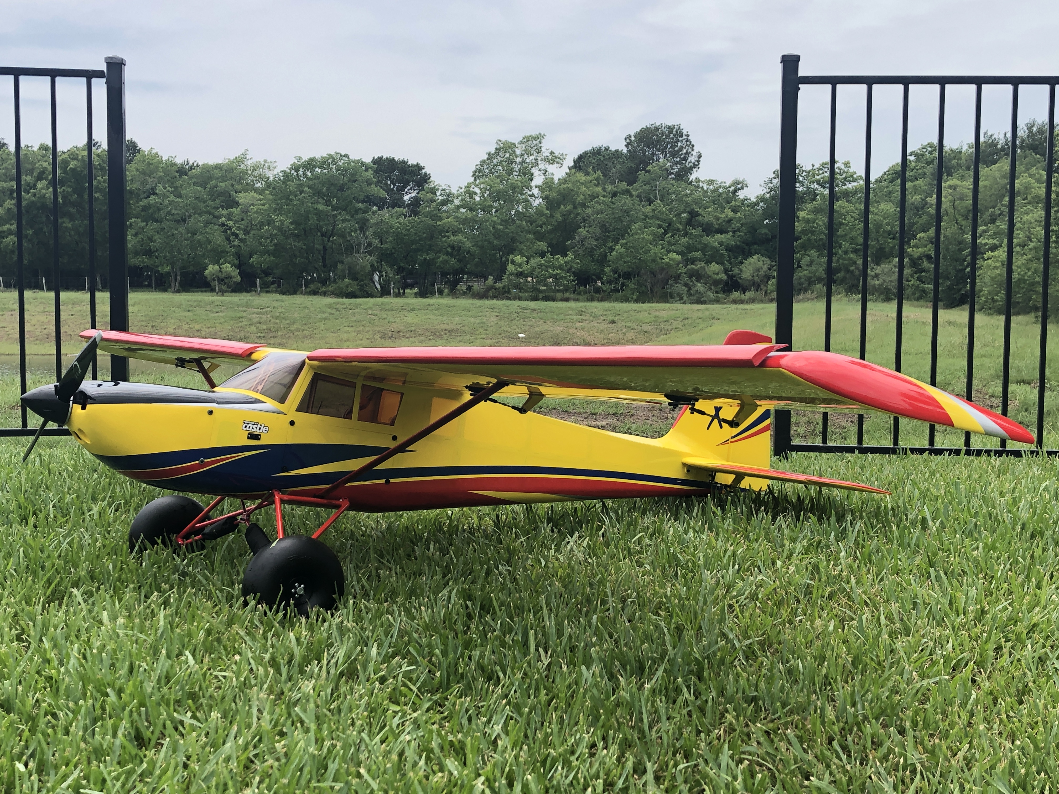

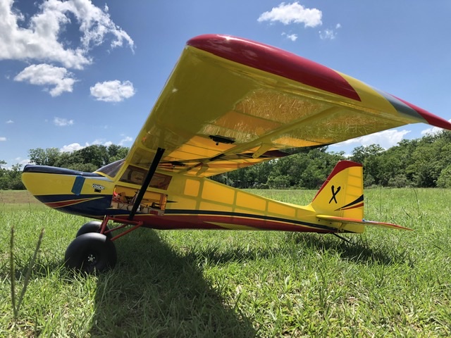

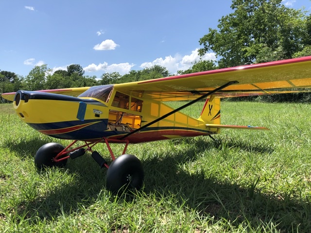

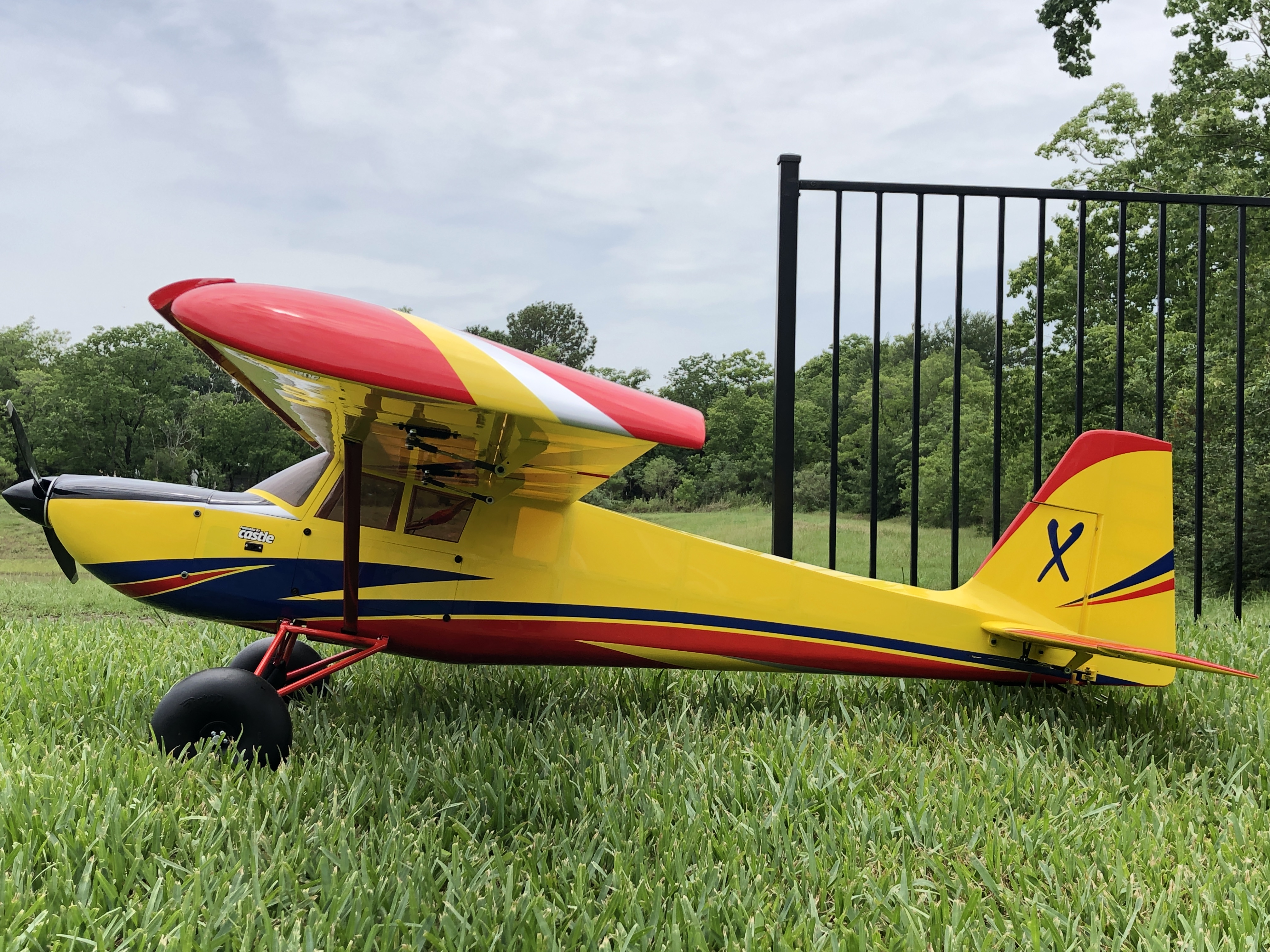

This is before I had everything finished, but you get the idea of the wheels and Xcub gear. This is the 7” airtops with the 6” dubro rims, reamed out for 8mm and painted black to look more scale like. Also, how I did my Xpwr motor with the blazing star stand offs. Works like a Charm with the Xpwr 40cc.

Correct. I drilled out the hubs, greased where they roll on the axle and then used rubber spacers to create a “brake” against the Xcub gear and rim.

I just verified that my Scorpion mount is made to match the DA-50 bolt pattern, which also matches the DA-60. So I'm going to try one of these DA-60 mounts - and then add standoffs to fit.

Like that the X mount and then some short extensions. Thanks for that info I have a DA 50 but was not aware that it had the same mouthing pattern as a Da60. Will have order a mout for my self thanks for that info, they are purchased from from Extreme flight.

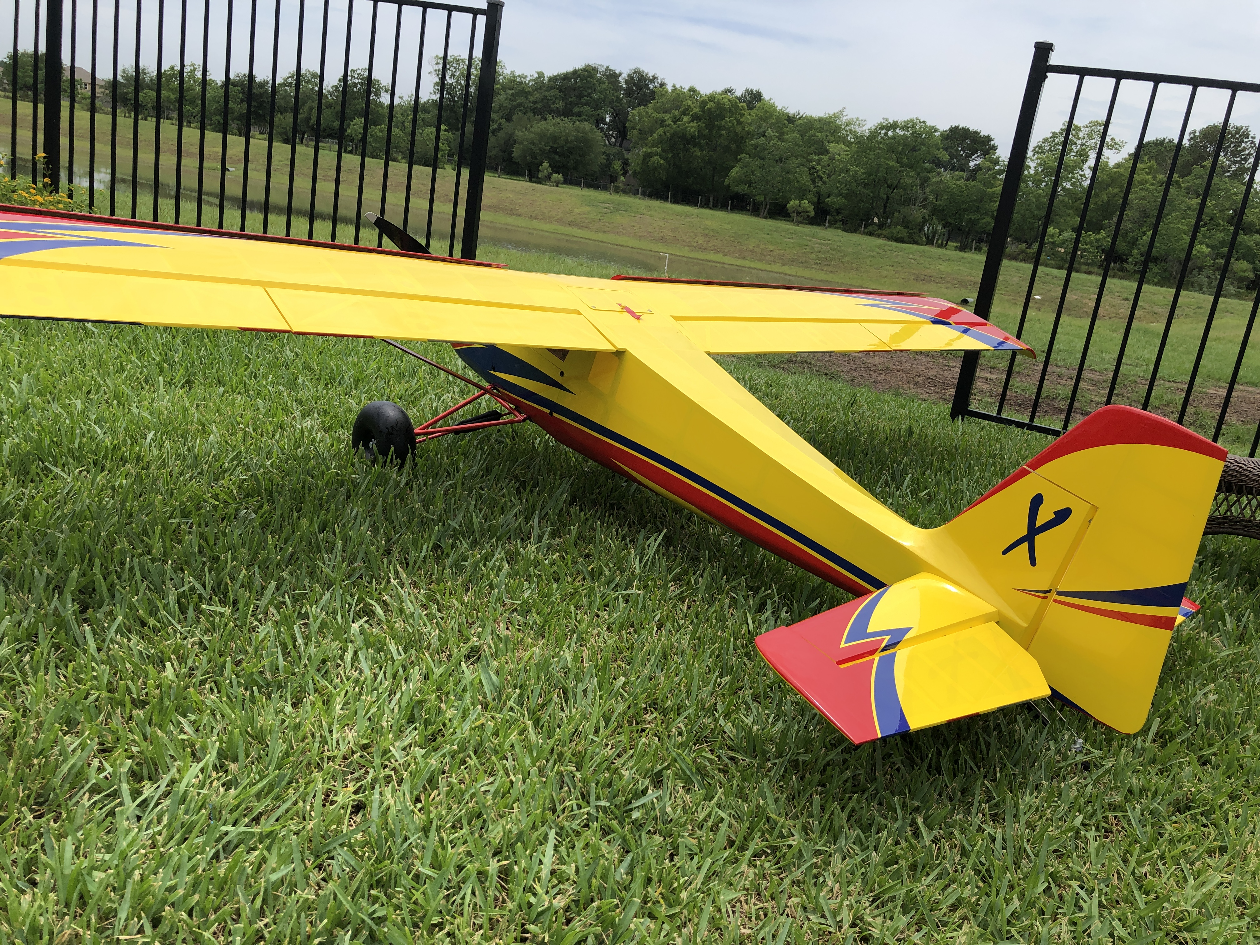

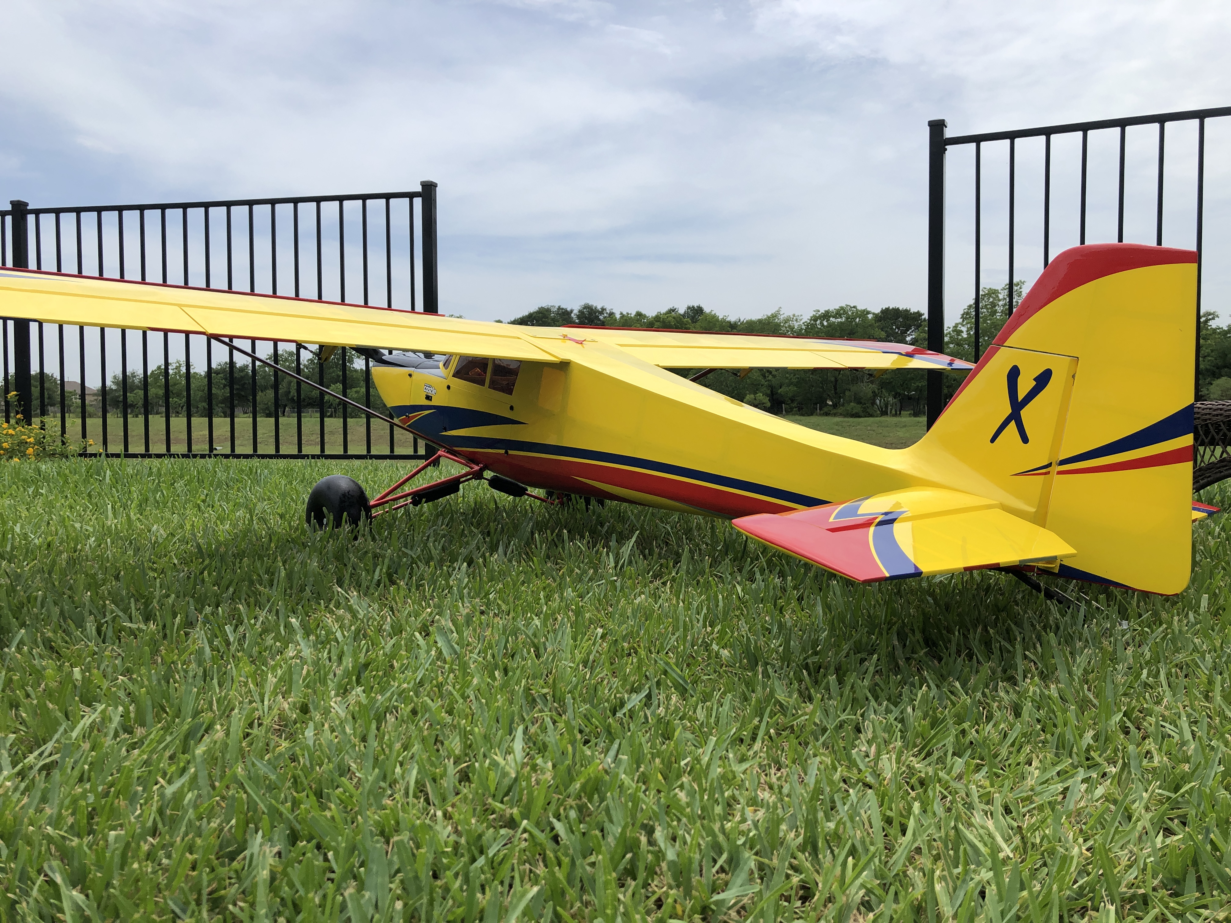

Here ya go, some more shots of how she looks now finished and flying. With the gear and Airtop tires. I’m about to modify the Xcub gear to make them sit higher by shortening the lower rod and about to try some flights on some smaller packs. these picks are from my backyard flying site. My runway is down in the detention pond.
it’s pretty fun! cheers!
