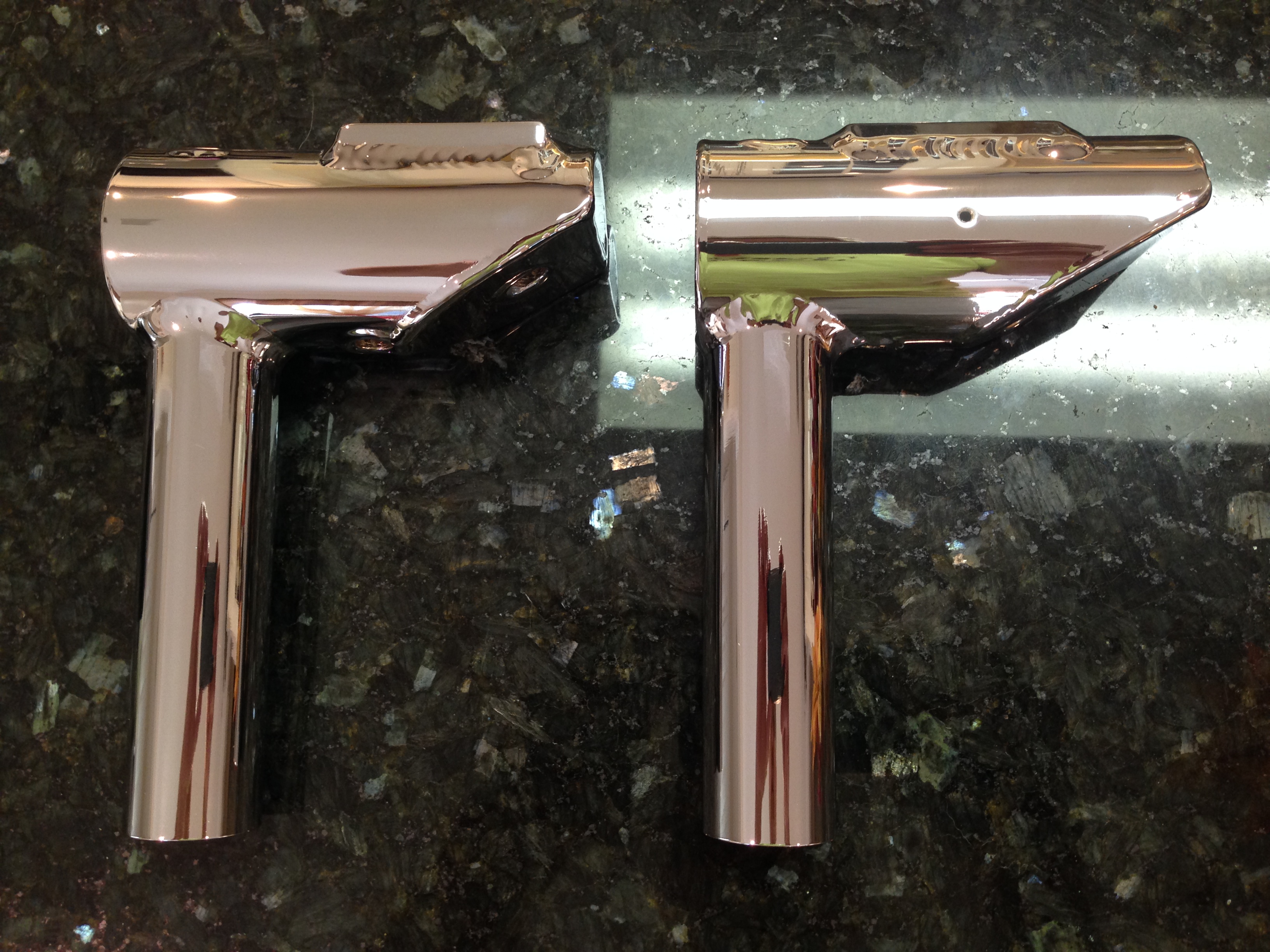

All three wheels are Airman ball bearing. The muffs are J&A Engineering chromed at Speed and Sport Chrome in Houston, TX. The spinner is a Tru-Turn anodized orange. The control surfaces are all running BLS157HV's with three on each aileron. Two on the rudder. The throttle is using a high speed Hitec servo. The wing bags are matching color scheme by REVOC. Graphics for it by B&E and Bad Brad. Radio a JETI DS-16 with a JETI Central Box and two satellite receivers with wireless switch. Batteries two LI-ION Magnums from Duralite. The magnums are their new high discharge LI-ION packs, 20C. The fuel and smoke tanks are 1 liter Fiji with machined PSP MFG hardware kits. For this bird I'm trying out a SECRAFT smoke pump. I have had Harris and TME in other planes. The landing gear is painted white and cleared. All connectors are removed from the servos and the wiring is soldered and heat shrank. Wiring is either spiral wrapped or snake skinned. The opto-kill is a Tech-Aero Ultra IBEC. This setup consumed 13 channels.

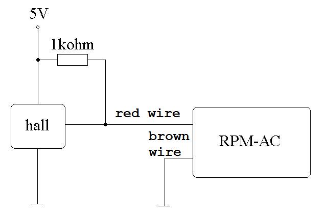

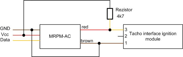

Yes for sure. Forgot to mention she is also getting additional telemetry:
MRPM-AC EX - Modified to use a DA tach wiring equipped ignition: http://www.espritmodel.com/jeti-telemetry-sensor-rpm-brushless-mrpm-ac-ex.aspx
Schematic's also show the hall sensor option modification.

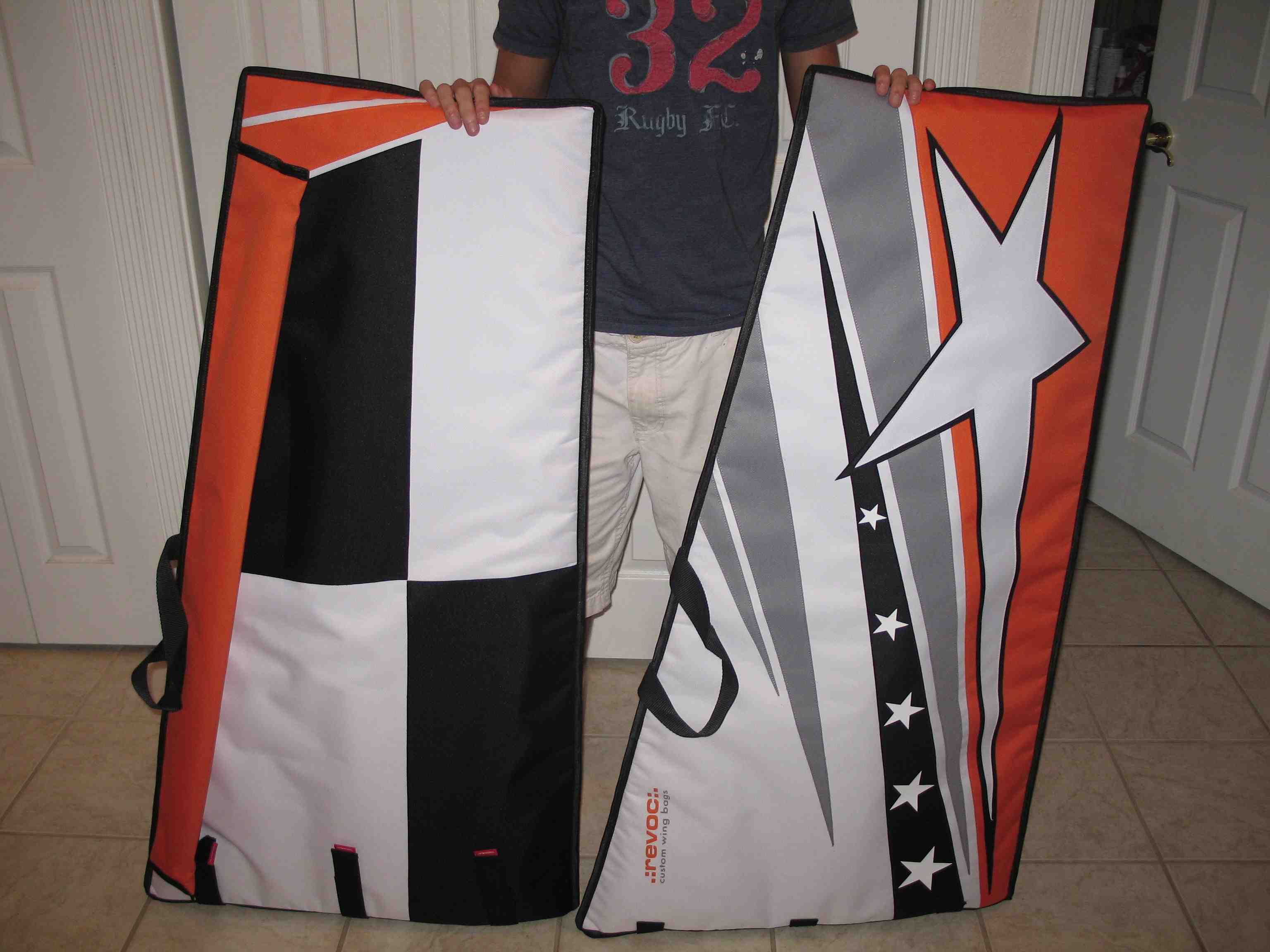

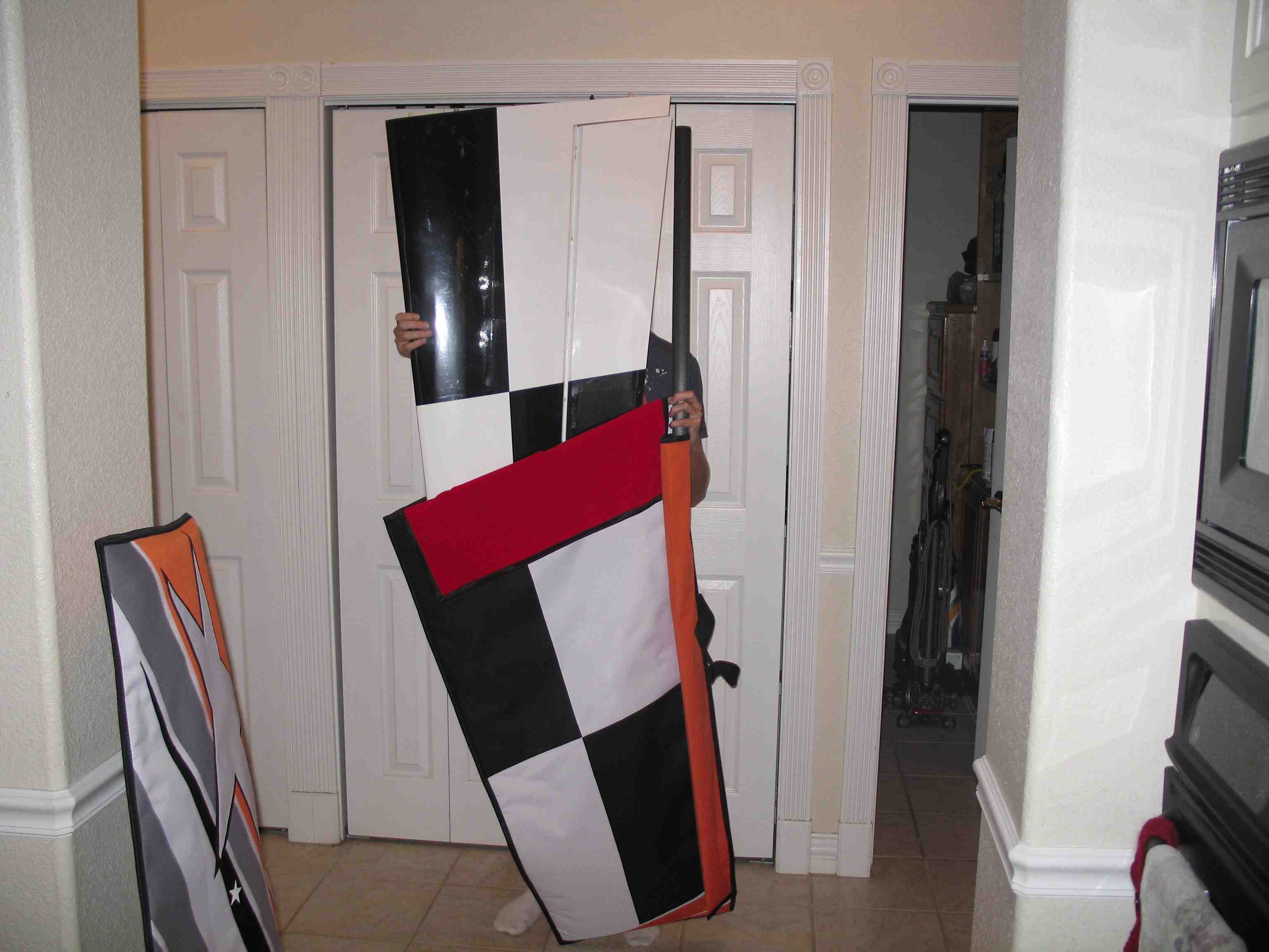

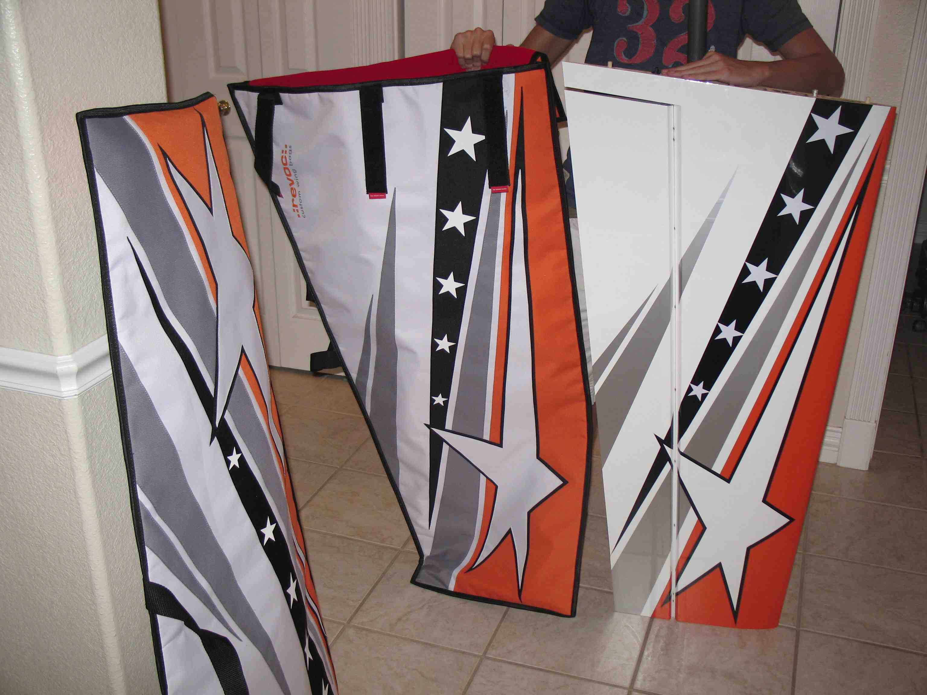

A few bag pics.
