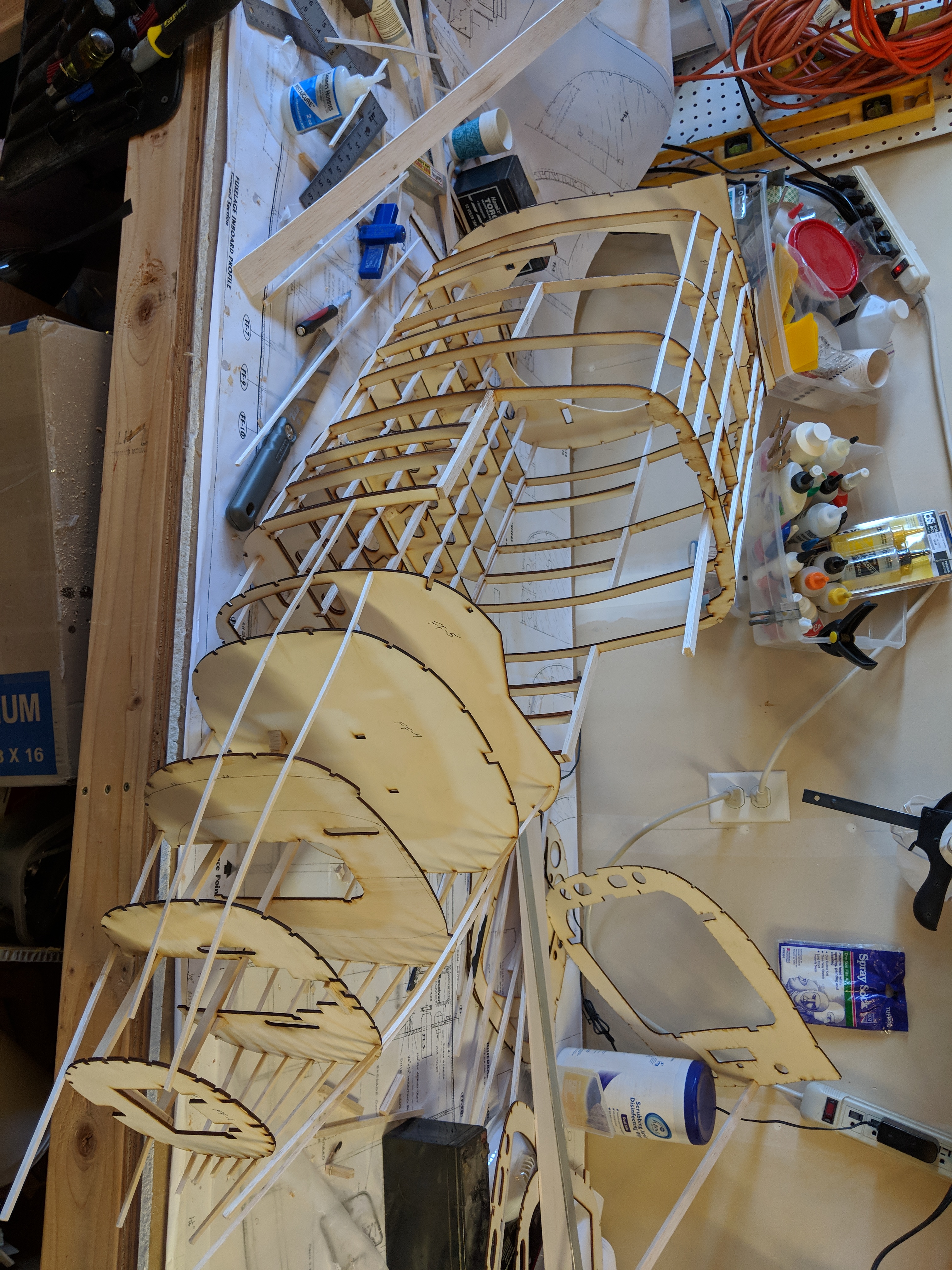

Spent some time today placing stringers, measuring, placing, measuring, gluing, etc.
The issues with the notches not lining up correctly have been covered well in another build thread, and I can confirm there are several places where things don't line up quite right. The main problem is with FF-5. It just doesn't work well with others!
I'm still waiting on the rest of the plans to arrive. They got here with only the bottom halves of three of the sheets. They are so large that they come in two sheets for each original.

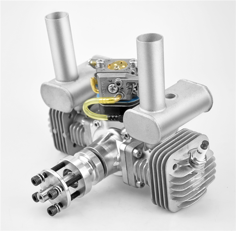

Looking around, it appears the best options for twins are the VVRC 40's, RCGF 40's, and DLE 40's. Another option would be EME 35's with autostarts, assuming they would fit. I don't know what the power difference would be.

EME 35 about 21 pounds static thrust with 20x10. But I totally forgot about the RCGF 50T! Angled plugs and only 8.77" inches across plug caps. I personally been wanting one. A bit pricy @420.00 though. But it will produce almost 30 pounds of static thrust with a 20x10 !
I had the single cylinder counterpart the 26cc....same size as a DLE 20 but would put the smack down on it! The 50 is the same size as the DLE 40 and yes the 50 puts the smack down on it too!

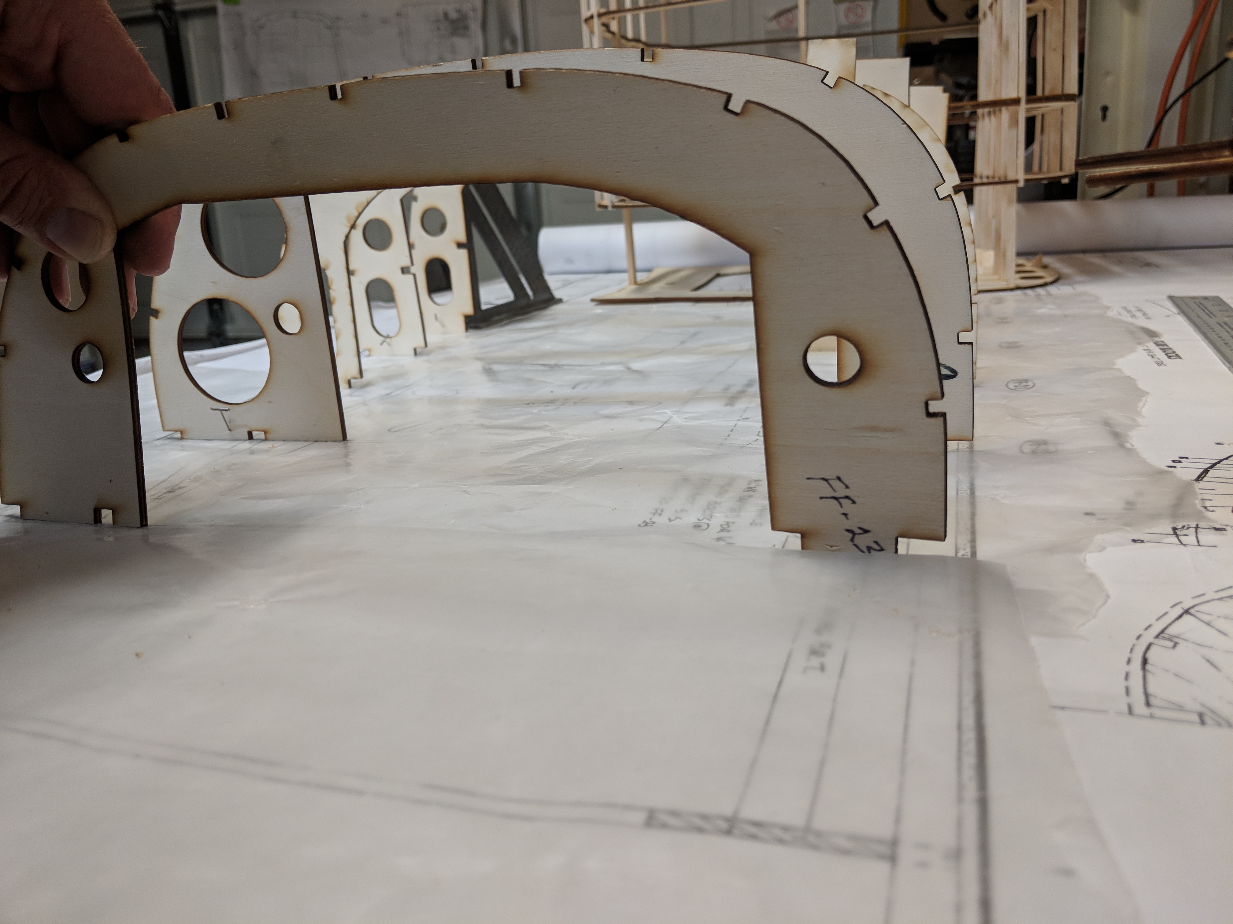

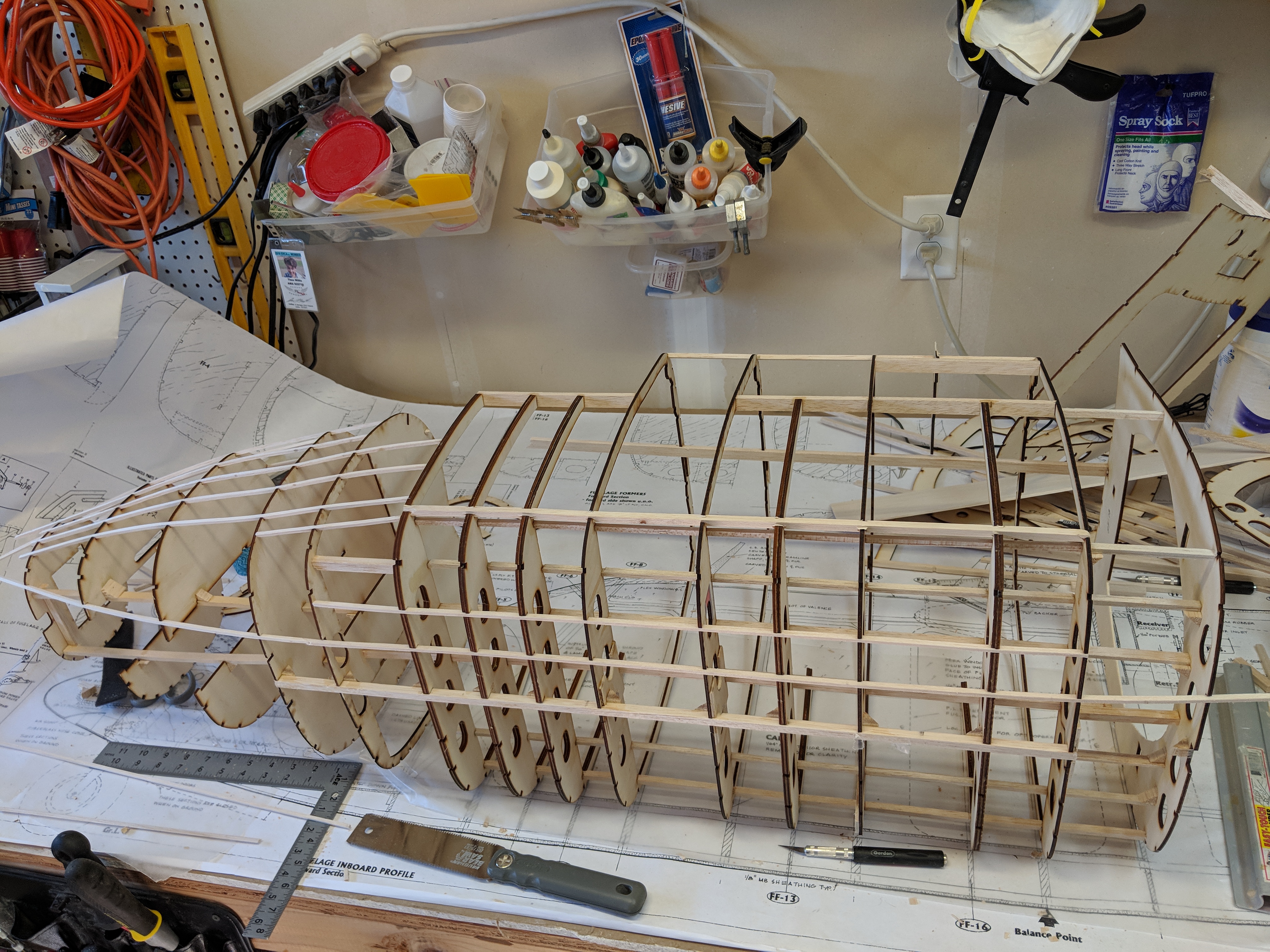

I decided to cut the remaining formers into halves and build 1/2 first on the board, then build the other side onto it. I will then attach that to the remainder of the fuselage. At this point, I plan to make it all one piece without the need to put them together at the field. This is going to result in a fuselage that is looking like it will be about 9 feet in length.
Unfortunately, the formers are just not lining up right at all. Some are too short and some are too tall for where they sit on the plans.
I think the only solution is to find where they sit best as far as their height so that they don't throw off the lines of the fuselage.
Ugh.
I still don't have the complete plans from where I ordered them. I was only ships the bottom halves of some of the sheets, including the fuselage ones. So I have no way of checking the former's to see if it is an error on the side view or if the parts were cut incorrectly.

Lets just say I tested half of the 50 lol. The RCGF-26. It ran VERY strong. Ran VERY well. Yes it was hard to start for the first time of the day (Needed a starter) but starts after that came easy by hand. The smaller crank cases makes getting the carb primed a bit difficult on these class of motors. Had similar issues with DLE 20 etc...
And RCGF is up front about this in their manuals. "First prime of carb will take 40 or more turns of propeller". The only other thing about the RCGF is the plug cap on their ignitions. I measured and found it to be a wee bit larger than the RcExel's. Fix is to add a small hose clamp to keep it from making RFI on the plug. But be as things are.....Send them to me and I'd be happy to test them for you :).

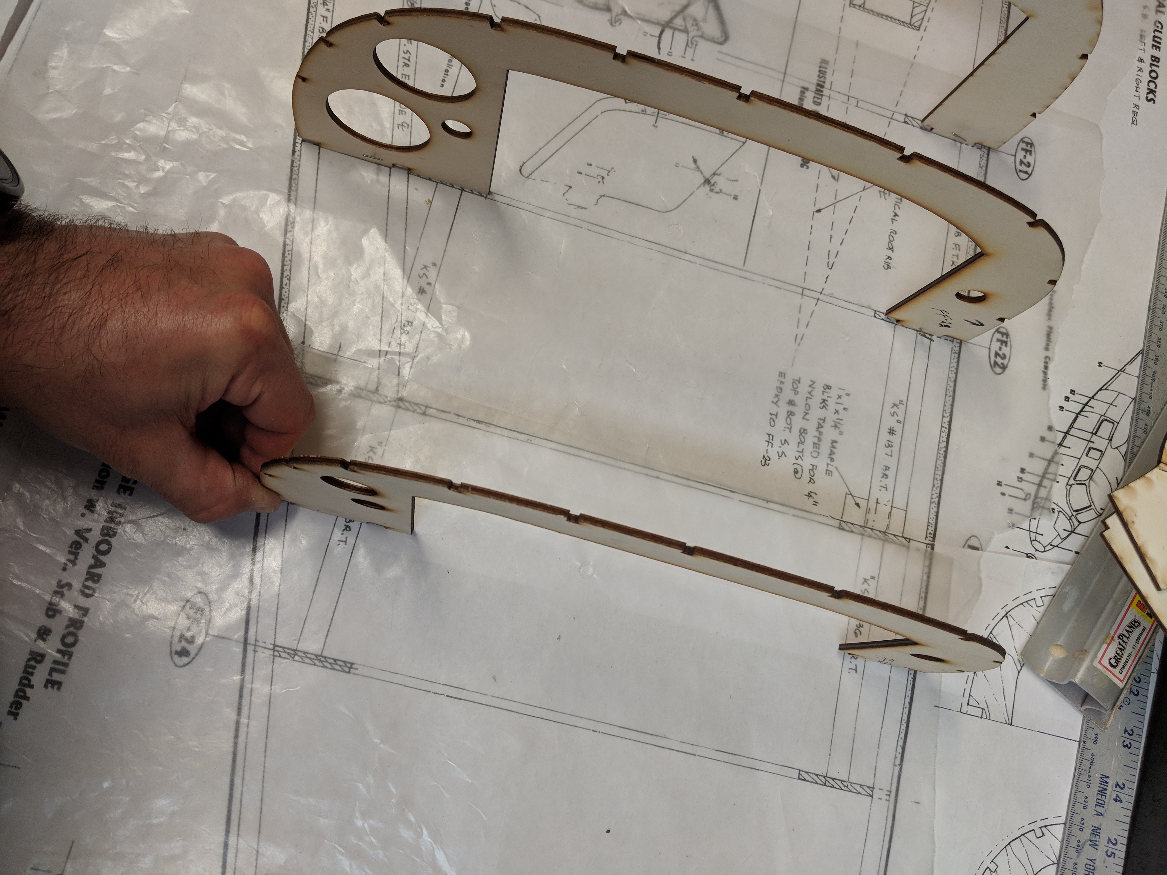

After doing a bunch of studying the plans and trying to match pieces up, I have concluded that the former's will not work. They simply are not cut correctly. I checked the stabilizer ribs and found that they are not cut correctly and several are missing. The wing ribs appear to be usable although not perfect.
At this point, I am going to have to start all over again it looks like. I may be able to salvage a few of the fuselage formers but I'm not sure. After measuring them and comparing the heights they should be on the plans, I am finding that they are not matching up correctly.
