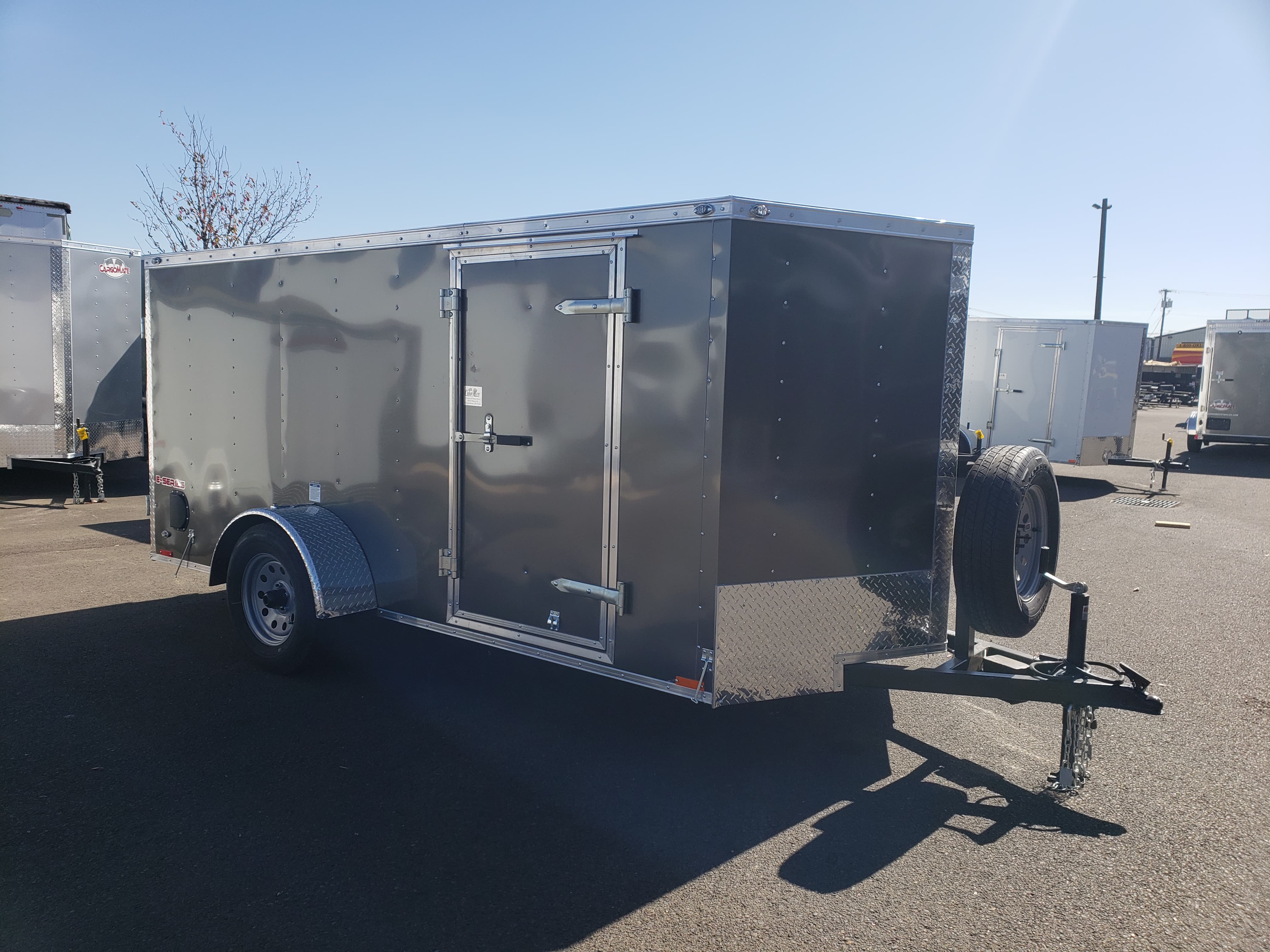

Okay, I know we're starting off a little slow. I just took possession of a new airplane trailer, so I will be working to get it all set up for hauling and storing our big planes. I'm hoping to get it mostly done tomorrow so that the build can resume.
