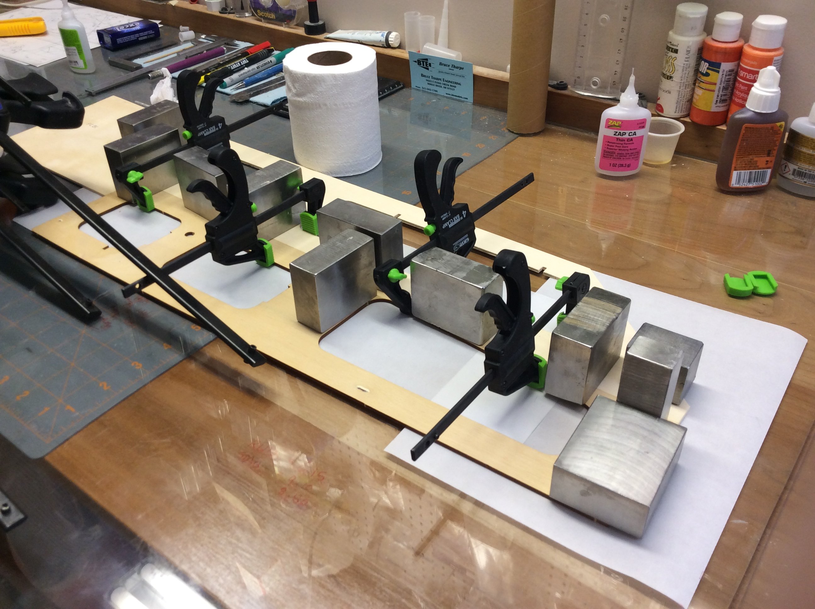

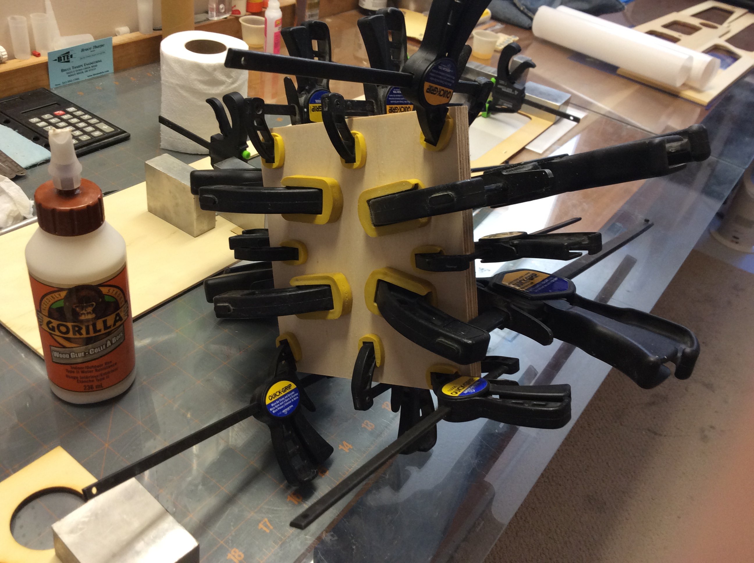

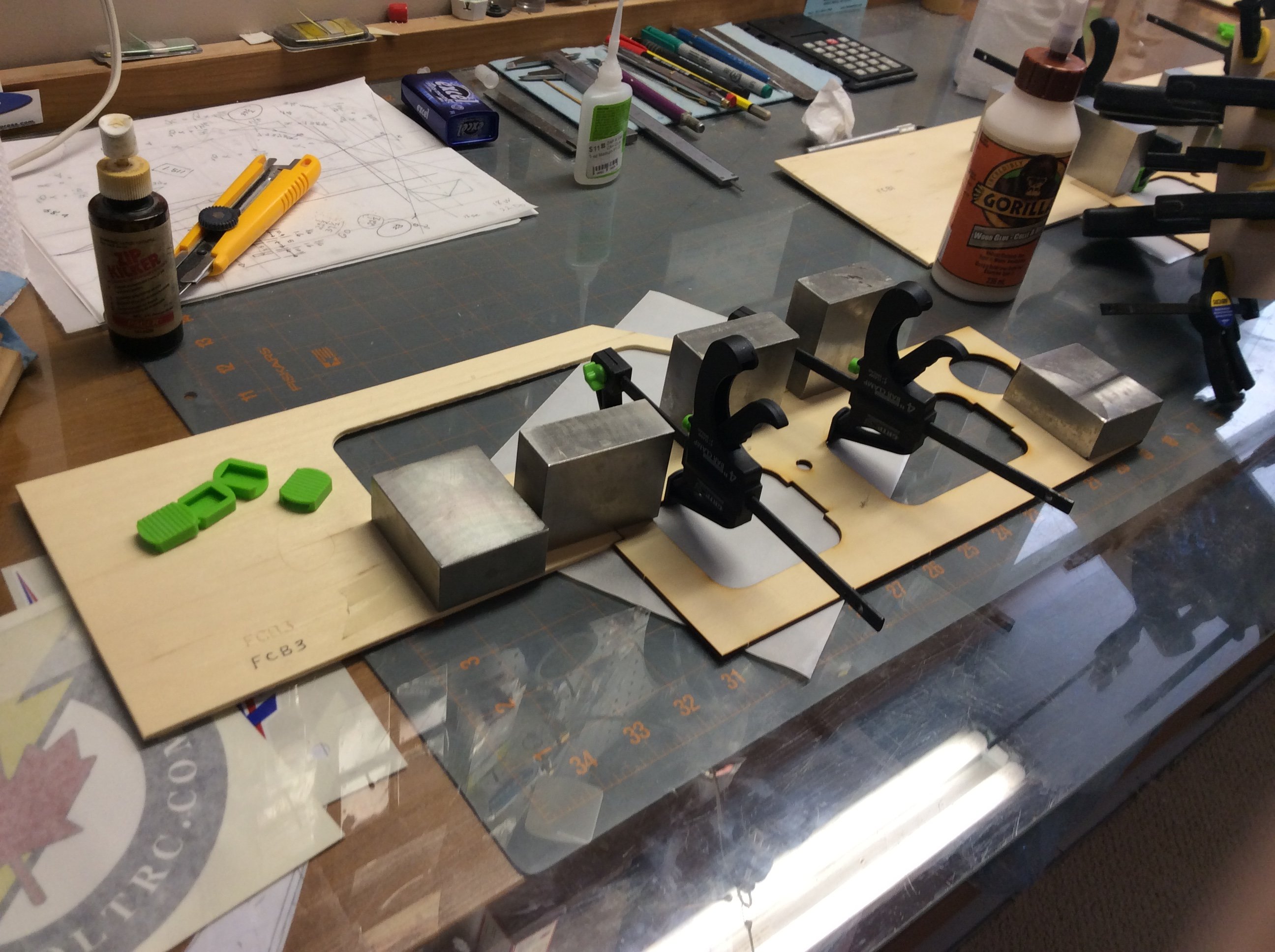

Well sitting in the shop waiting for the hysol to cure I started to look at the fuselage and then just started do some small parts as shown in the pictures. The one is the motor bulkhead being glued together and the other two pictures are the sides for the right side of the fuselage. Took a little bit of weight and some clamps to pull it together and close all the gaps.
