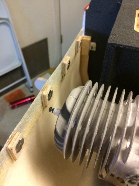

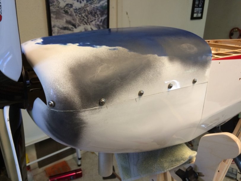

Thanks guys, it's really simple if you don't overthink it o death. Makes for very nice and clean cowl installs.
Capt. I made my own tabs, as mentioned a small square of plywood or even a strip the length of the seam works equally as well.
What a great thread Terry. You have explained this very well and the pictures accompaning your postings have been very helpful. Thank you for sharing valuable information.

Your welcome, it's easy once you get past the "butt pucker" part of gluing our cowl back together and trying to get it back apart when dry :)
Capt.Roll
Ha, my "butt pucker" moment was drawing the saw to start the cut.........LOL. Turned out great......thanks again Terry.
