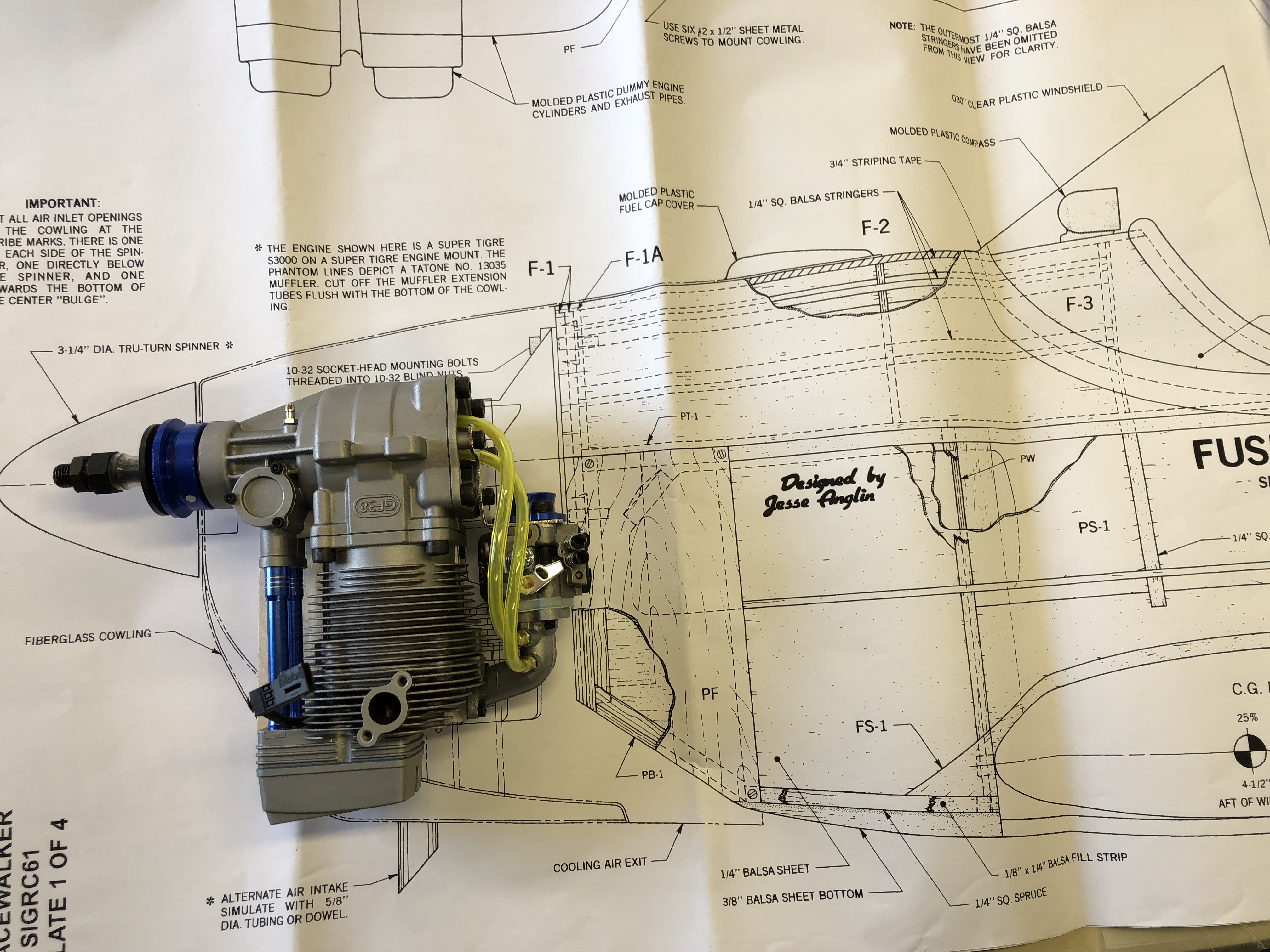

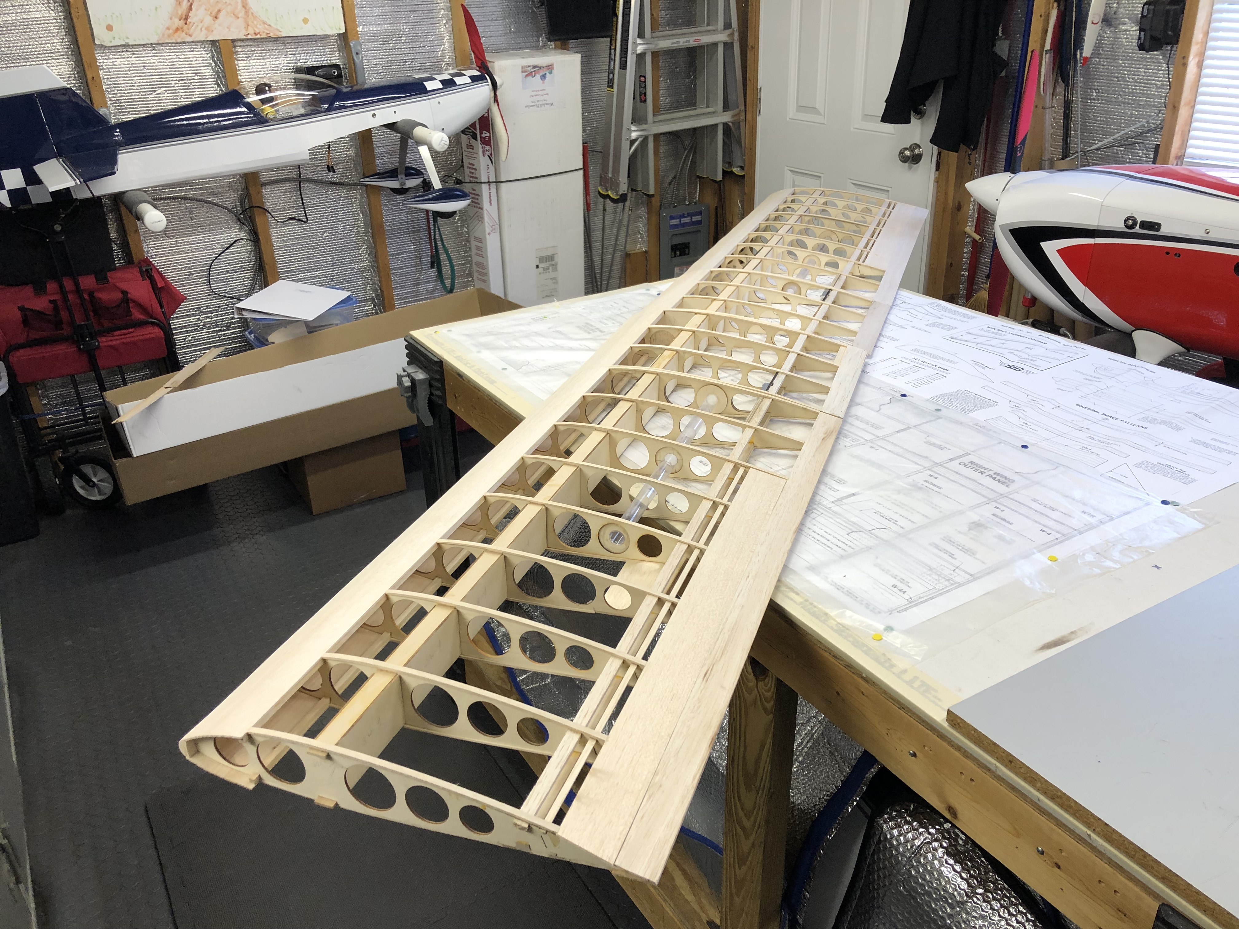

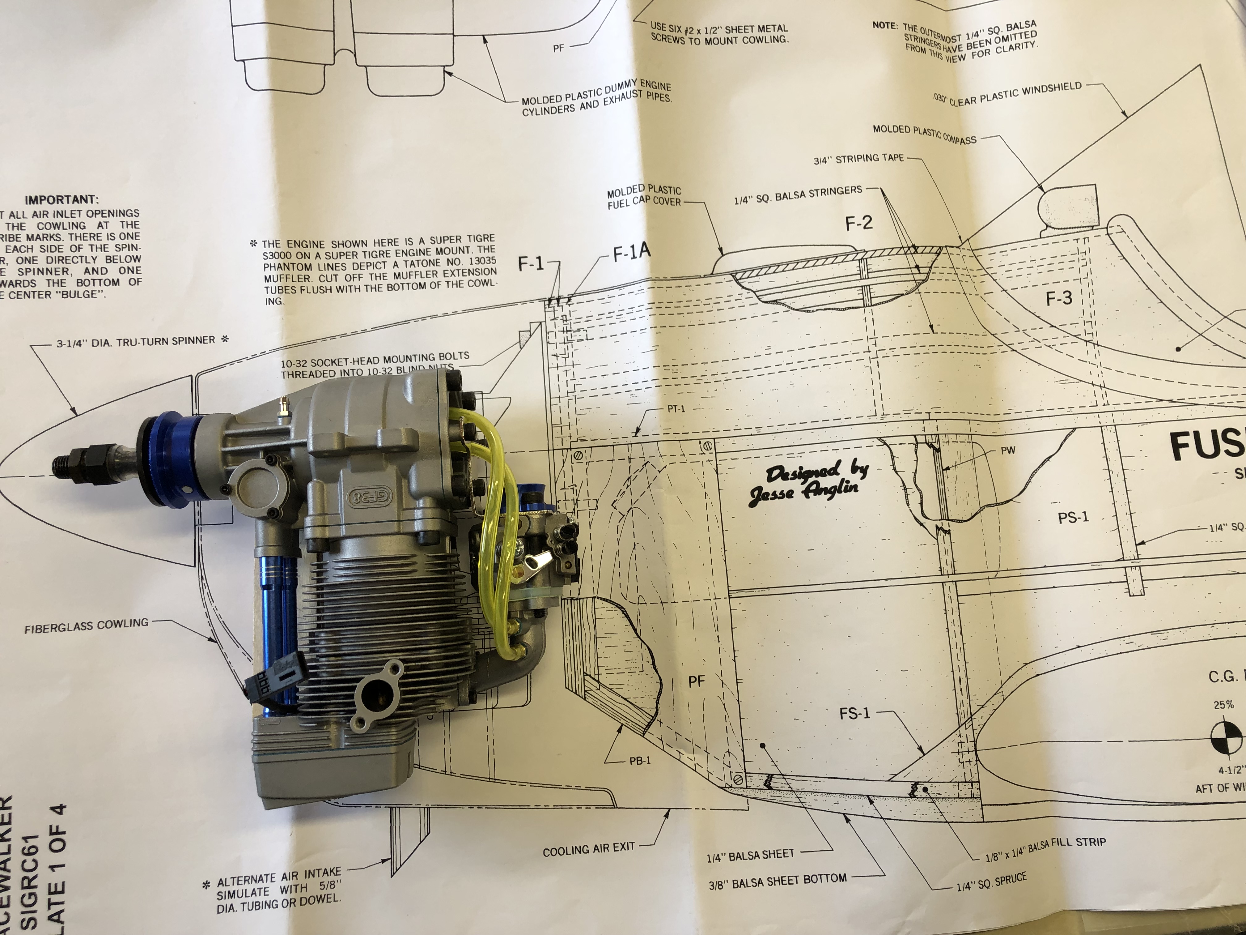

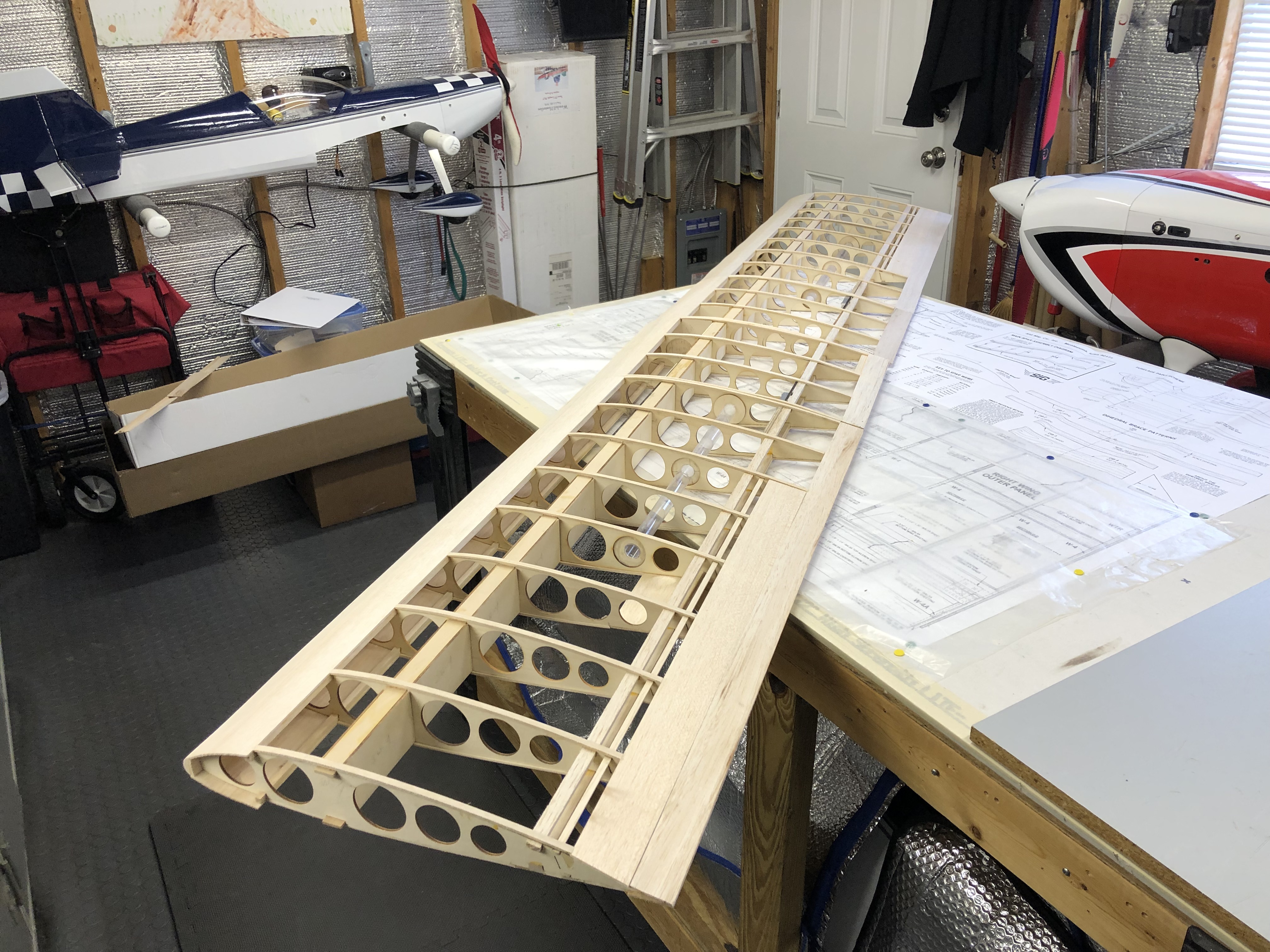

Looks like the NGH 38 will be a good fit size wise. Finished the left wing with the exception of the fiberglass wingtip.

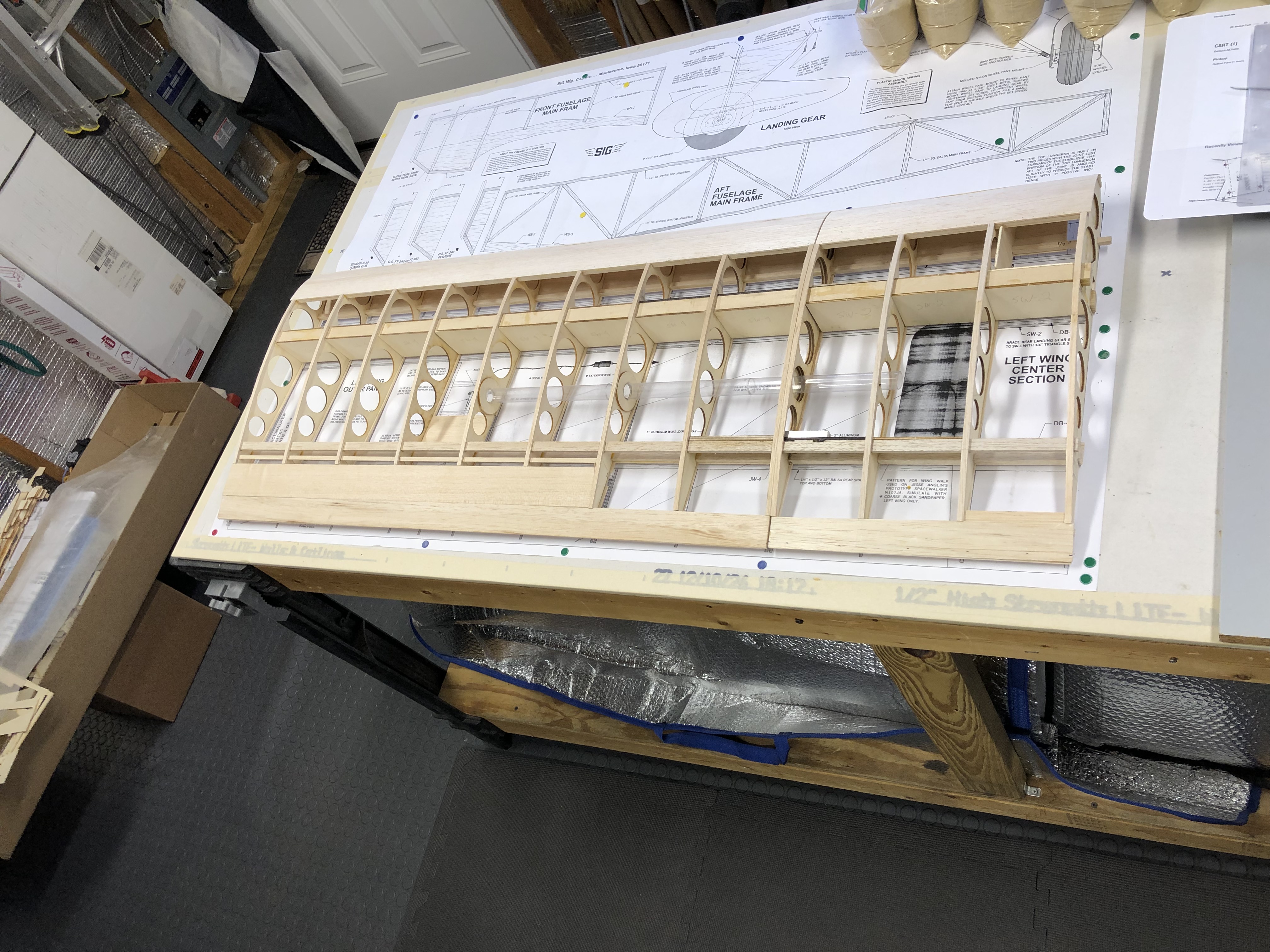

Sawed thru the main spars to separate the outer and inner wing panels. Starting on the right wing tomorrow. Also found the Robart 1/4 scale Cub gear on RCG. I know the price is reasonable but not sure I want to spring for $185.00.

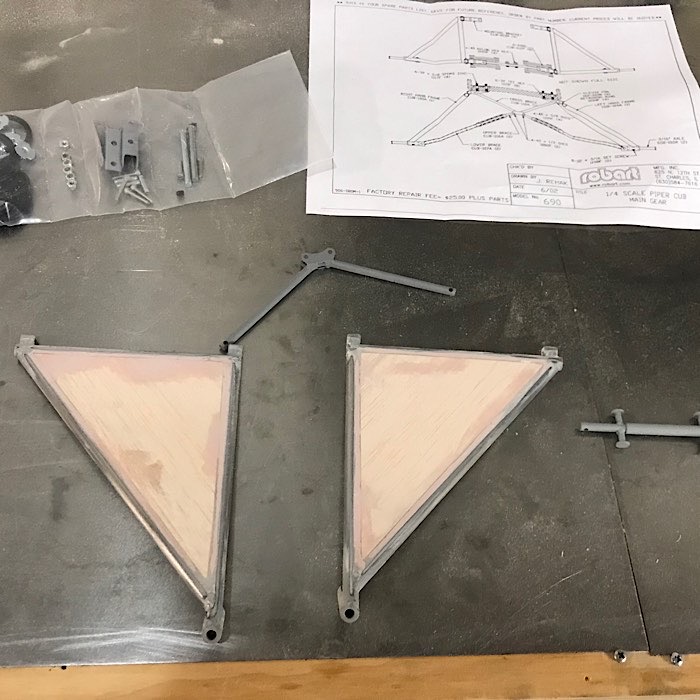

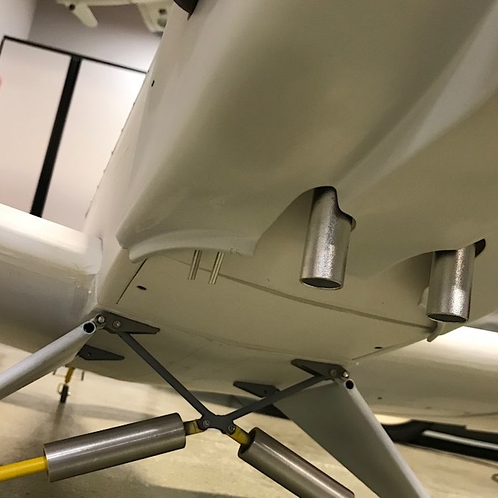

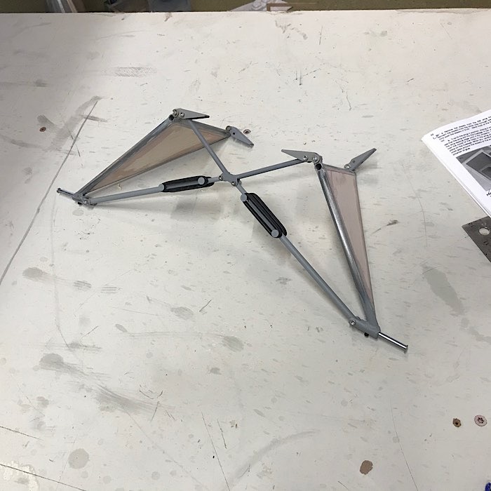

It’s been a while since my last post, what with the holiday season, end of year and COVID-19 it’s been a little hectic around here. Just got my first COVID shot and life looks like it might get back to normal. I can hardly wait to be able to go my local Hobby Shop. It’s amazing how many times I run out of something and have to wait for Amazon to show up. Since the last post progress has been made. Early on I decided to use 1/4 scale Robert Cub gear. Fitting the gear was very simple as the only modification needed was the replacement of the grooved landing gear mounts with a non grooved substitute. I could have just turned them over but the extra strength seemed worth while. The gear comes with rubber O rings as suspension. After mounting the gear it was obvious more ”SPRING” power was needed. I tried adding springs + the O rings and it was stil not enough. Fortunately, I had a set of struts from an old departed PA18. After a bit of reworking they are working great!
I inserted 1/4” balsa and wrapped in 3/4 oz glass.

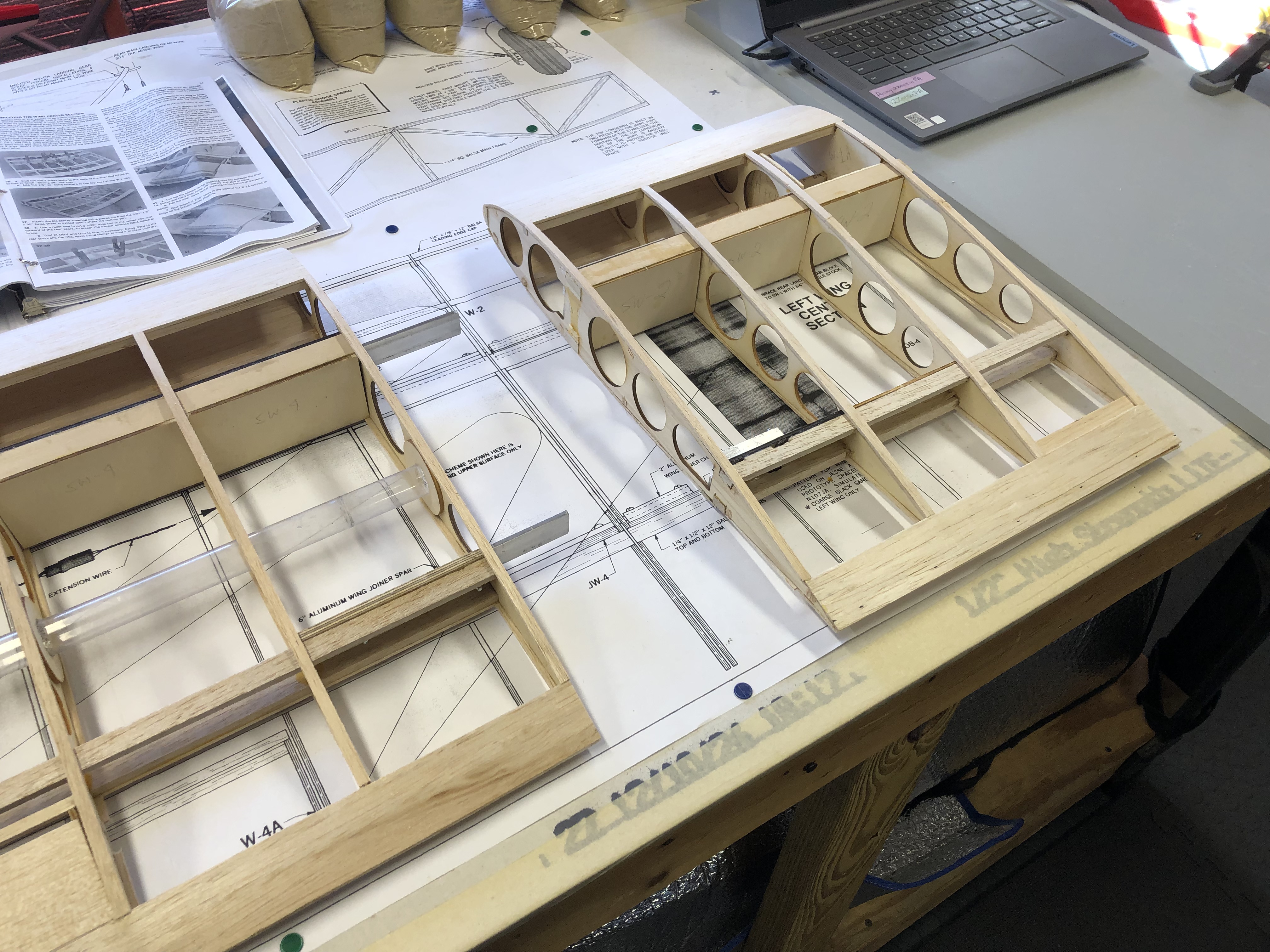

I snoozed and lost the gear for $170.00. Hoping another will pop up at some point. About 90% done with the wings and then on the fuselage sometime next week.

The gear on my 1/3 scale Super Cub was assembled from parts in the kit and was silver brazed using a propane torch. I can take a photo of the plans if you like if you wanted to scale it own.
Wing looks great.
