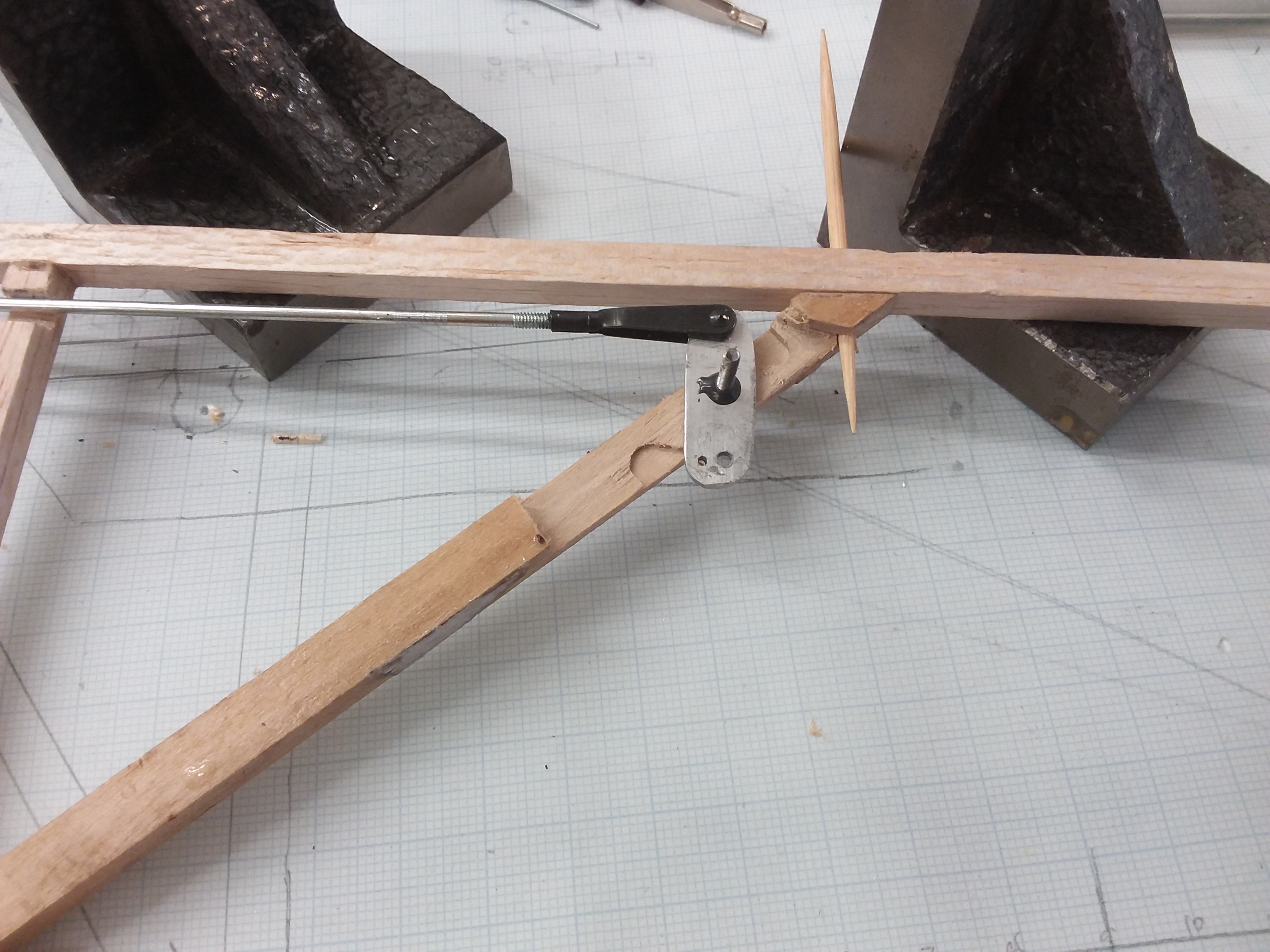

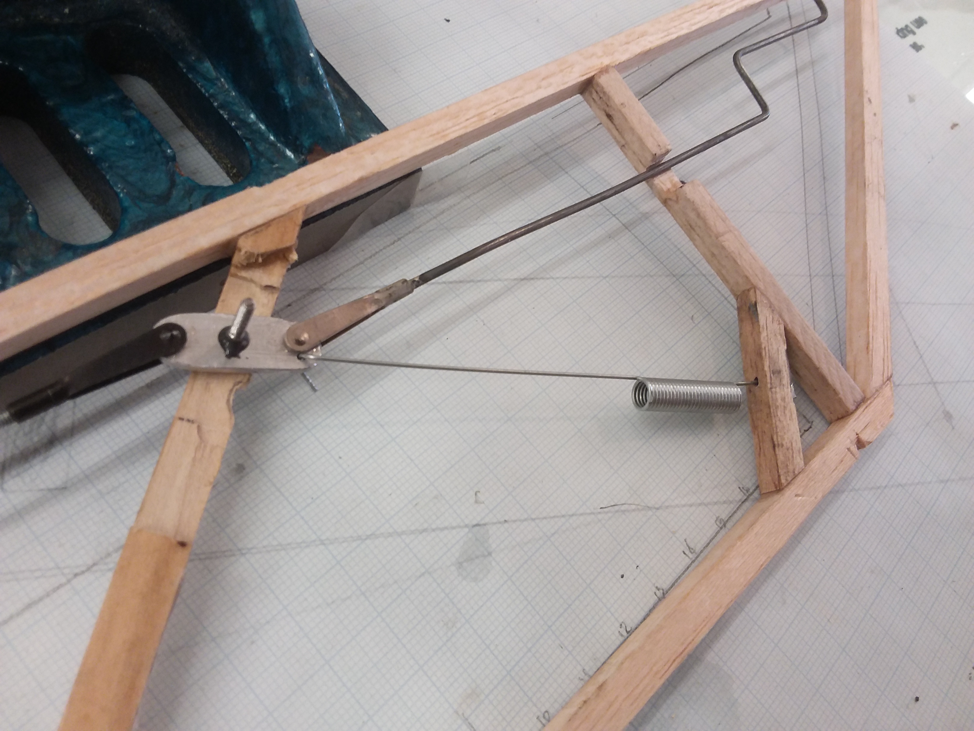

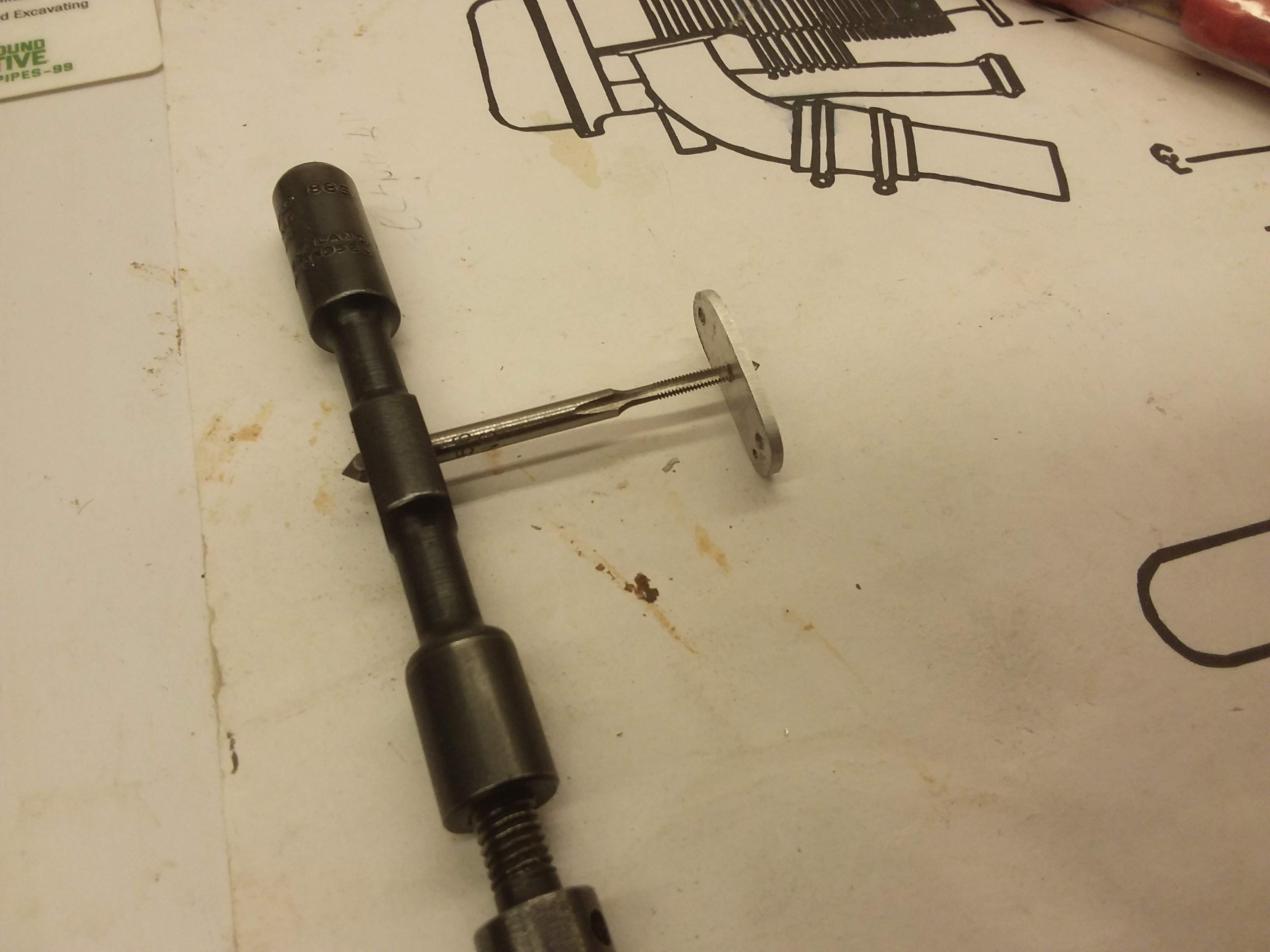

More big photos. Decided to try an aluminum arm idea. Cut, tapped (2-56) and sanded to a basic shape.

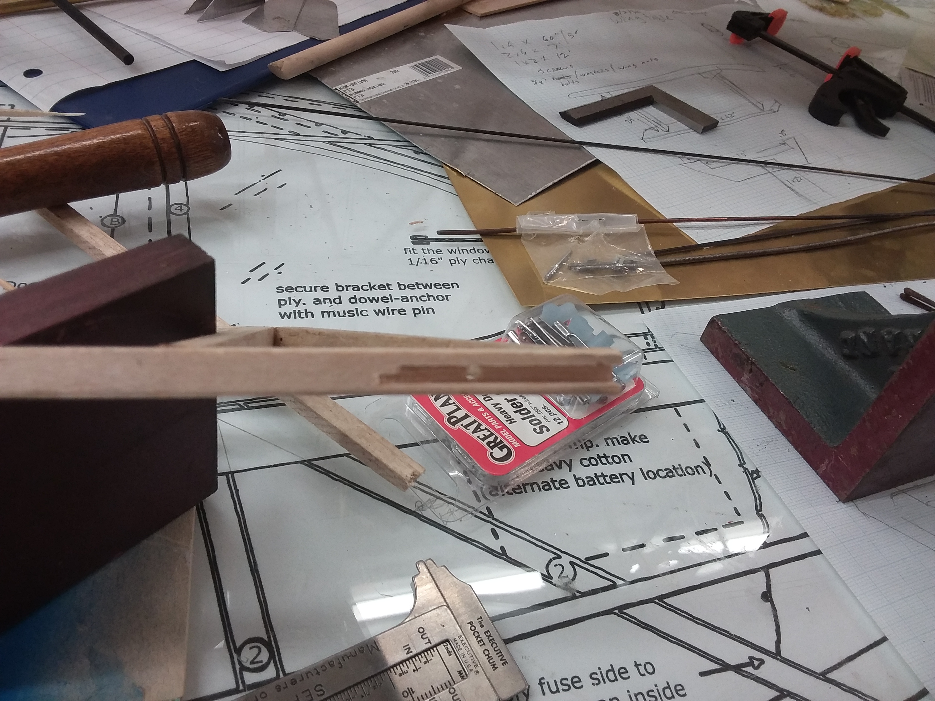

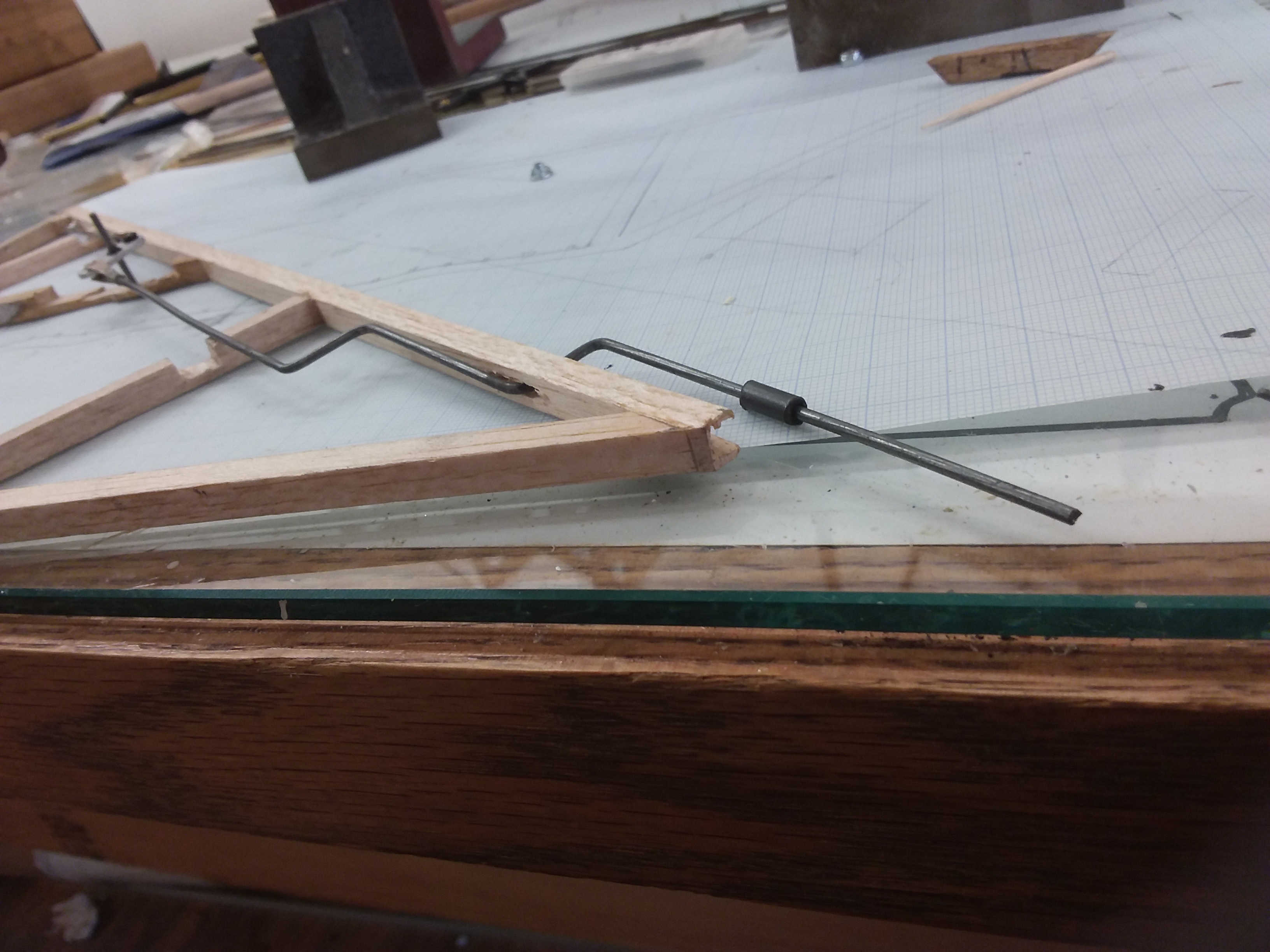

Routed the top of the door for push rod insertion.

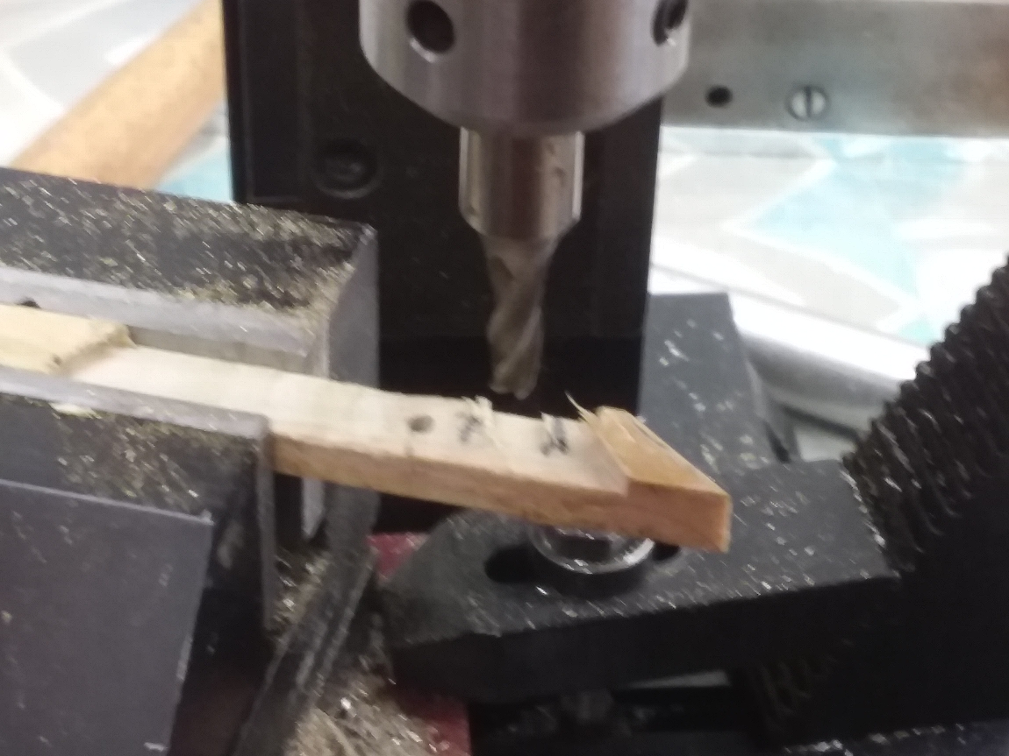

Will use a small piece of cf dowel to keep rod in line.
