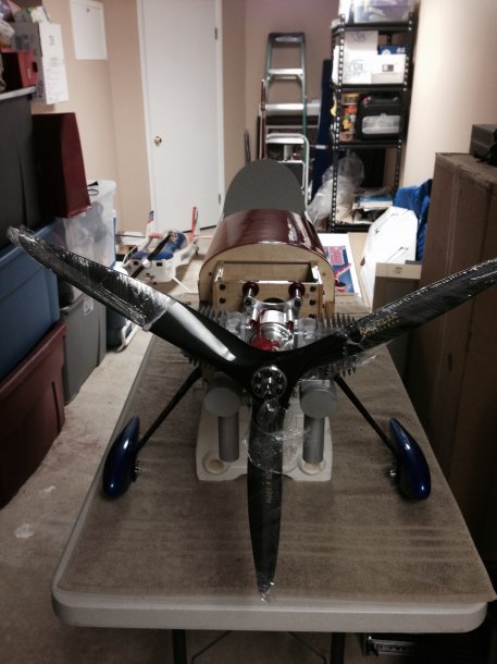

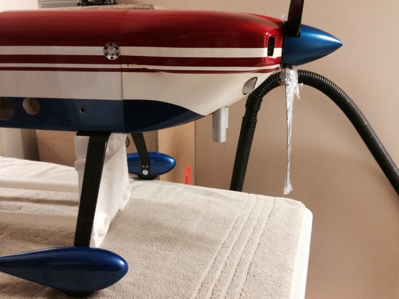

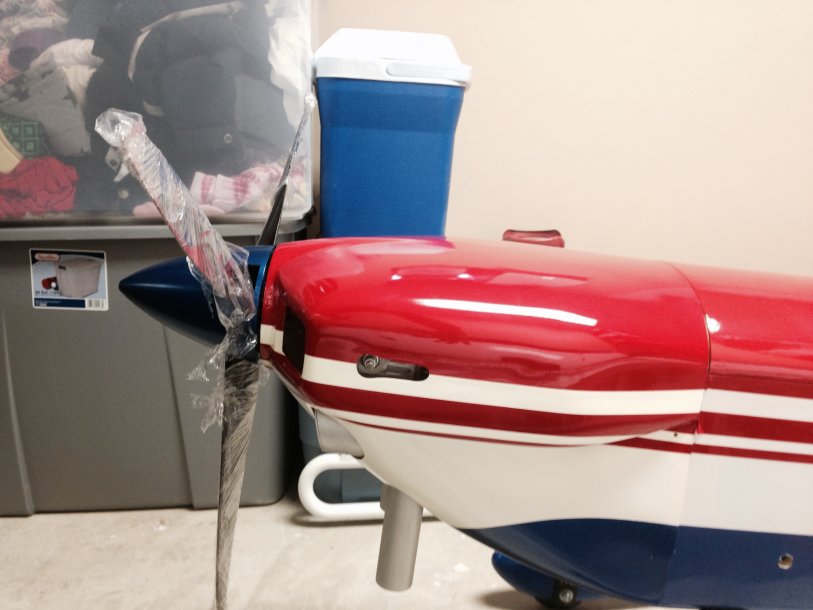

    Some of you have seen some pics of this assembly in general discussion, I figured I'd contribute to the forum and add a build thread. I'm a CAP lover so here I am, building an old school CAP with current gen hardware. Most of the assembly is complete. I got the spinner today. I intend to complete the canopy today and will begin to test the CG so I can permanently install batteries and complete the install.
    Engine placement looks close to spot on, based on spinner to cowl clearance. I'm pretty happy with the 3-blade prop clearances as well.
    BTW- not sure why the first pic always gets posted twice, and some repeats in the bottom. I added only one copy of each. I'll submit a bug report to the team to look at it.

    I bought it before I started having kids, it took a backseat to wedding. When my wife was pregnant with my first child, she's 8 now, I stopped flying completely and kept it in the box in the garage. So I've been waiting to put it together for a long time, close to 10 years. There is some ironing I've had to do, the cowl has a couple superficial cracks, but all in all, it's new. 97". Originally designed for the GT80, this DA is about 1lbs lighter and incredibly more powerful. Throttle management will be key. My hope is that my investment will be protected and can reuse a lot of the hardware in a current gen arf when the time comes. For now, I want to enjoy the CAP for as long as it stays together. :)

    VERY nice job of cutting that cowl!!!!!!! Nothing I hate worse than a jacked up cowl. That plane is going to be an absolute monster. H9 has had some really cool planes over the years, it would be cool if they would dig a few of them out, revamp them a bit and re-release things like this CAP.

    terry, the cowl took a couple hours of trial and grind, trial and grind trial and grind. And a lot of sanding of the edges to make it clean. I think I need to cut a hole for the carb to breath.
