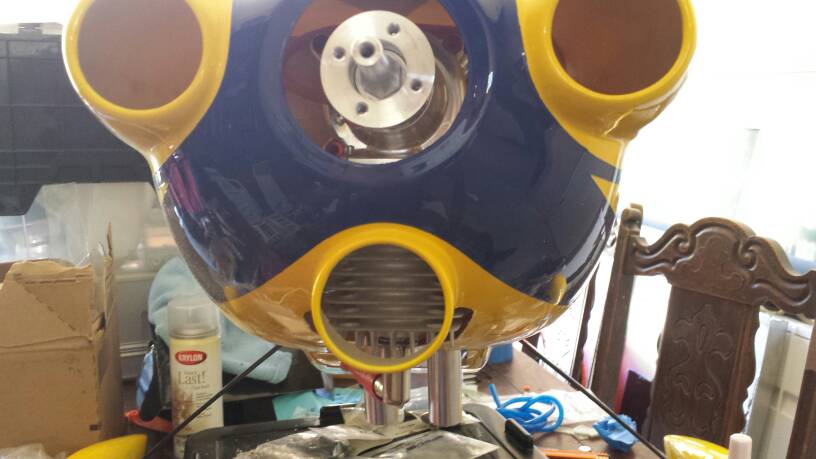

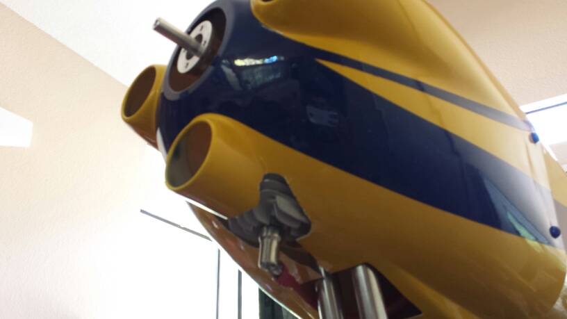

What a coincidence! I just mounted my motor too :)
I'll be taking it back off to drill the firewall for throttle linkage and such though.
uploadfromtaptalk1408141283389.jpguploadfromtaptalk1408141297049.jpguploadfromtaptalk1408141303901.jpg

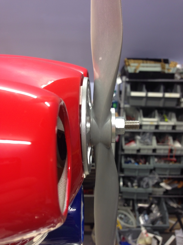

Thanks to a tip from "the boss", I used double sided tape to set the perfect spinner gap. The stand is the one EF sells. Very handy. It has 3 different size airplane cut outs.
Just model props has dropped the ball and not shipped a order I made on Tuesday. Have to use either a 21x10 xoar or this hunk of APC.
http://www.extremeflightrc.com/store/index.php?main_page=product_info&cPath=7_9&products_id=91
That's an awesome spinner gap. Great tip.

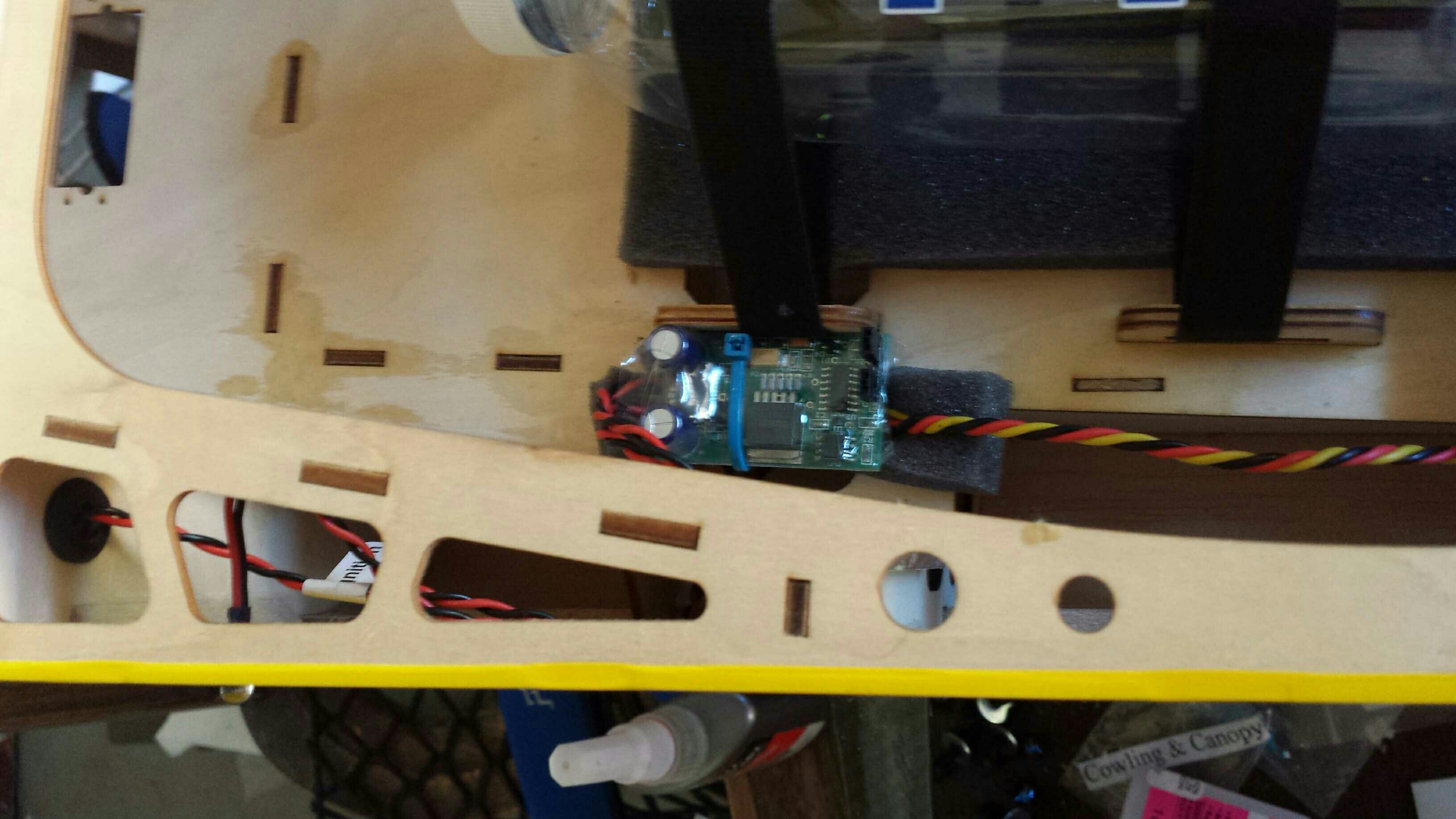

My tech aero ibec came today so I just dropped it in really quick. I'm going to need to pick up some of that snake skin/mesh covering for all my wiring. uploadfromtaptalk1408148918798.jpg

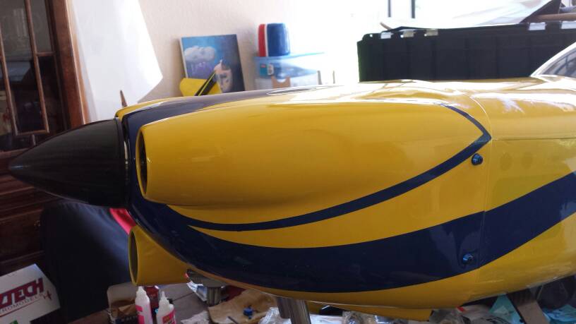

I am using a EF 3" spinner for now. I ordered a slightly larger one from Falcon that has the cooling openings and should fit perfect as the 3" is slightly too small.
