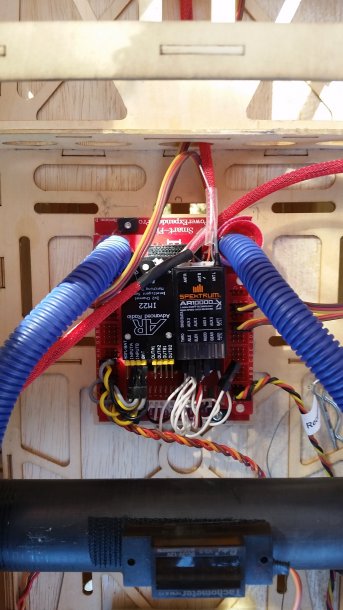

I just ordered one for my 3DHS 104" Slick. As for the hookup, I'm assuming you put this before the power distribution (I have a SmartFly in it)? Like this: Normal three-wire servo extension from the RX to the Intellimatch (so that the Intellimatch feeds off the same source as the RX), then a single signal wire from each output into the SmartFly.
Makes sense?

FWIW, I just maidened my 3DHS 104" Slick with an Intellimatch IM22 on it and it worked beautifully. The setup is dead simple. Plug it in, push a button and it does the rest itself. Very minimal buzzing across the entire range. I have dual Savox 1270TG on the ailerons, so a single IM22 took care of both surfaces. And since the device costs less than two Matcbboxes, I can't see what's not to like.
The only possible complaint would be that I'm feeding four servos from three wires (the two incoming channels, plus an auxiliary battery wire). I don't think that's going to be a issue, though.

@thurmma Did you check that the servo moves freely and doesn't bind somewhere along the curve? I think the device works by measuring the current, so it it finds a spot where the servo binds a little and draws more current, it may think that's a mechanical end point. This is a dumb question, but you did hook it up AFTER the power distro unit, right?

Zero binding and perfect mechanical geometry. Went by the directions to the letter. It doesnt mention setting end points on slave servo. Ill give that a shot. Pm replied to.
IMAC FANATIC
40% happier than most folks.
All good and wonderful again in the world. Thanks Mark for the walk thru today, and just like you said the step to simply push the button was missed and it truly doesnt say to push it on my instructions but the pdf online does. Awesome units incredibly easy totally impressed with them and with my friends here on GSN, the help flowed so fast and correct. Thank you thank you thank you.
