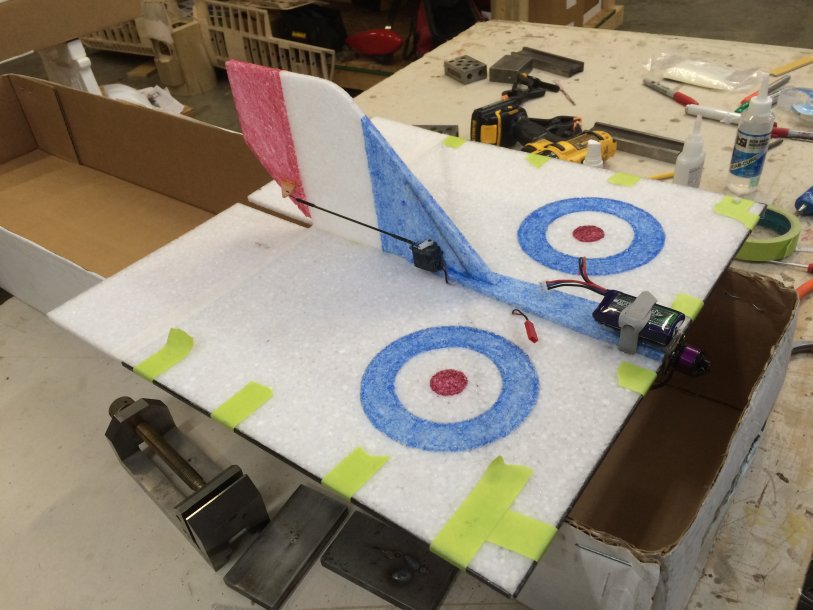

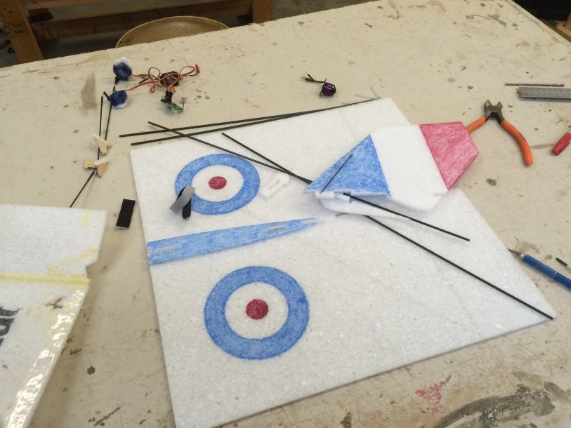

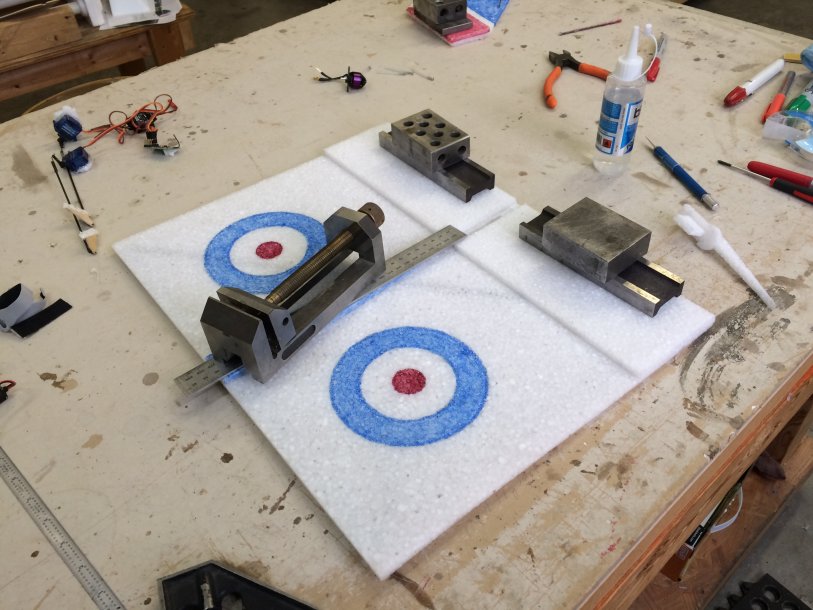

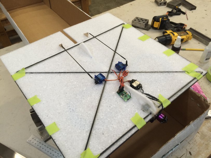

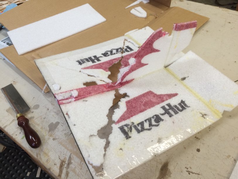

Meanwhile the indoor season is upon us here in Indiana. THat means Pizza Box Combat. All my old plans were shot.I'm finally giving up on the Pizza Hut plane. I'm replacing it with my last kit that I had laying around. I wanted to make it look like a Camel. So I got the Magic Markers out and put some Roundels on it. Also colored the tail Blue White and Red... I was looking at it before coming in the house. I think it looks like an Owl. LOL

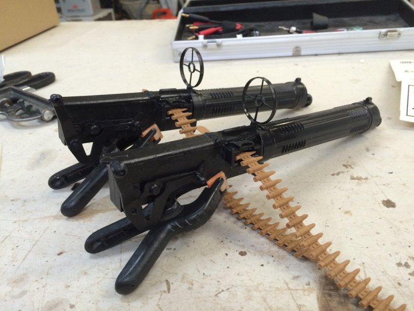

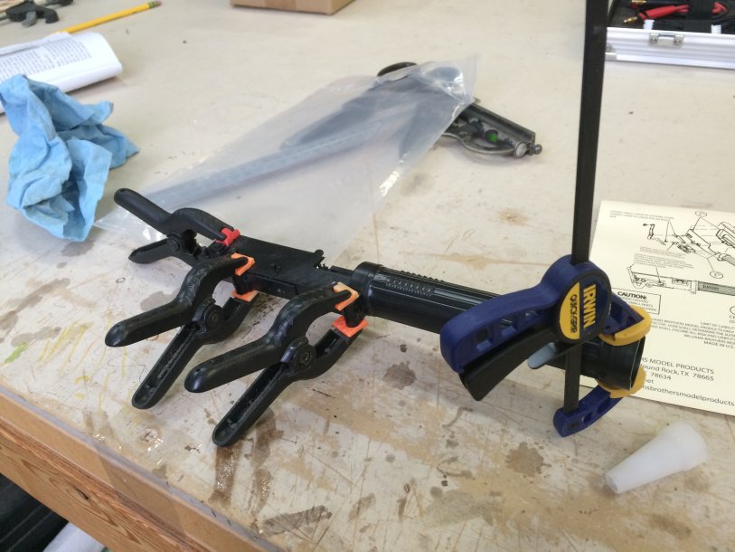

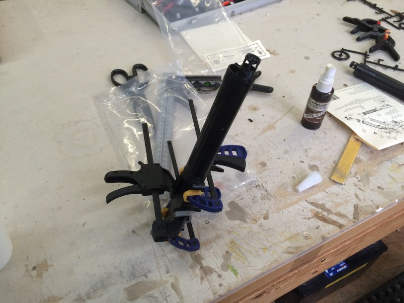

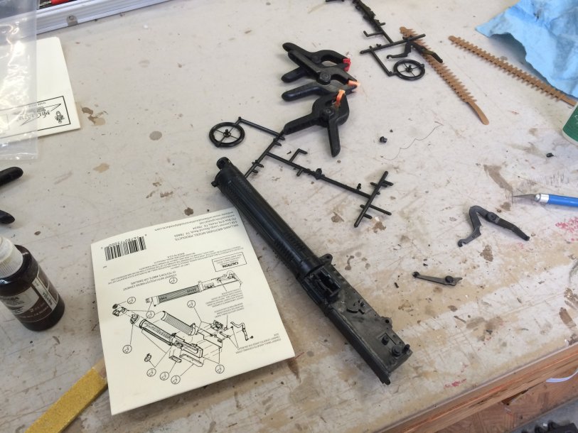

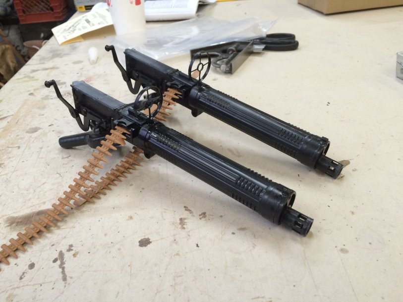

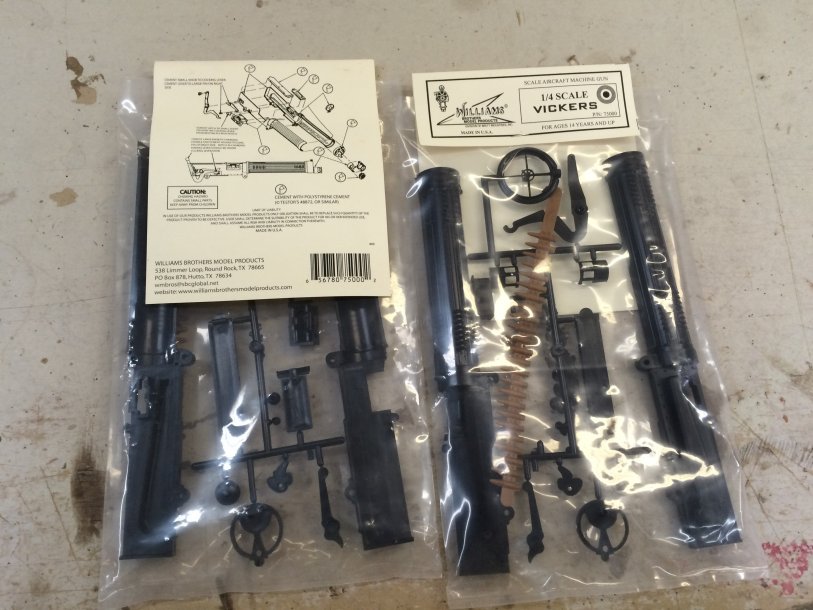

Decided to put the Vickers together... It's ready for paint. I probably should have waited so it don't get messed up. I'll pack it up in some bubble wrap if I can find some.
It's progress. Sort of. :)

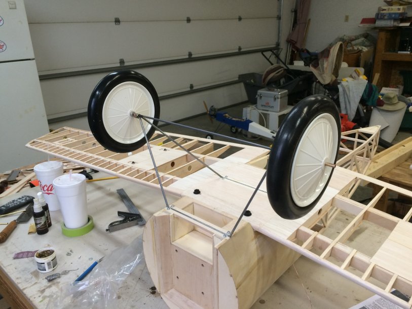

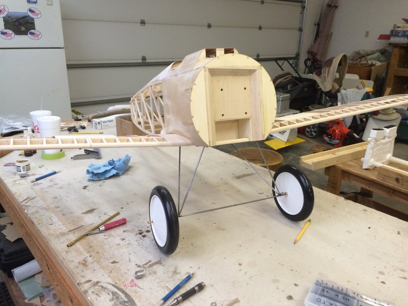

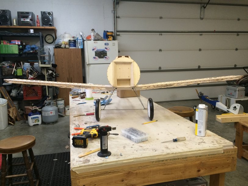

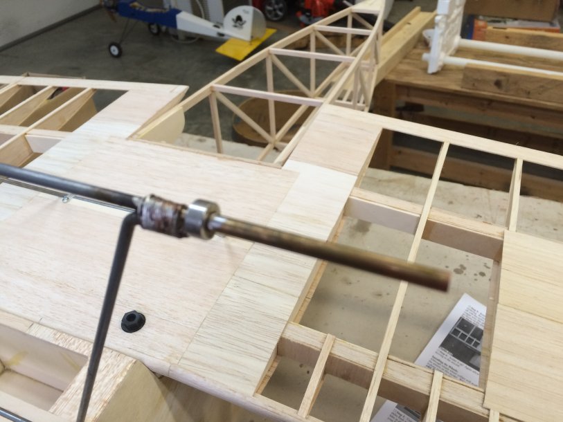

ere is another out of turn step but it is progress.
Built the landing gear this afternoon. The kit didn't come wit an Axle that bridged the gap between the LG Struts. I bought an extra 5/32 diameter rod from the LHS and some 5/32 ID Brass tubing to finish the axle the way it should be done. Learned how to do this on my Fokker from Steve Percifield. The Brass tube fits the ID of the Sullivan wheels perfect.
