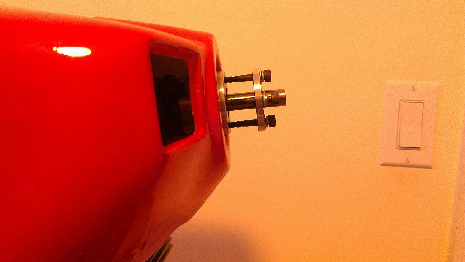

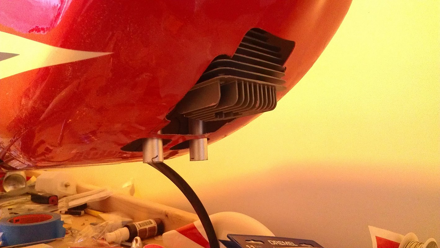

with my dle the muffler is a hair from touching and i left it that way, been a few seasons with no problems, you can add washers to your standoffs but i would check you spinner gap first cause the cowl isnt really adjustable.
njswede
Just finished the rough cutting of the cowl and the verdict is that the PTE36R is a perfect drop-in replacement for the DLE30 in the 72" Extra. The spinner gap looks like it's going to be perfect with the stock standoffs! I'm a happy camper!
njswede

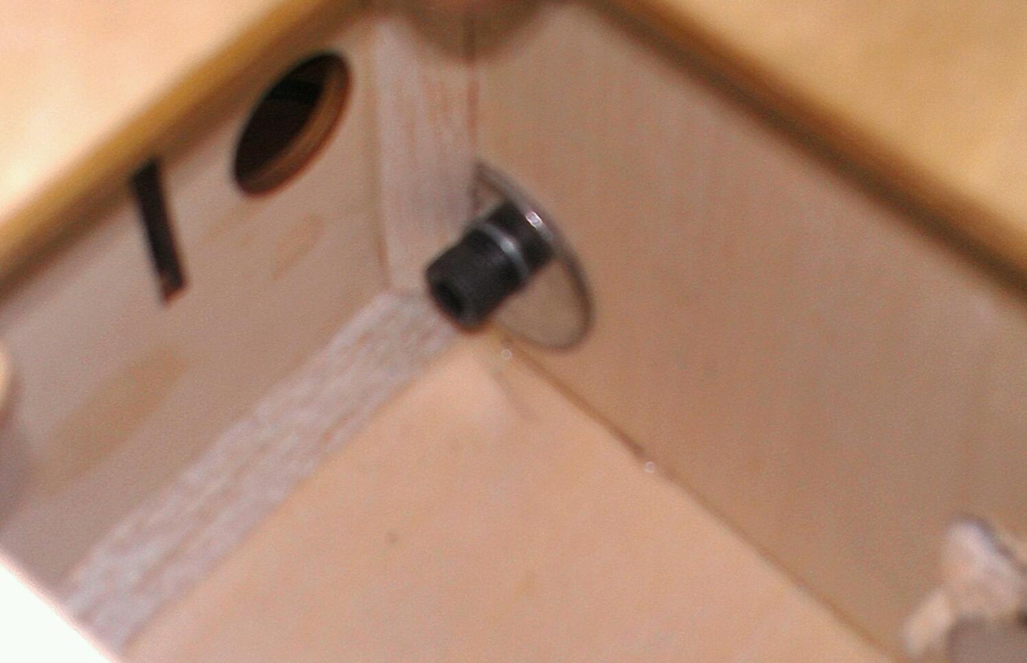

Some dremel surgery of the fender washers needed to make them fit. But bigger washers are better, IMHO, so it's worth a little work with the cutting wheel.

I did a test fit of my PTE36 on the Extra and it fits, but... The muffler gets REALLY close to the wood on the firewall. I'm going to add some fender washers between the firewall and the standoffs, but the distance between the muffler and the firewall is still going to be just a couple of mm. Is it a fire hazard? Do I need to get the compact muffler?
