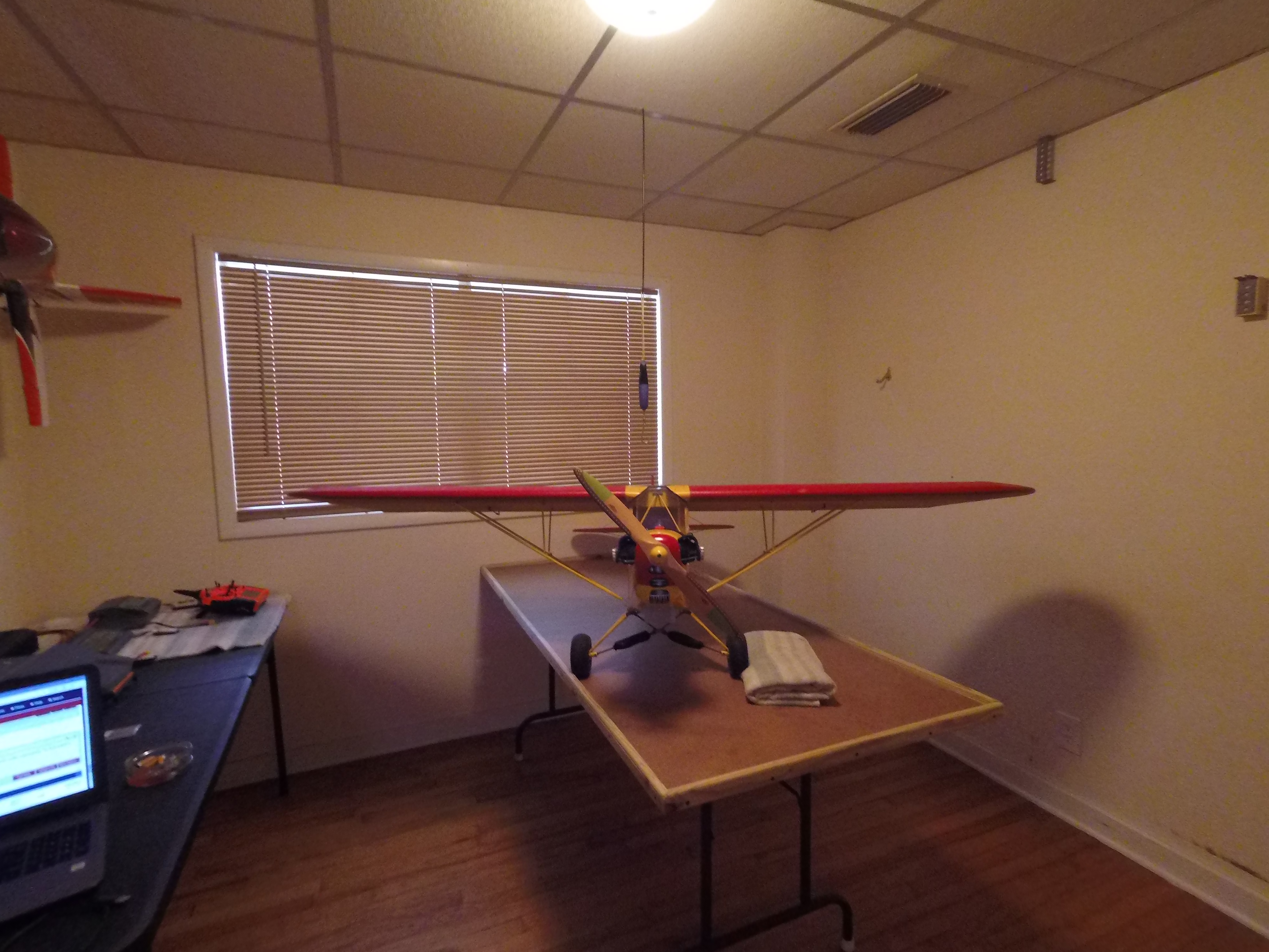

Well.....Here it is all done with the exception of the scale exhaust. Currently looking for some 1/4" copper tube and fittings.
Thanks Snoop's. I have an idea on why the plane has a not so good glide slope. Yes the 17 pound (wet) take off weight is not helping but this thing should still "float" like a Cub. The stits covering on the wing is painted nicely but the fabric has not been sealed. You can blow air right through it rather easily. I think air is "bleeding" through hindering "lift" under the wing. Going to see if I can find something to spray to seal up the bottom of the wing.
